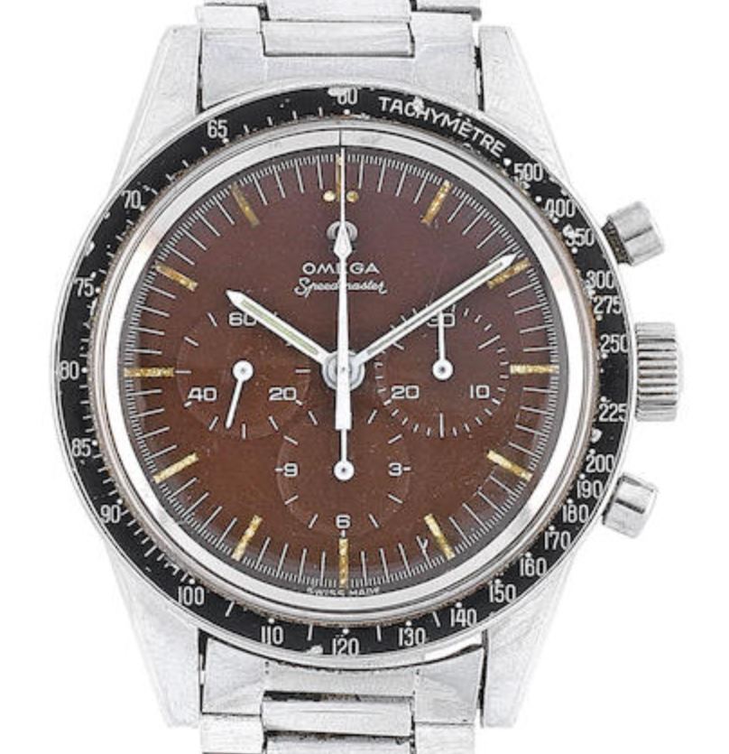

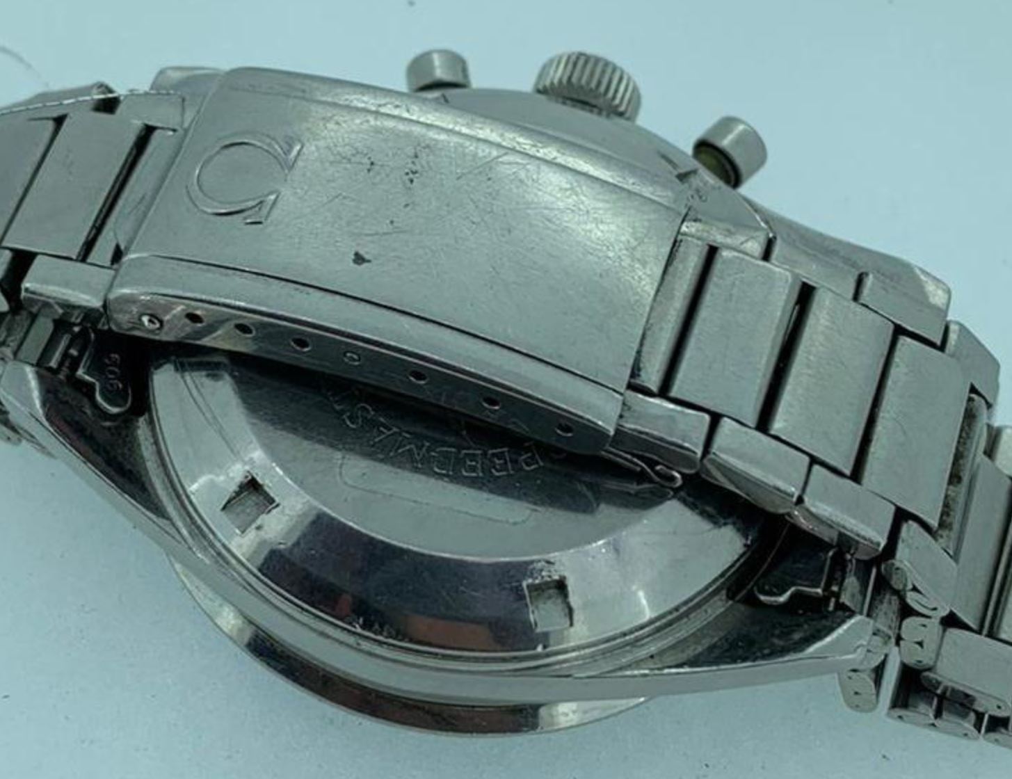

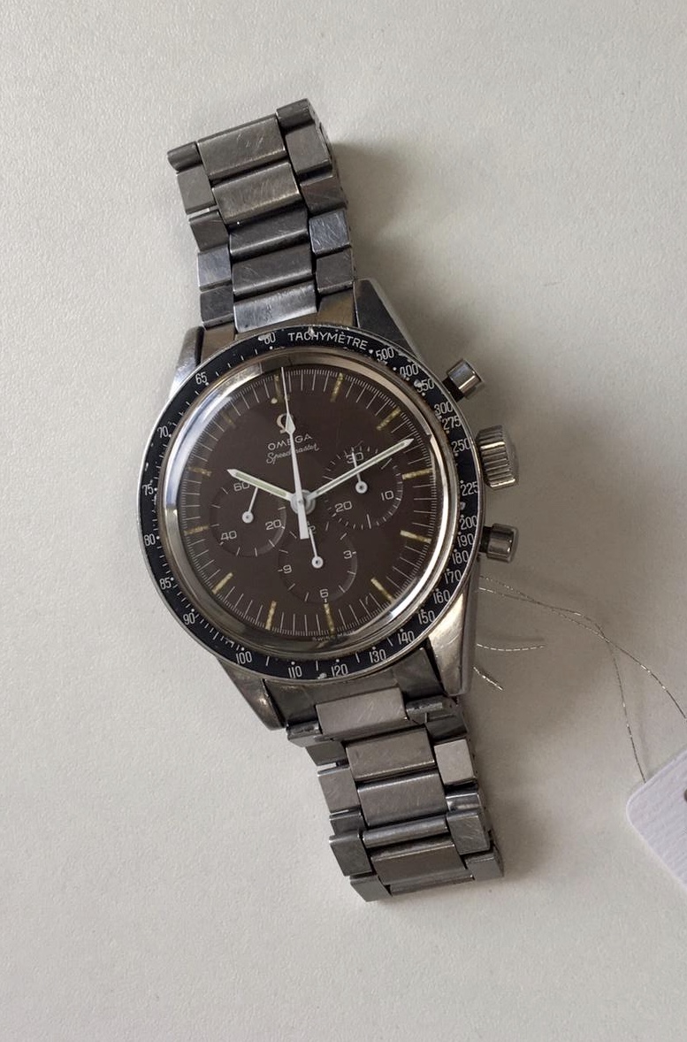

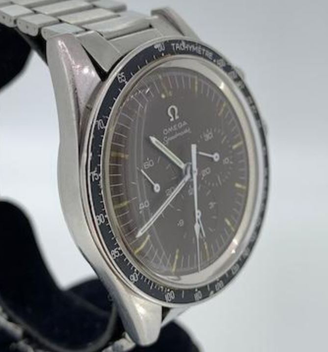

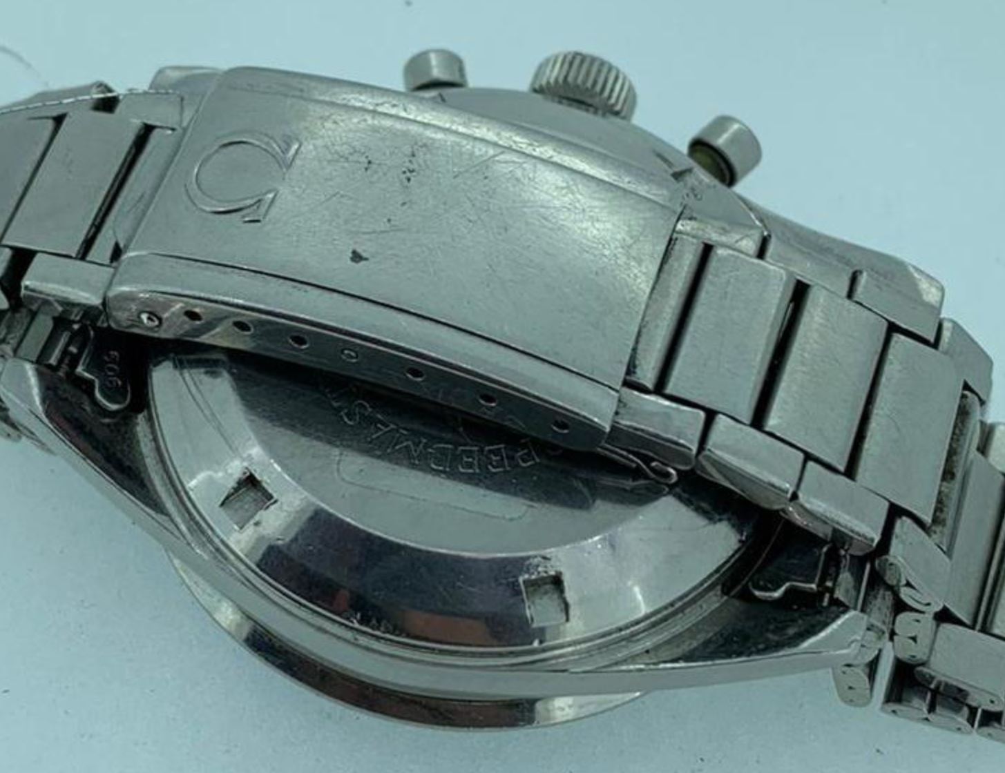

Well it has the wrong hands, the wrong bezel, a misfit pusher, and the wrong bracelet. Wrong crown too but thats easy to fix..

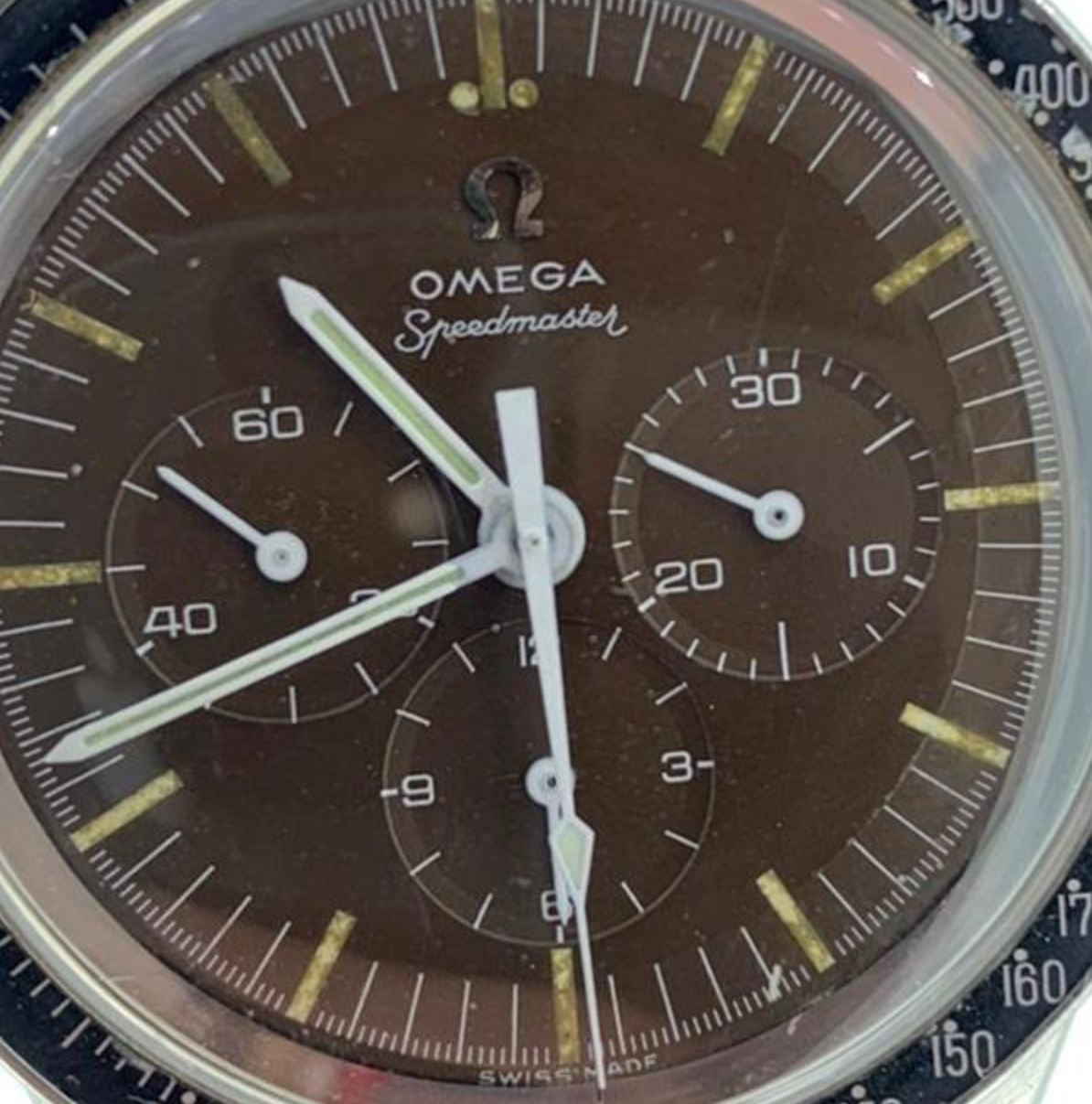

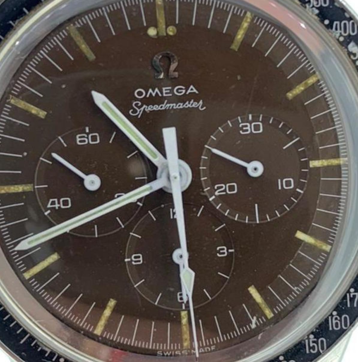

The dial is correct for a 2998-1/2 with small indices on the right subdial, and a round O Omega. The plots are what I call algae and I must say I do avoid them. The dial itself looks "Dry" - note the presence of white around the subdials. Otherwise the print is intact.

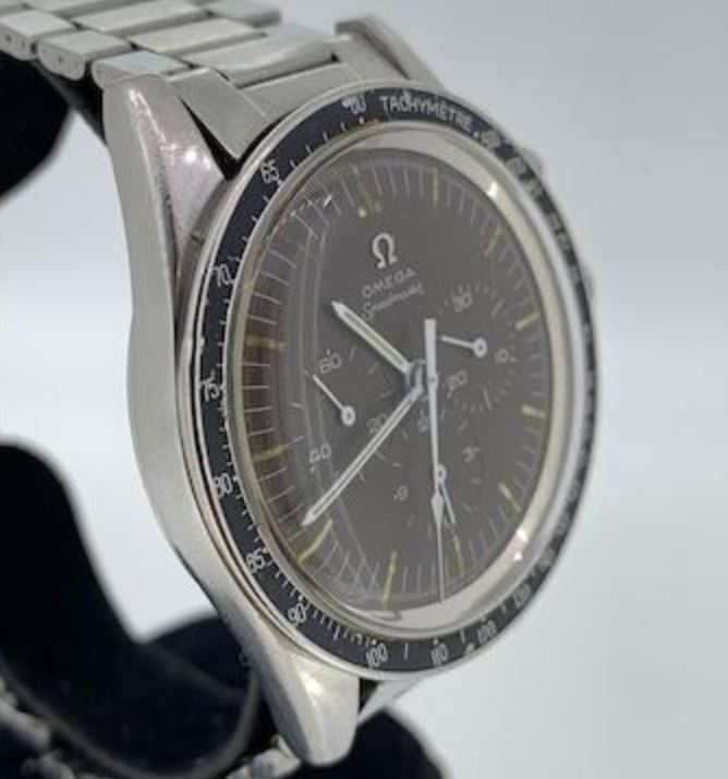

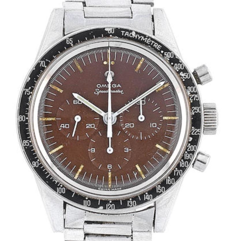

What is that colour? I think its a heavily photo shopped photo. here is another shot:
The photo above is a bit greener and I suspect more true to life. The plots are dirty and look more natural in this photo than the headline photo. So yes its a tropical dial, BUT is it attractive? The short answer is that I think it could have charm at a certain price.

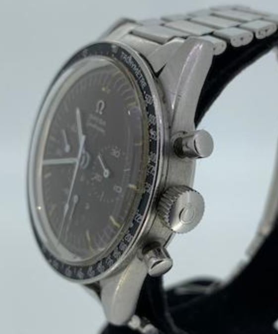

More shots here:

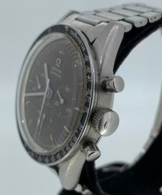

The tops of the lugs are all blurred considerably.

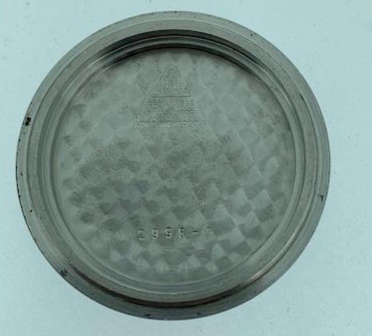

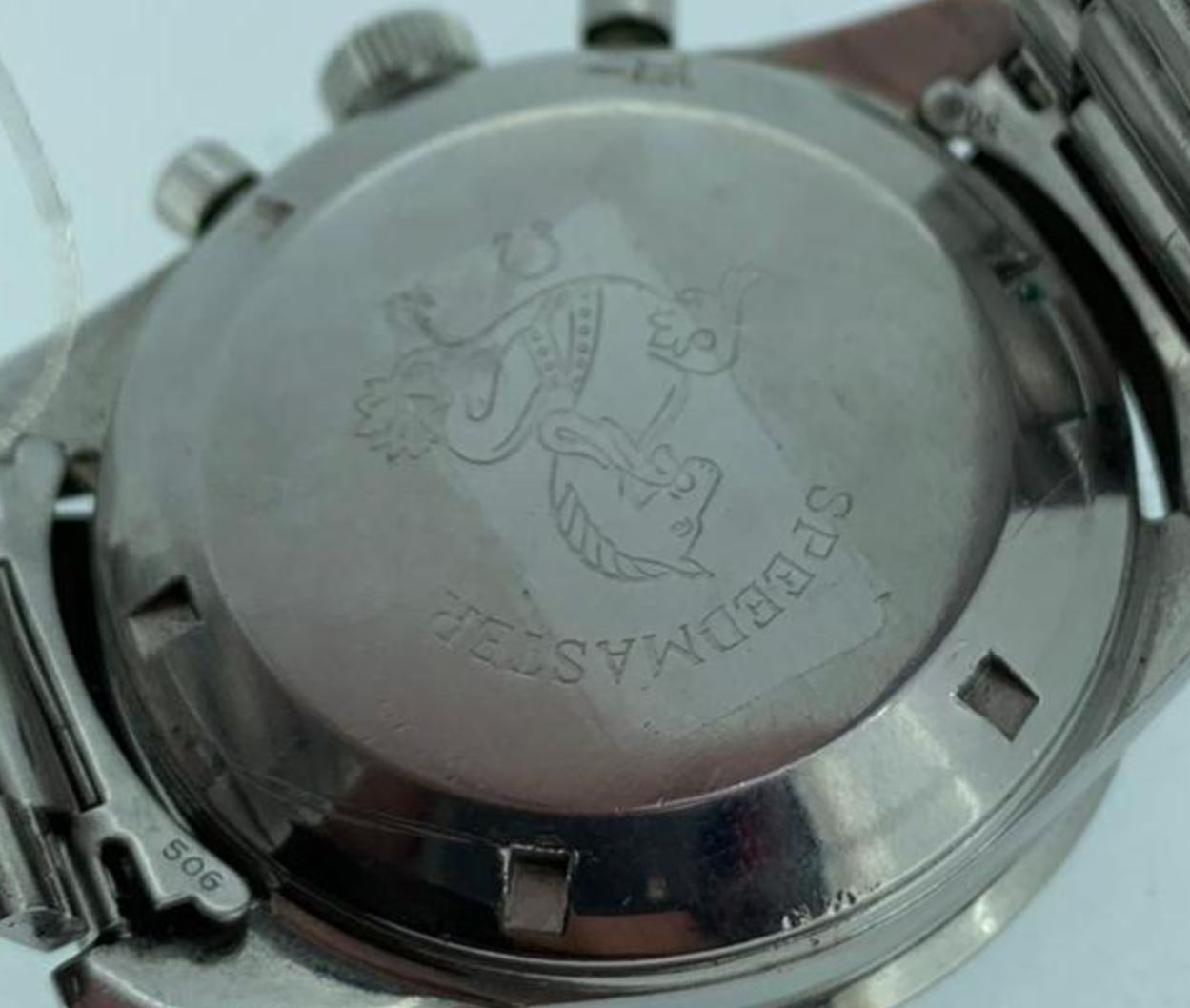

The case back seems as though it might have lost some definition.

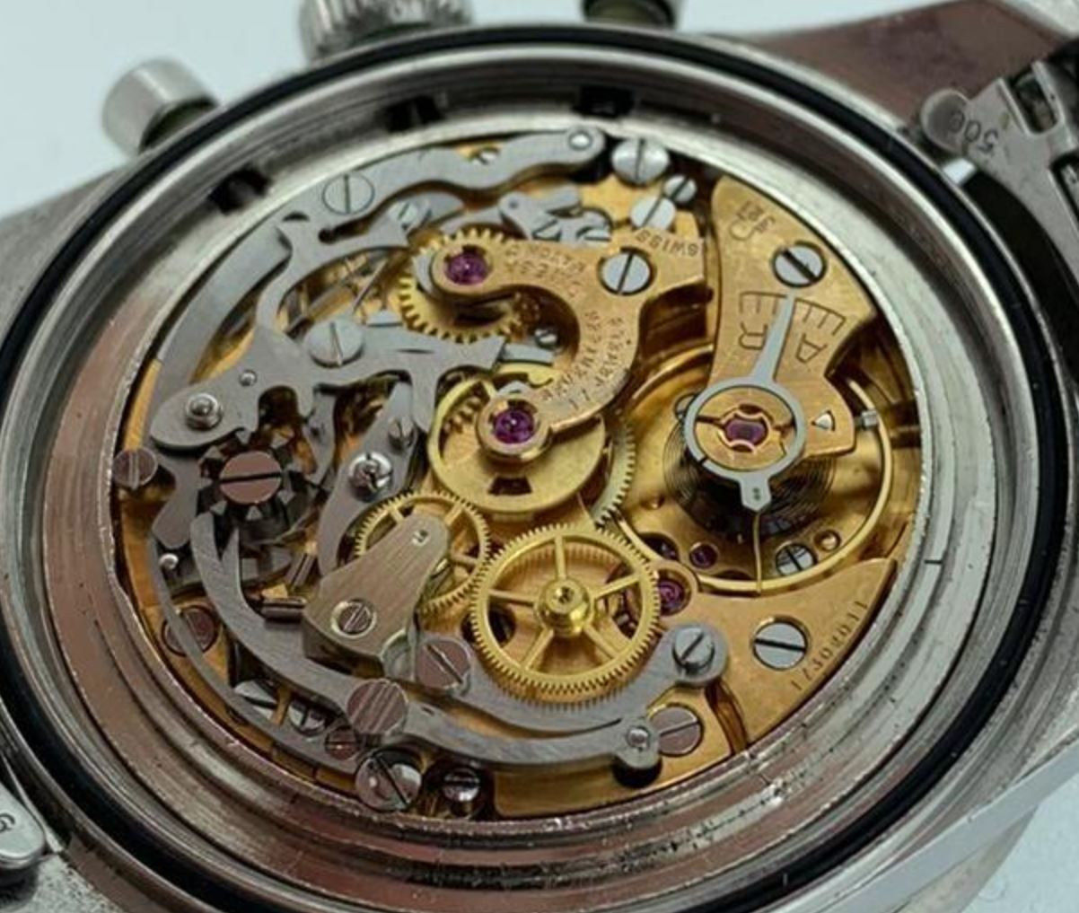

The inner back shows a lot of watchmakers marks, which explains all the added parts.

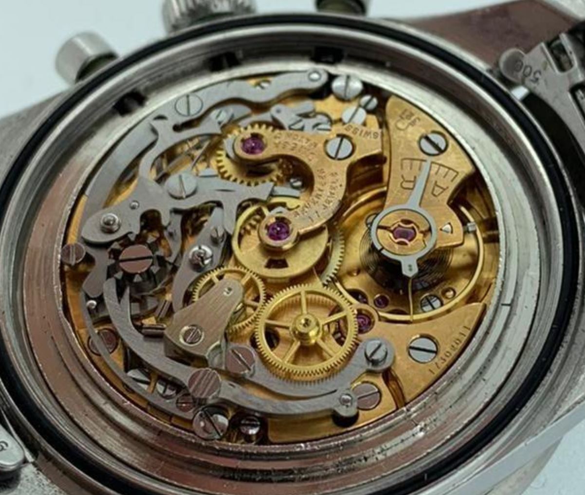

The movement is surprisingly good after all that work:
My feeling is this watch is going to take a bit of cash to get to correct specification, but the dial may have been what has drawn the buyer to it.
I have some reservations about the dial. I do not think it is as brown or attractive as we might hope. The other photos lead me to think its a bit decayed, rather than a nice warm brown. However I hope that I am wrong and that the buyer will pop up here with decent photos.

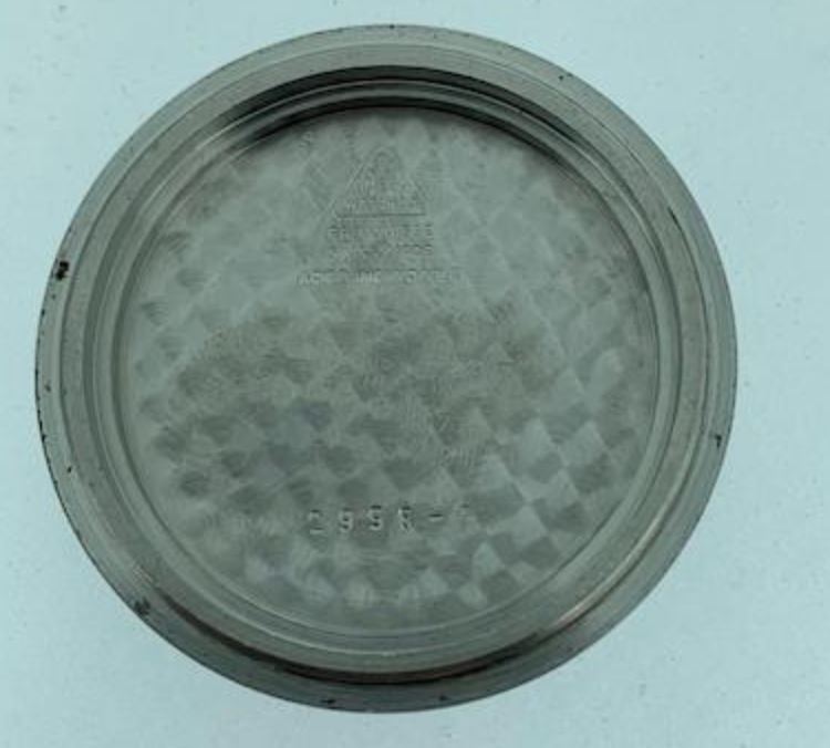

The case is polished so that the case back has lost some definition to the steps on the back.
The DO90 is not correct for a 2998, but has some value.
Finding hands for this watch is going to be a challenge, though not as much as a challenge to find the right bezel.

It’s getting to the stage where the main photo is bordering on misrepresentation.
Based on the first picture my gut reaction was “that’s glowing to come up lovely”, and then in sinks in somewhat after a few seconds, closely followed by the other pictures and I started to think “hmm I’m a bit nervous for the buyer now if they weren’t able to view in person”.

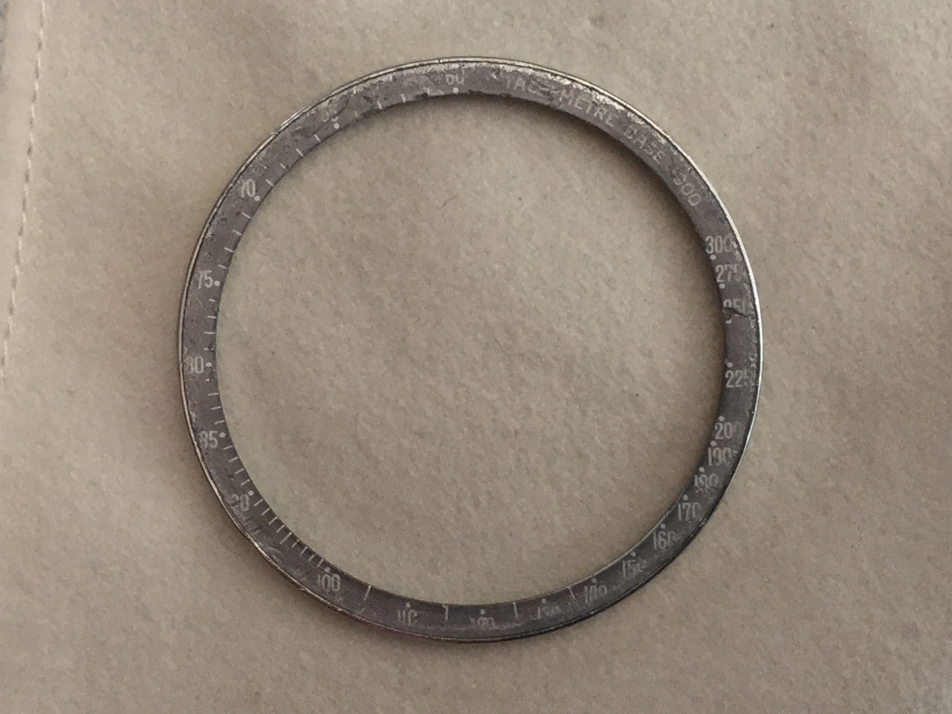

Would need to spend about 10-15k to get parts right
That’d only be the Base1000 bezel.
Add Alpha hands, sweeping (lollipop while you’re at it), correct sub-counter hands and crown.
And that’s only a wishlist, now go find the parts even if the budget is handy...
5,110
15,810

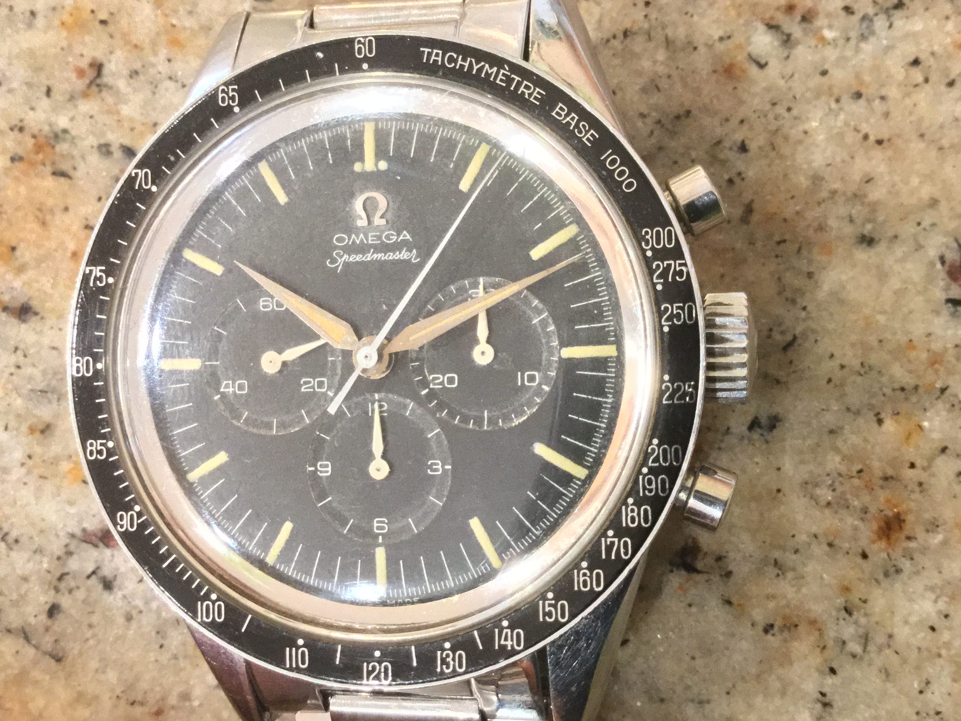

Here we go (compared to the OP watch, and the ‘Dink offering, I am not sure why this still languishes)

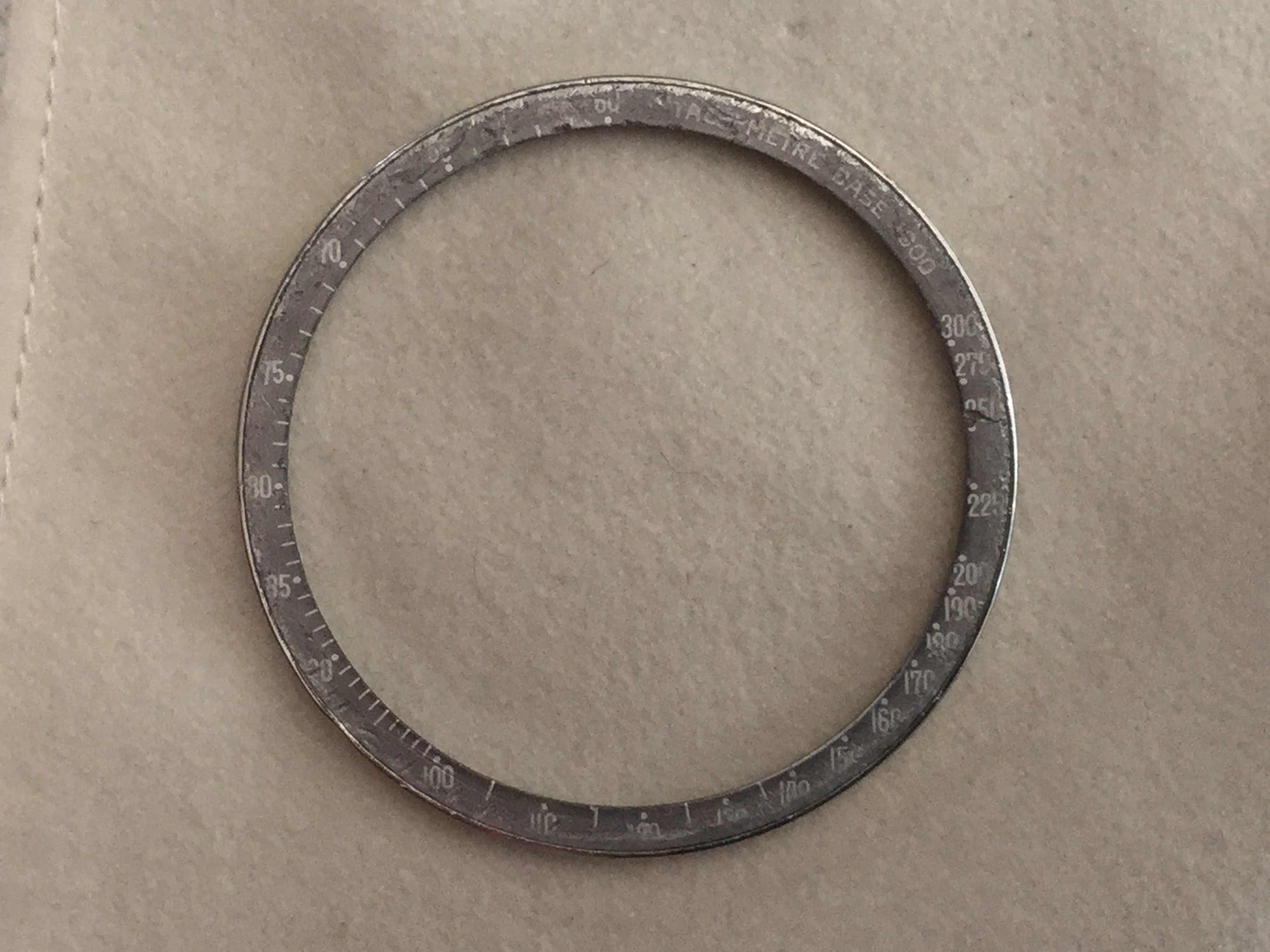

last ones sold puplic were all arrounf 7k€ and not sold fast.
85
105
was on ebay. davidoff bros also sold 2 base 1000 there. both under 10k.
5,861
16,800
As with all bezels, Base1000’s vary in quality and price. Different styles as well.

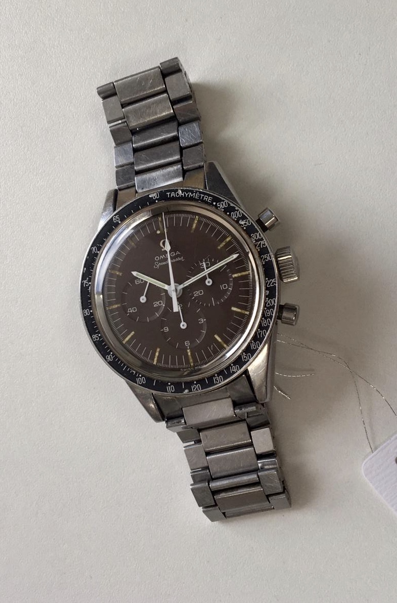

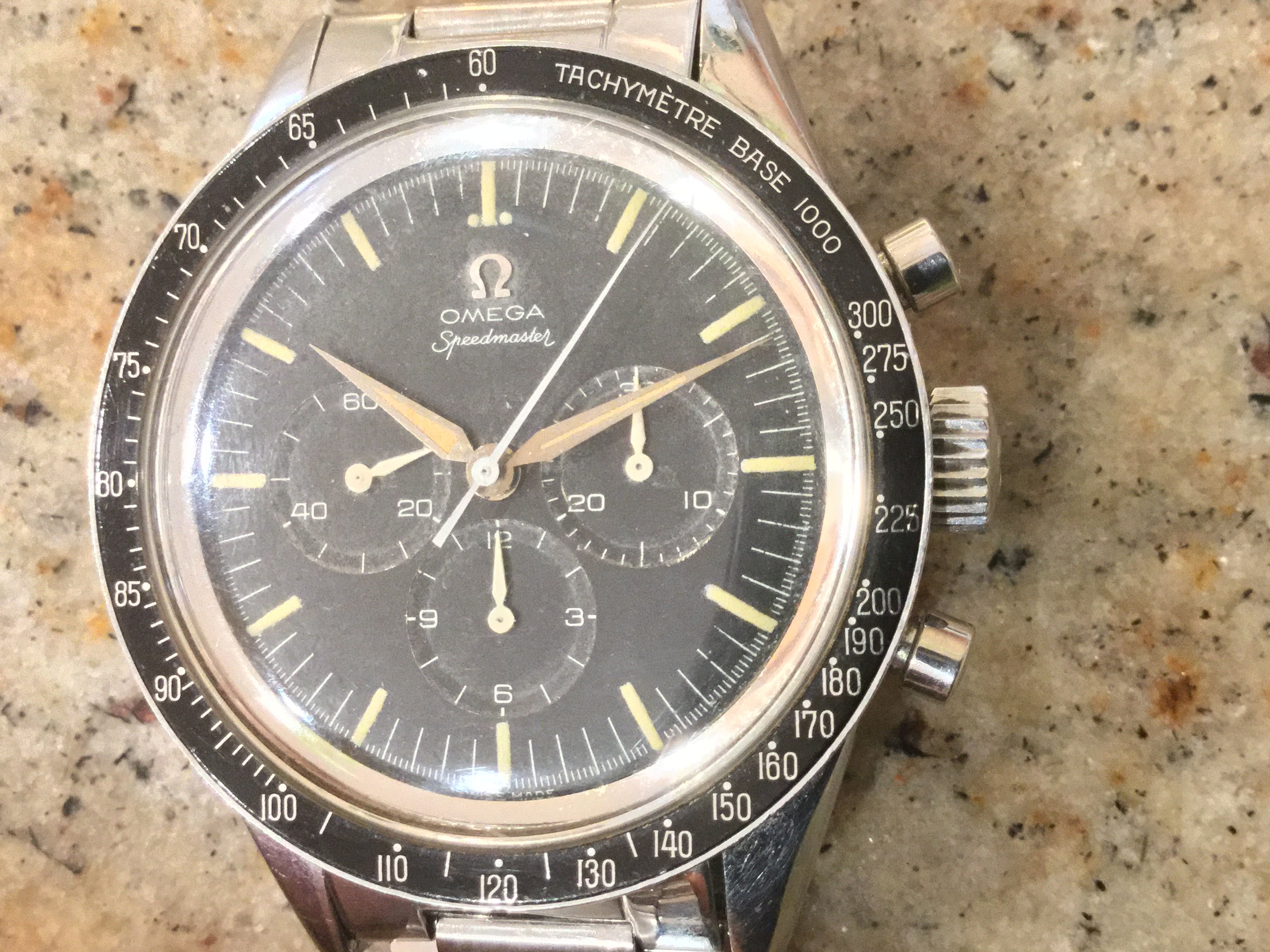

Here’s another photo of the subject watch in natural light. Dial seems to look evenly brown and smooth without visible blemishes. Might be bought by a dealer who will relume and pimp it up, just my 0.02.
295
387
It looks much better in your photo IMHO.
