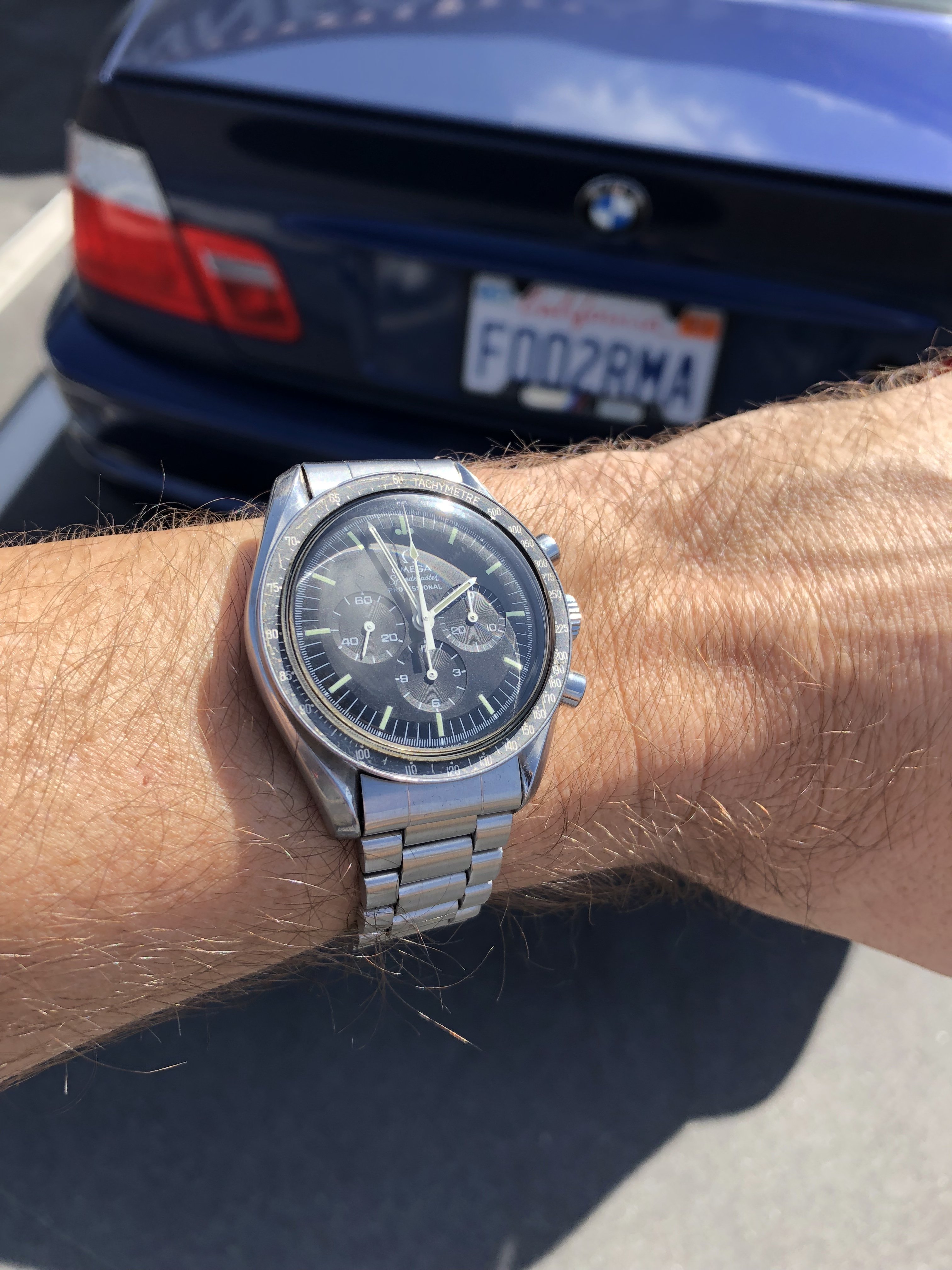

You can still get the modern version of the 1171 bracelet from Omega boutiques (under $500 if I recall), which would work better on an older Speedmaster. I'm personally not a fan of the hollow end links which make it "clinky" to wear. Or of course you could look for the older style bracelets for sale, but those can be pretty pricey. Probably $600-$800 for a 1479 and $1500-$2000 for a 1450.
18,132
27,425
145.022-76 on a new 1171/2-633
