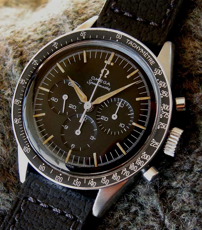

Would love to see a photo of the 2998-4 if you don't mind sharing
609
789

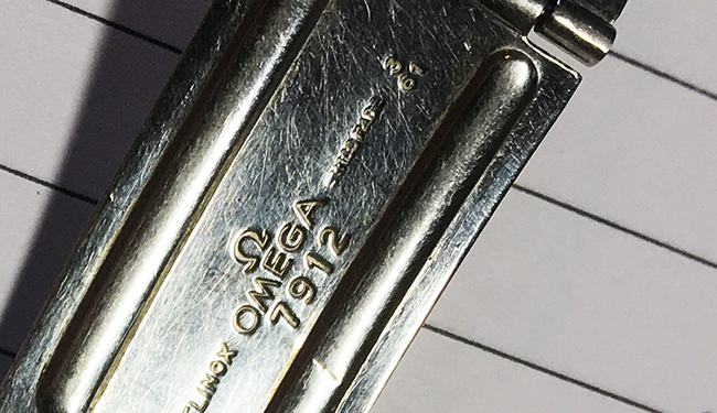

This is mine. It is a 2998-4, hence still radium, extract 27/09/1961. Now on a beautiful 7912/6, marked 3/61.

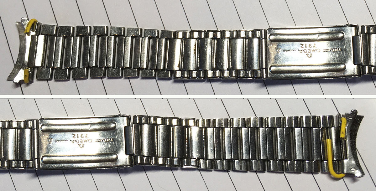

And this its 7912 / 6:
With 2 different versions of fixed links😀
609
789
You are right! Half closed, half split. They must be from my 7077, I must have swapped them ! Sorry 🙁🙁
5,861
16,802
No worries. No sorries. It’s your bracelet. Wear it and enjoy!
