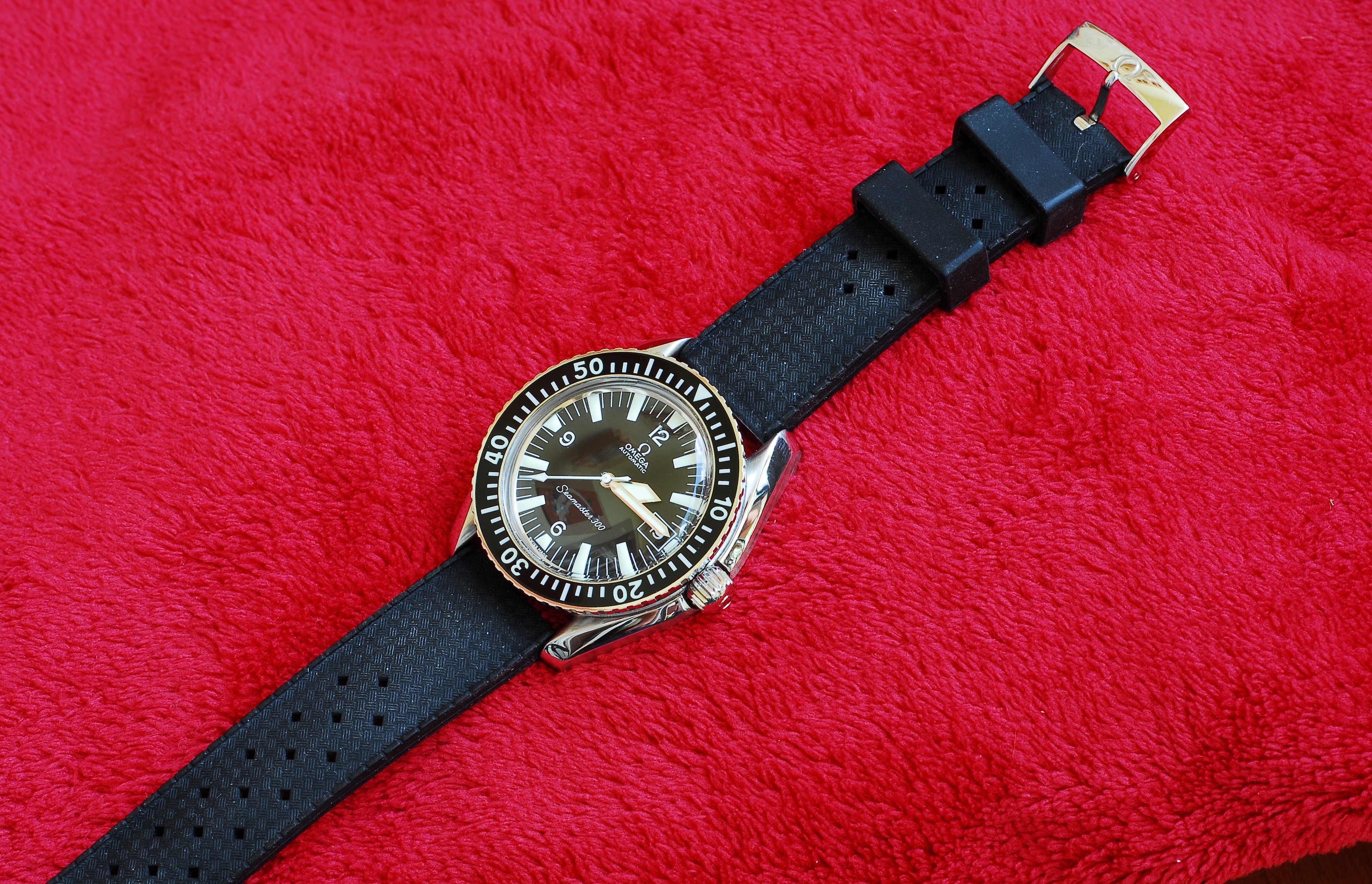

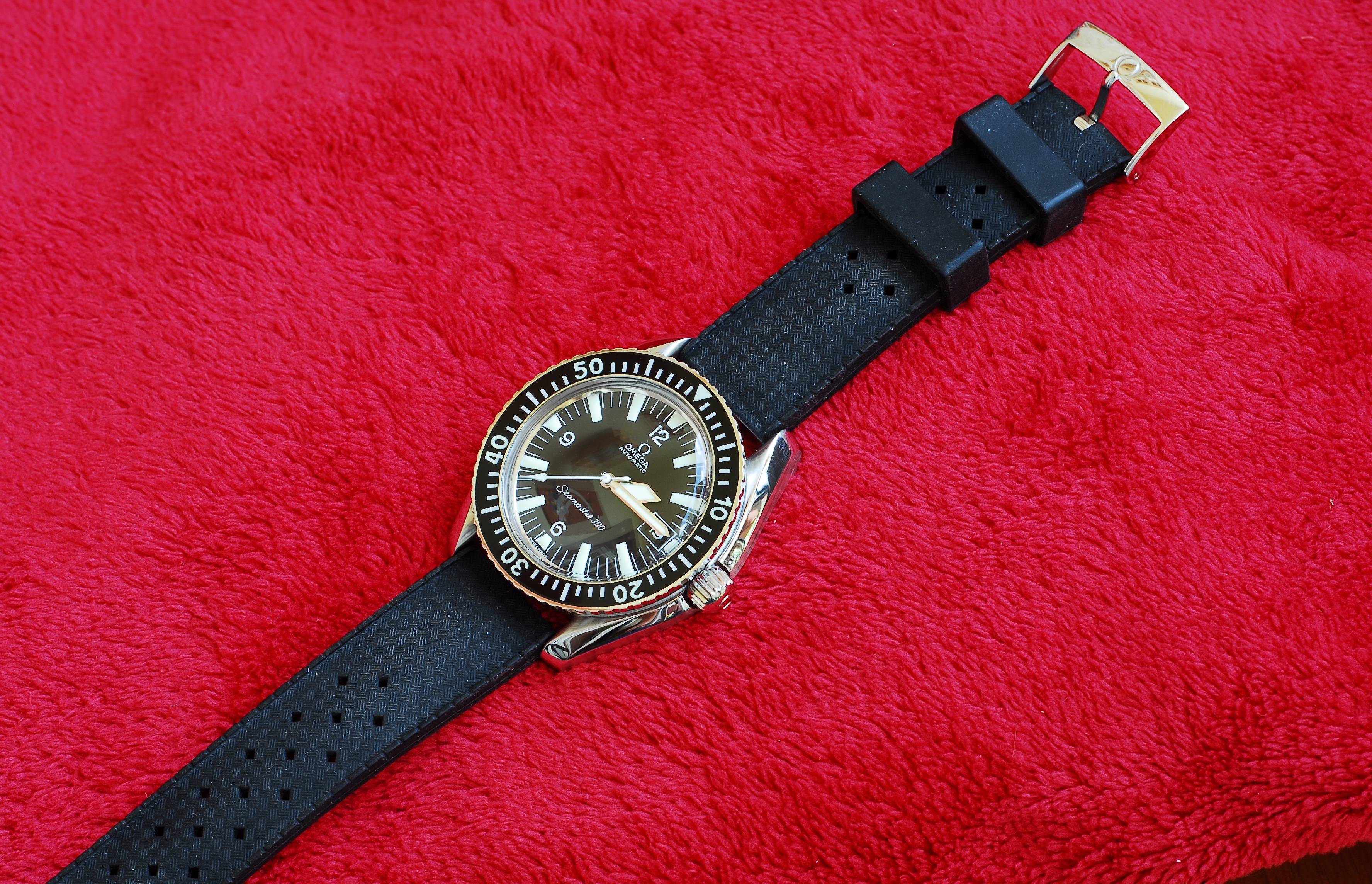

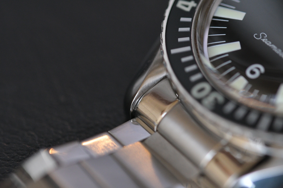

Vintage Tropic fits well:

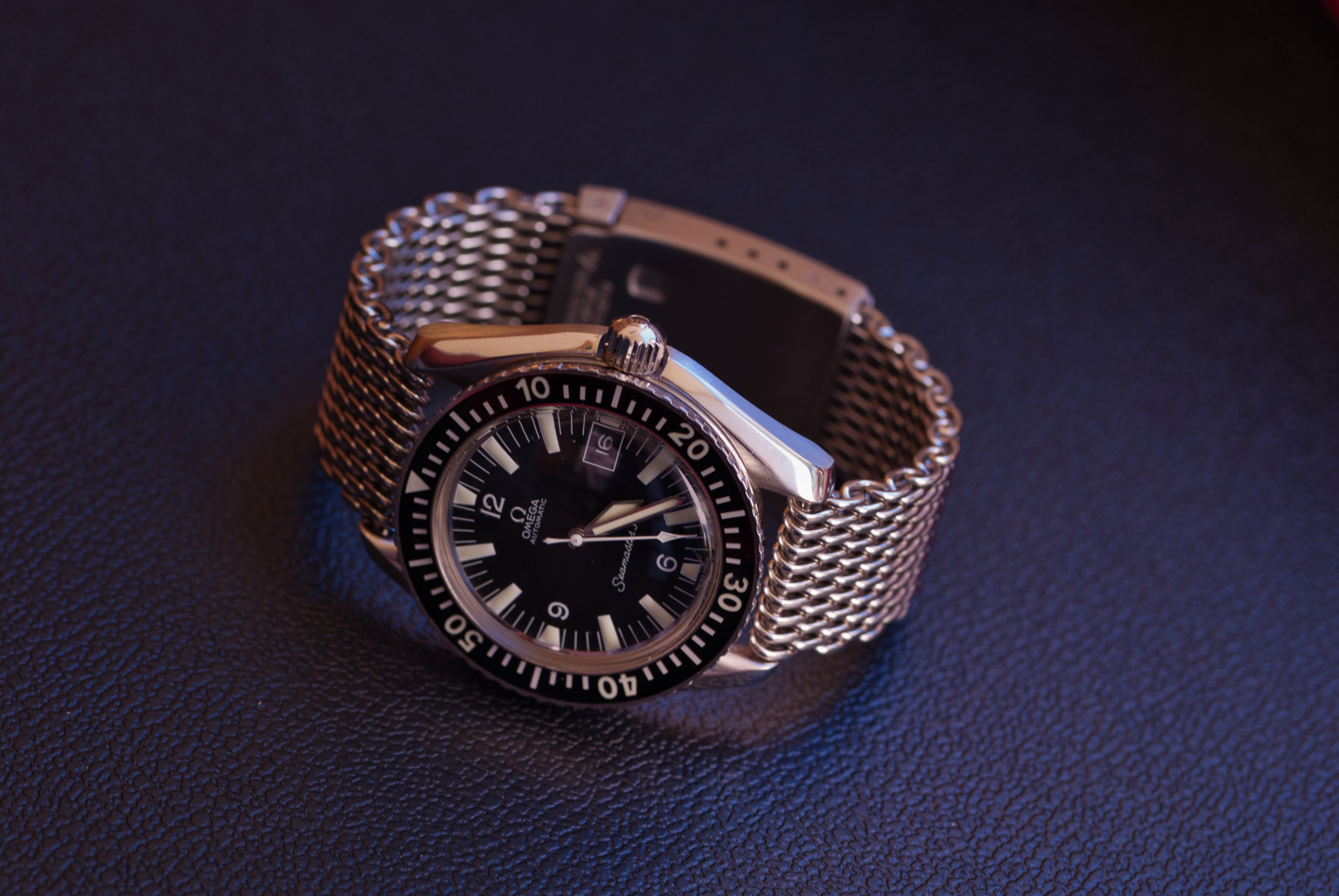

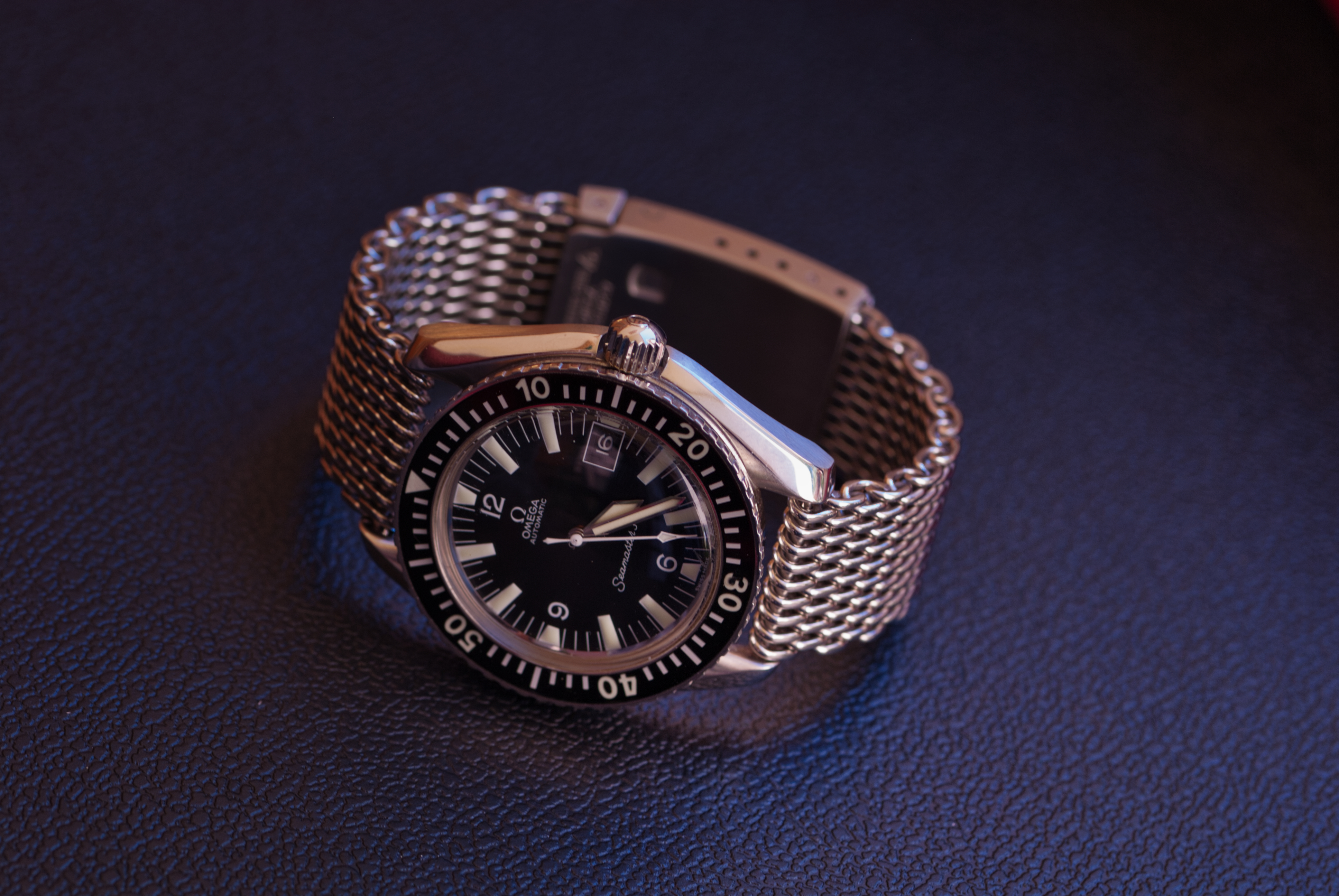

Or OMEGA Shark Mesh:

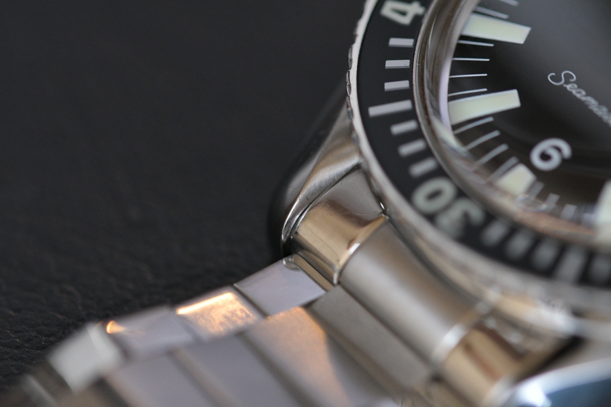

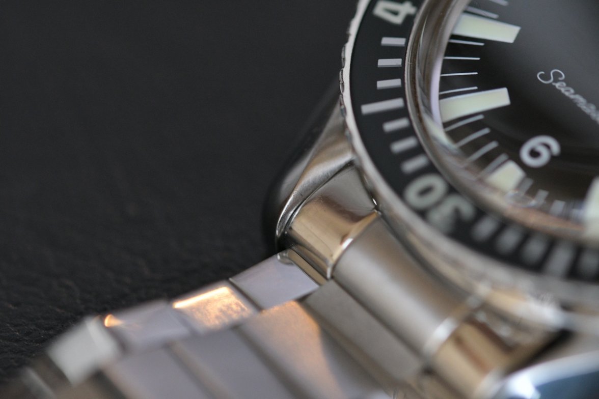

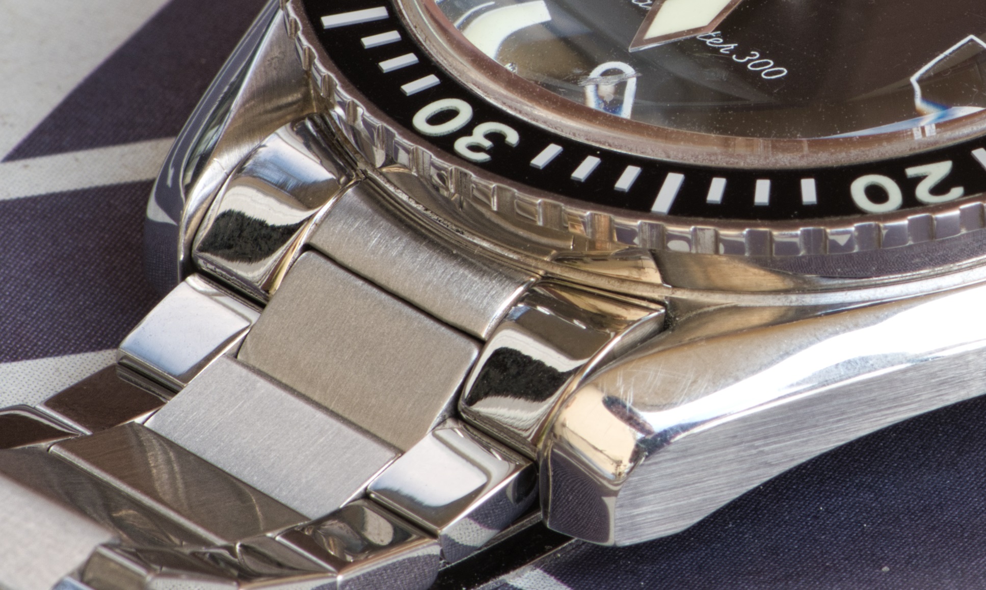

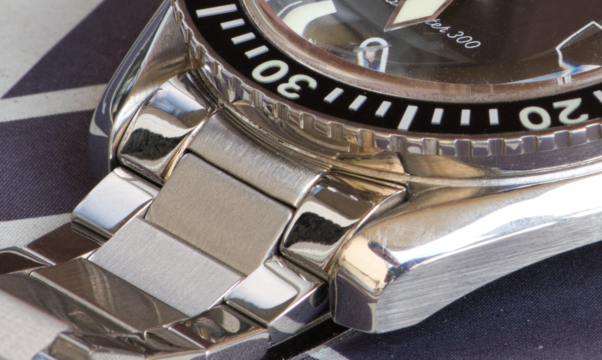

Forstener endlinks doesn't fit well at my housing:
Uncle Seiko flatlinks fits better:
Really love the look of the mesh and the tropic, I've decided to buy a Omega mesh that jaegodylan has kindly offered to sell me 😀

The vintage Tropic is not rubber but a polymer plastic.

I have a few vintage tropics that are nice to wear, some not so much. I think they age differently obviously based on use or storage- or perhaps different formulas during the run? Also- they need to be the “Tropic” brand- I have a couple no-name vintage tropic style and they feel like strait up plastic.
I normally hate “rubber” straps (think seiko or Casio), but the US are comfortable as are the very few good condition vintage tropics I have.

I agree, the actual "Tropic" is better plastic than the copies, as you might expect. And, don't overpay for curved-end Tropics, they don't fit the Seamaster 300 worth a darn.
Does the Uncle Seiko 1171 bracelet fit without any modifications ? I also have the WatchCo Seamaster 166.024. thanks!
