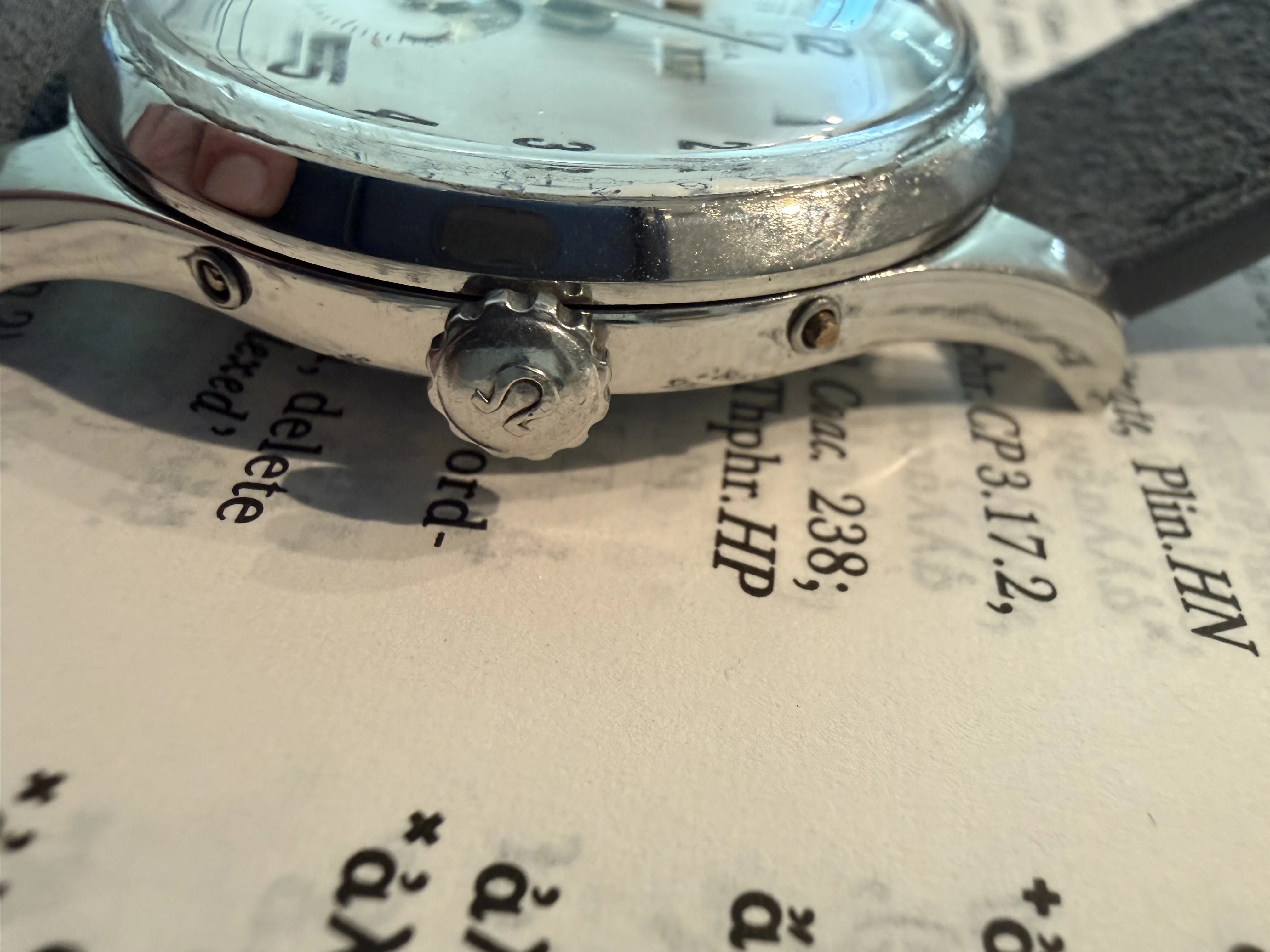

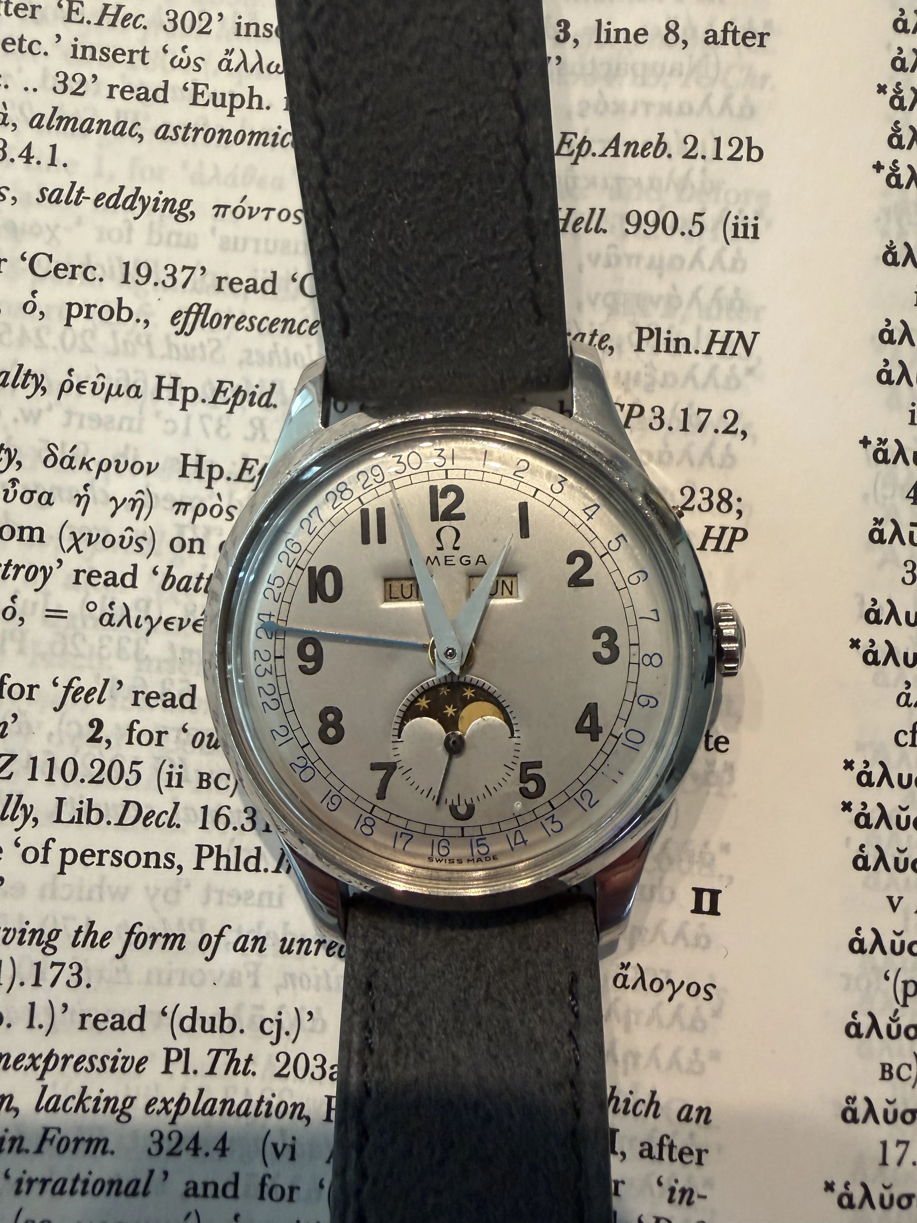

G Posts 1 Likes 0 gryphon82 ·7:06pm yesterday Can anyone identify which parts are non-original on this 2471 I recently purchased? Also, is there a book or other resource out there that breaks down the different options this watch had? Thank you.
Posts 1,560 Likes 6,791 Aludic ·11:47pm yesterday·@SpeedyBirthYear Hi! At first glance, I like the dial. The hands look crude to my eyes, probably not original. Still a pleasant watch to look at. Calling @cristos71 who knows an awful lot more about these than I do.
Posts 62 Likes 321 ricardosantos ·Today at 2:21am I think it is a redial because the days should be in one orientation only but i may be wrong, hands are wrong too should be leaf hands and crown is wrong too, even the case doesn't strike me as a 2471.
Posts 8,150 Likes 36,677 cristos71 ·Today at 3:02am Oh, if you have the option of returning then take it. It's a redial, with wrong hands, wrong crown and the case doesn't look correct either.
