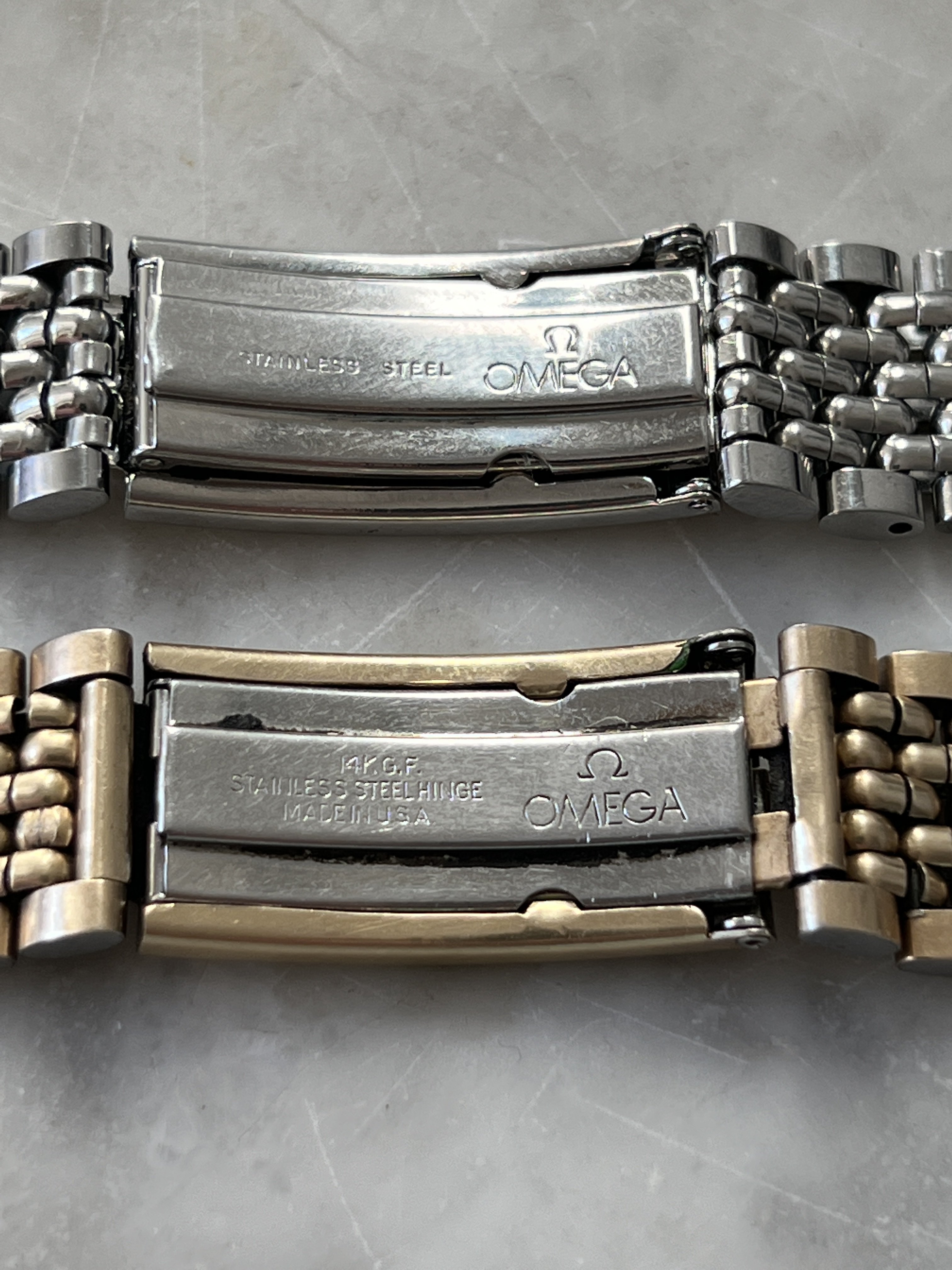

I recently was bidding on a BoR bracelet on ebay and had second thoughts due to the lack of bracelet marking on it (i.e. 1037, 1503). Seller seems reputable and has other marked bracelets. So my question is - how to explain the no markings? Were there authentic bracelets made with no markings?
3,596
13,553
Indeed there were - here are two examples:
Both very early sliding clasp BoRs. A few more pictures of the one in question would sure help us to determine wether yours is actually correct. Most fake ones I know say 1502, by the way, but not all of them.

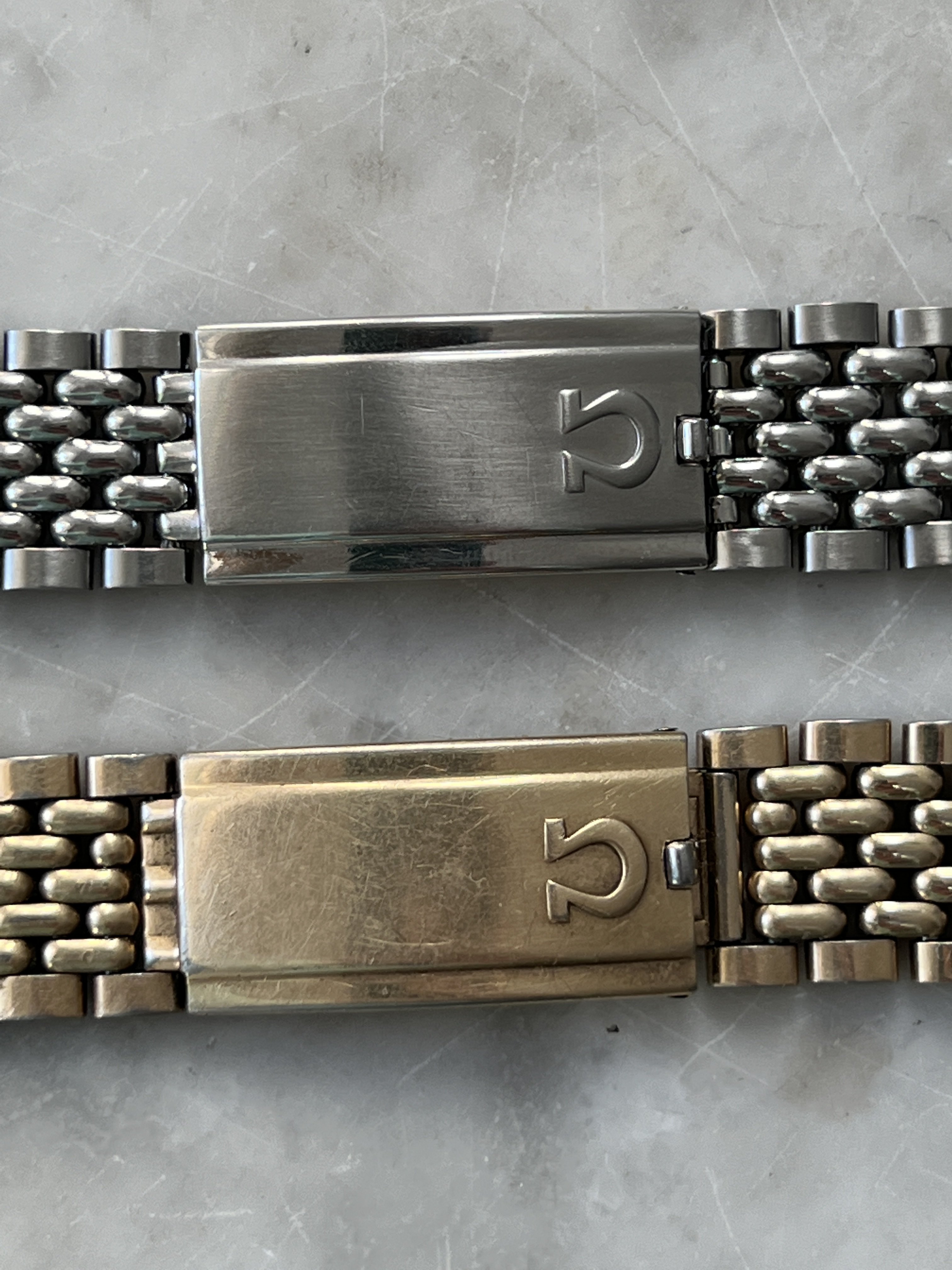

I ended up not buying it, but here are a few other photos. Everything else looked good to me.
16,305
45,025
Not at all.
The unmarked (number stamp) ones tend to go for less becuase people think they may be fake. They can be a bargain.
