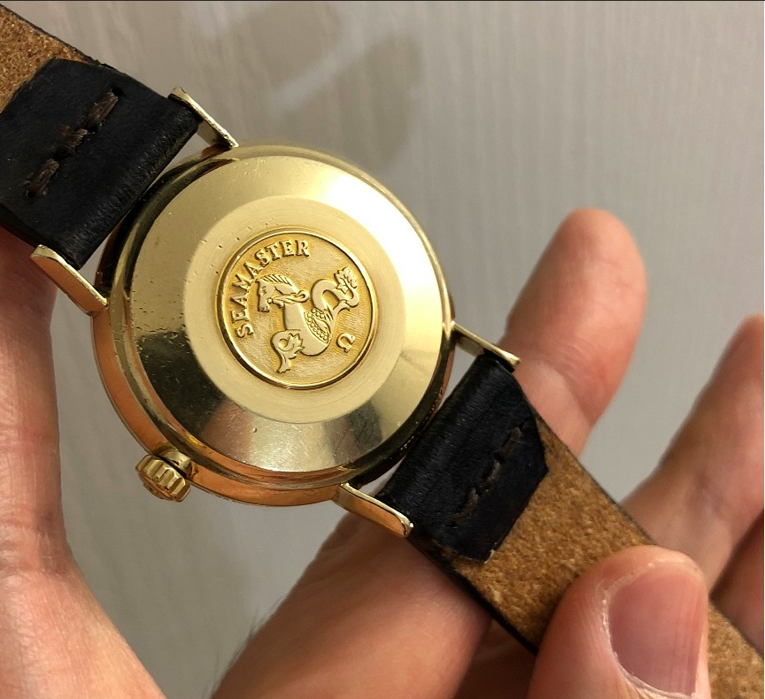

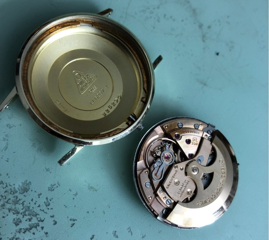

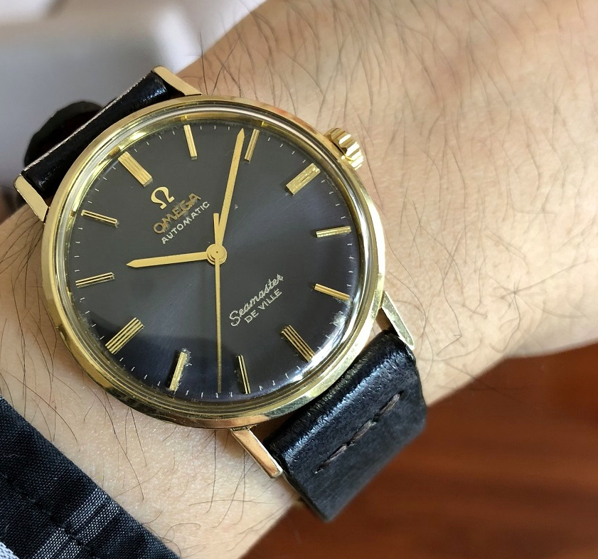

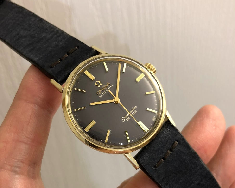

Hi guys,
I would appreciate your advice/feedback for this watch that I found. In my opinion, it's all original except strap and buckle
Here a some characteristics :
Circa: 1966
Model: Seamaster De Ville
Caliber: 550
Movement serial #: 24198908
Jewel count: 17 jewels
Movement type: Automatic wind
Case model: LL 6287-1 (335299)
Case material: 14k Gold filled
Case gasket: Does not take a gasket
Crystal: Acyrlic New crystal
Crown: Signed
Case Diameter excluding crown: 34mm
Case lenght lug tip to lug tip: 40.5mm
Dial: Factory original finish
Hand type: Index (original)
Thanks a lot in advance for your input

No, don't buy it. It's a totally overpriced, redialed watch.
Thanks for the advice! Tough to find a good one at present.

Whenever you see a "good" looking watch from South Corea, be precautious. South Corea is one of the cradles of redials of watches from the 1960s and 1970s.

Is it the "automatic" in lower case that tells you it's wrong?

If the text on a black dial is white, it's most likely shite.

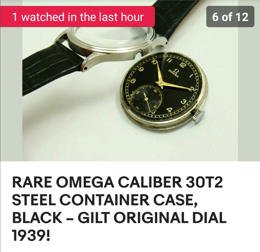

This one claims to be original dial, no refurbishment.
Yes but I think with your enthusiasm you maybe getting slightly off track, the OP is looking for a black dialled Seamaster from the 60's or70's.

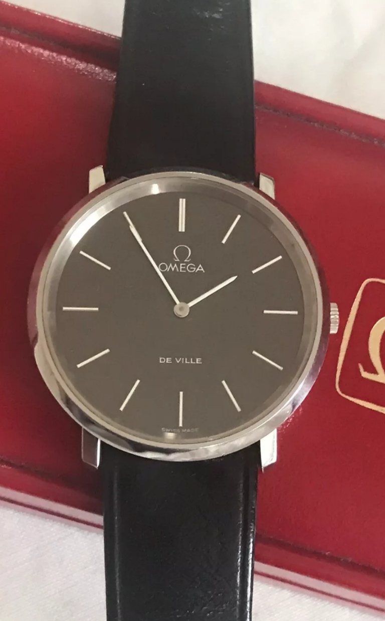

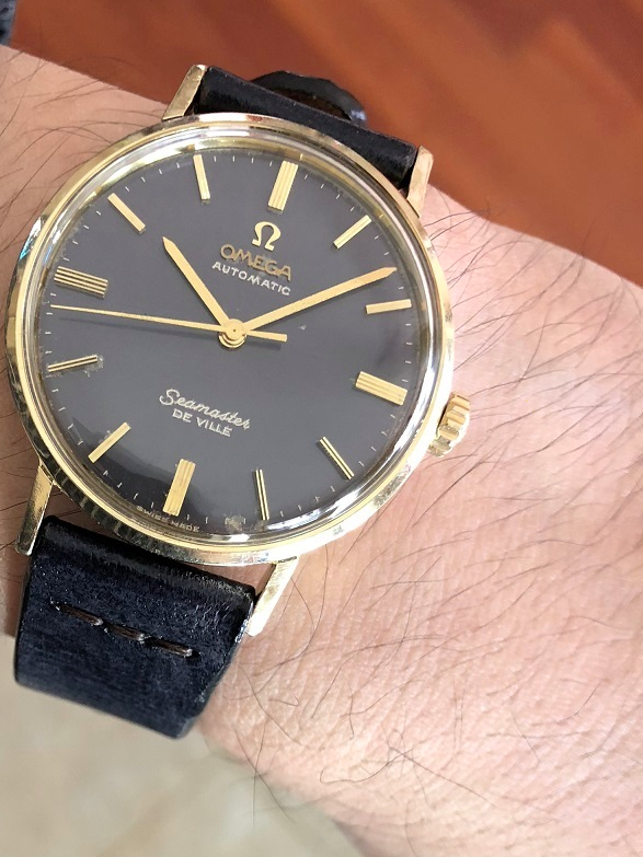

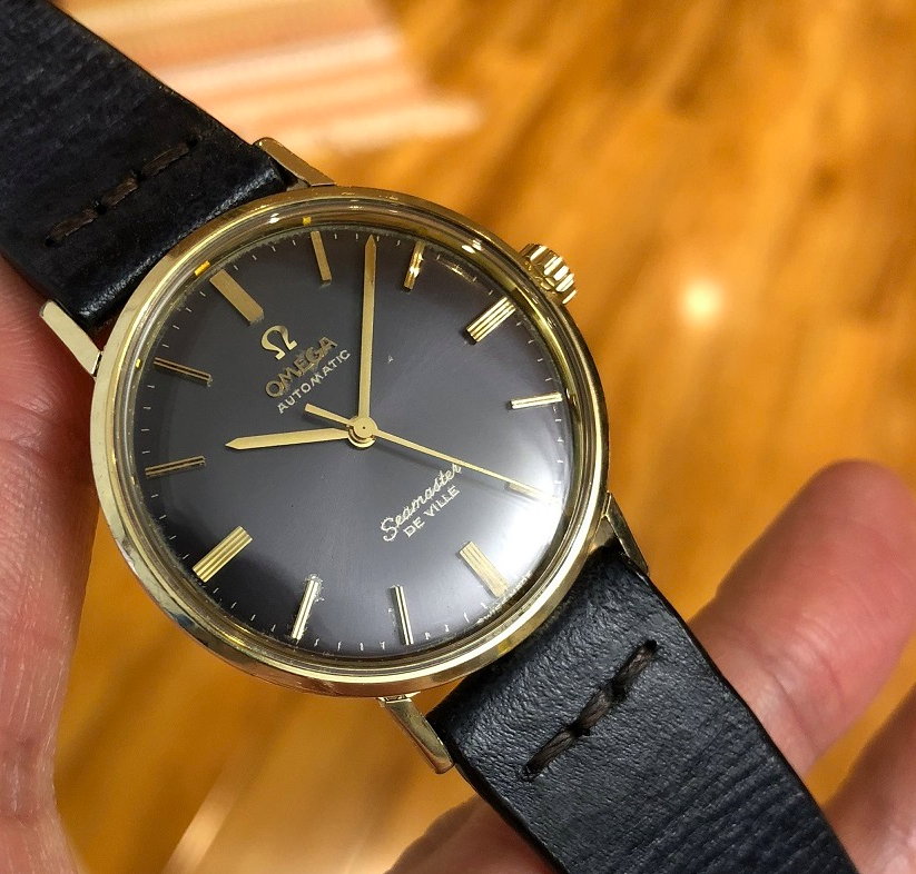

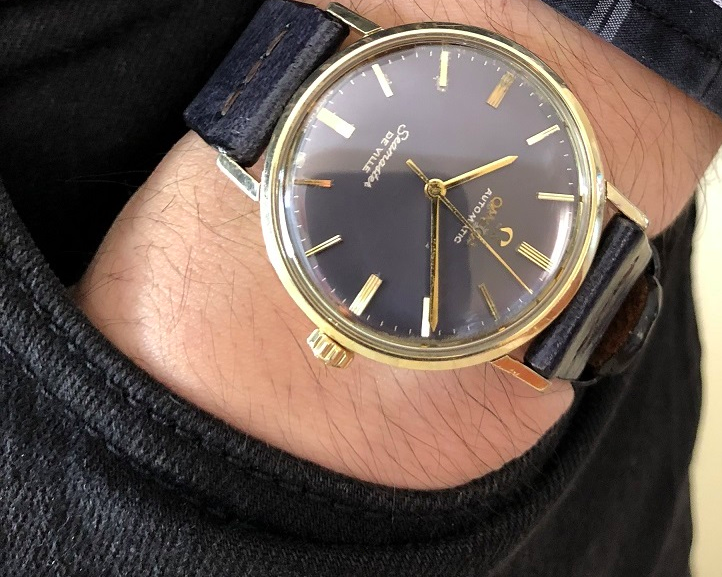

A lot of original black dialed 60's dress Seamasters will have black gloss dials with silver or gold gilt text. This is what makes them desirable in the first place and why they are often re-dialed. They are pretty hard to find in good original condition, and by good I mean with a perfect and damage free glossiness to the dial.
Be skeptical/suspicious if the one you are looking at is missing either of these attributes.
A good proportion of the dreadful 60's dress Seamaster black re-dials that I see around have the wrong finish to the dial ( matt or not glossy enough ) and also white text. These are easy tells and should raise warning signs. I reckon at least 95% of EBay watches in this category are re-dials so watch out!
Here a few original black dialed 60's Seamasters, all glossy and gilt.
Love this and I am also looking for a black dial for some time now. Out of interest, how did you find out / test that your dials were originals and no redials?
