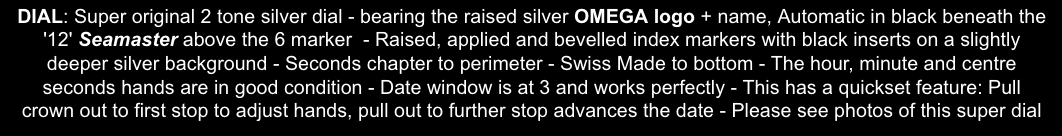

36mm is a decent size for the 1960s, but not really what would be called jumbo or oversized. Overall the watch is not a desirable vintage watch because of the poorly repainted dial and polished lugs (especially the top surface where the original edge has been rounded over. As mentioned above, this reference did not have sharp edges on the sides of the lugs). So the watch has been badly "restored" in a way that is not honest to the original. Just answering because you requested information (and specifically whether the watch was "any good"), but it's your money and you are obviously free to ignore the responses.

@Rickyp The issue with redials and wrong hands is that the dial is no longer in original condition. It may say the name "Omega," but that script wasn't designed by Omega, the lacquer was never sprayed down by Omega, and the case no longer has the dimensions as originally machined by Omega. The replacement hands may not even be Omega manufacture. Sure, the watch may be polished and shiny, and you may like that, but it was likely originally polished and brushed, with sharp case edges that made the watch's features distinct and unique. Take a look at the AP Royal Oak - if all those brushed and faceted surfaces were overlaid with a polished finish, and the edges softened, the watch wouldn't look like an AP Royal Oak. If the dial were redone and the hands changed, the watch would no longer have the identity manifested by those who designed it. Yet when a watch's elements are correct, it is truly special. When you see such an example, you will know what I'm talking about. I'm sure a forum member can post photos of an imacculate, unpolished connie or seamaster. I think it's possible that you simply haven't seen such a pristine example before, as they're so pristine that they'd almost definitely stand out in your memory.

If any of this discussion has changed your mind in the least, the seller claiming that the dial is original is absolutely untrue and would be grounds to cancel the sale.
