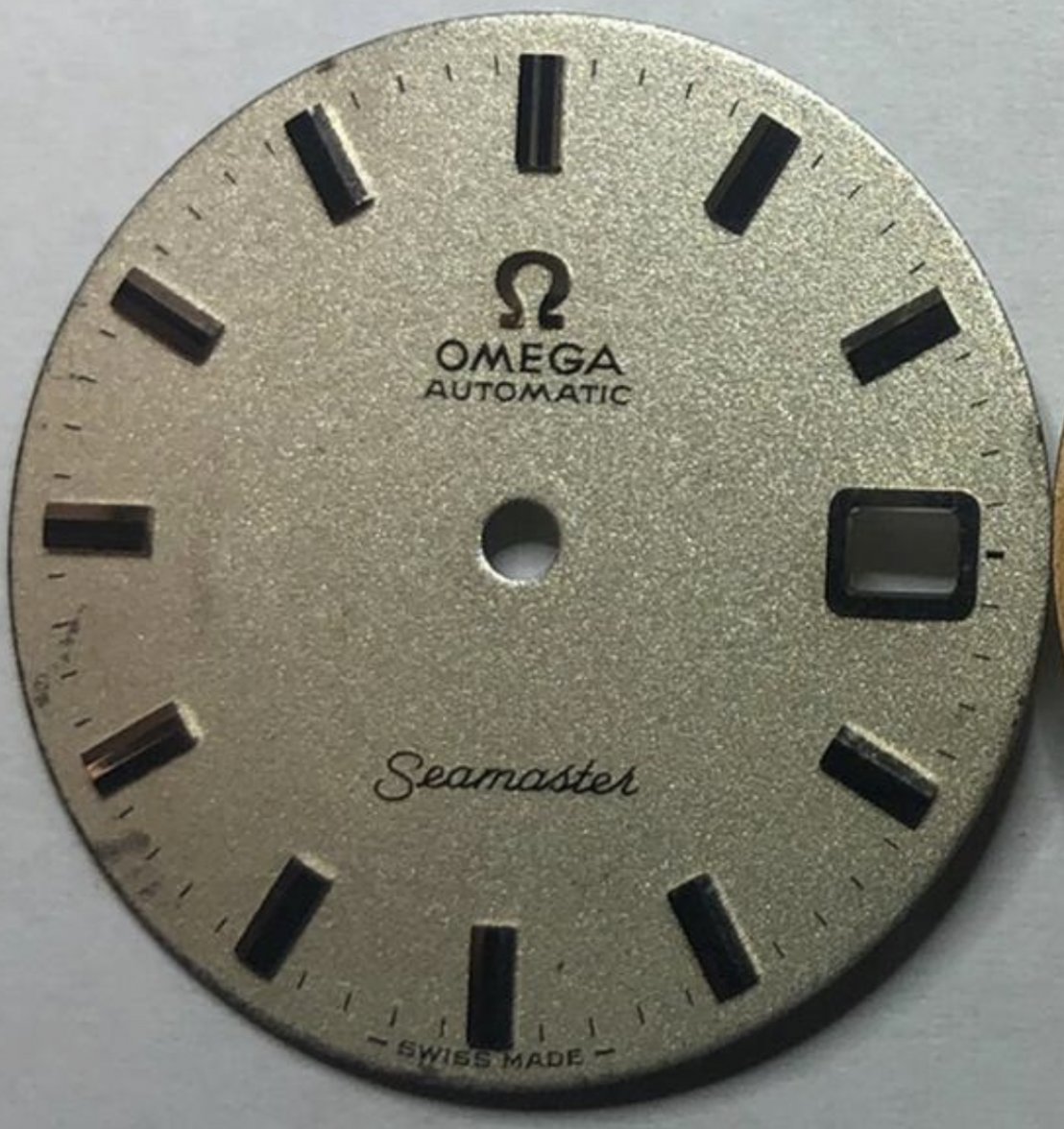

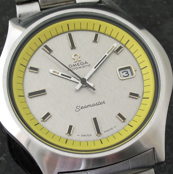

Thanks - Watch currently has this (incorrect dial):
It should have this version instead:
30,289
78,178
No, that dial is not shown as being available any longer.
