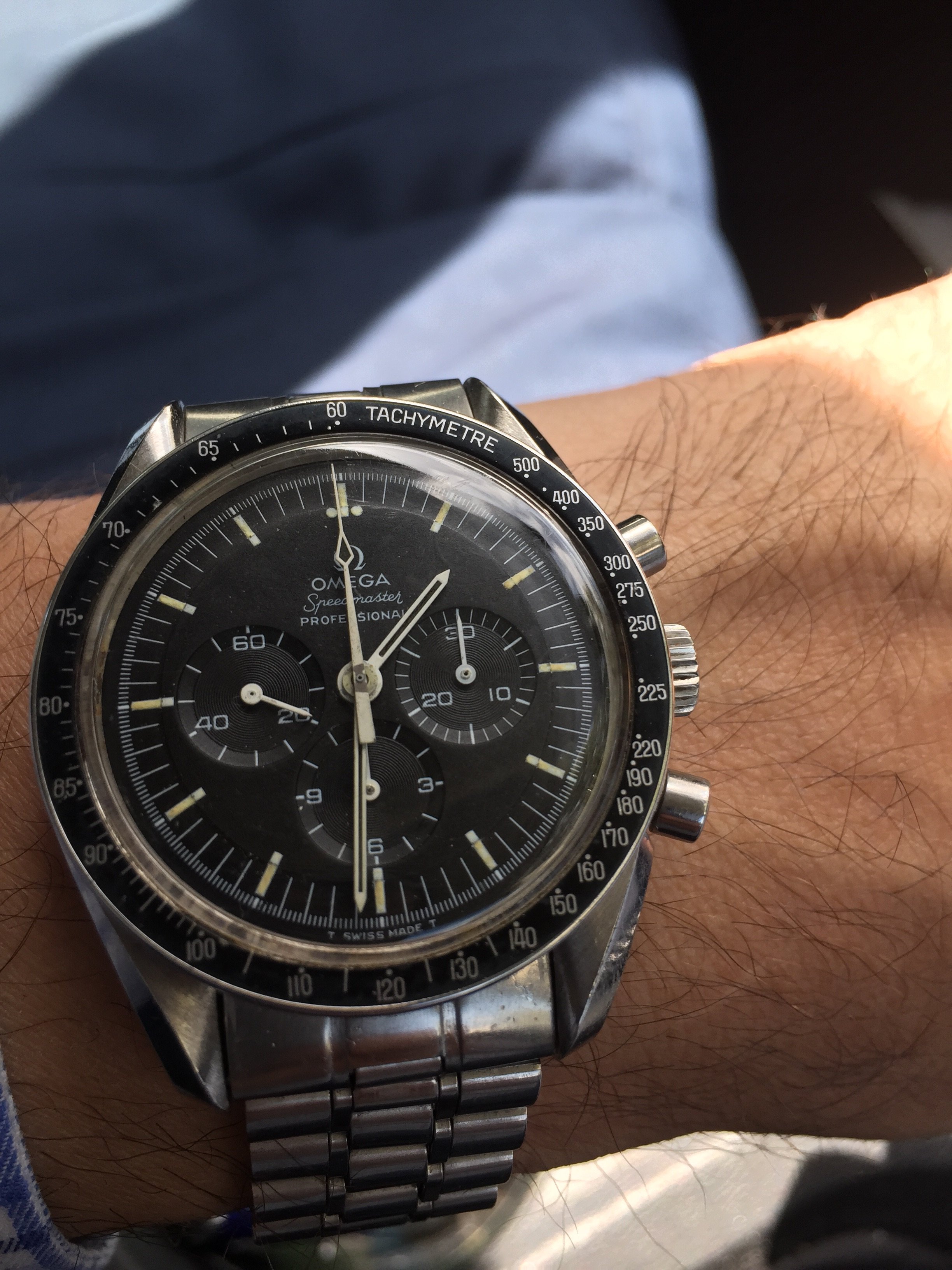

Hi Guys
Is this what they mean by patina?
This is my 69 Speedy
Thanks

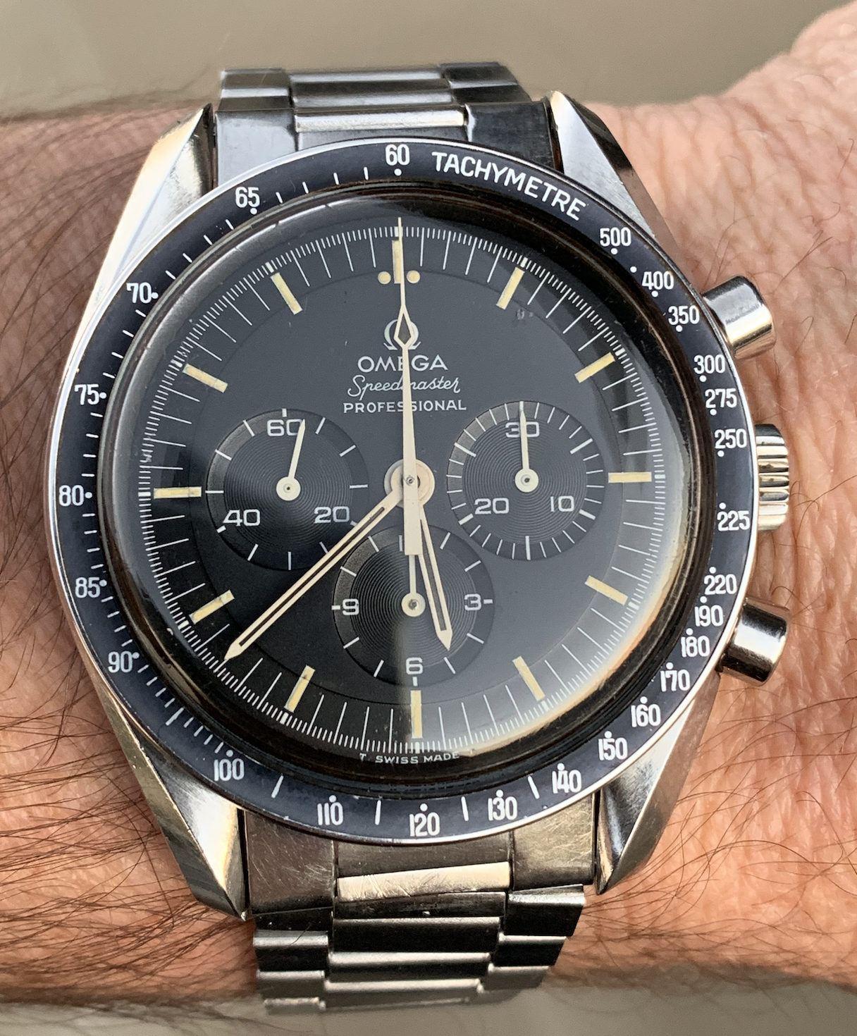

Thought i might send a pic of mine for reference. I'm in South Africa, so this could confirm the story that they were shipped here in '69.
