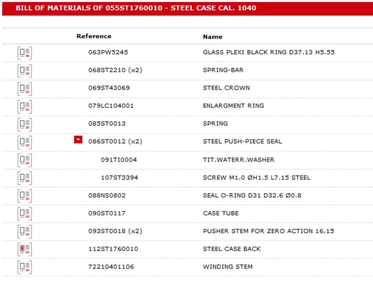

Hi there,
I have a few questions relating to an Omega 176.010 or Tissot Navigator Yachting… do they have a separate outer steel bezel that is detachable from the main case? If so are these still available? And what diameter is the outer steel bezel on a 176.010?
Thanks Andy

I see nothing to indicate that there is a separate bezel available.
Thanks for the response Archer. Is that then to say that it’s a one piece case? Or that it wasn’t available as a single item, only a complete case?
Thanks Andy
I think the middle case is one piece, like the 176.007 case.
Nothing shows up in the BOM as Al noted.
Thanks Andy
It's a regular case with the main case frame and case back, but with no separate bezel.

Thanks for clearing that up Jim and Archer. Much appreciated.
Cheers Andy
