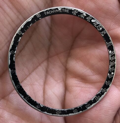

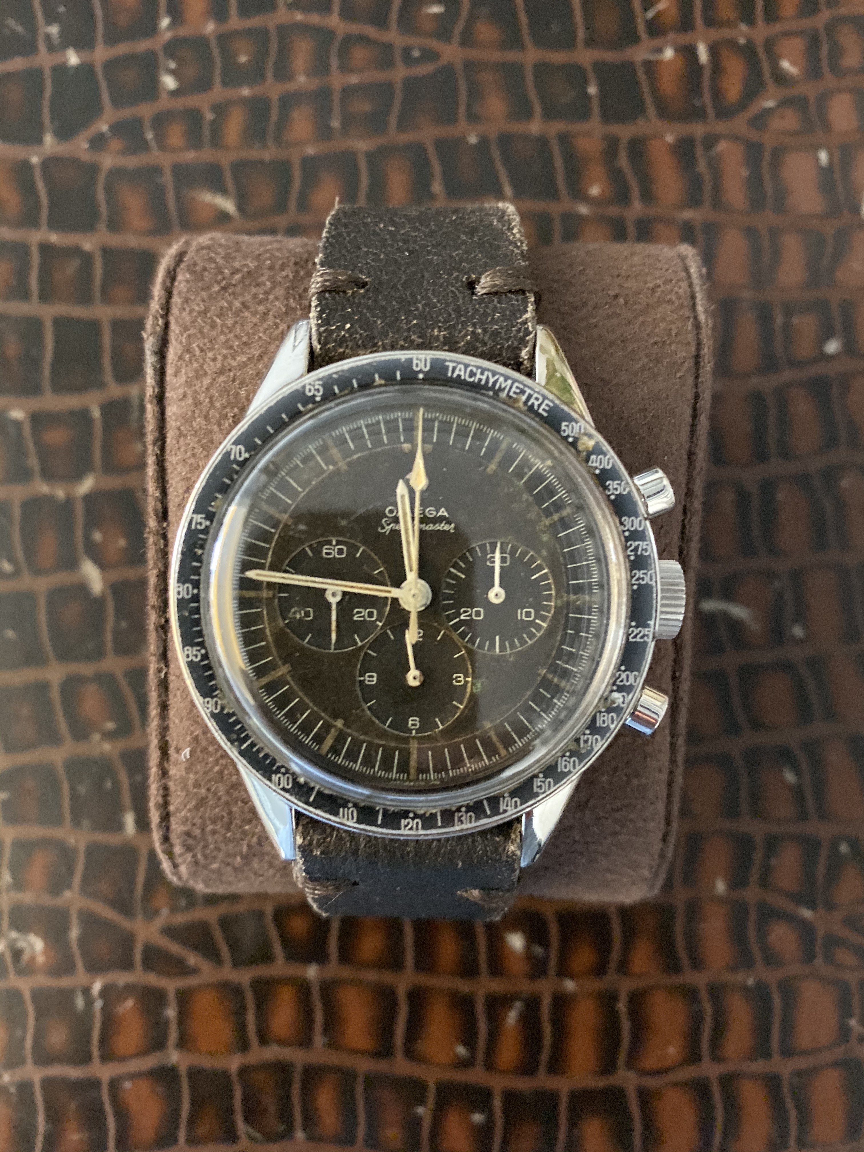

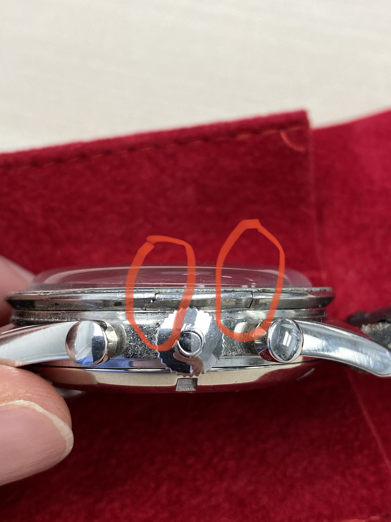

Hi all,
I'm new to this forum and hoping to tap into any expertise out there to help with a bezel issue I've come across with regards to a 105.003-65 that I recently acquired. The watch has an amazing chocolate patina and the DON bezel is a little beat up but all in all has aged nicely too. However, once or twice, unexpectedly, the bezel insert has falled out of the bezel. Most of the time it stays put fine but obviously I was concerned and asked a watch repair expert I met here in Hong Kong where I live. He noted that the bezel had two cracks on it that indicated it might not be holding the insert well, and recommended I replace the bezel.
Is it possible to acquire a replacement bezel that doesn't cost and arm and a leg if you only need the bezel, but not the insert? Alternatively, can the bezel itself be repaired?
I'd very much appreciate any insights to figure out my next steps. Thank you!

pretty sure thats a later bezel DNN
+1
I wouldn’t spend time fixing this bezel. It is incorrect for the reference. I’m sure you could find a suitable DON replacement for a bit more than the money you would throw at the current bezel repair.
2,318
5,713
The metal bezel is shot and unrepairable unfortunately.
Your cheapest way of going about it is buying a current service bezel, and finding a very skilled (and patient) watchmaker who can remove the insert from the newer bezel and implant the DNN insert into it.
Once said and done, you'll still have an incorrect DNN bezel for your watch.
If you want it all correct, you'll have to pony up for a DON bezel ($1,000 - $4,500 depending on condition)

I wouldn't worry too much about preserving your existing bezel; the value is negligible. Glue it in with some removable adhesive if you're really concerned and use it until you find something better. As you probably know, the inserts are not really meant to be exchangeable.

I wonder how the bezel holds on - do the cracks not go through?
