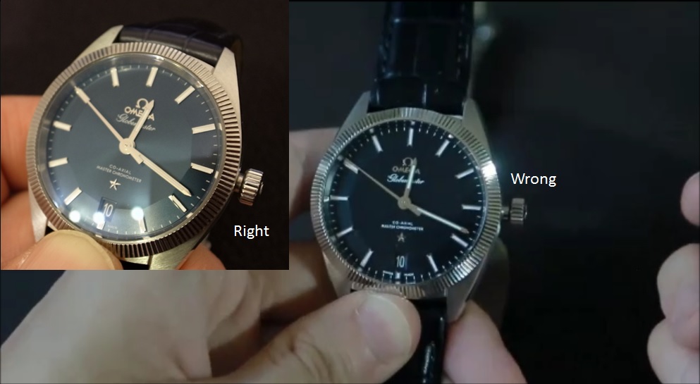

Not convincing at all. Anyone that's seen the kit that new Omegas come with won't be fooled for even a microsecond.
We'll just leave it with this: Omega's oscillating weights aren't that loose, and the accessories look like they're from the 90s, not 2016. Also, where's the Master Chronometer card? [emoji6]

I agree with the other posts that this is a poor replica attempt. Even someone with poor vision should not be fooled by this one, as least if they have a minimum knowledge of how the watch should function: crown in position two you have a quick date set instead of the jumping hour increment🤦 and you can't even hack the seconds in position three to set the minutes hand😲
Well spotted! But there are quite a few more mistakes in there.

Here is my list of observations (you might want to play that Depeche Mode tune in the background now):-

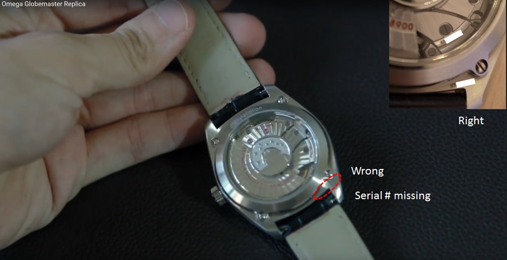

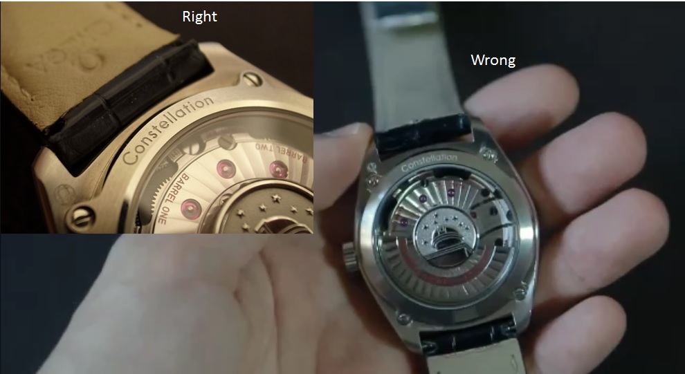

1) Missing serial number on rear of case, normally located just above lower right lug.

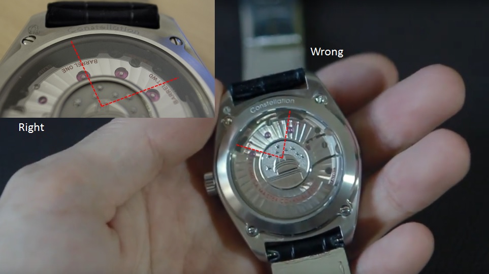

2) “Constellation” text is too high on the rear case back ring. In the fake it is approximately in the middle. On a real GM the top of the last “n” will be approximately in the middle of this ring, i.e. the main text is below the centre line.
3) Screw-down crown. This is funny, as this was a feature that I actually wanted on my GM, but no, a real GM does not have a screw-down crown.
4) This fake does not have a quickset hour hand. At the second pulled out crown position we can see the presenter counter-clockwise rotating the crown to quickset the date. Date quickset on the GM is via hour quickset. There is no independent date quickset on the real deal. At 2:27 we see the crown fully pulled for time adjustment, but the movement keeps running; this fake does not hack the seconds.

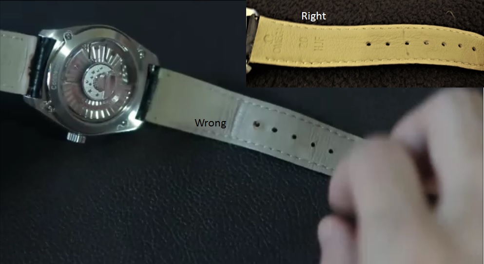

5) Take a close look at that movement (at time 3:00 into the video). The centre line of the rotor approximately bisects the caseback screws at the 11 and 5 o’clock positions. With the rotor in this orientation you can only see one of the two barrels in the fake. On a real GM you will be able to clearly see both barrels. Also at this rotor orientation you can see what looks like the movement serial number at the 4 o’clock position. On a real GM the movement serial number will be almost completely covered; you might just be able to see the last digit of the serial number. This fake has at best an incorrectly oriented movement w.r.t. the case, but there are other points of difference too.

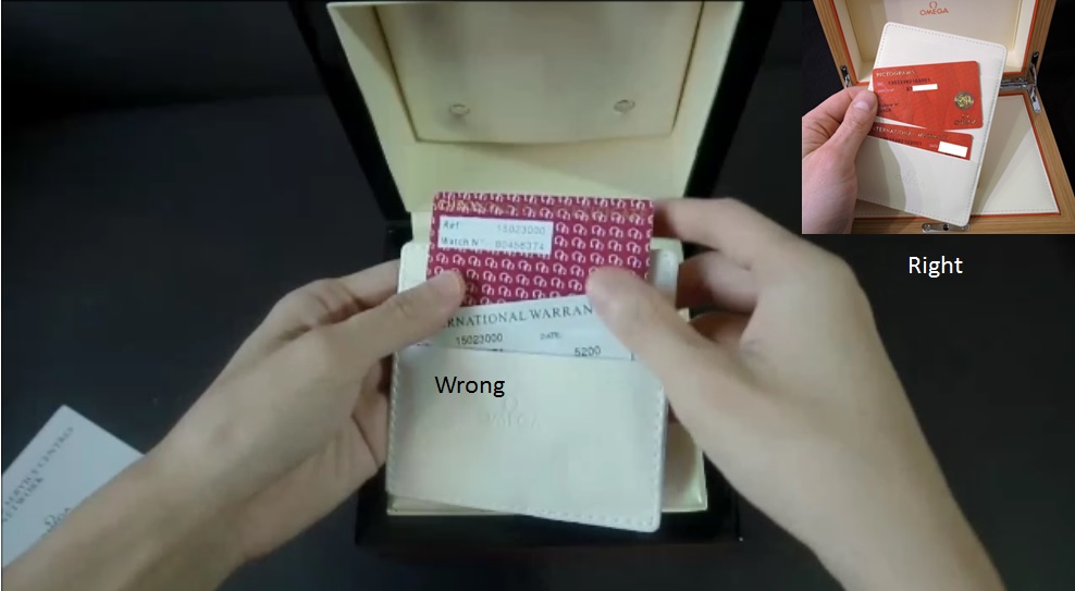

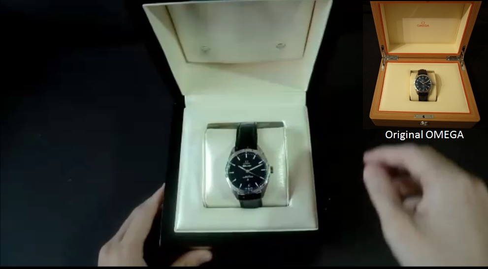

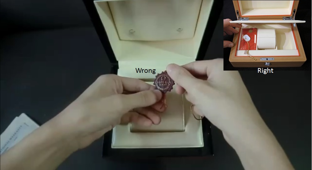

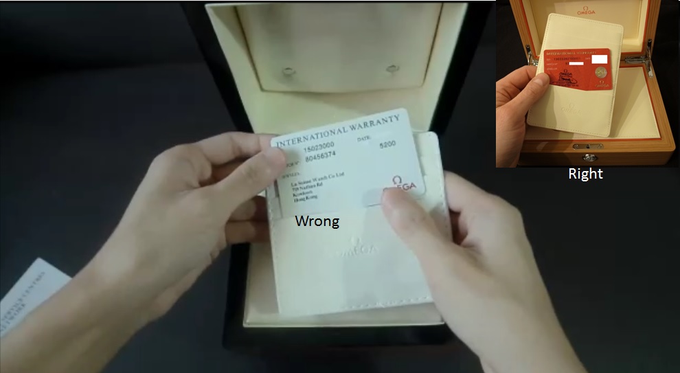

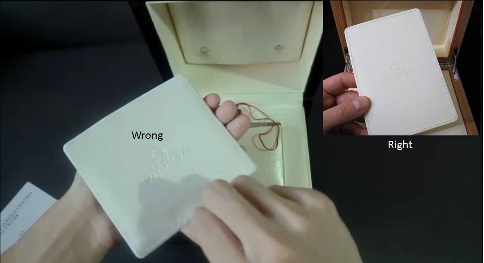

6) Wrong warranty card, missing METAS card, wrong pictogram card, wrong box….
7) Correct text missing from the rear of the leather strap (both sides)

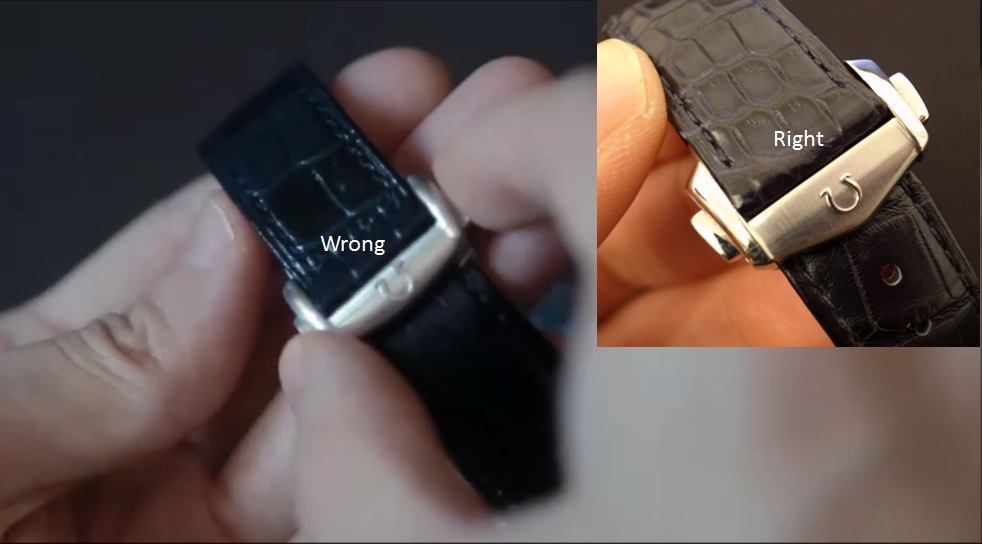

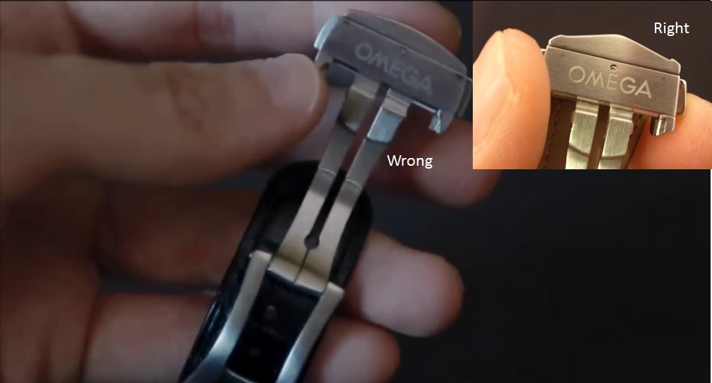

8) “OMEGA” text on inside of deployant clasp is too fat, with too small a gap between the characters. Logo on outside of clasp is also wrong.
9) The serial number on the card is wrong. I believe that all Globemasters start with 87xxxxxx. @meganfox17, can confirm this from her GM. The Annual Calendar that I reviewed recently also had an 87xxxxxx serial number.

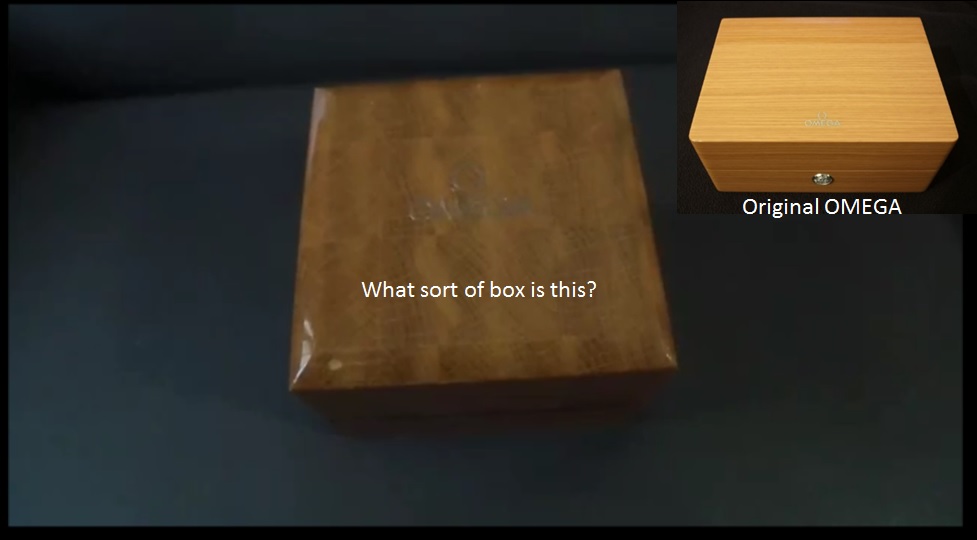

10) as for the box, well
Nice try. FAIL.
