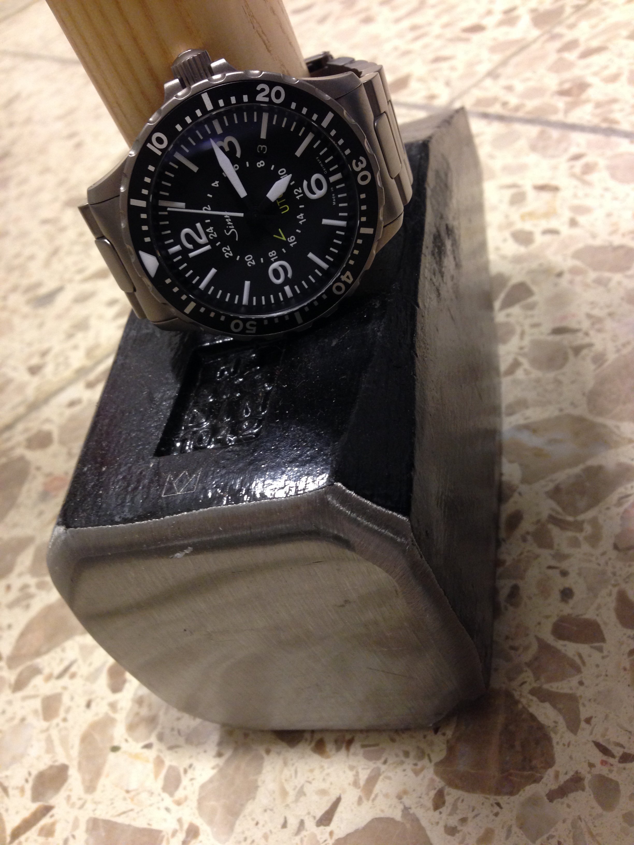

I think I will have to get hold of one of these fakes and post still photos, the fakers video was too easy for OF members.
In the meantime it's off to do some actual paid work so that I can afford my next acquisitions (a high speed camera and a hammer maybe 😉).
