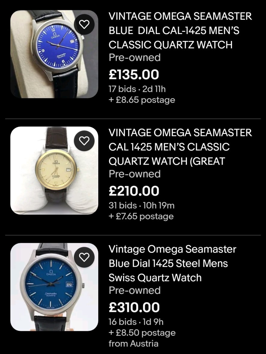

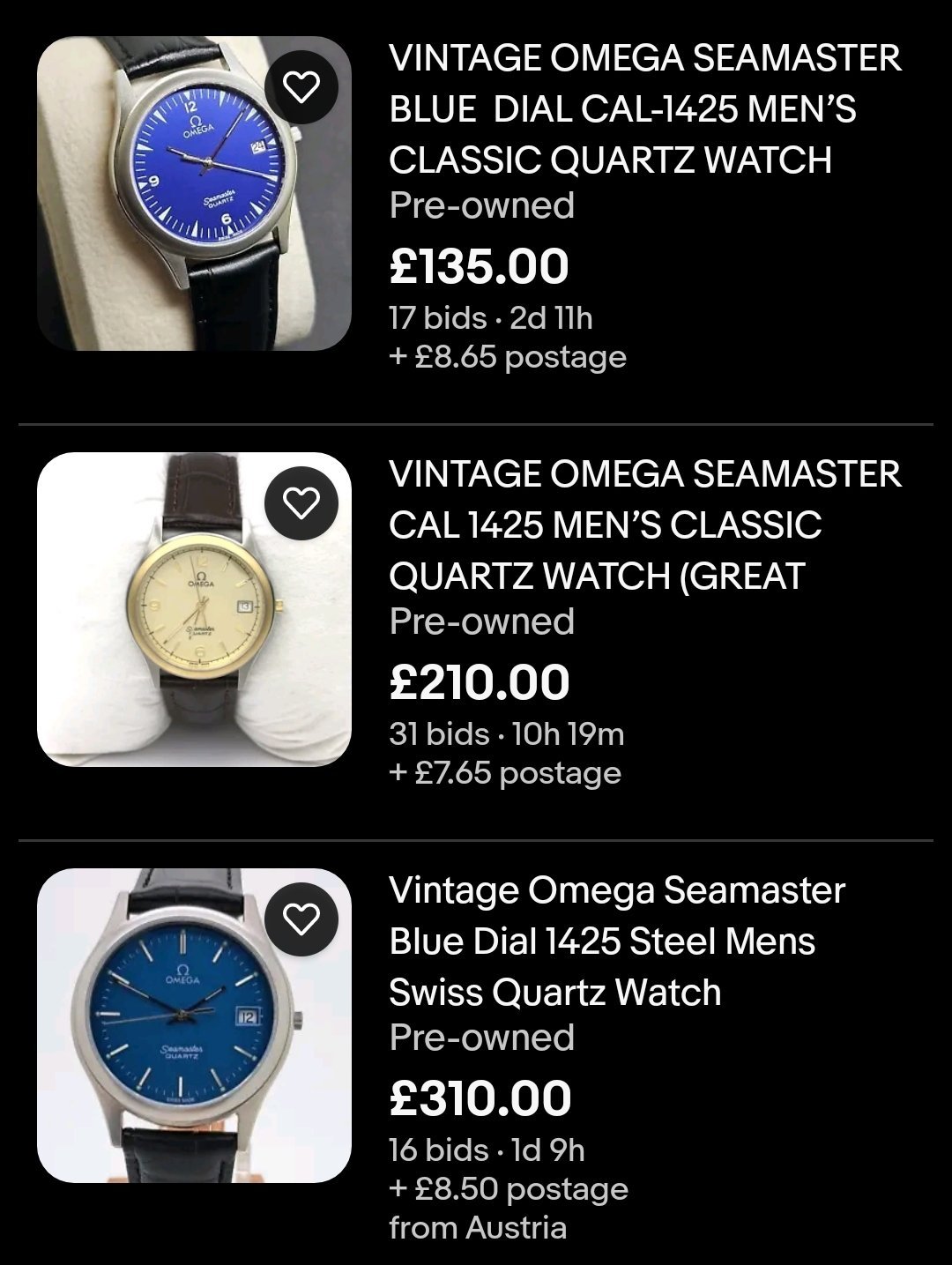

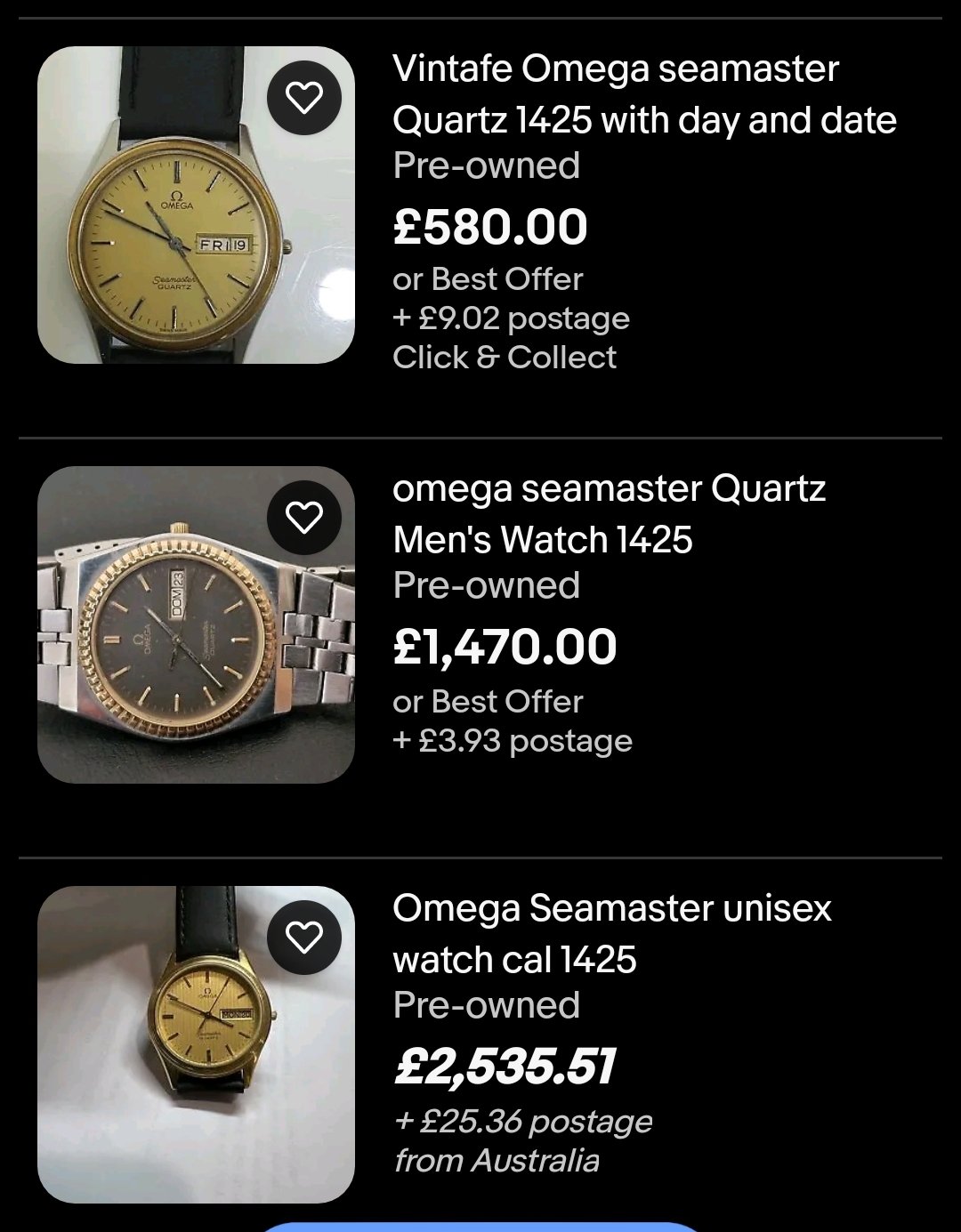

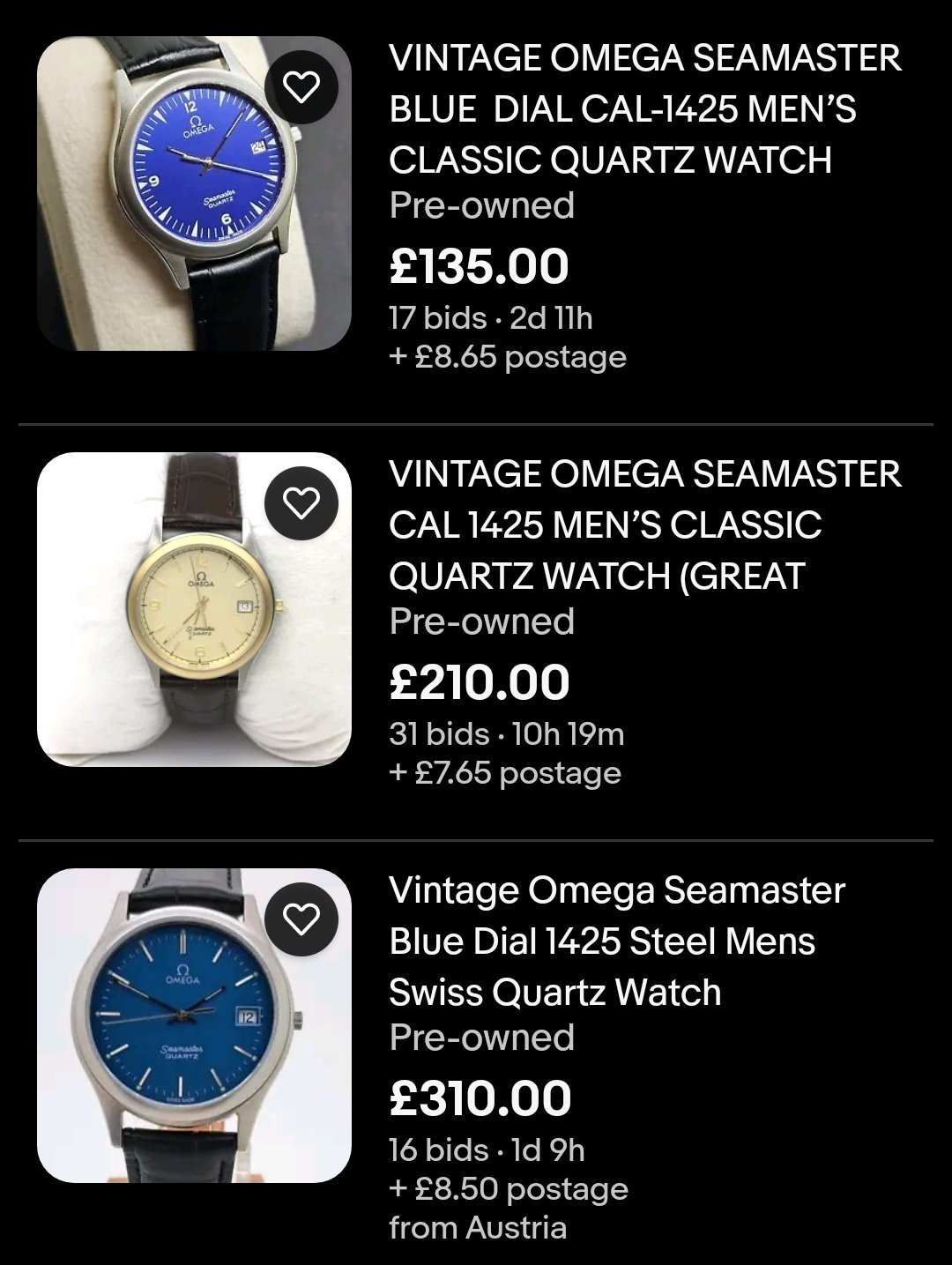

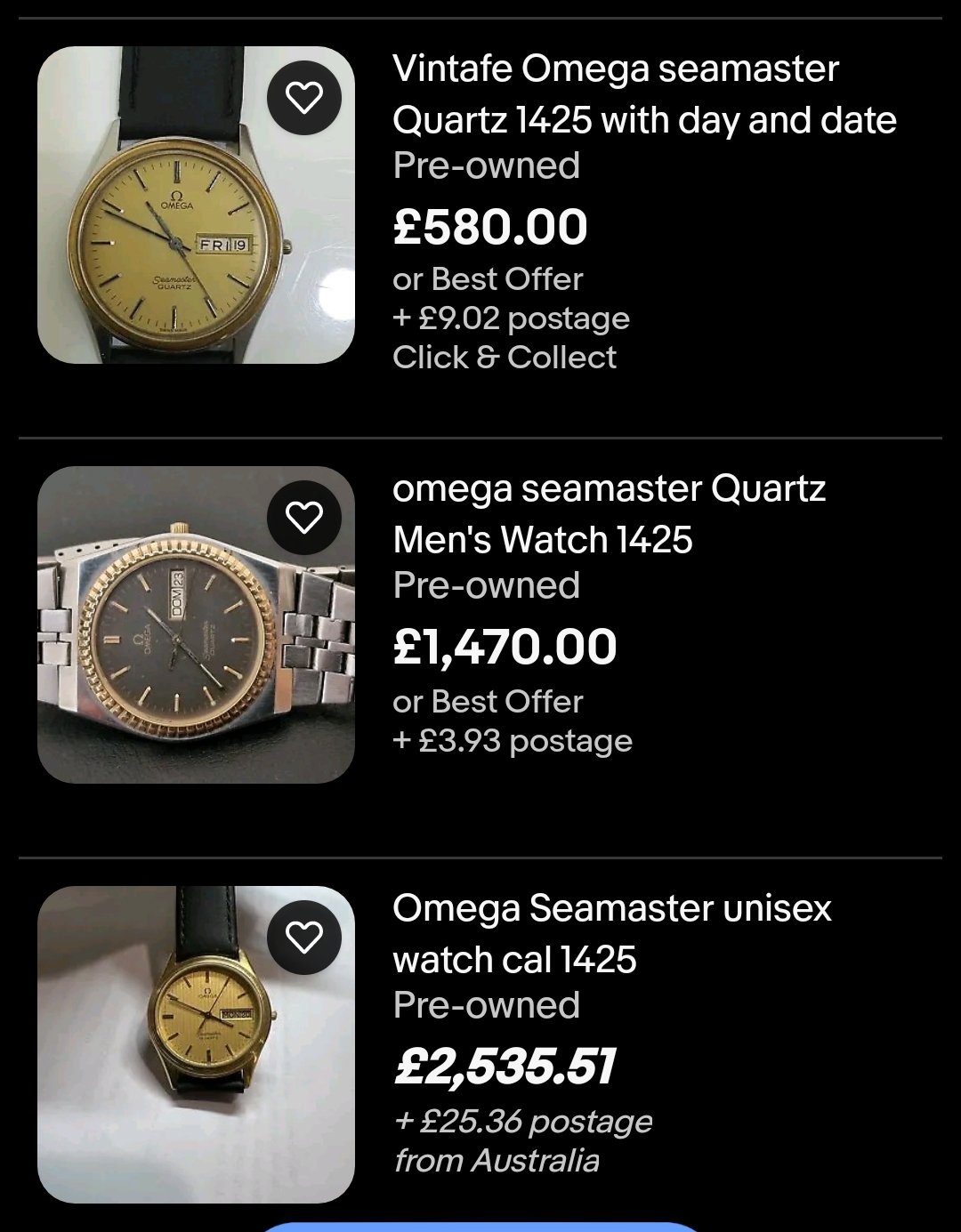

What is confusing me is that the 1425 (I think) should be a day date, but loads of these have date only dials while some have day date. What is going on here? Am I missing something about the movement, or is it common to cover the day display with a date only dial? Examples below of typical listings showing date only and day date.
