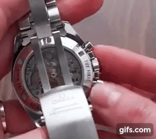

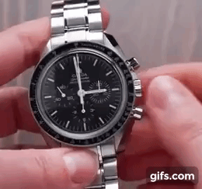

Having recently bought my first Speedmaster Pro, I am finding it a bit difficult to wind because of the crown guards on the side. I have seen some youtube videos showing people winding it various ways, and I would like to know what you folks think is the best way to wind the watch?
a) Traditional way with thumb and index fingers:
b) Dial down with thumb and index fingers:
c) Index finger sliding along the back:
I personally find the index finger along the back method to be easiest for me, but I am wondering if it is placing undue stress on the winding mechanism of the watch?

It appears as though example b) is NOT tightening the main spring at all...so don't do that one that way! You can wind a Speedmaster with the watch inverted like example b) but you turn the crown in the same direction as if the watch was not inverted, like examples a) and c).
I own two watches with Cal. 1861 movements, and interestingly, one is super easy to wind and one is really hard to wind. I sent the one that is hard to wind into Omega while it was still under warranty to have it checked as I was concerned that something may be amiss inside. But everything checked out OK, so now I have calluses on my index finger and thumb from winding that particular watch (which I do once each day).
I can't imagine that winding like example a) or c) would put any more or less stress on the winding mechanism when comparing the two.

+1 this. A Tim Mosso-type who worked at my local OB said to me once on this topic, "...just make sure to release the crown between each clockwise spin...", which would make c) apparently unrecommended, and I don't think b) does anything other than a counter-clockwise spin. And no power drills, please.
I had to take my watch off and look at it as I wound to find out what I really do. Grip is (c) but to move thumb and finger back to their starting positions I do have to release the crown. Been doing it this way for over 50 years (minus the quartz years 🤦 ) with no evident problems. One watch gets wound upside down but that's because it's a Cal. 11 with the crown at 9.

Well I am doing like in a) but I have seen my AD doing it like in c) and it is just faster I think

I've been rocking method C since day 1. No problems.

I use "a" but turn the crown forward then back. I know back does nothing, but it seems smoother for me going back and forth. Just a habit I got into. And always with the watch off my wrist.
