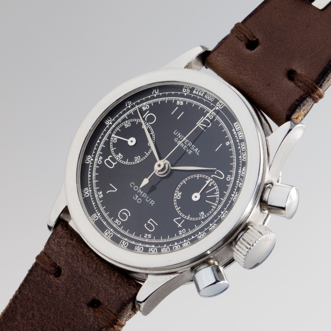

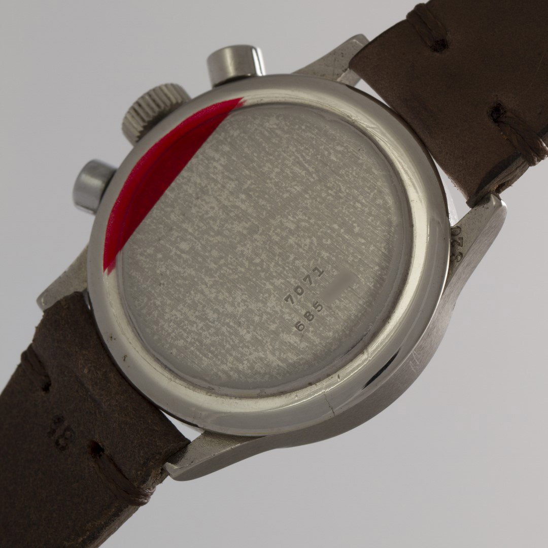

Here is something remarkable. Has anyone seen a UG waterproof case earlier than this?
Ref 7071
Case 685xxx
255
315
I do know of a legit Compax, Ref 7075, with high pressure case (same/similr case as Vetta Ermeticos and Bovet mono-rattrapantes) which dates 1937/1938, hence probably consistent with this serial more or less.
Would be interesting to see the last three digits of the serial to see if they match the three digits engraved under the lug, as this should always be the case with these high pressure cases.

FRANKEN ???

Which one? The one Bernardini had or the one I mentioned? The one I mentioned is not a franken for sure, it is original, just very rare.
The Bernardini one I honestly dont know, that dial rises a few concerns if you ask me, but the case back looks original UG (if you go on their website you see other pictures as well) but to see if it belongs to that case you would need to know the whole serial number to see if the last 3 digits correspond to the ones engraved below the lugs. if they do then I would say that the case is legit. If they don't....well no more to say I guess 😉

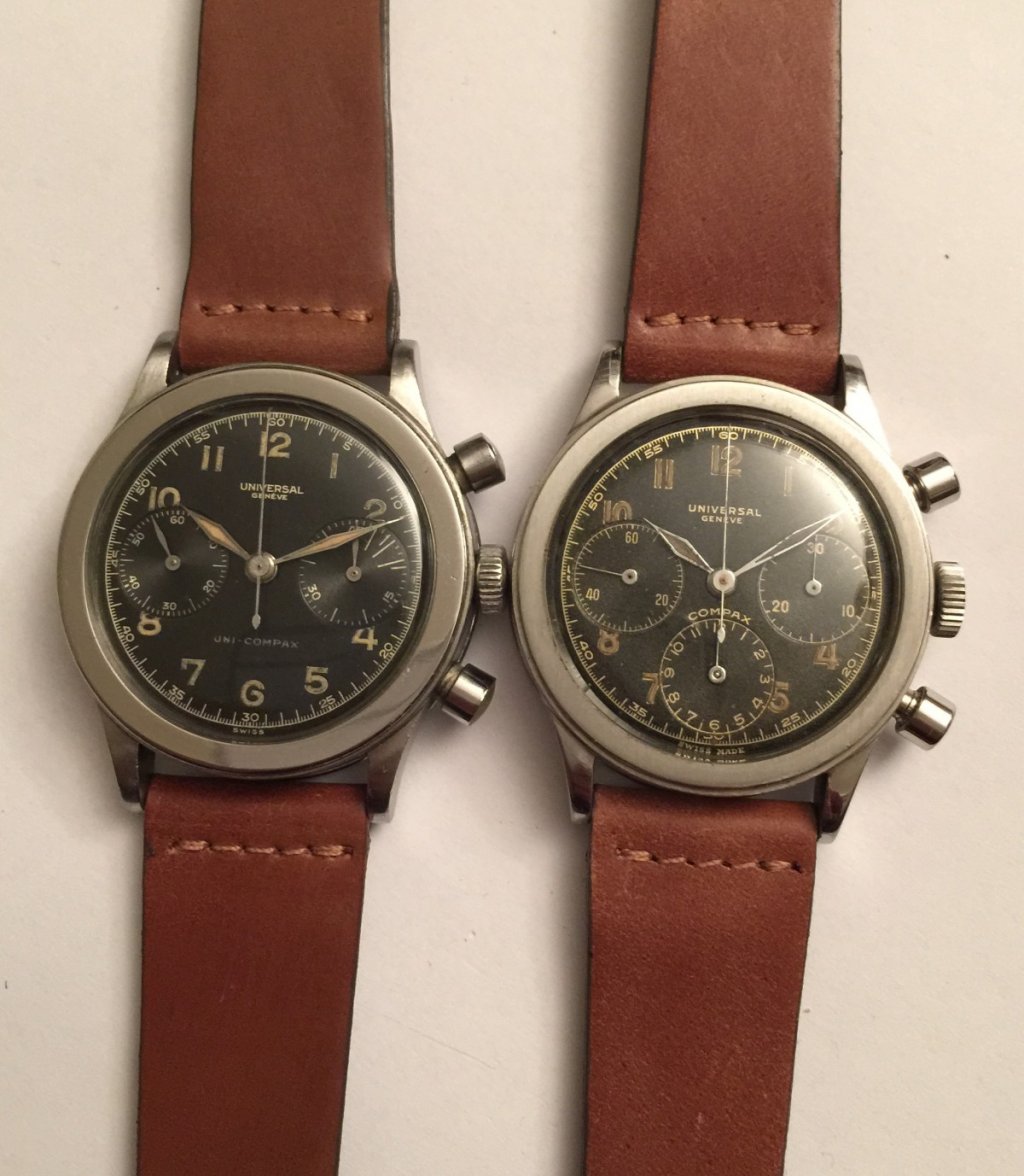

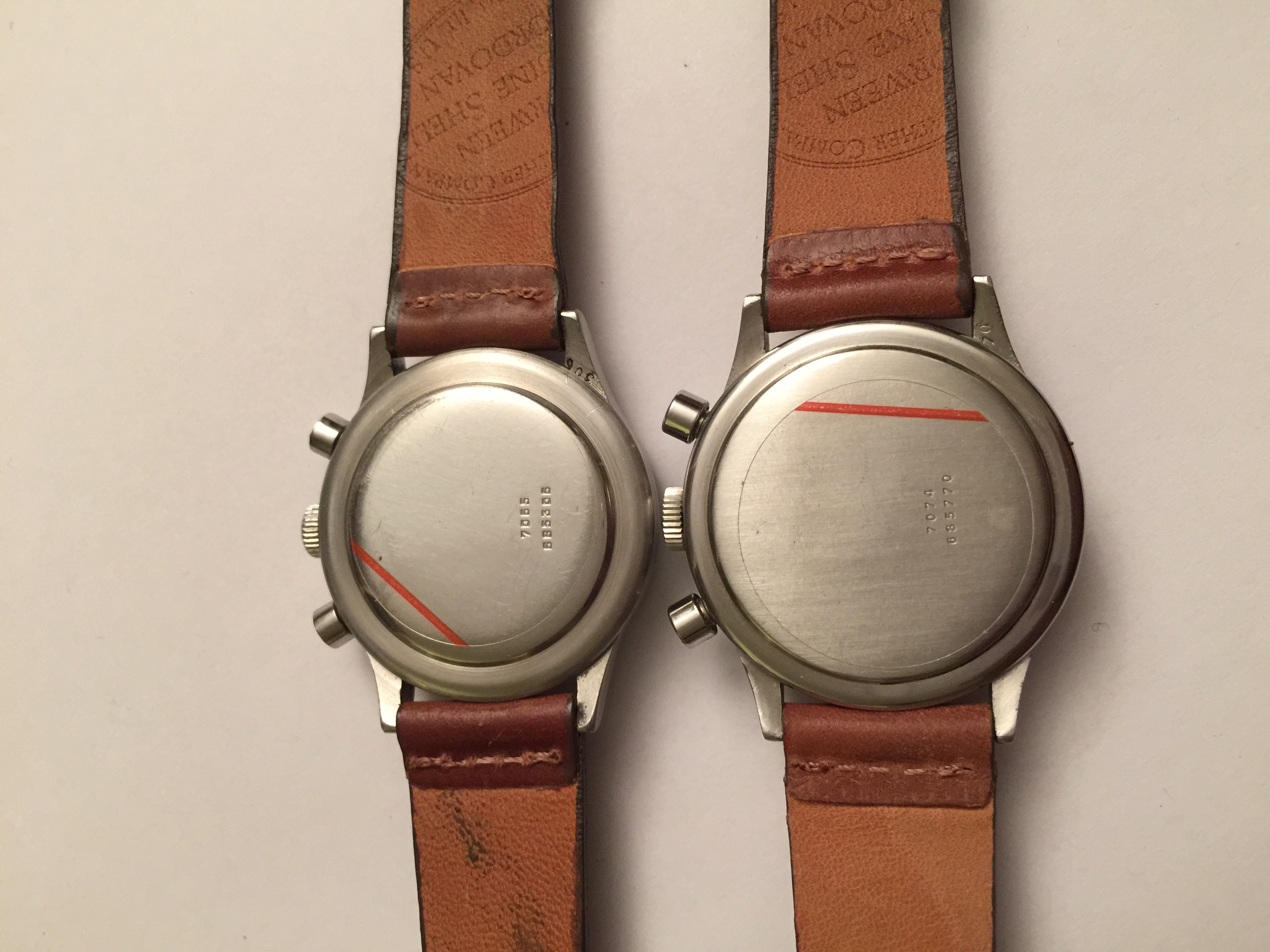

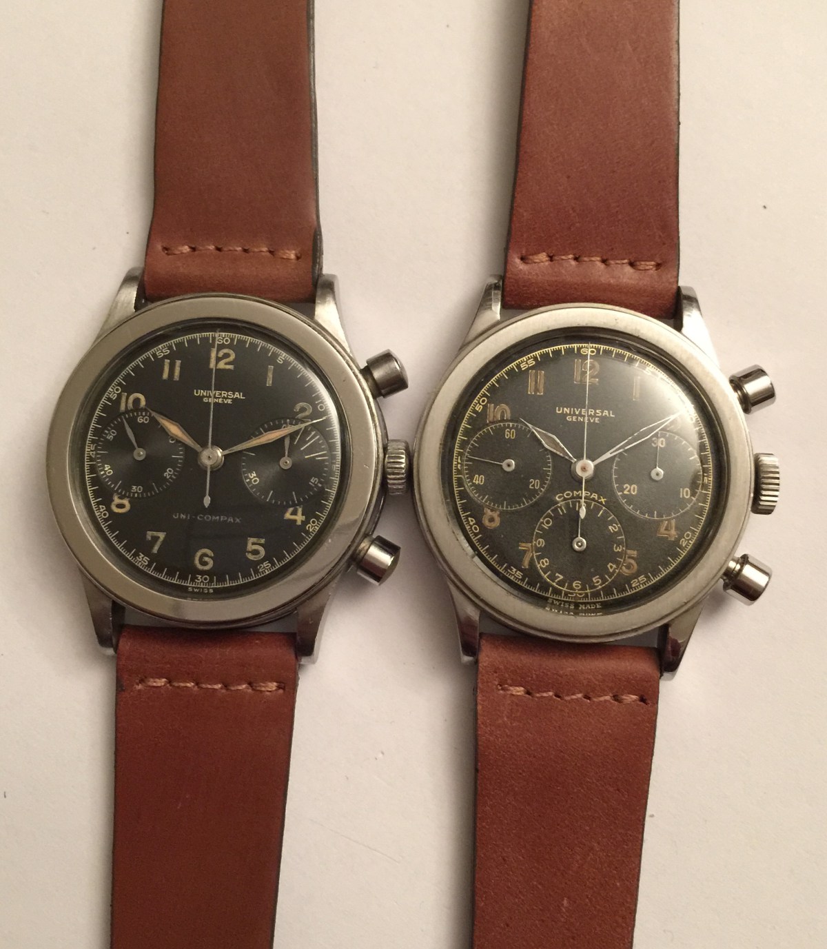

I'm talking the one with the Ref 7075 Uni-Compax, case can't be right ?
255
315
The Ref 7075 I mentioned is a Compax (3 registers), not a Uni-Compax. And it comes in a high pressure case. Why do you think it cannot be right?

Yes, I met Compax, find another example of UG Compax with this same case for comparison, then maybe I'll believe it's not a Franken !

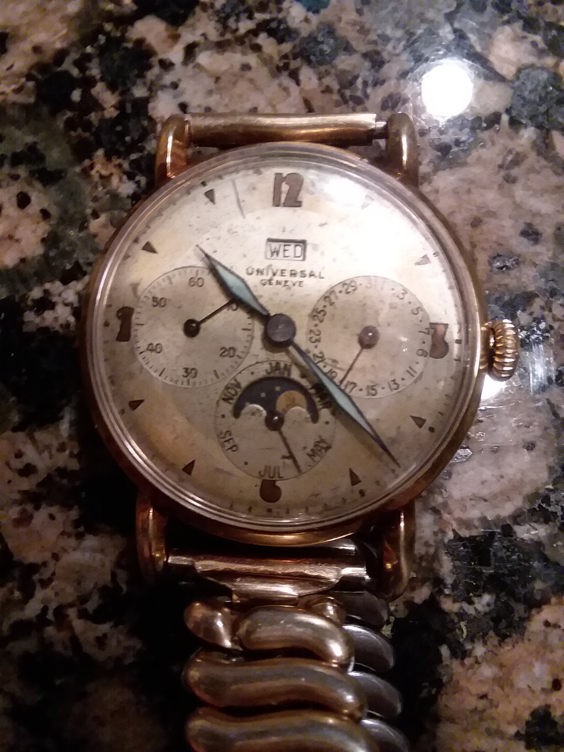

You are confused ! Okay, themouse member, I've collected vintage watches for 40 years, I have a collection of approximately 20 vintage UG pieces. Watch companies like UG made watches for mass production, If this case was really a UG it must have been a prototype. If it were a production piece, on the world wide web you would find other examples. This is one of the ways collectors research authenticity, by trolling the web for countless hours ! If you don't want to be educated by collectors world wide that have big vintage watch collections, and have collected for many years, and researched countless hours on the web, then you are truly confused ! Not sure why you don't want to listen to people with tremendous amounts of knowledge and insights when it comes to vintage watch collecting ? NOT sure what you point is "the mouse" ?
You bring out the fact that the white gold TDM is a redial in our opinion, I have 4 UG TDM in my collection to compare it to, as well as ALL of the images on the web ! There is not a SINGLE example of a UG TDM without the ring in the months register ? If it is ORIGINAL it is the only one I've seen in 40 years that was printed like that !
Also, most of the time in the day of the month register is in red print. The registers for the day and seconds usually have grooves, this Milan example they are SMOOTH, this almost always means REDIAL IMHO ! Also, for the age of this dial, it is TOO clean for a 70 year old dial IMHO ? This is one from my collection, ORIGINAL, this is probably what this dial was supposed to look like ?
That can absolutely be right.

Lou, so you think this case is original to the dial and movement ? Does not look like any Compax case marking I have ever seen by UG ? 7075 ? What about the markings for the Compur 7071 black dial ?
Well, I haven't seen the dial, so I can't say about that but there is nothing implausible about Mlafra' s description. Compaxes have been documented in this reference and serial number range, and the case markings are similar. Here is a 7065 and a 7074 from Ore del Mondo a few years ago.
I do also notice that the UG style of printing is essentially established in these models, and it does NOT include a double ("Railroad") track on the subdials, like the one at Bernardini, so I am pretty skeptical about that dial.
@Mlafra : you will see that the lug numbers match the serial

Thanks Lou, I've never seen this case by UG, awesome to gain knowledge from your posts on these RARE waterproof UG references !
I've trolled the web, where did you find this information and pictures ?

This is where the database comes in handy. These are from early 2015.
