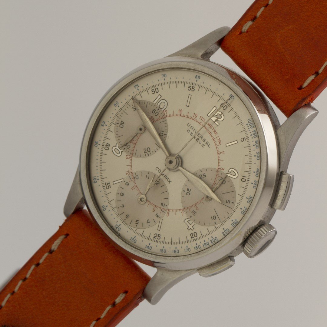

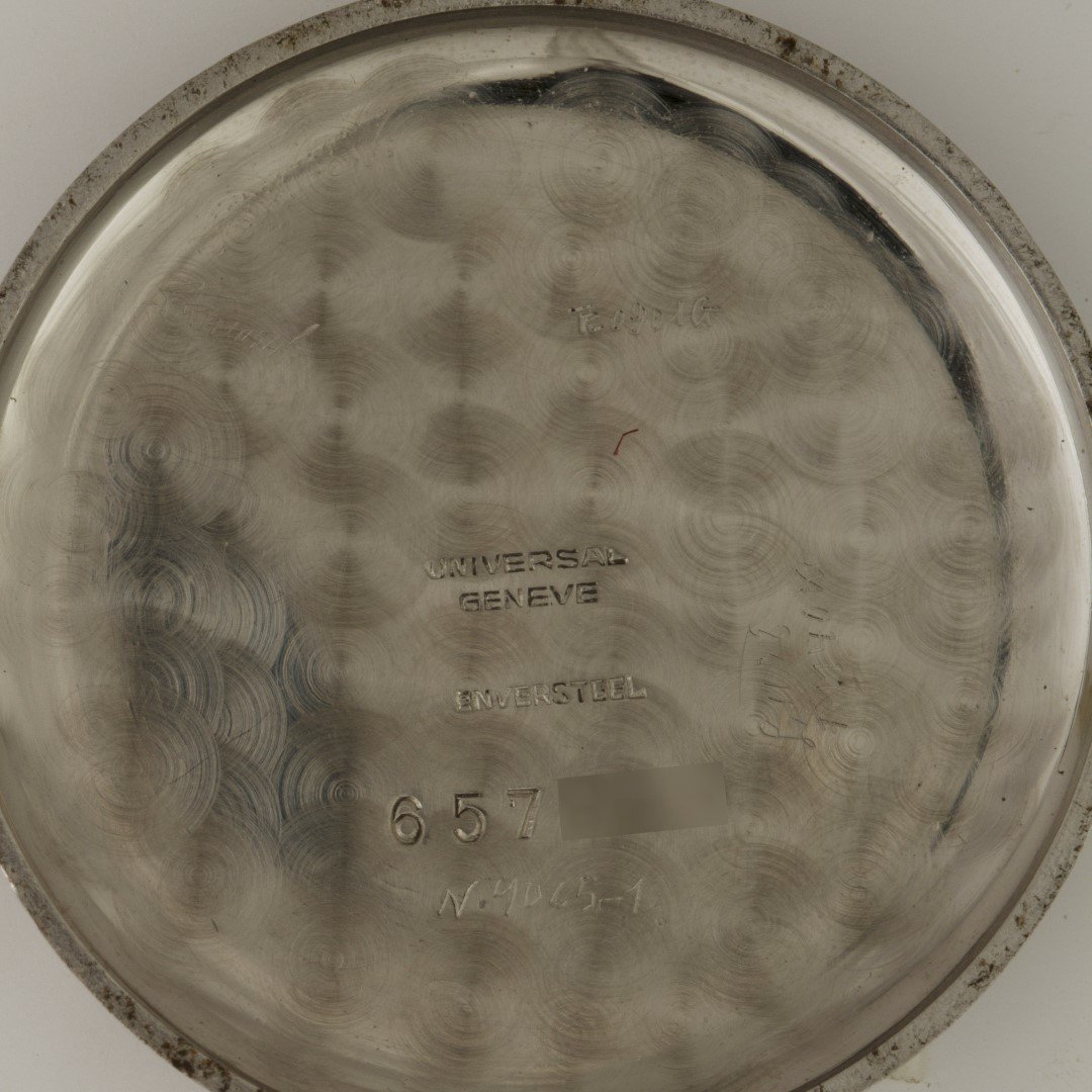

Has anyone ever seen a Compax with this low of a case number? It's a few tens of thousands lower than I have ever seen.
I suspect the dial might be a bit later but I think such a serial number on a Compax is indeed correct and it probably is one of the very first Compax, from 1937/1938. Also those hands and even more subdial hands shape are consistent with UGs around that serial number.
I can say this because I own a UG ConTax (not Compax, the very first Compaxes were actually called Contax and they were the very very first chronos ever with an hour counter ever): Contaxes are very rare but when they do appear they all have low 600k serial numbers, like around 605xxx-620xxx, hence I guess a 657xxx could well makse sense for an early Compax.

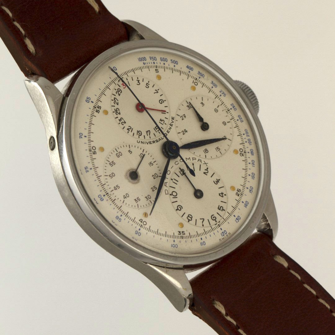

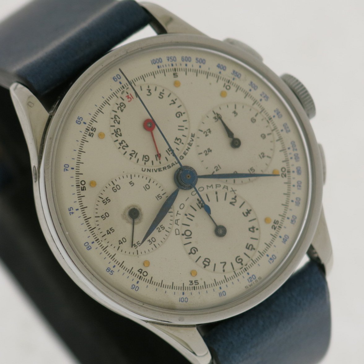

Dato-Compax is the same one they had in May 2016, now EUR 4000 more expensive at EUR 16000. It is also pictured in Sala, p 326. NOte the Portuguese punch mark on the 11 o'clock lug

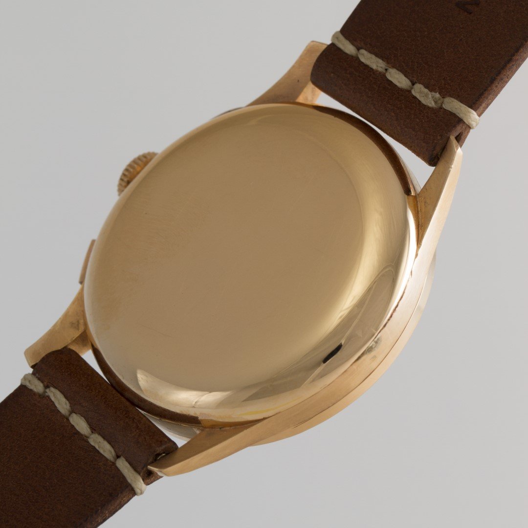

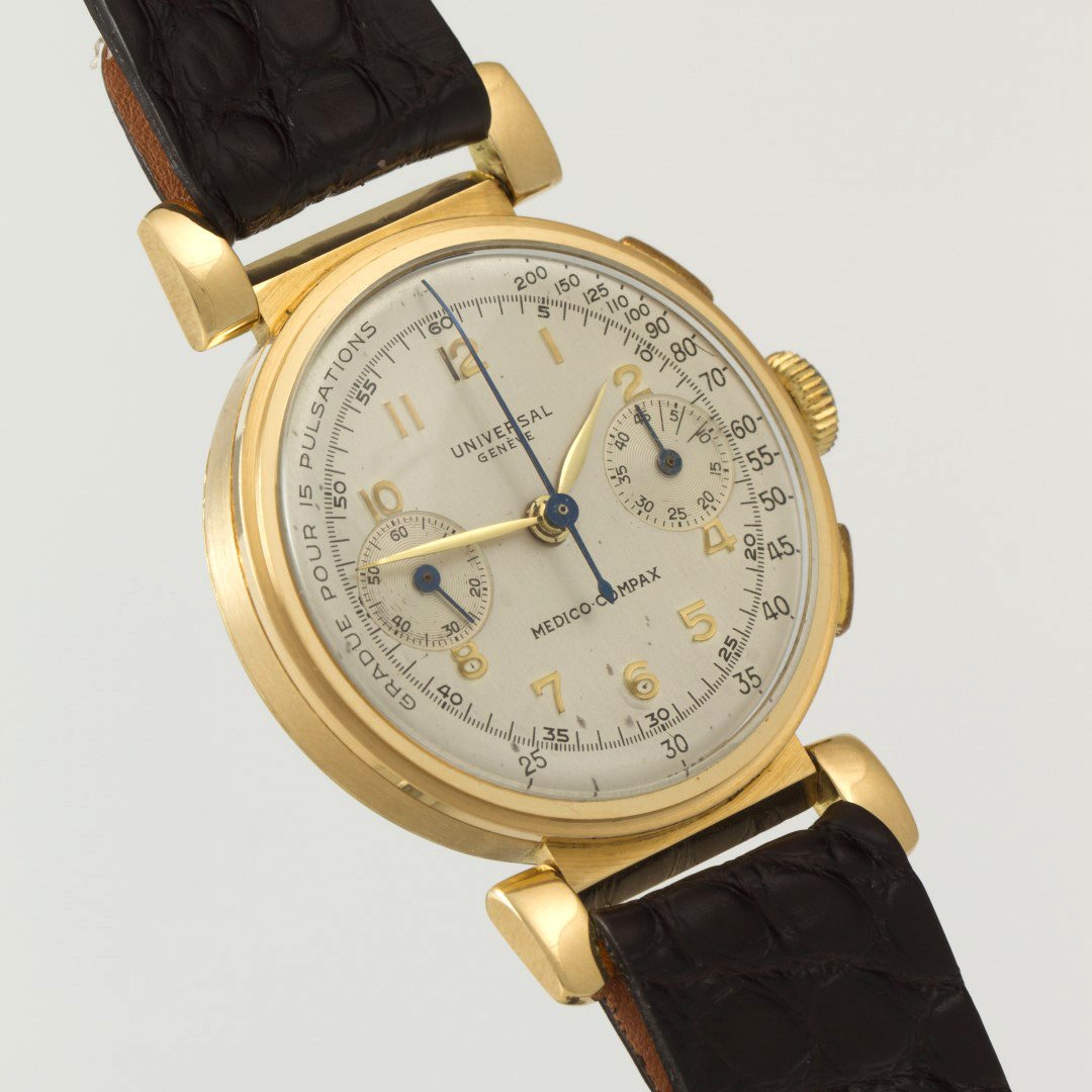

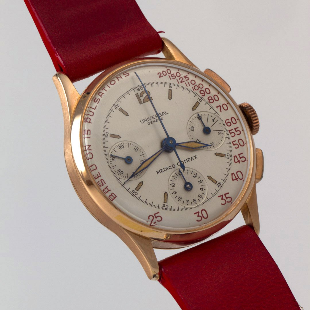

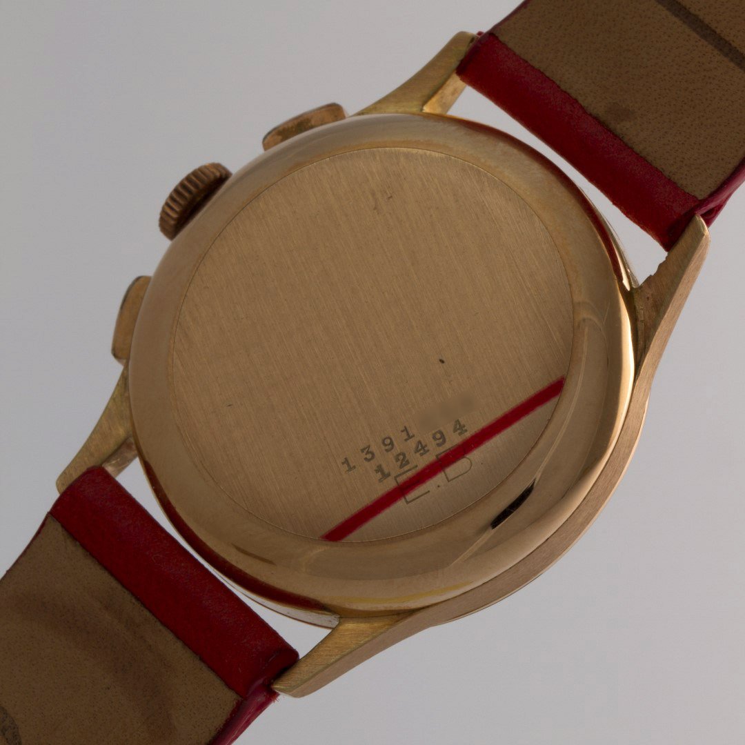

Here's an egregious forgery - Medico-Compax ref 12494. The Ref 12494 is a Compax reference, not a Medico-Compax reference, most of which went to the Brazilian armed forces (Exército Brasileiro or the Forca Aerea Brasileira, surely a flashy bunch with their gold timepieces). Sure enough, there is an Exército Brasileiro marking on the back ("E.B."). The Medico-Compax dial was from a batch available on line until last year. These have been turning up at various auctions, and I happen to have two spare dials in my drawer.

Seems to be inspired by this 12494 EB sold in 2013 with blatant redial 😗

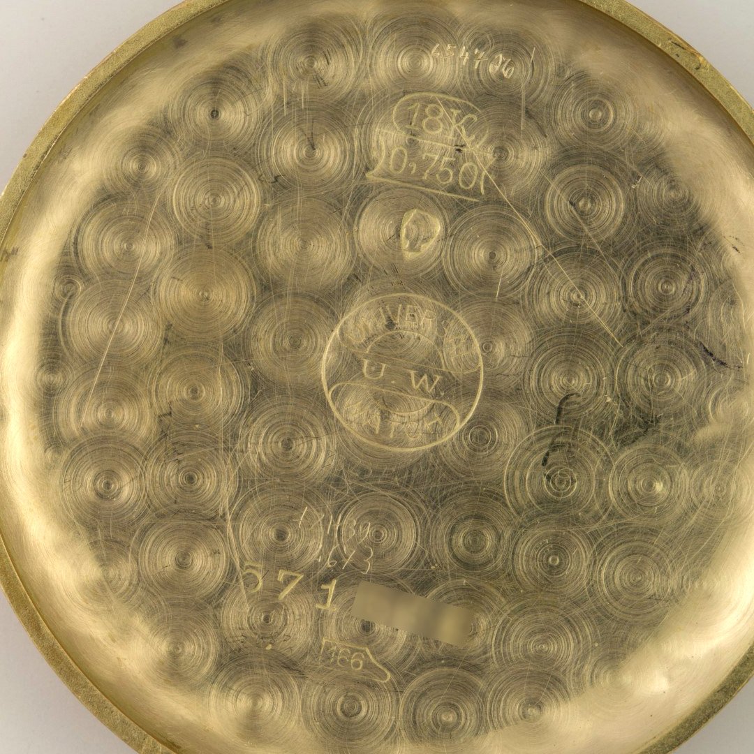

And the crap keeps coming. Here's a Medico-Compax with a case number about 600,000 earlier than any Medico-Compax documented anywhere else - about 15 years before the model line was introduced. This one is SOLD!

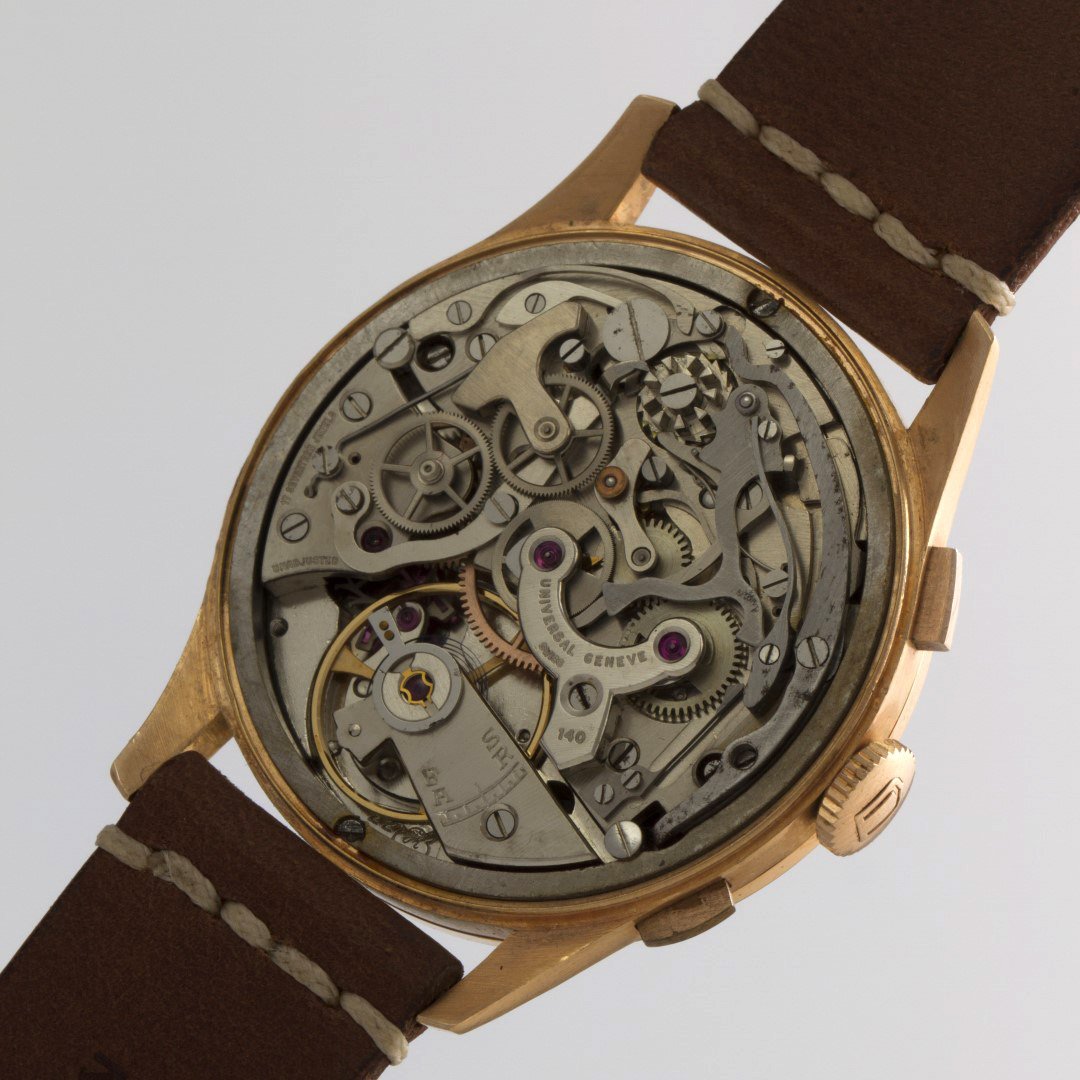

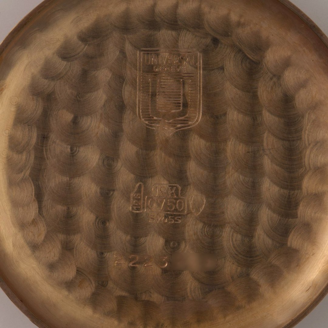

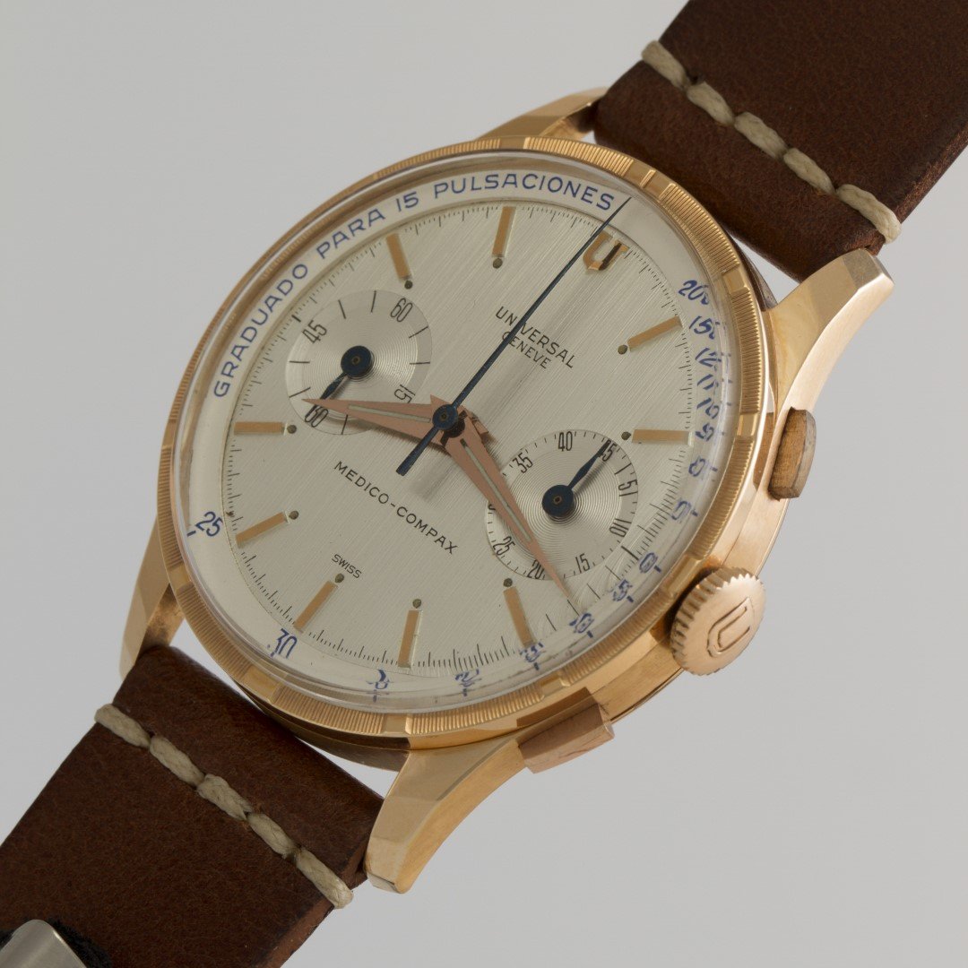

Here's one I actually want to believe is real. If it isn't, UG should have made it. It's a Valjoux 22 (UG cal 140) Medico-Compax in a Thunderbird case (ref 124146, a case that usually accomodates a UG cal 285). The reference and case numbers are conveniently obliterated. Could it be?
