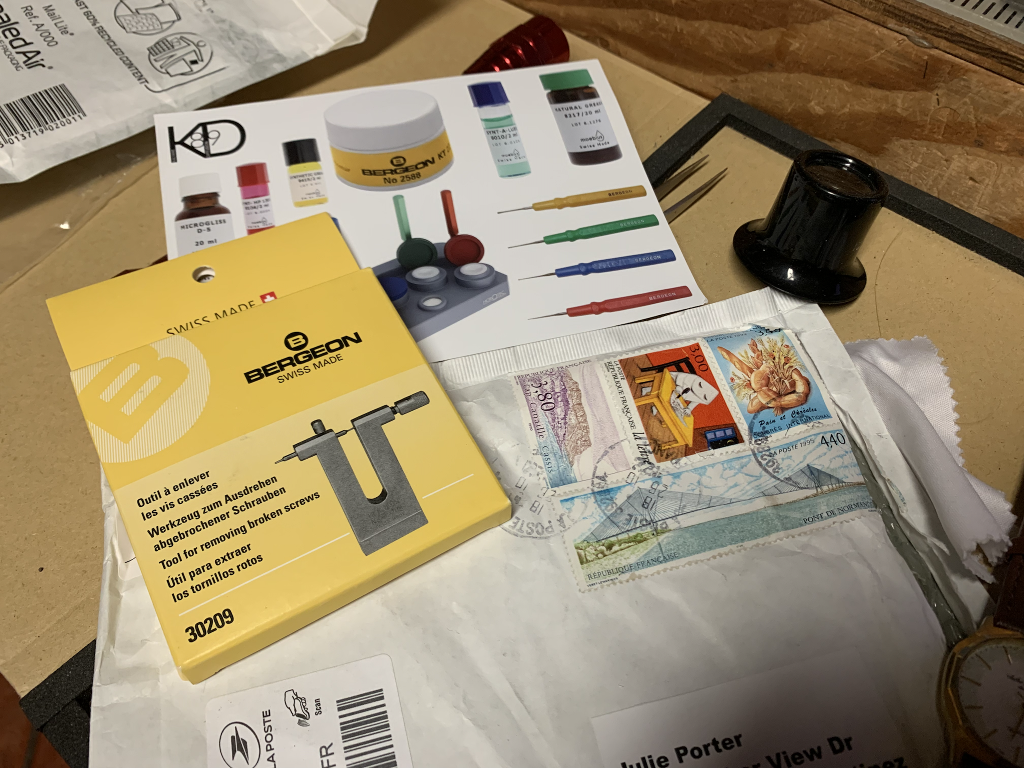

Now a full 6 months after ordering, without notice, my cannon pinion remover arrived in the mail. Better late than never!
15
10
It is finally here. Thanks to a member here on OF I was able to order one from france using eBay.
Have not had a chance to try it yet.
I ordered 1 and I used it on a stuck screw in an Omega 601 movement. It worked find in my situation.
