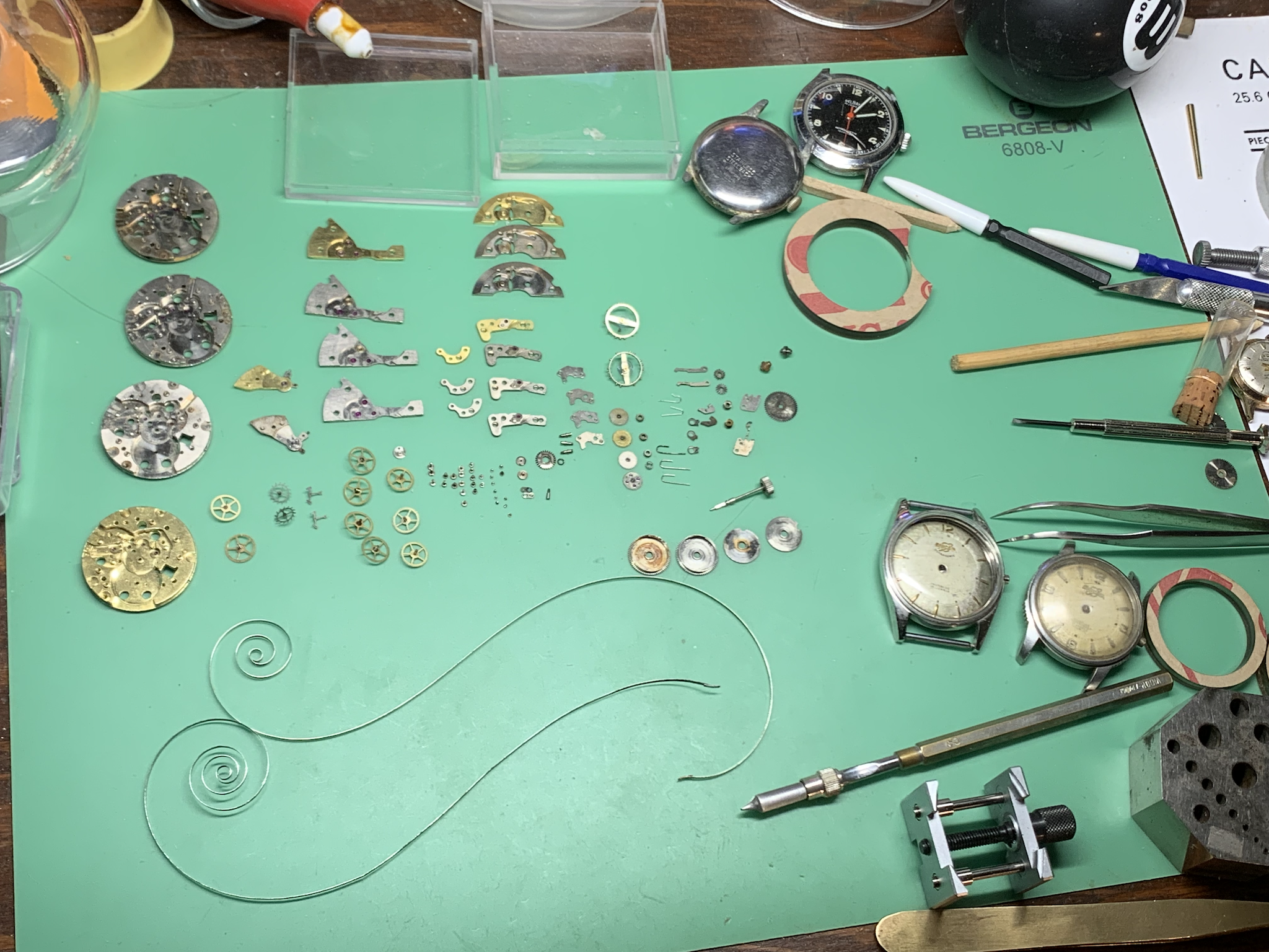

Bench time for some enicar inners.
3,014
4,783
Some time ago I got some AR 1010 movements really cheap. They are also really trashed. I decided to take them down to their components parts. There is almost. a complete watch here. Sadly not the gold plated one. That is missing an upper jewel, and is not milled for incabloc. Looks like it had one of those radial shock absorbers.
The most complete movement which does have incabloc has rusted screws which will need to be etched out. There are also no cannon pinions. It is also interesting that there are different mainsprings.
The hairsprings are also wonky. I did get some special tweezers for hairsprings. They never behave as the textbooks indicate. Ironically I started playing with these as I have yet to practice more with the landeron and A Schild hairsprings from last year. Working my way up to the Val-72.
