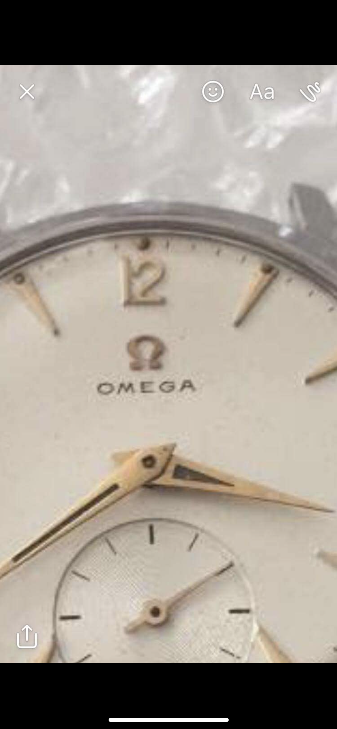

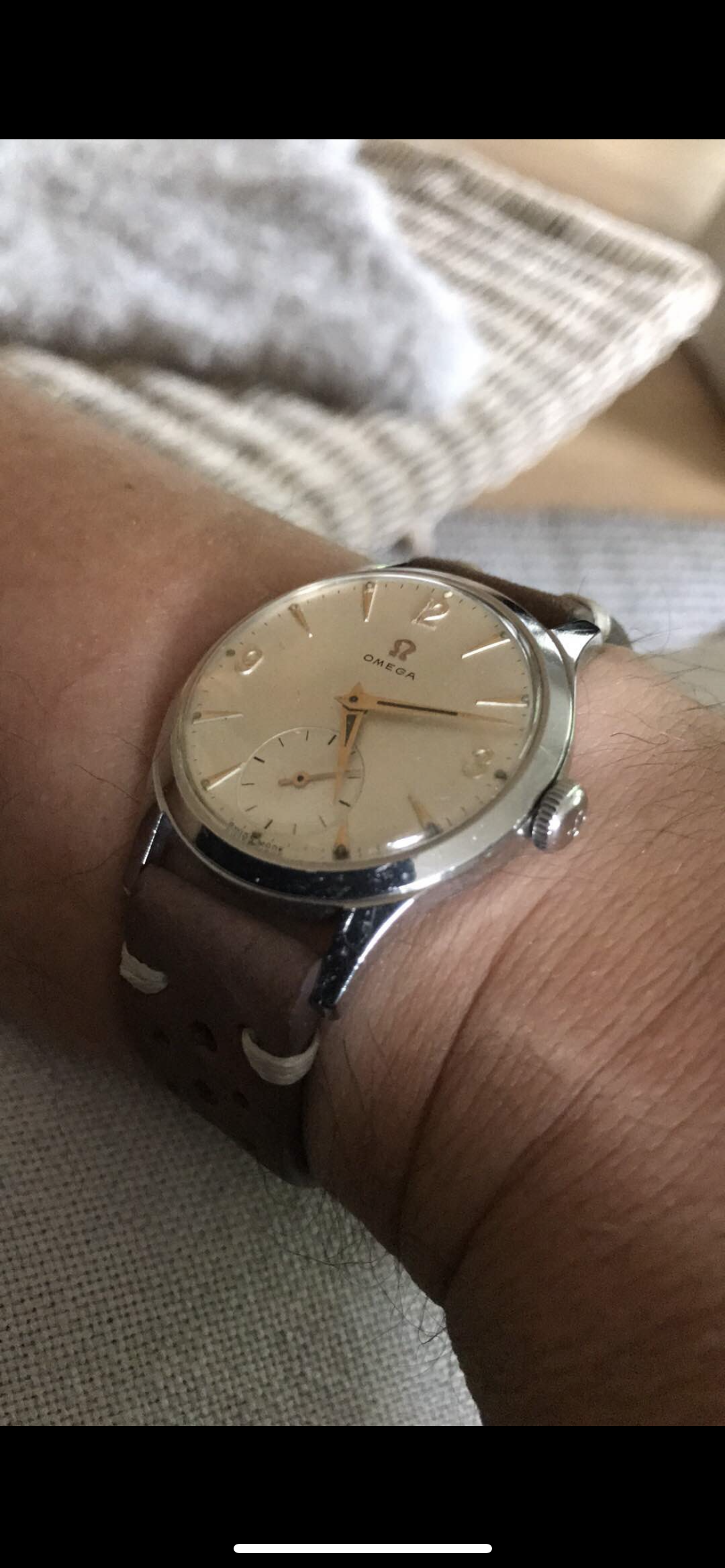

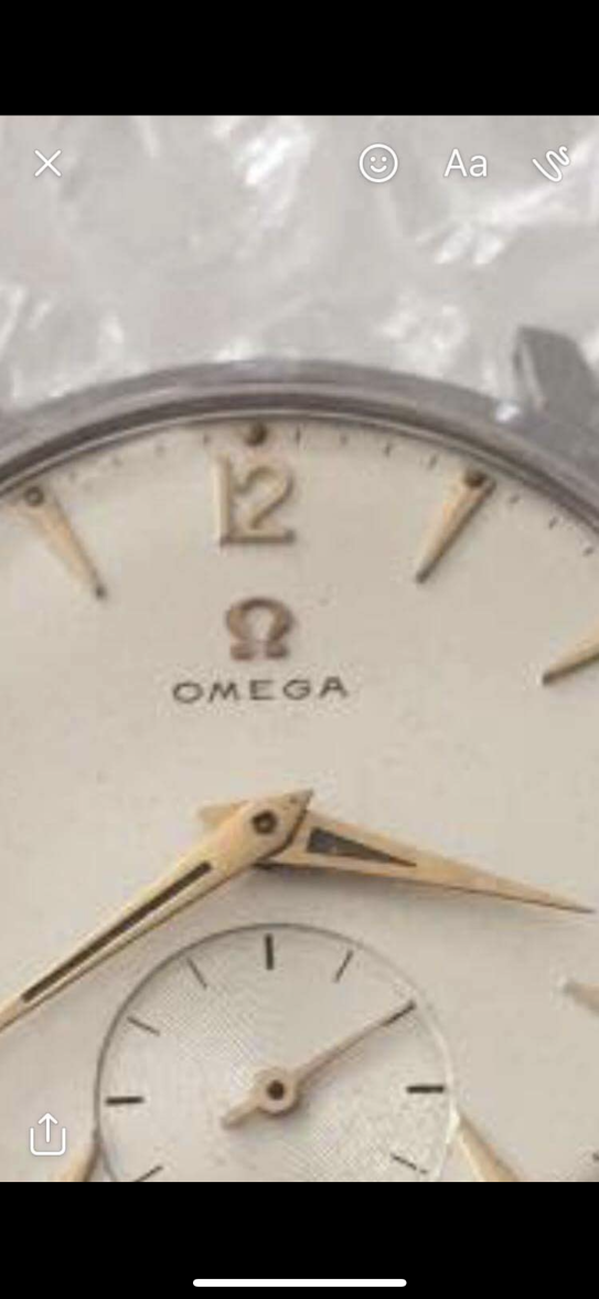

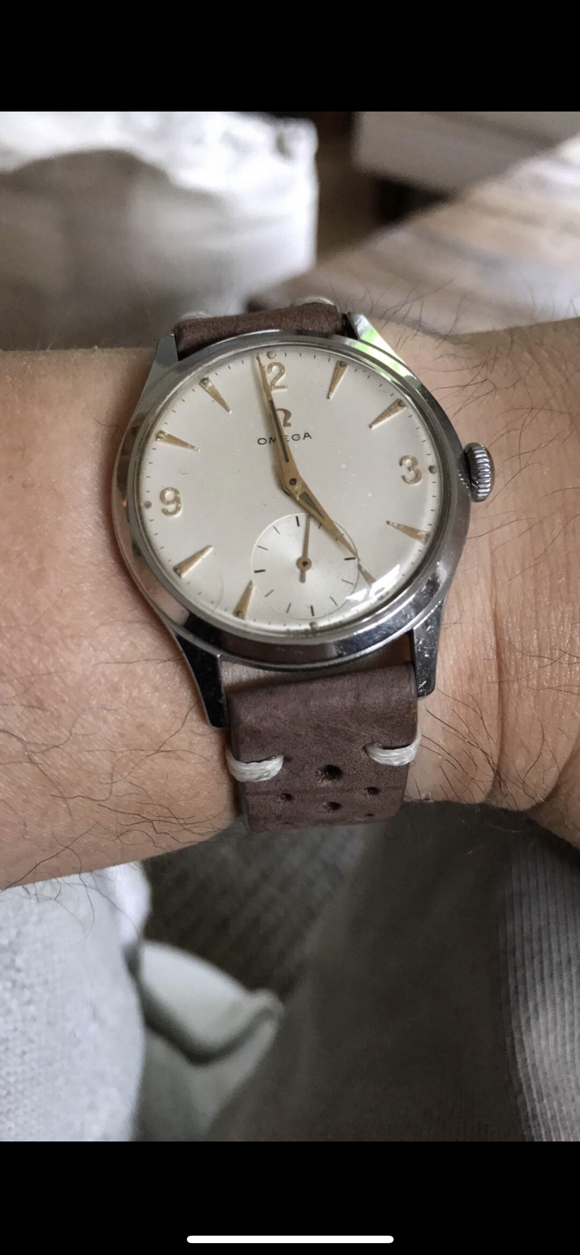

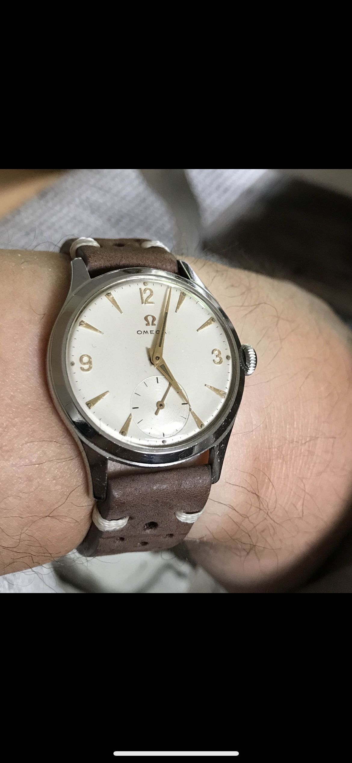

I bought this one in 2017 and I Wonder if its orginal and what the value is today.
Is it a Ref 2622-2 ? And what is the year of production.
Is it a good Watch?
thank you

Looks to me like a very good example. Value? Do a search on ebay completed listings.
13,493
31,814
SOLD listings.

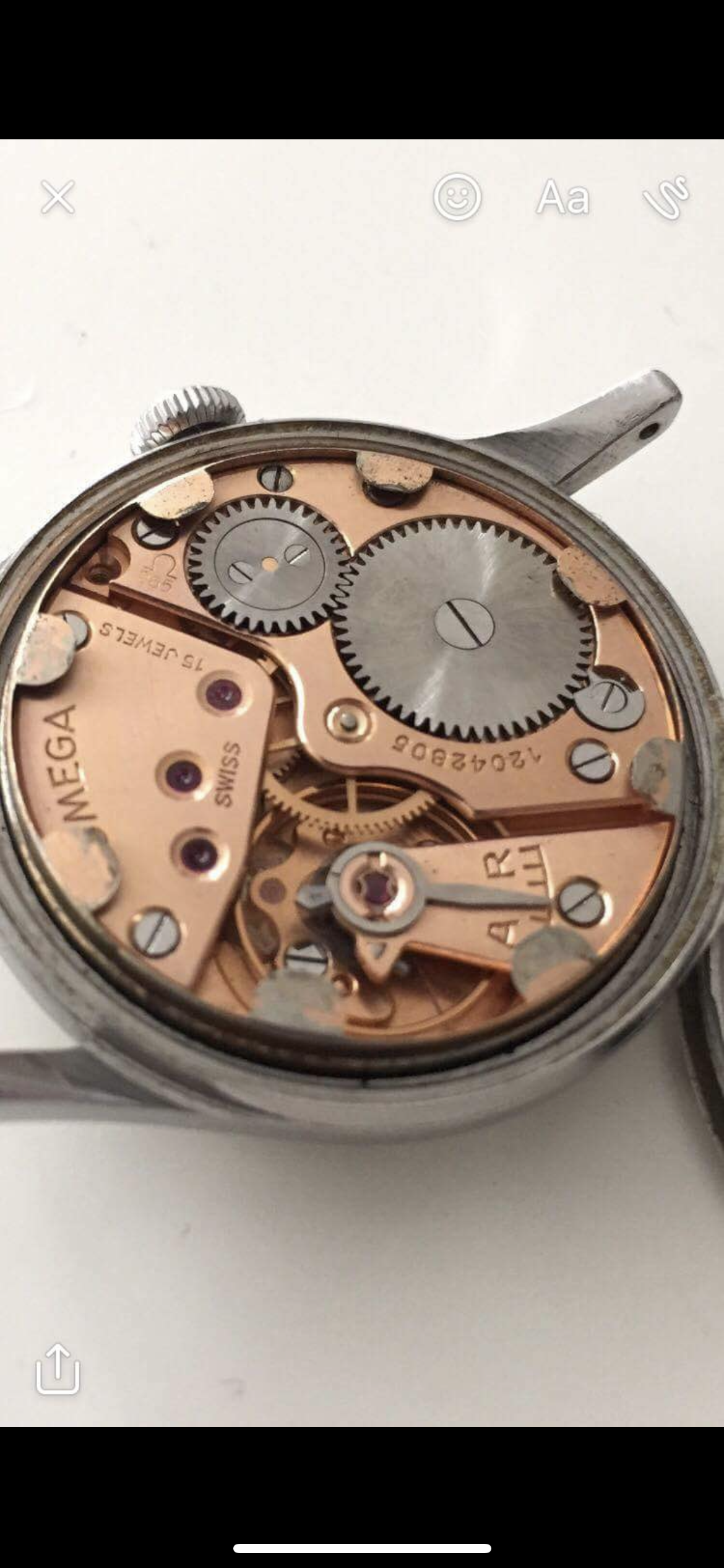

And while you’ve got Google open look for omega age by serial number….yours is the long one beginning 12 in the last pic.

12.04m is much nearer 1950 than 1955. No later than '51 IMO. Actually I would have put it at 1950 so maybe the OVD is wrong (happens often) or a slightly earlier movement has been swapped in. Or it’s one of the first.
10,806
16,814
What is the OVD ?
Omega vintage database. It’s what Tom used above to show the model was introduced in 1951, but as I say it can be inaccurate
5,631
5,815
In this case, I would believe the database more than i would believe the serial number lists.
Either way, early to mid 50s.
10,806
16,814
So would I but I wasn’t basing my estimate on any online list.
