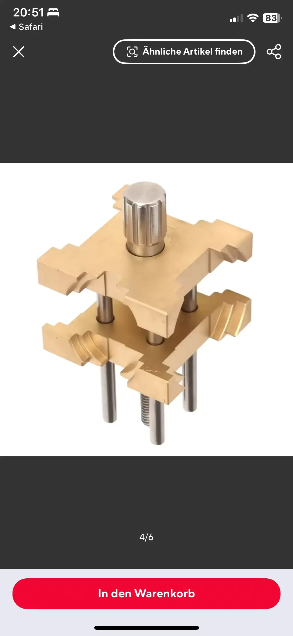

And i think you forgot a Movement holder. I really like this one.

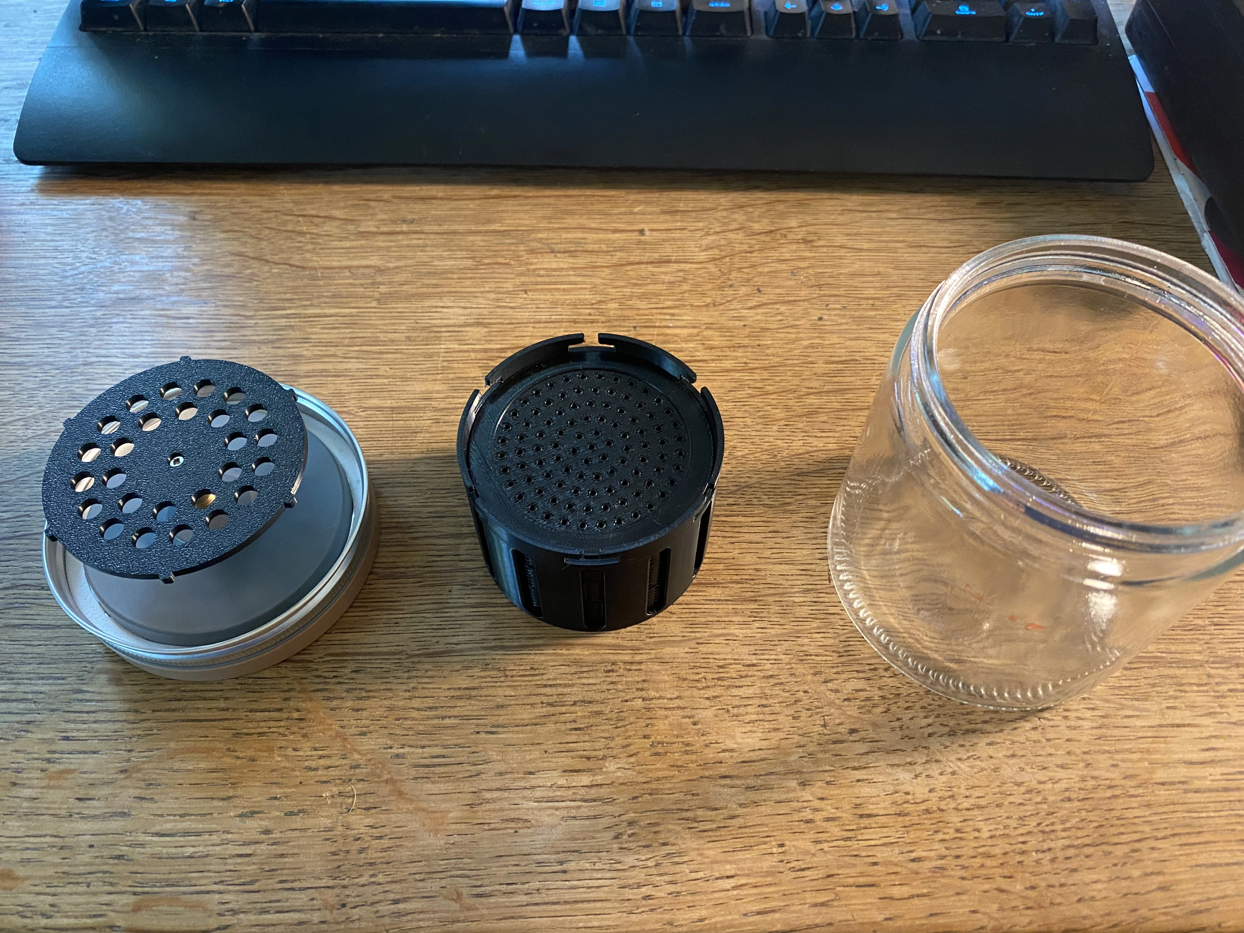

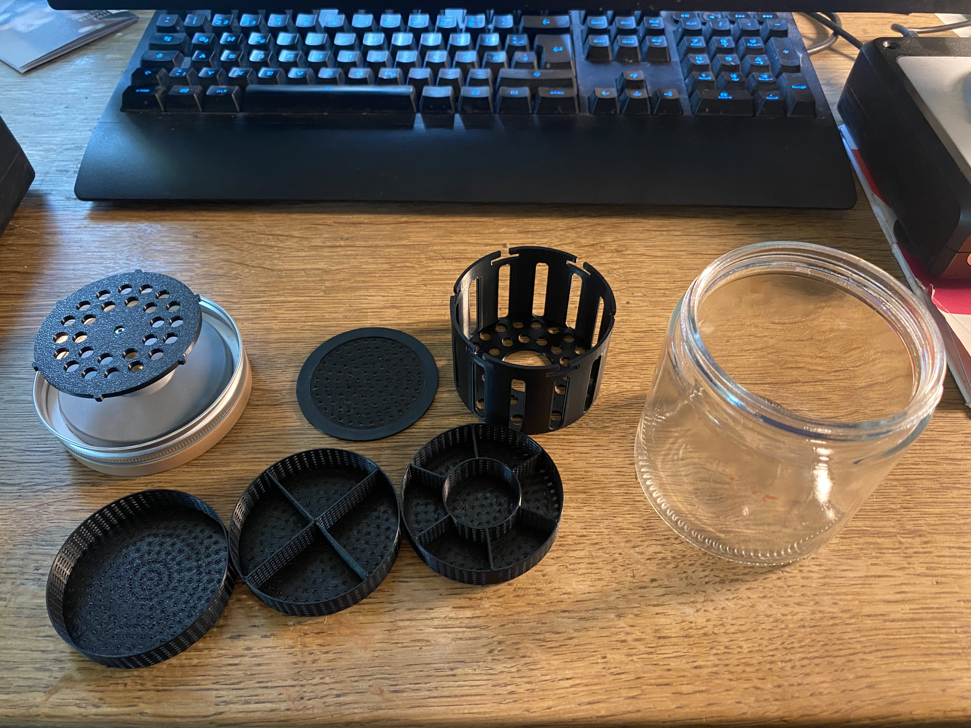

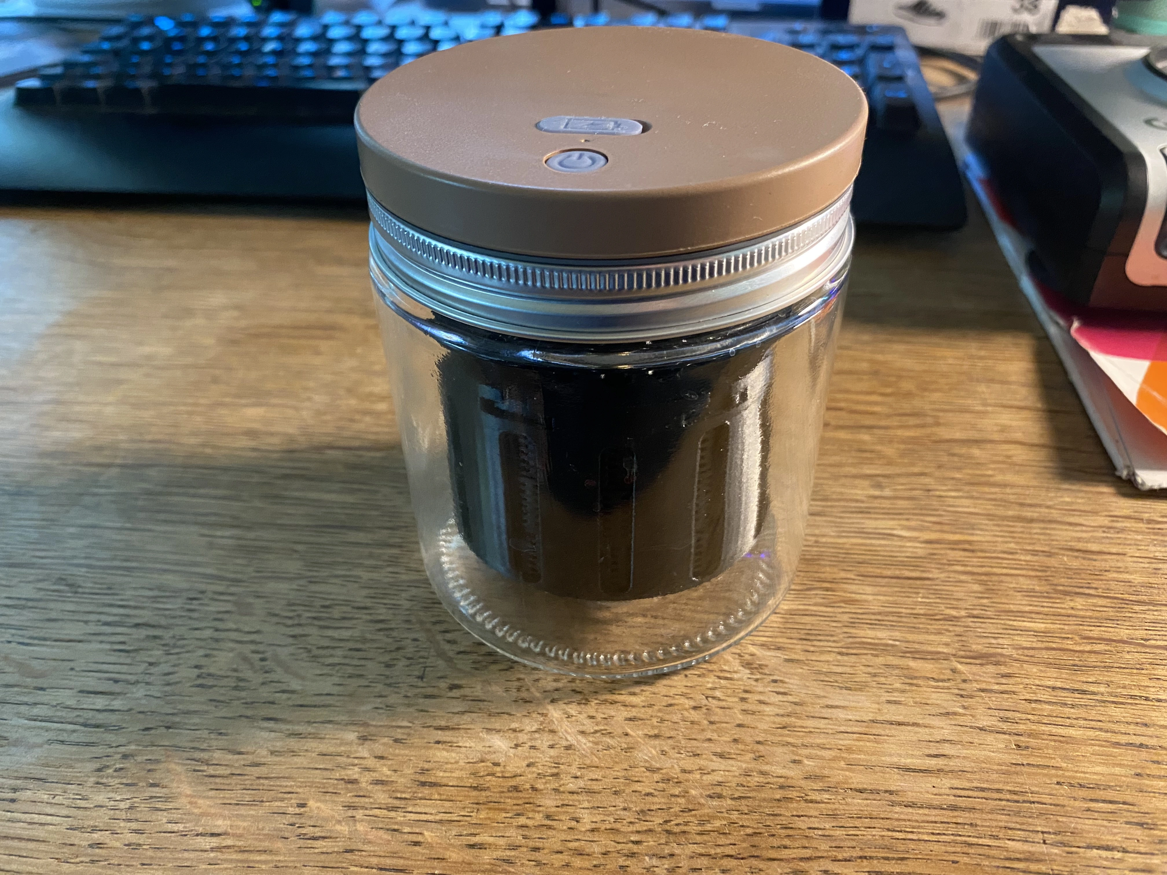

Im currently trying out this thing here. It Spins in a jar. I will try it in an ultrasonic cleaner soon. Its just around 50€

79821405228__67EF71DC-DBC8-4772-A71D-6622866B429E.MOV - 795.4 KB

Those things are absolute garbage. While they do a fine job (though their spin speed is pretty bad), their batteries are crap. All of mine (I bought 6, they seemed nice after a short time!!) have bad batteries after only about 2 months of use.
Also, the baskets tend to get soft over time in the cleaning fluid (just L&R), so they kinda fall apart. Mixed with the fact that the holes in it aren't particularly large, they don't do a great job of letting cleaning fluid in.
In the end, they were kinda total wastes of money.
