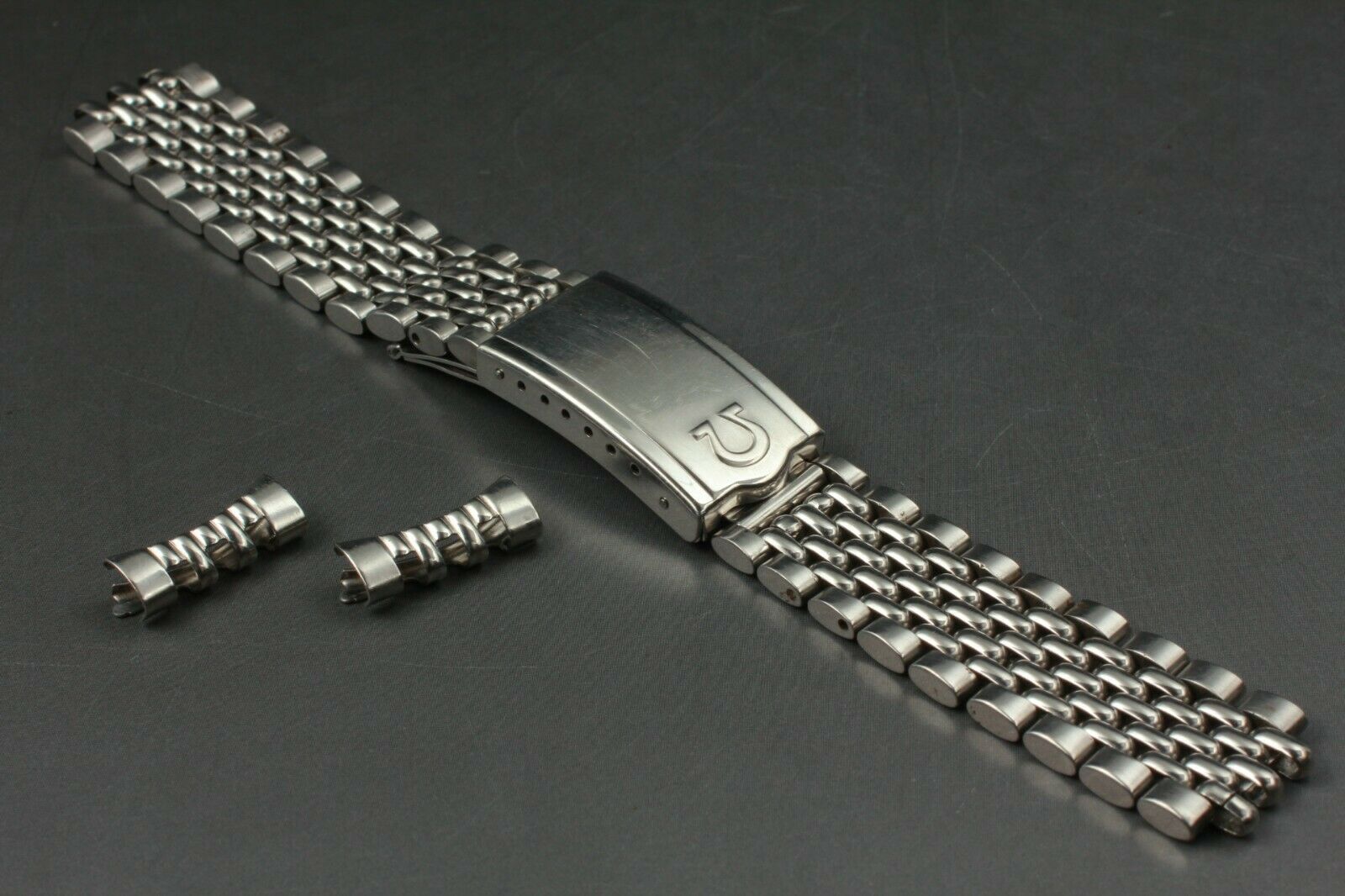

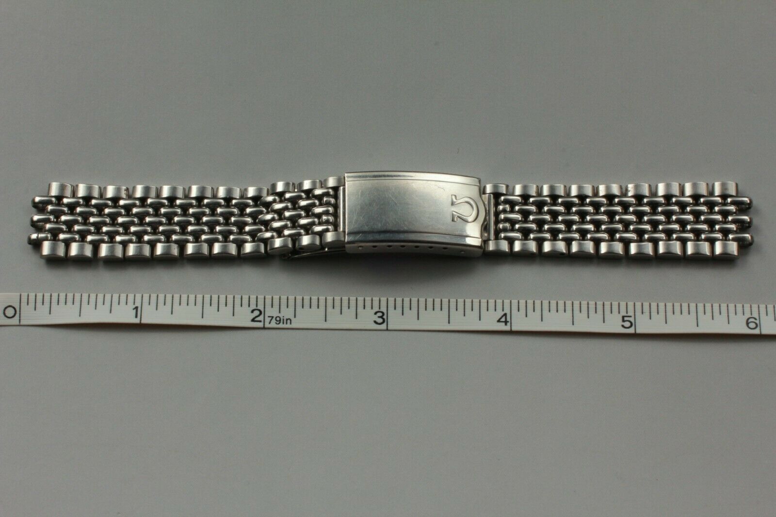

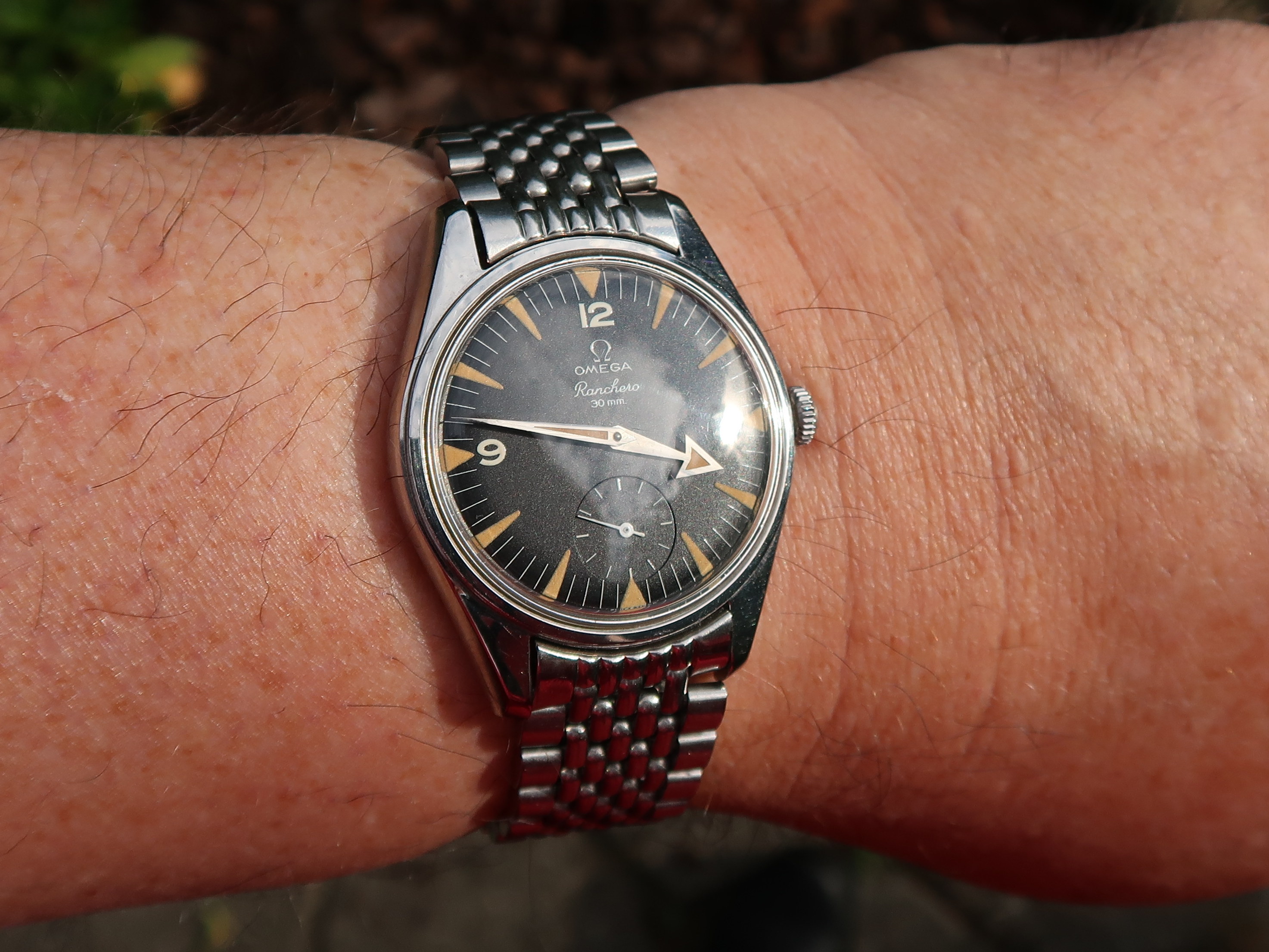

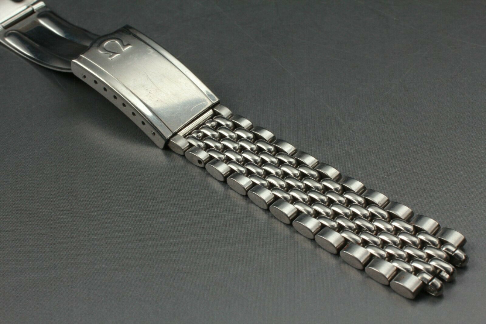

Ok, OF vintage bracelet experts, what are my options for a beads of rice bracelet for a 1958 Ranchero 2990? I know that an early flat link is the recommended bracelet, but I already have a flat link 1175/640 on my ‘71 Speedmaster and I want something different for my Ranchero. I’m thinking maybe a 1036 BOR. Would that work and, if so, with which end links? Thanks!

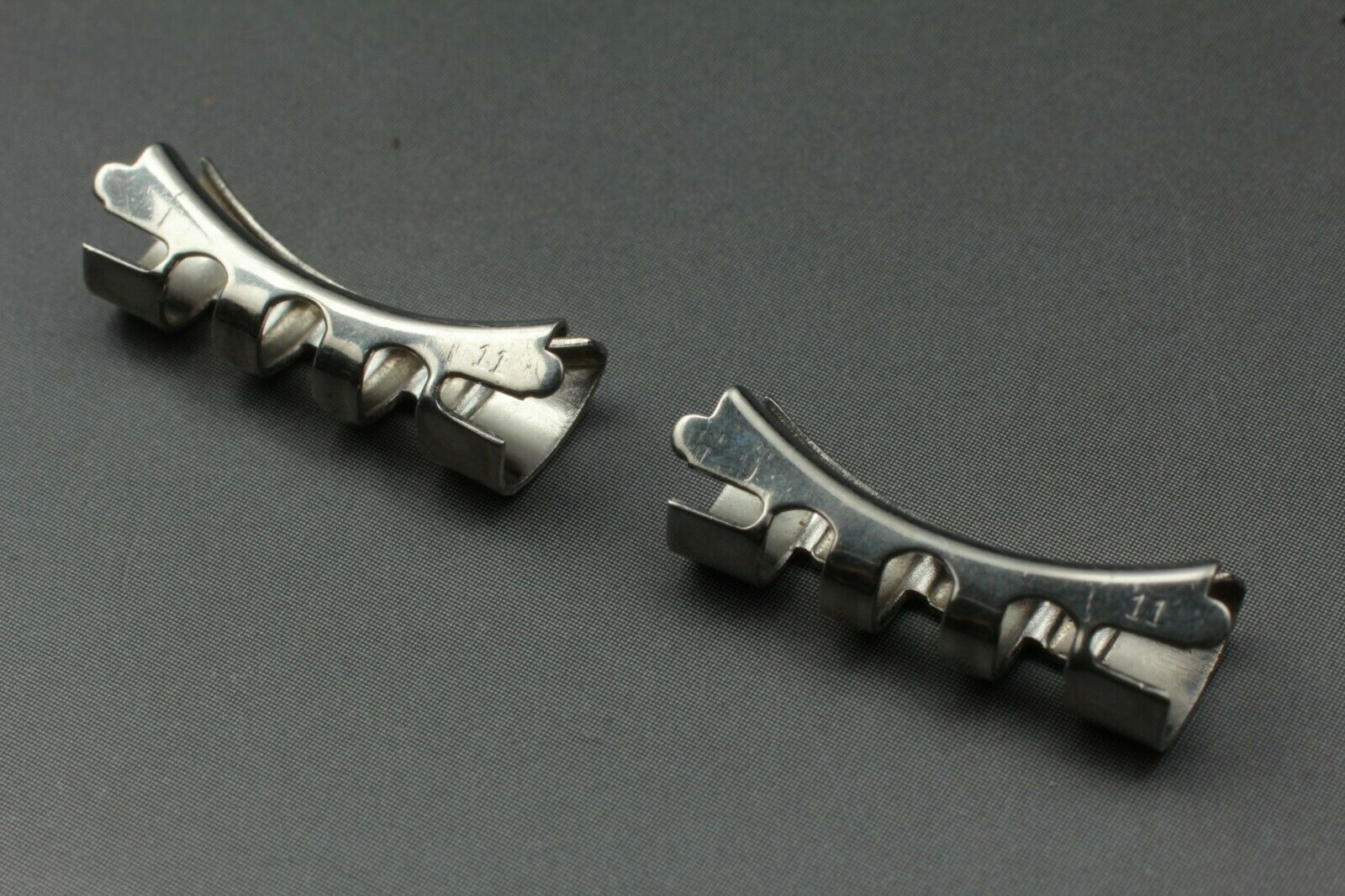

I’d say No.11 end links would be the best bet.

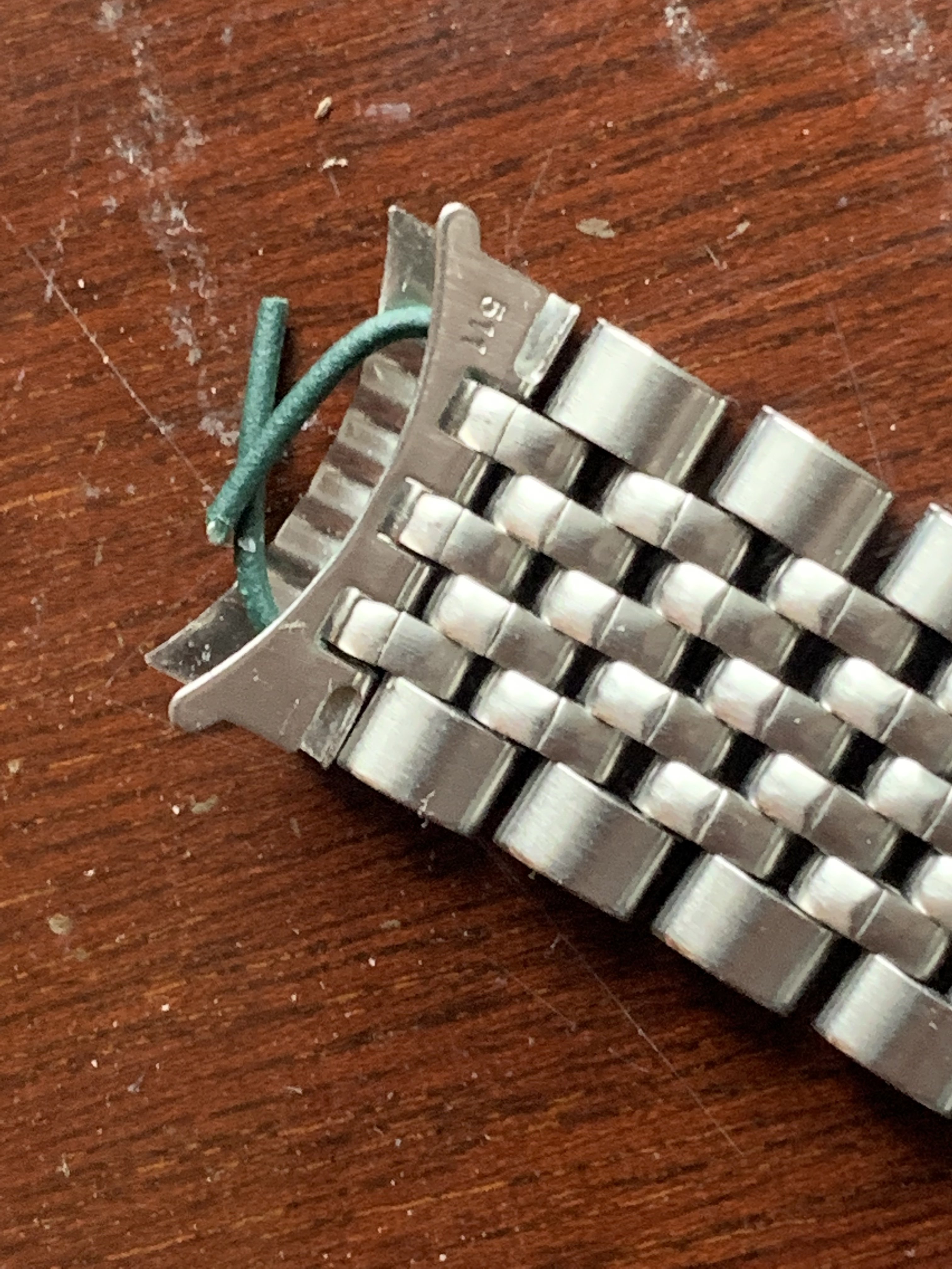

1036 with no. 11 end links. Looks authentic to me, but would appreciate a second, third, fourth, etc. set of eyes. Opinions?

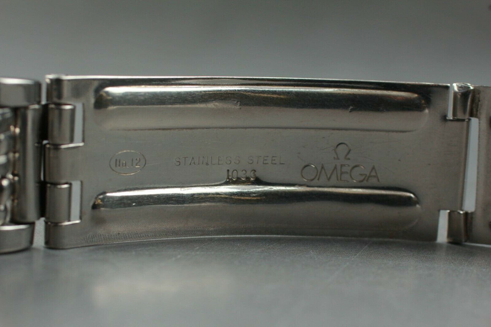

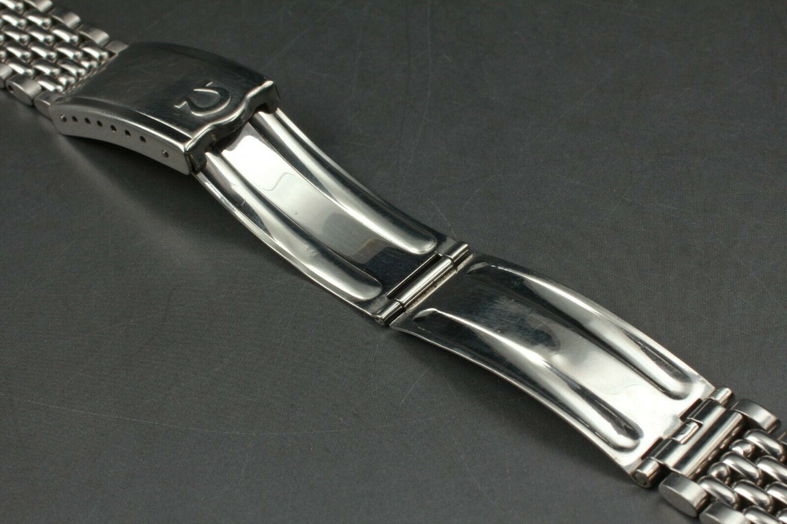

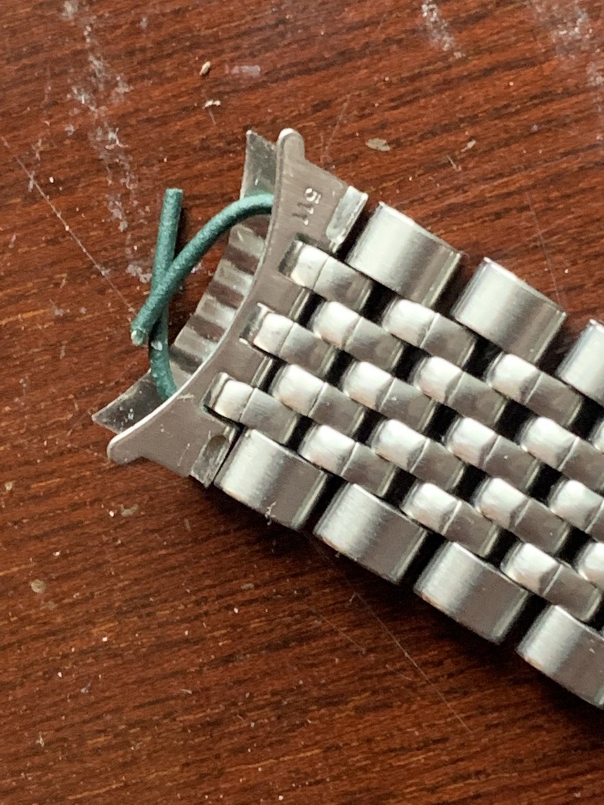

Well, the 11/12 endlinks are the earliest for the 5-row, the 511-512 are the same just with the newer number. The clasp model number is what will tell of which era. Plus the folded over end like shown above is also early as the later ones aren’t folded.

Right. For all of those reasons I thought that a 1036/11 would be a good candidate.

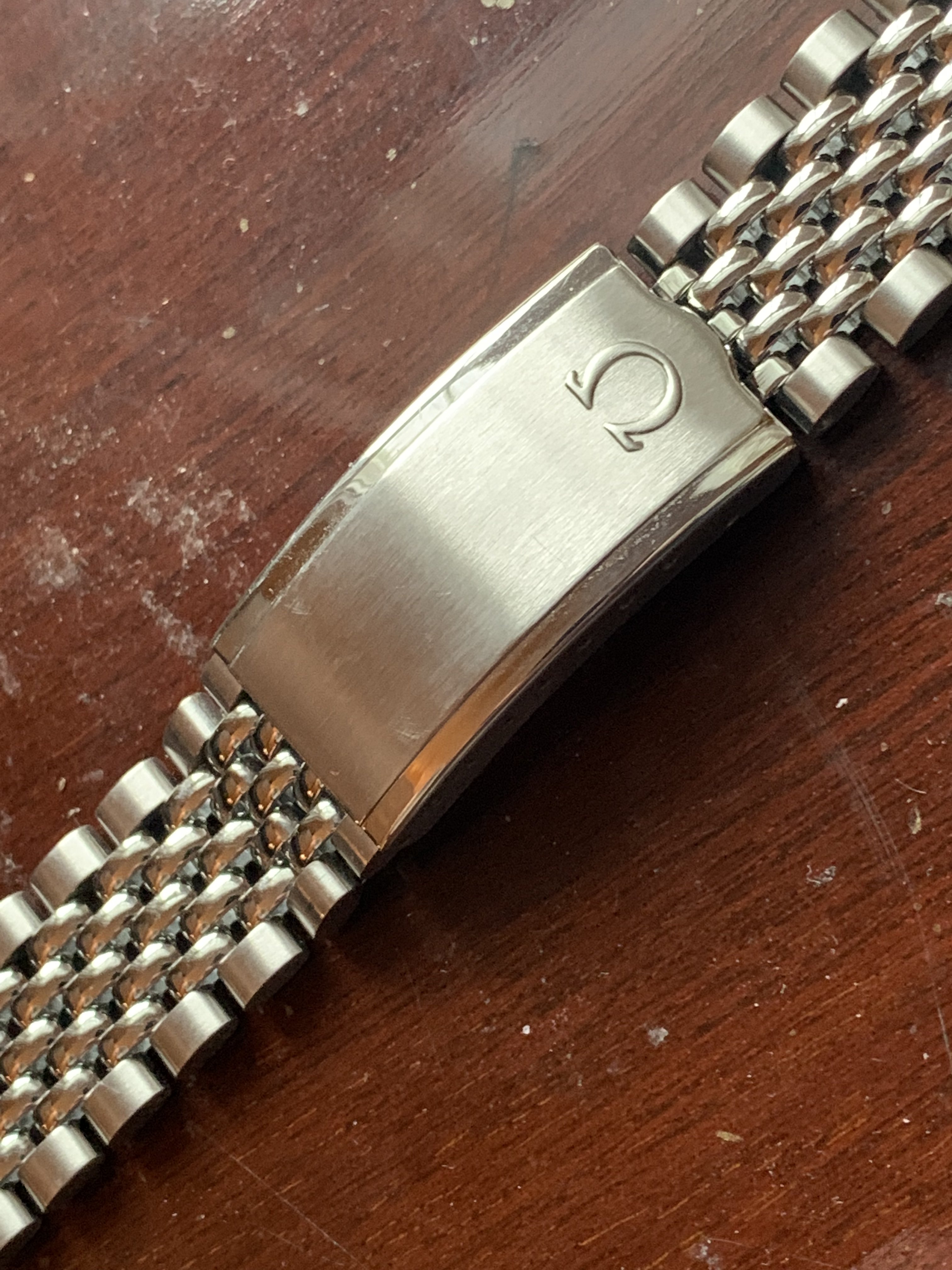

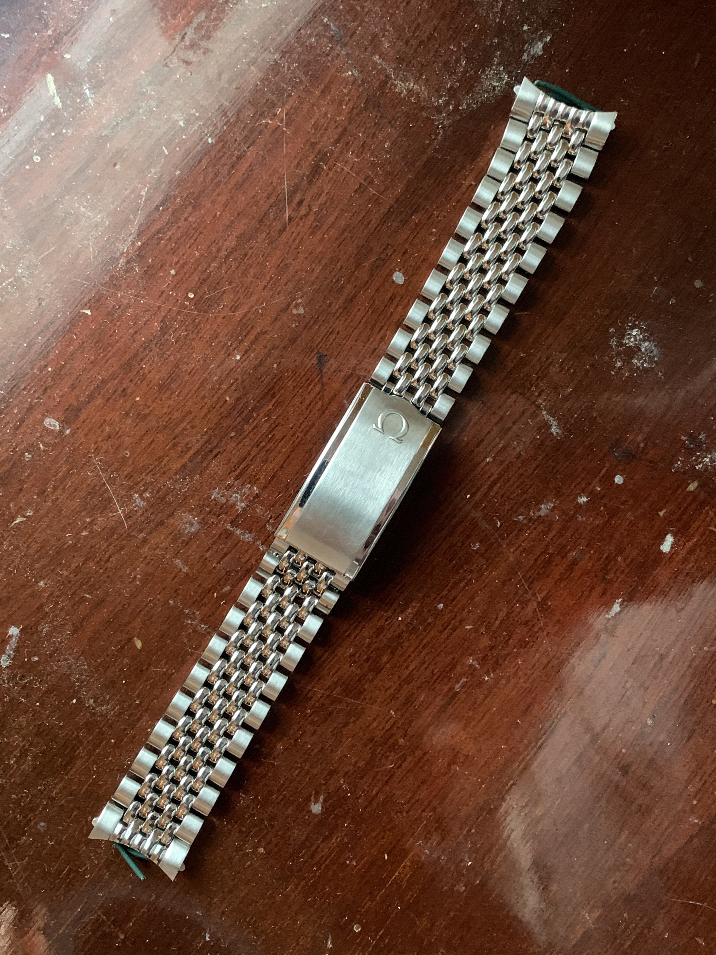

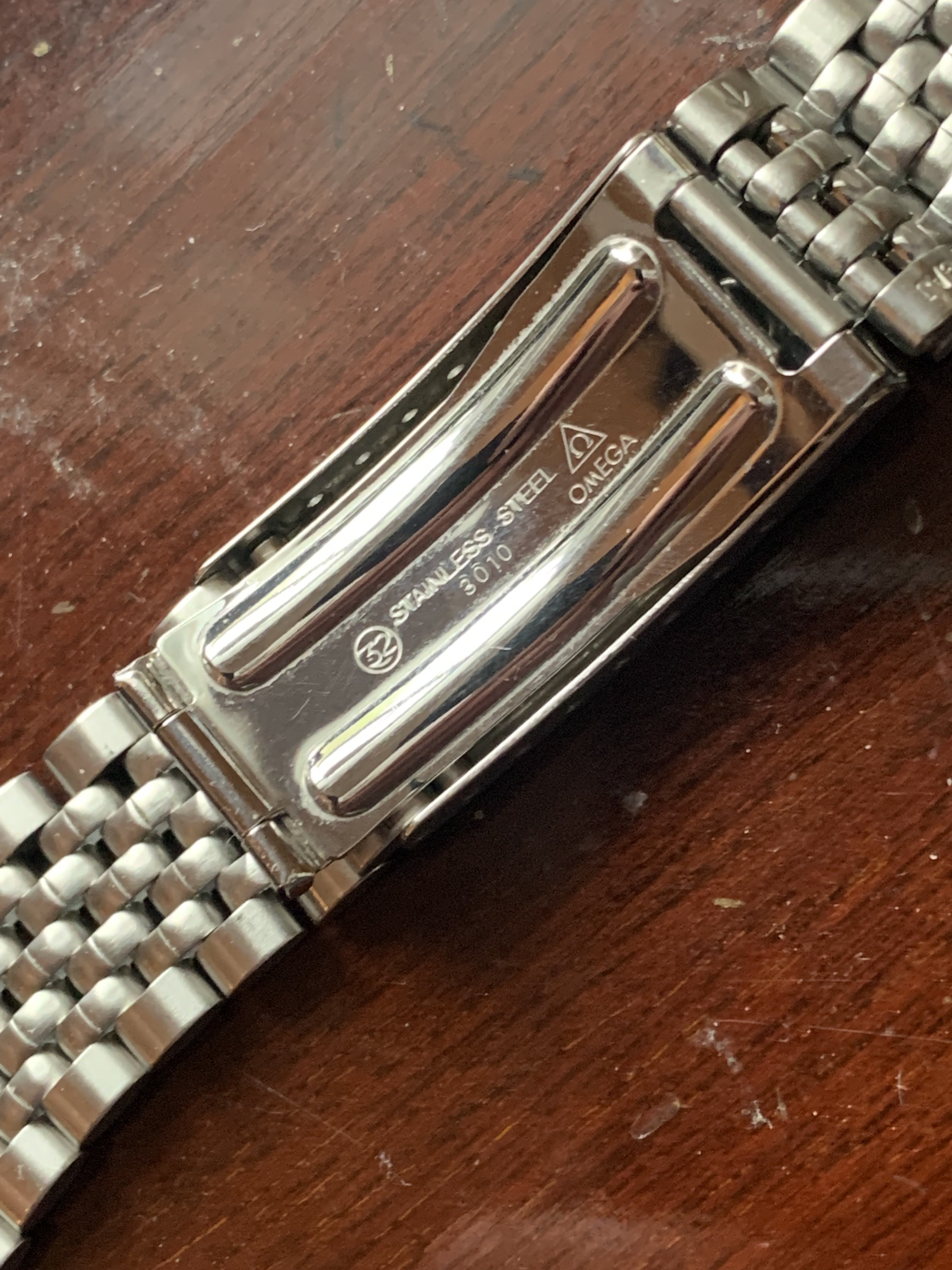

If you want "fits" then get the 3010/511 direct from Omega for $450. Brand new!
That extra "lip" on the top of the #11 is not on the modern 511, and because of that, it might fit better?
Edited to add: 512 might actually be better, those lugs don't seem to curve?
Good to know. Thanks, Tom. The 3010 is 18mm and includes a pair of the 511’s?
I have one (came on a watch I sold), it’s a nice bracelet.
Yes, but see above.

Will do. I’ve been considering a 1036 with number 11 end links (see above photos), but now SkunkPrince has me thinking about the modern 3010.

1502, 1036 and 3010 are basically the same bracelet - just iterations from different decades, 1502 being the oldest. Personally, I don’t see the reason why one would spend that money on a 3010 when you can have a really, really nice 1502 for significantly less and even stay period correct without any drawbacks. But there’s no right or wrong here really.
I agree about period correct, but to Tom’s point, if you really want a factory one without sifting through over polished, stretched-out, beaten with crimped in wrong links and broken pins that’s 5” long- you can walk into an OB and order one today
