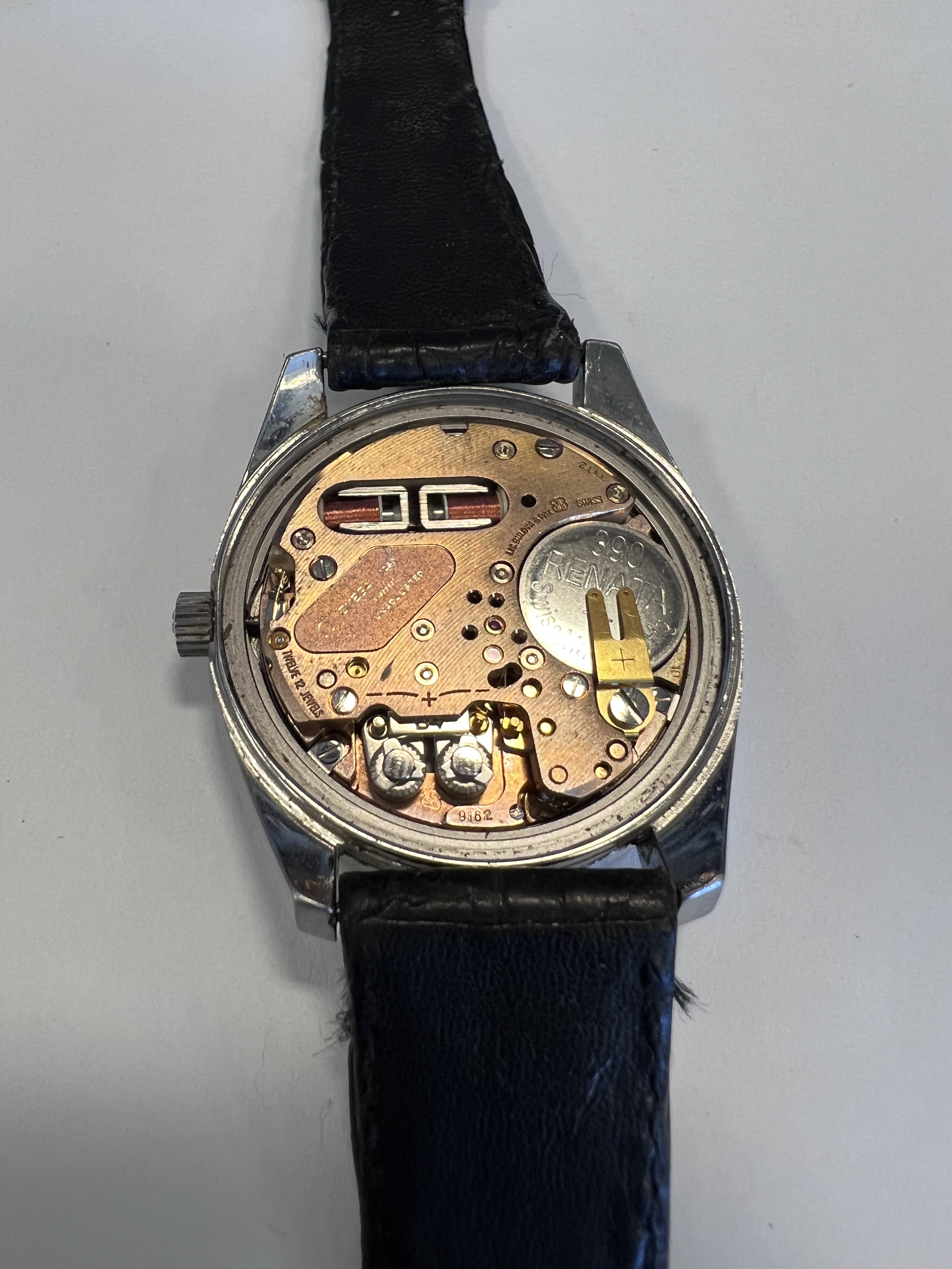

This is my watch.
I unscrew the caseback (I use a soft rubber caseback ball).
With a fine screwdriver, I carefully loosen the screw that secures the battery arm until the arm swivels. I’m reluctant to unscrew it altogether in case the screw drops into the mechanism.
I insert a replacement battery and tighten. I’ve noticed that occasionally, I have to re-seat the battery.

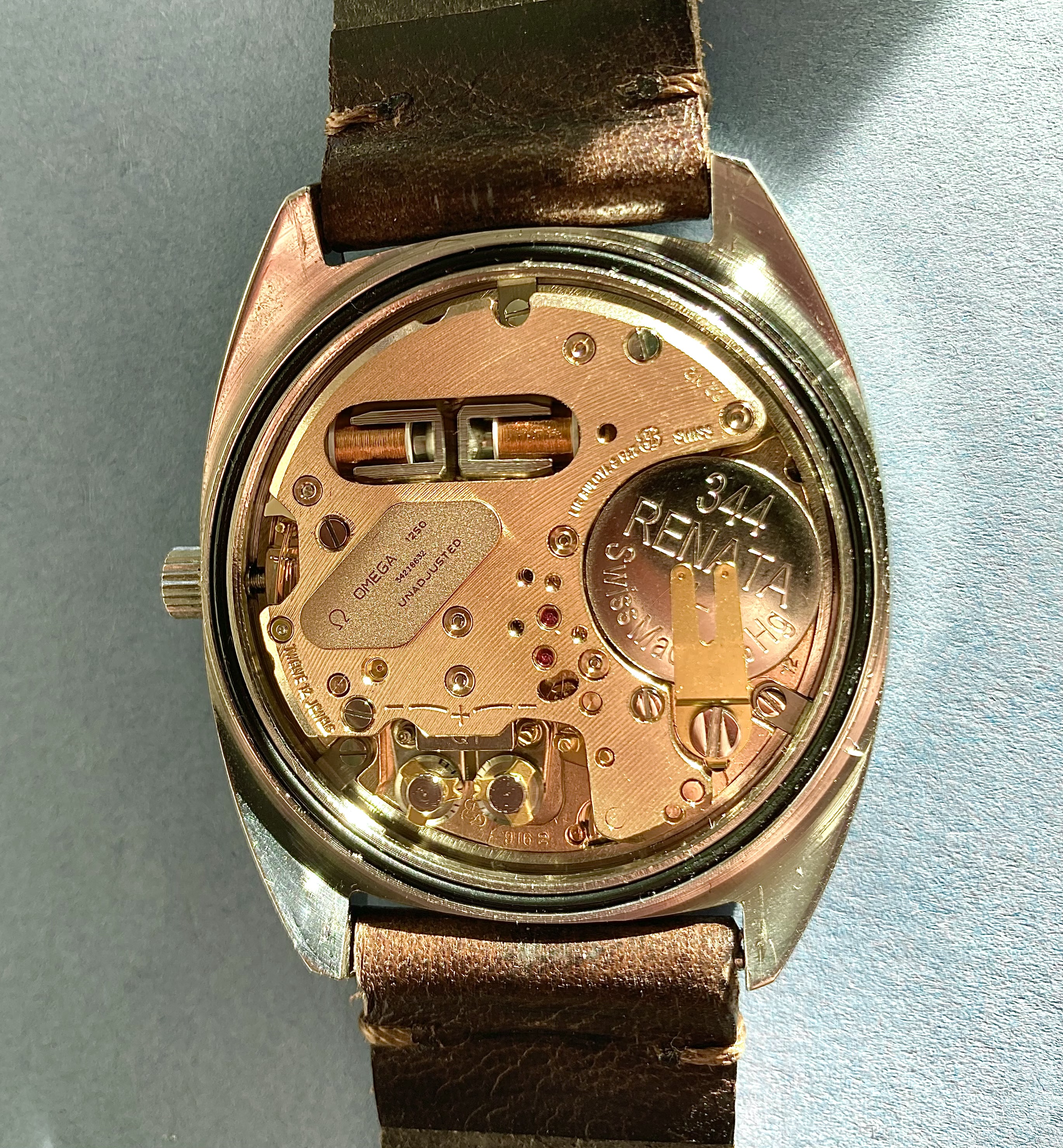

My batteri says Hi! 😀
But a Renata 390, I do hope that my watchmaker did the right choice...??
It is a Seamaster F300 ref nr 198.001, and keeping time spot on.
