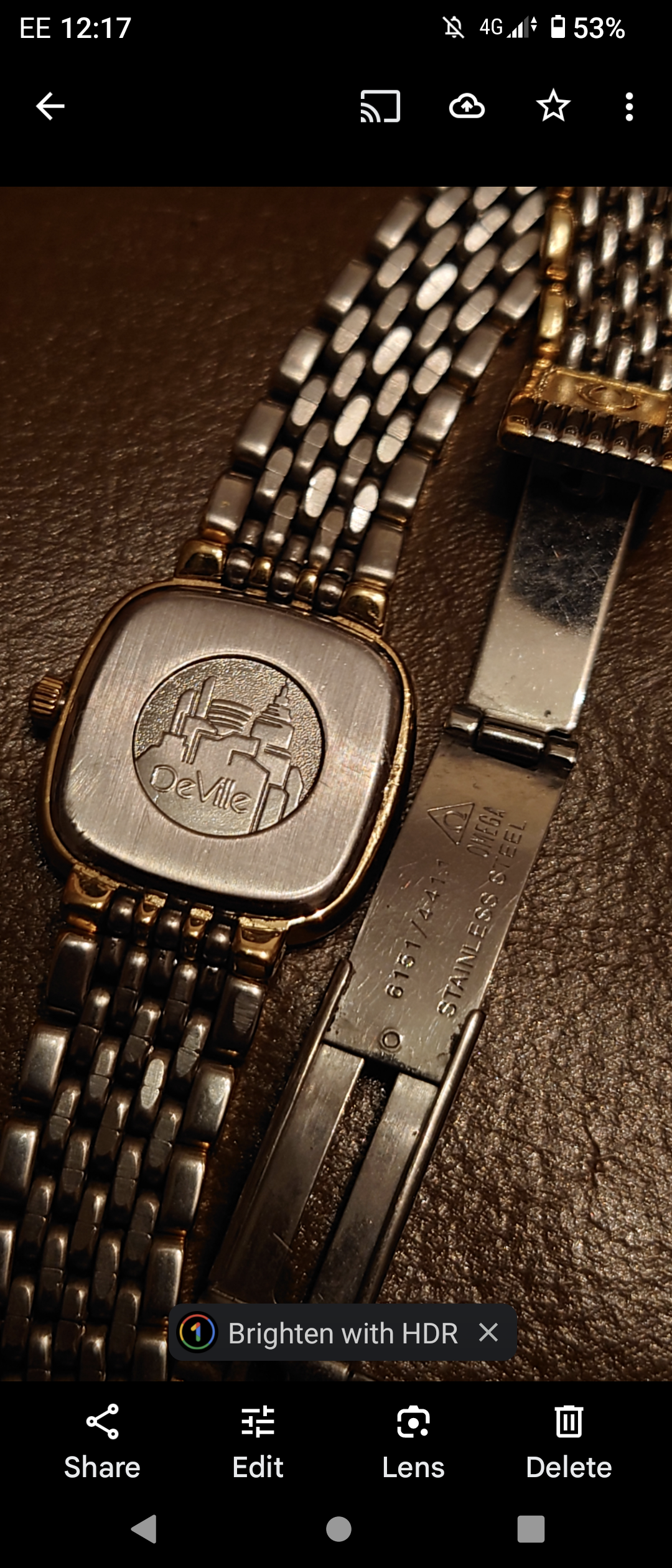

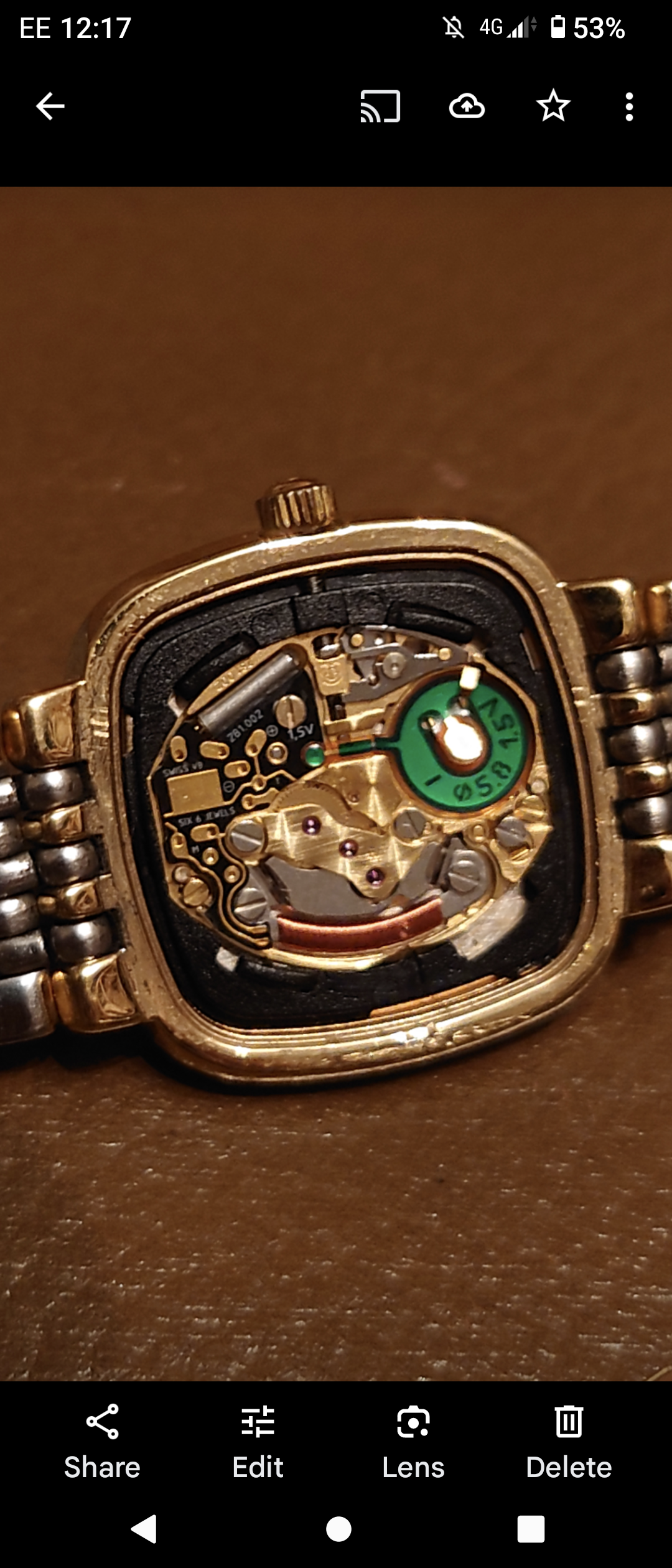

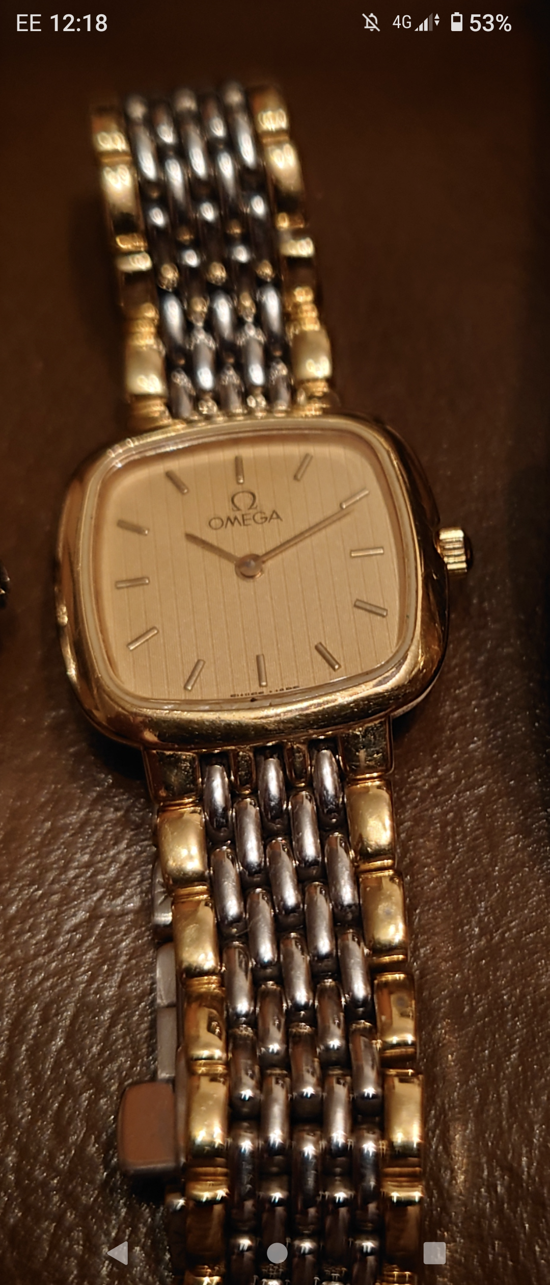

Posts 532 Likes 270 Wat-1 ·Dec 23, 2023 I'm look for help for what battery code I need for this ladies Omega de ville much appreciated thankyou
Posts 935 Likes 1,058 vienna ·Dec 23, 2023 Looks like a ETA 281.002 to me which needs a Renata 750 or 751. Kind regards Max

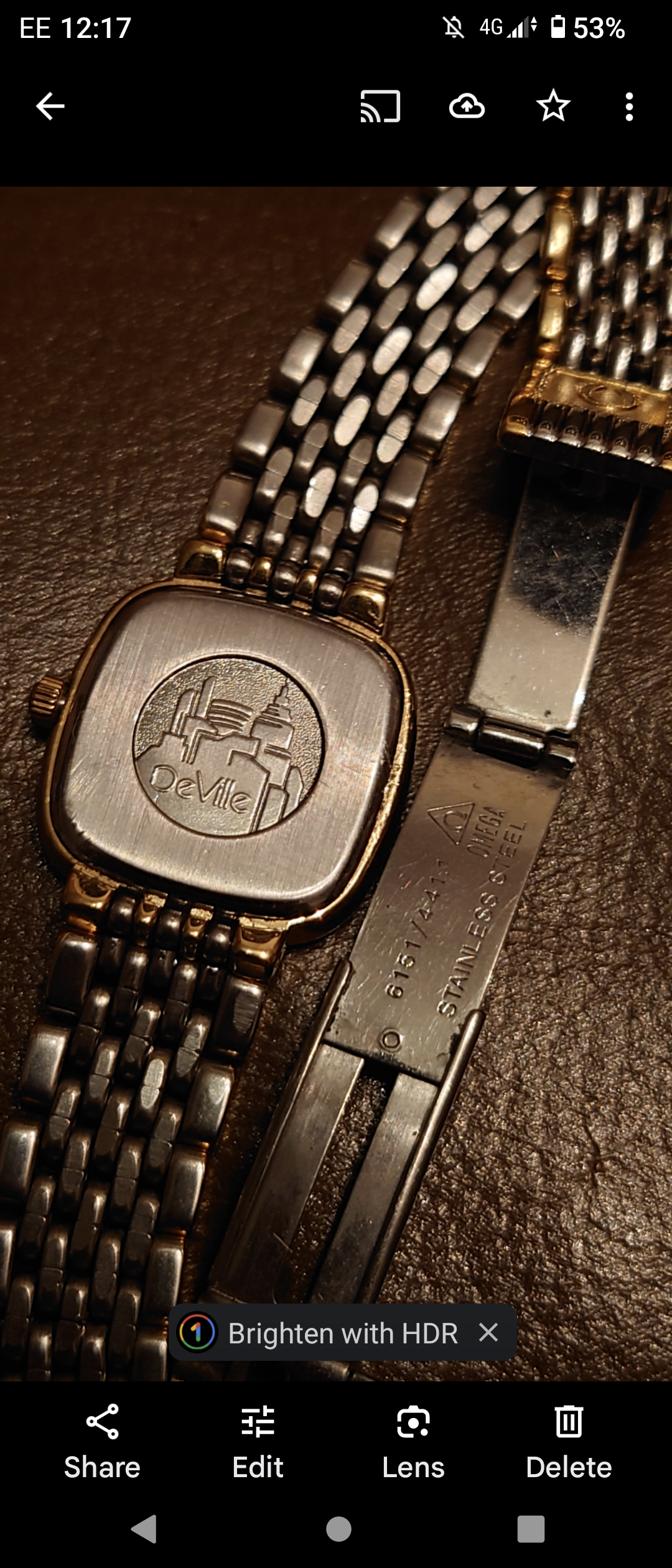

Posts 532 Likes 270 Wat-1 ·Dec 23, 2023 vienna Looks like a ETA 281.002 to me which needs a Renata 750 or 751. Kind regards Max Just had a look and the back cover is 795.0898. 2. If that makes a difference?? Thankyou
Posts 18,840 Likes 39,182 JimInOz ·Dec 23, 2023·Melbourne Australia Looks like a caliber 1459 (ETA 281.002). Should be a 335, SR512SW or Renata 751 Lithium. PS: Looks like Max beat me to it.
Posts 532 Likes 270 Wat-1 ·Dec 23, 2023 JimInOz Looks like a caliber 1459 (ETA 281.002). Should be a 335, SR512SW or Renata 751 Lithium. PS: Looks like Max beat me to it. Number on the back cover is 795.0898. Can't make out the cal. I appreciate your help thankyou

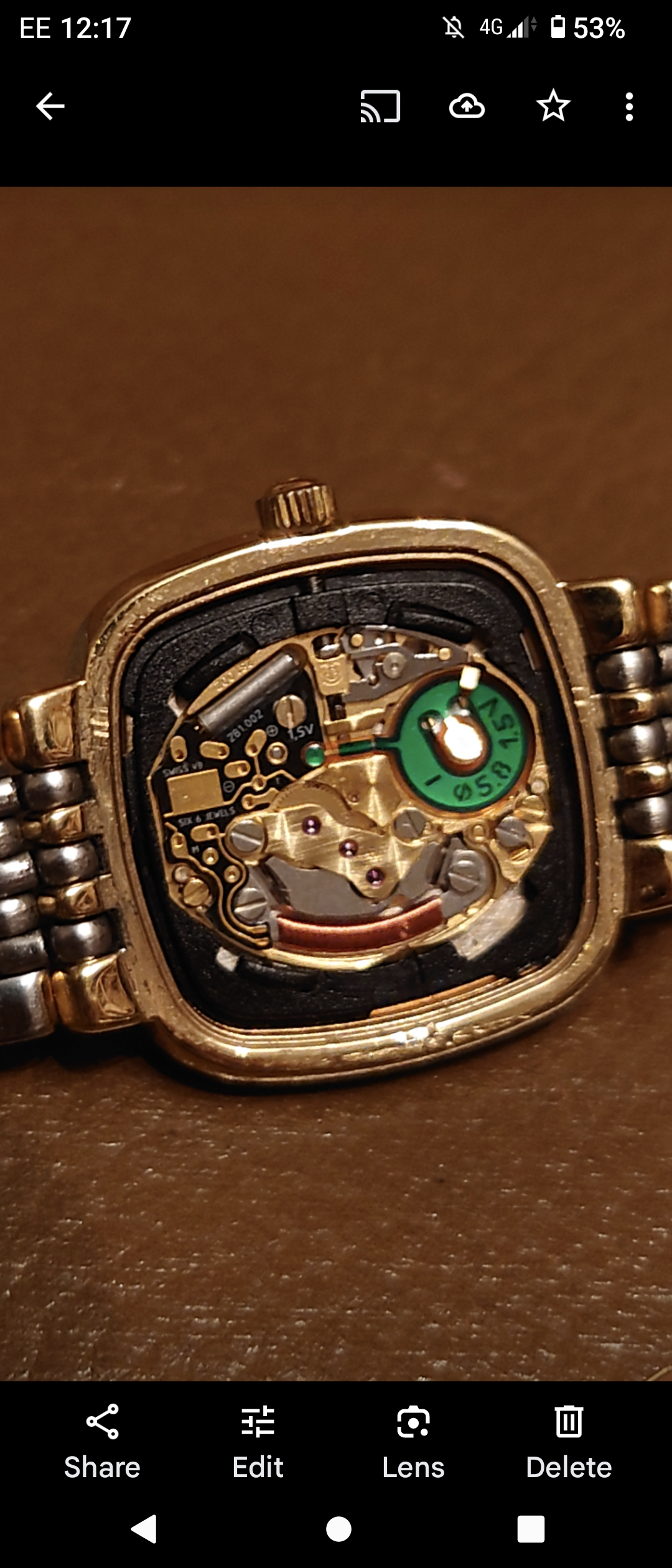

Posts 532 Likes 270 Wat-1 ·Dec 23, 2023 Archer Yes, Onega calls for a 335. Thanks I appreciate I've ordered one I did just see the coil and it's been nicked so it probably won't work lol
