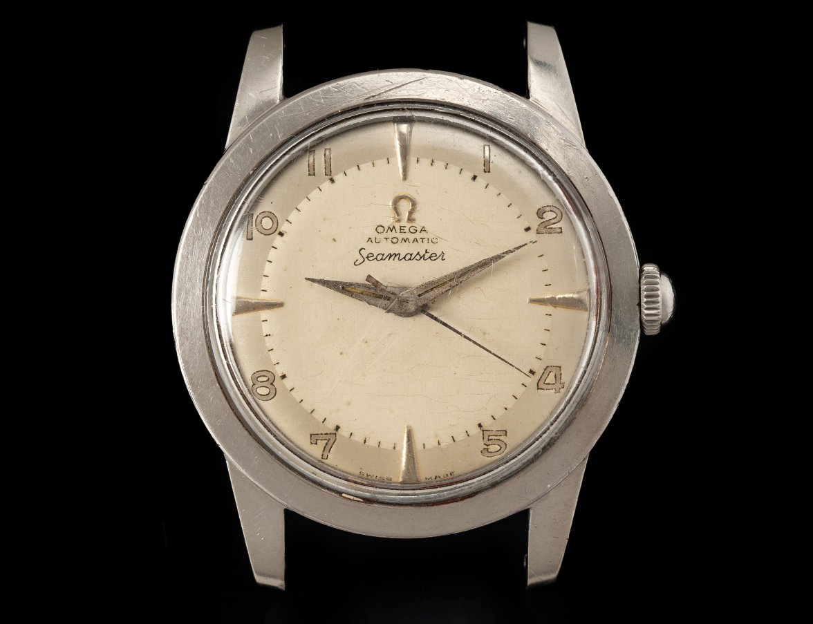

[Back from the watchmaker!] Your opinion on this working 1954 Seamaster

Thank you STANDY and kov, this is very useful. I will definitely get in touch with atelier h13.
Maskelyne, as I read your comment, I understand that STANDY meant no polishing of the case? But that crystal polish is something recommended? I personally think it could give a clearer look and I would go for it if possible.

The watchmaker will polish the crystal. 馃憤
( if it鈥檚 not an authentic Omega crystal he may be able to replace it with one if they are still available. If available it鈥檚 a no brainer to just fit a new one, also you will get the old one back in a little parts bag )

I agree with STANDY about the crystal. If you decide to polish the case, be cautious, seek knowledge and a person which not ruins the case.

I have a similar 2577-1 (bumper cal 351) which has lumed hands and it was made in 1950. @ConElPueblo what do you say about the hands? They are lumed and the indexes are not.
Beautiful Seamaster with an unusual, early dial! As the Arabic numerals are mirror finished, I'd say that the hands are replacements. If the dial had been lumed to begin with, there ought to be cut-outs at the arrow markers and/or squares for lume by the numerals 馃榾

Thank麓s and I agree. 馃榾

Gorgeous watch, congrats! Have it simply serviced and wear in good health 馃槈

Hello again!
I am in contact now with the watchmaker that kov mentioned. The watch will be serviced there.
I have one question for you: do you know if originally there was an Omega logo on the glass of this watch?
The watchmaker say that he can replace the glass with one that has an Omega logo on it.
Thanks in advance!

If he can replace it with a Omega Logo it鈥檚 a - Yes always.
Most do have a Omega logo.
There are plenty of generic crystals that would fit but I would always go for a Omega crystal even though it鈥檚 a more expensive option.
It may have been replaced at a service with a generic crystal. ( common practice years ago if the watchmaker didn鈥檛 have a OEM crystal )
That's what the watchmaker said.
Thank you for the info, now I am 100% sure about it!

I don鈥檛 think we are certain of the date of the OP watch but it may well have been made before the crystals were marked with logos. The crystal logo was introduced in the mid 1950s, sometime from 1953 to 1956 at a guess. For this reason it鈥檚 tricky to be sure if a 2577 crystal is original. I鈥檇 always fit a genuine crystal if one were necessary, but wouldn鈥檛 swap a plain one out for lack of logo for this reason.
I respect your opinion, but as you say it麓s more expensive and I don't see any reason to use a crystal with a tiny expensive logo.

I don鈥檛 think we are certain of the date of the OP watch but it may well have been made before the crystals were marked with logos. The crystal logo was introduced in the mid 1950s, sometime from 1954 to 1956 at a guess. For this reason it鈥檚 tricky to be sure if a 2577 crystal is original, but of course if it is logo marked it most likely isn鈥檛! I鈥檇 always fit a genuine crystal if one were necessary, but wouldn鈥檛 swap a plain one out for lack of logo for this reason.
I wasn鈥檛 sure the date of watch, but he will get the crystal back.馃槈
Not sure the OP is one of us yet 馃榿 so I can see him wanting a new crystal and a new crystal will have a Omega logo.
@Mike2222 it could be a original crystal that came before the Omega logo was used so a purist would not change it.
I have a 1953 Seamaster with a very old, signed crystal. So faintly engraved that the watchmaker who serviced it recently couldn't see it. Of course, I don't know if it is the original crystal, but it did have a very low profile that isn't available on replacement crystals.

Its a tricky one alright. I couldn鈥檛 find a definitive or academic answer for the date after a cursory search, just conjecture, like my own! What muddies the water of course is that they were routinely replaced at service time with a logo model. There is enough doubt to make me think twice about knocking a watch from before around 1955 for not having one but as Standy says, all thing being equal it鈥檚 a nice thing to have!
As many watchmakers over the years have said at least you know a Omega is a 100% fit and not a 99.3%
I always find it a bit funny when people insist on saving the old crystal because "it's the original!". Well, there's no way of knowing, is there?

One rule of thumb I use, half tongue in cheek is that if the crystal logo is lined up perfectly then it has definitely been replaced!
Well I just decide if I want麓s my watchmaker to replace the crystal with an original one or not. I leave the rest to him, I trust that he can order what he needs for the job.
