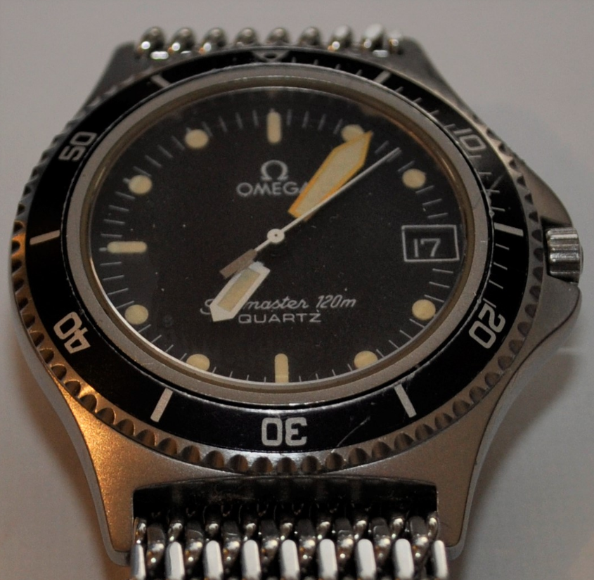

If anyone here can suggest where I might get one of these repaired properly at realistic I’d be very pleased to hear, as I’ve tried already many repairers but none have fully succeeded and the watch now functions as it should but exhausts batteries approx every 12 weeks which obviously should not happen.
I know the only source of replacement movements is now Omega in Switzerland themselves but if there is anyone out there able and willing to take apart fix and rebuild existing I’d love to hear from them.
Link to pic of actual watch here
https://www.evernote.com/shard/s74/...a391d6109651/cc60ab65758157657b14b047e08b0ac8
Thanks
David

Omega did have replacement 1337 movements but that was a few years ago now, the watchmaker who serviced mine has retired unfortunately, it’s a Calypso as pointed out above, the baby ploprof is an automatic seamaster.

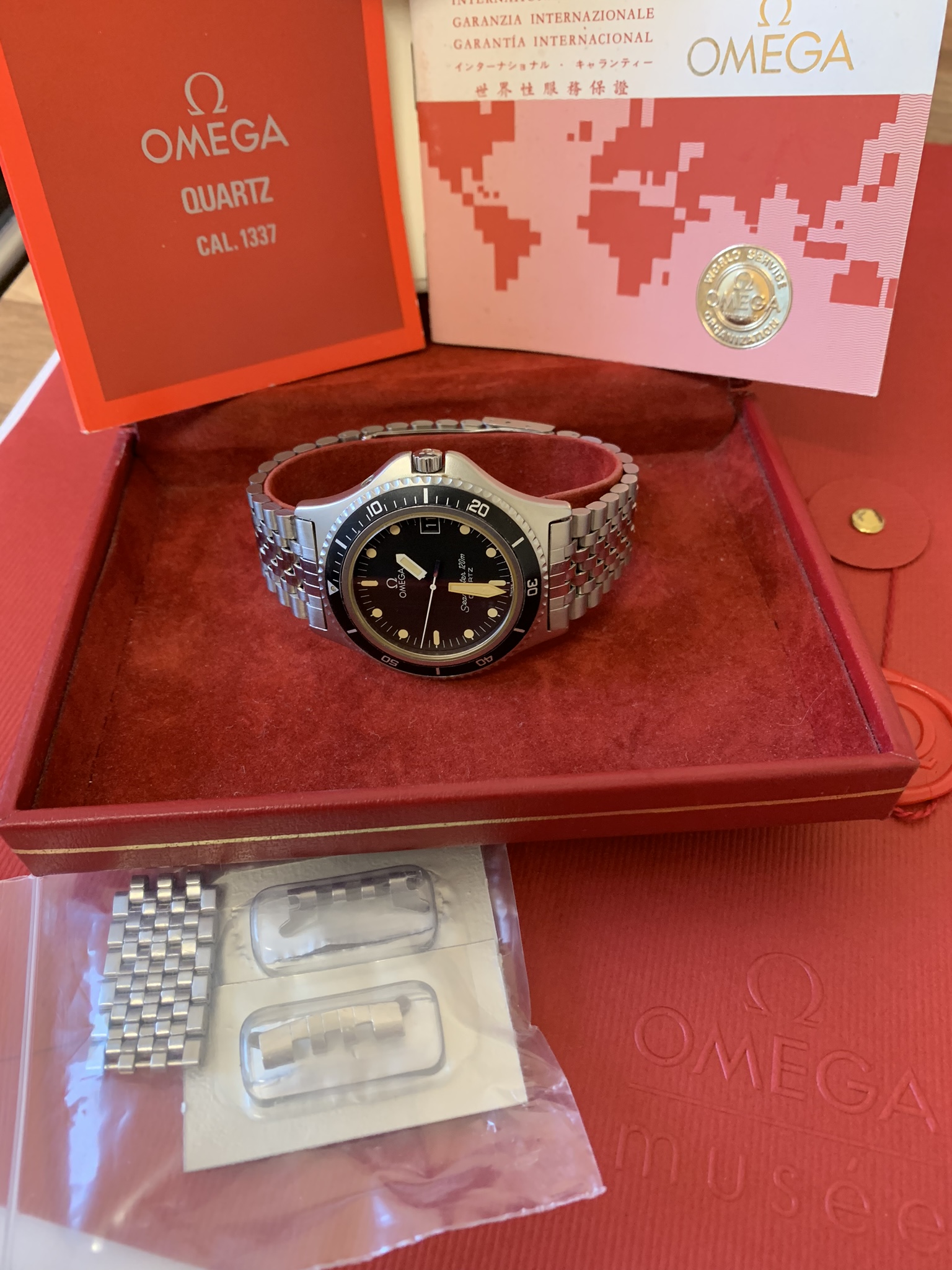

I’d like to find one from 1982, not a ton of good looking birth year watches for me from Omega that I’d really enjoy wearing often, this is one that’s been on the list to keep an eye out for.
