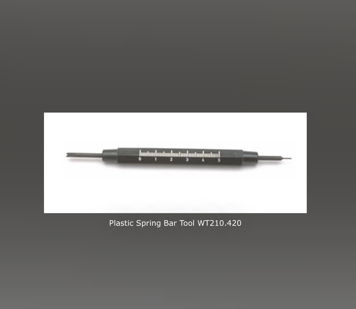

For bracelets, I highly suggest buying something like the Bergeon 6825.
Practice 10x on a cheap watch. Remove the clasp on one side first and make sure to tape the lugs of your Omega.

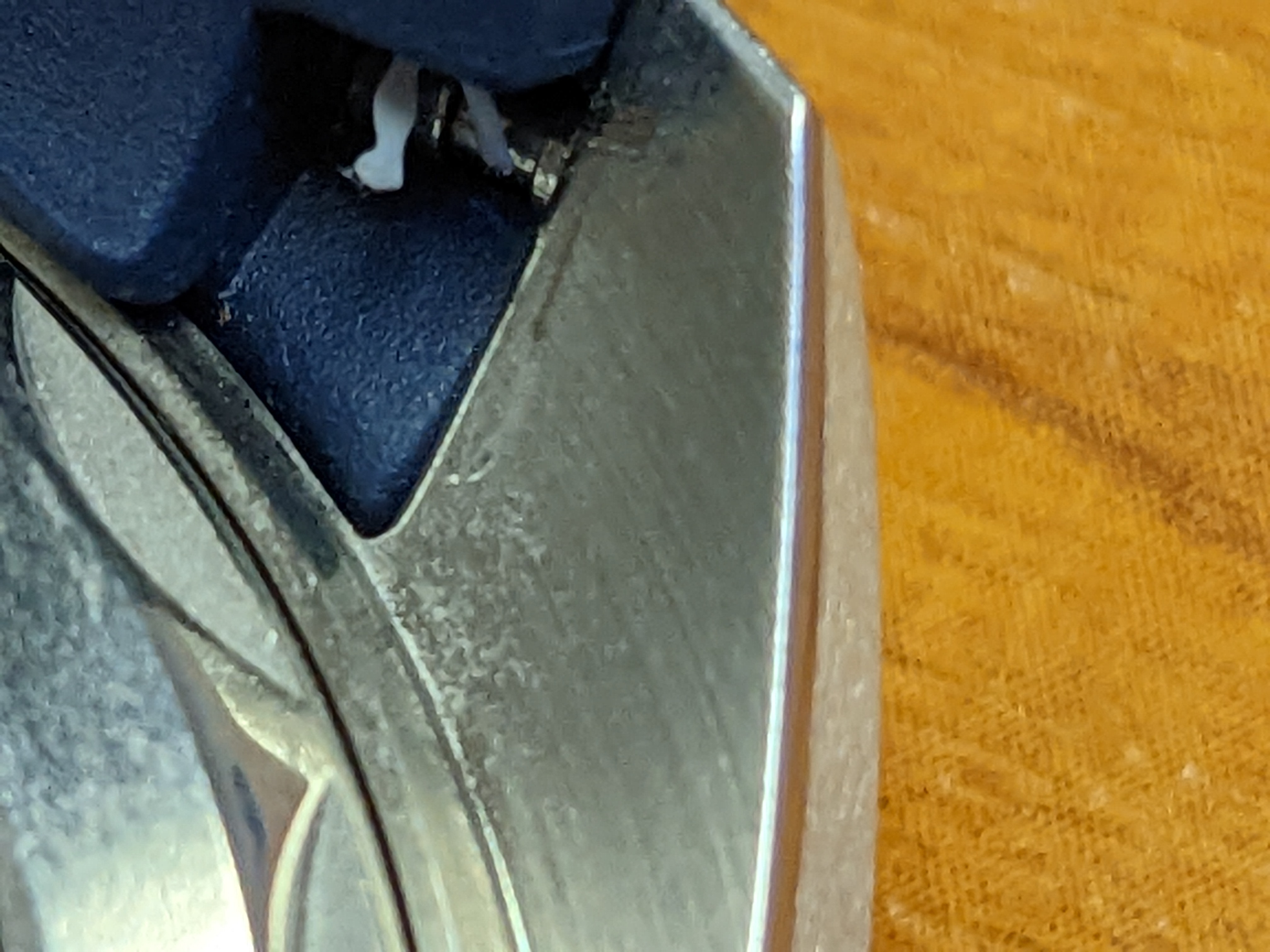

Sigh. I was worried about that. Ironically I bought it after getting my AT (removing the bracelet with the 6767F was like defusing a bomb). Would changing to different spring bars (19mm, lol) make it easier to use the tool or is the Bergeon 7825 better? Honestly, I was trying to practice using the 6825 yesterday with my Sinn U1-T (fully tegimented case and bracelet) and even then it was just nowhere near as easy/smooth as the video above - one fork or another would lose the spring bar both when removing and re-inserting the bracelet. Very frustrating since I have pretty steady hands and was looking up close (very nearsighted at a baseline.

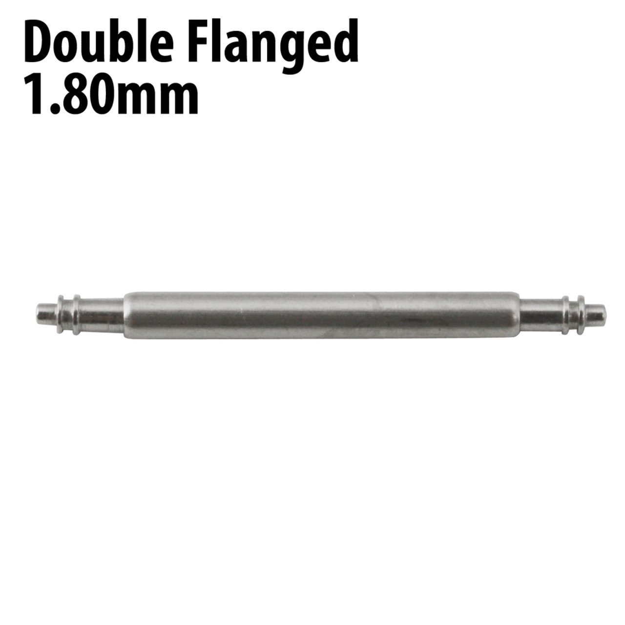

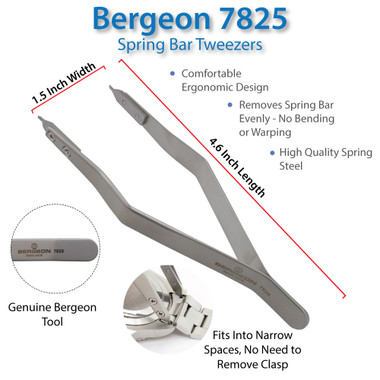

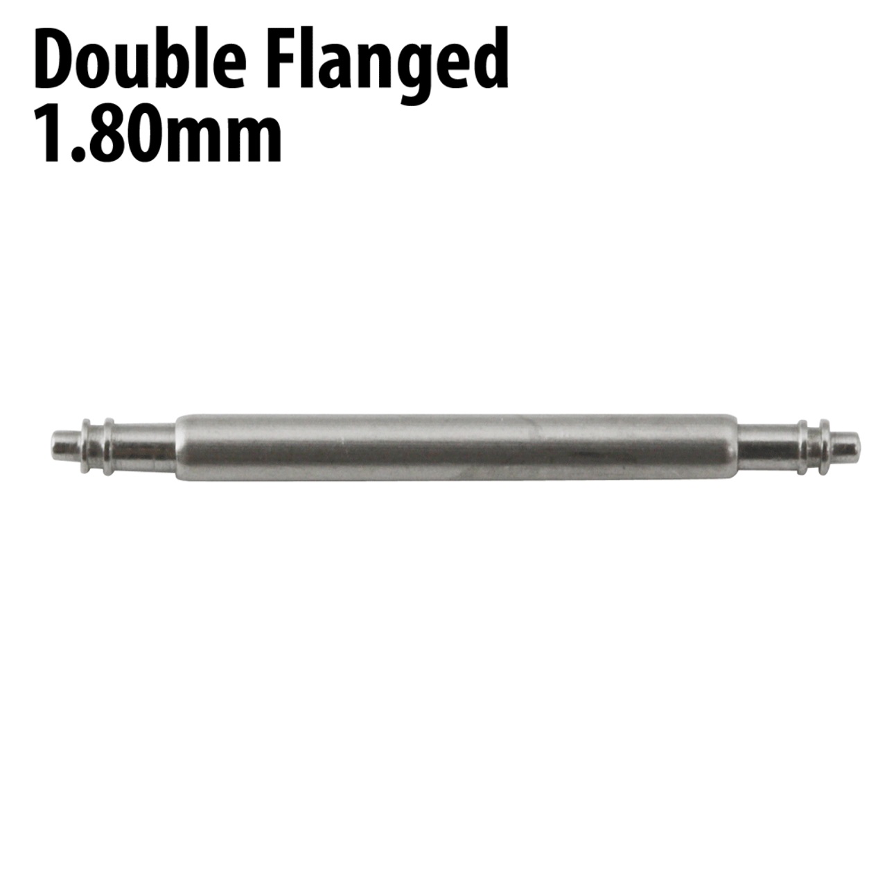

That said, I've found the Bergeon 7825 tweezers to be the easiest to do a clean job. I also recommend switching your springbars to something with a very defined double flange on the ends. Obviously get the correct thickness and length as the OEM springbars. And then I put the OEM springbars back in the box for the watch so I don't lose them.

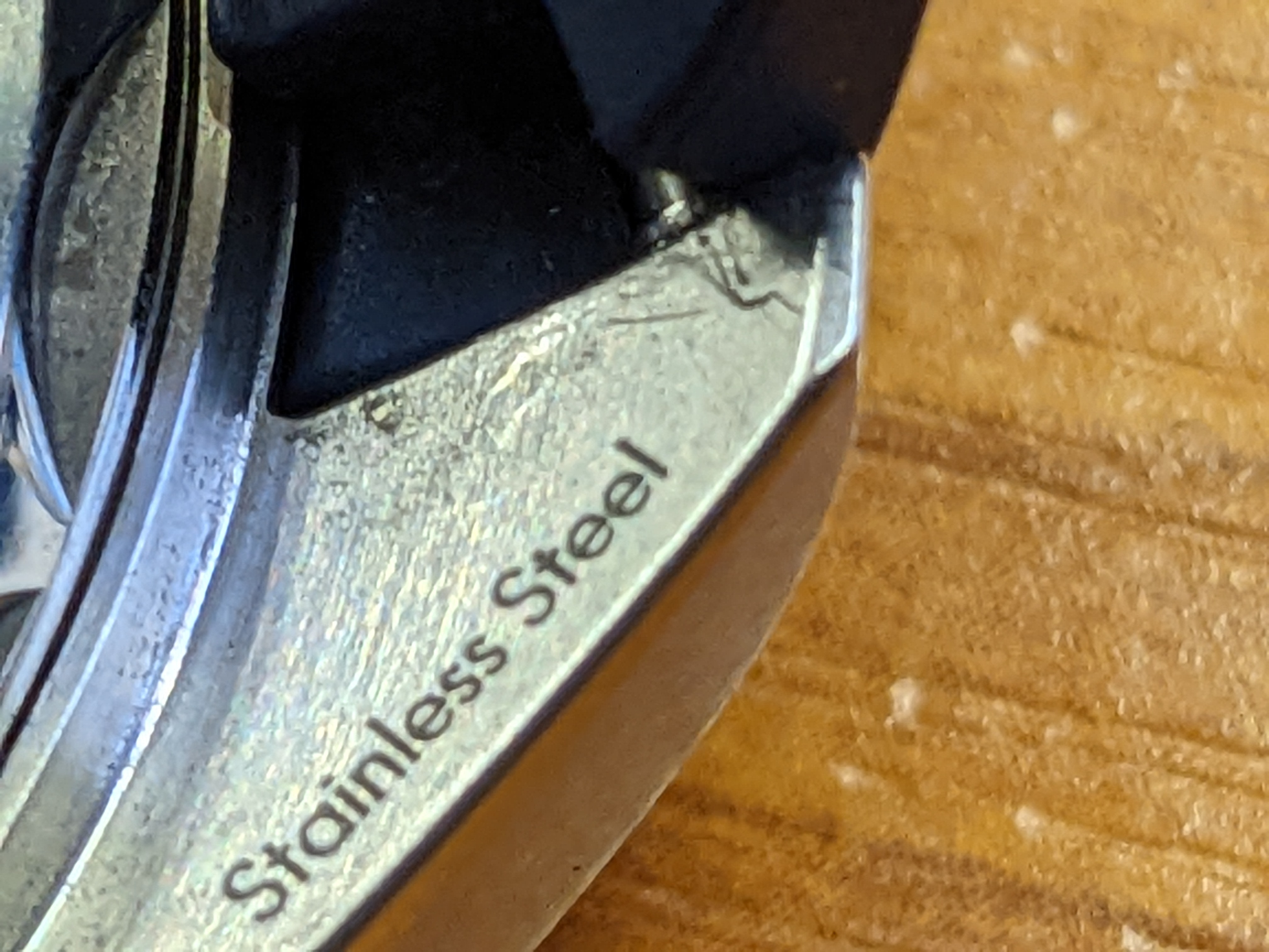

FYI, whether it was a mistake or not, the scratches on lugs on mine weren't touched at last Omega service.
The rest of it was restored beautifully, but the lugs on back came back scratched. Mistake or... they don't do them, or did it putting the bracelet back on. No idea, but not bothered about that.
I actually ordered those exact spring bars from Esslinger (unfortunately not with the 7825, but did order some other things to take advantage of their Anniversary sale including different/more tips for the 6825....which I had done the 7825). Been working on my technique with the rubber strap and gonna change over from Delugs straps to the Omega rubber on my GoodPlanet 38.5mm AT this weekend...
