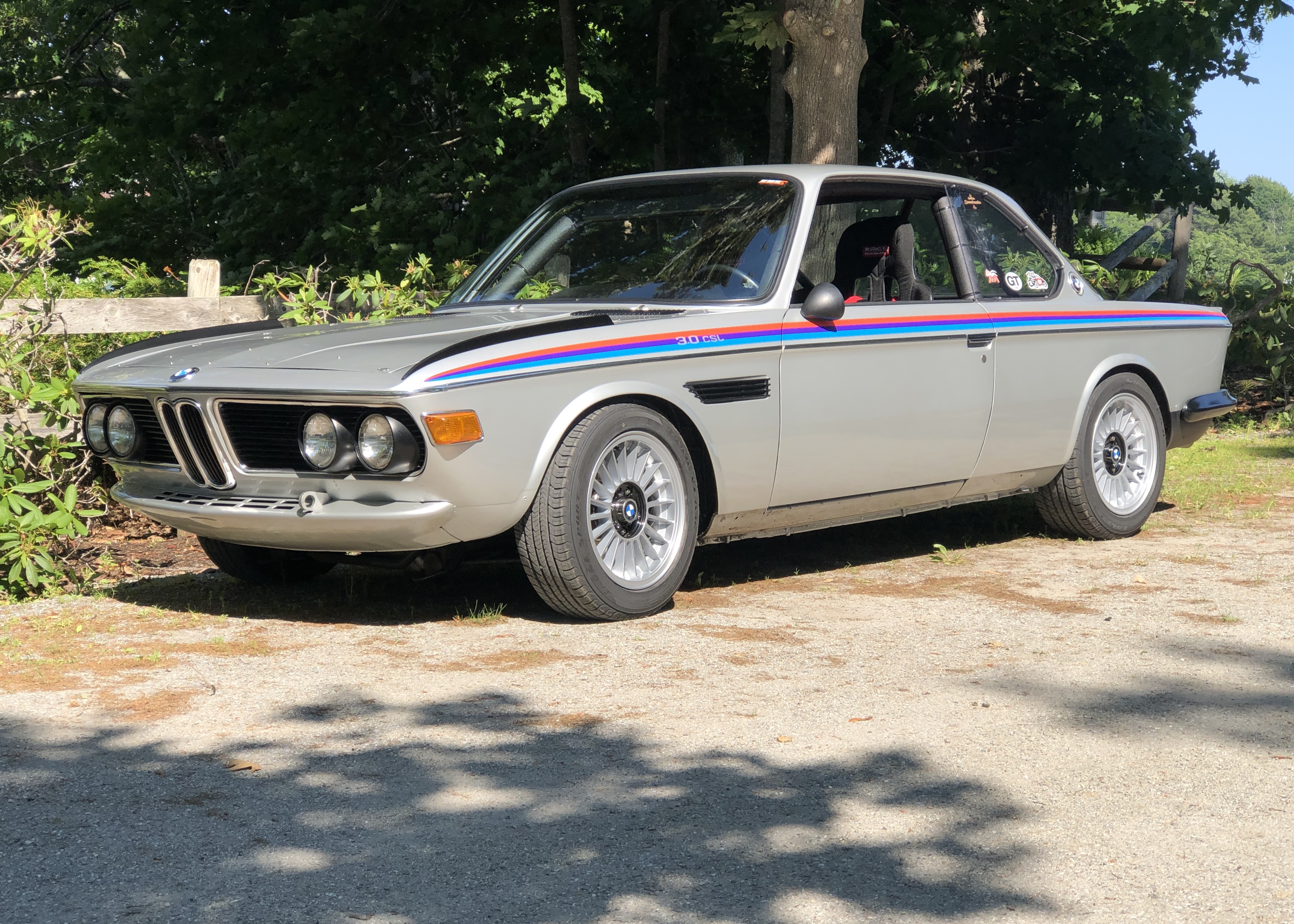

No, it’s not a true CSL. It is a US delivery CS to which I added a bunch of “Liecht”.
And I imagine the thinner gauge steel on the true CSL’s may have the same weirdness to the alloy.

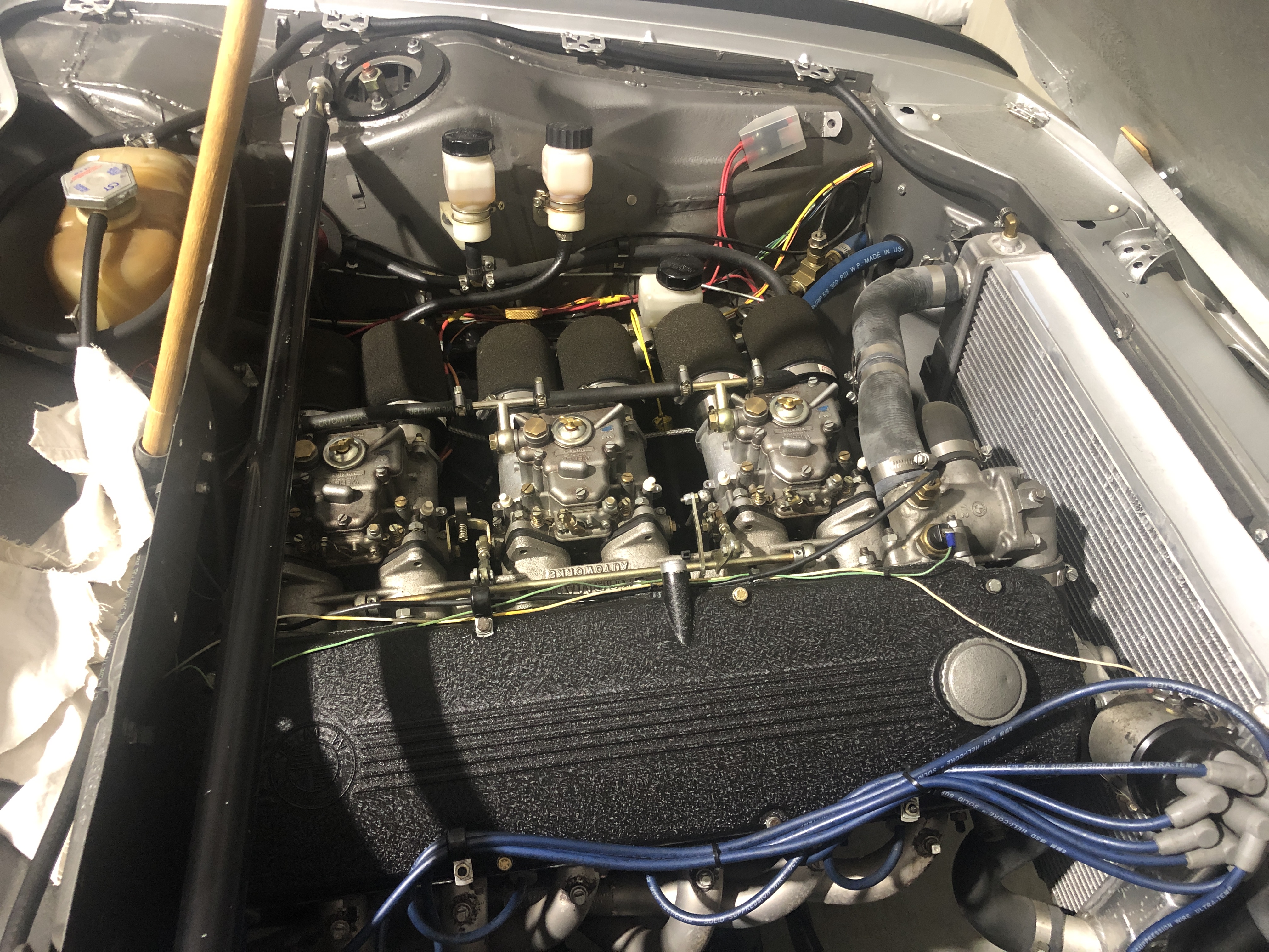

I have an M88/3 that was going to go into it back 20 odd years ago. The S50 would have been wild, but either of these motor choices would not provide quite the period vibe I was looking for at the time. At that time M90’s were relatively available at a price I could afford-as were CR dogleg gearboxes. This motor has a trick CNC ported head and big ole domed pistons that were available at that time. And I had always wanted to learn how to tune Webers, which is quite a rabbit hole - in and of itself. This motor dynoed at 280 pounds feet and 298 hp at 6200 on a 300 degree cam while running on Sunoco 110 octane. A bigger cam would bump the power up even more at a higher RPM peak, but at the expense of street driveability.
all this stuff is a slippery slope as you all know. And I needed to figure out where I could effectively play on that slope. I’m happy with it as it is and this car deliverers big grins to me every time I run it.

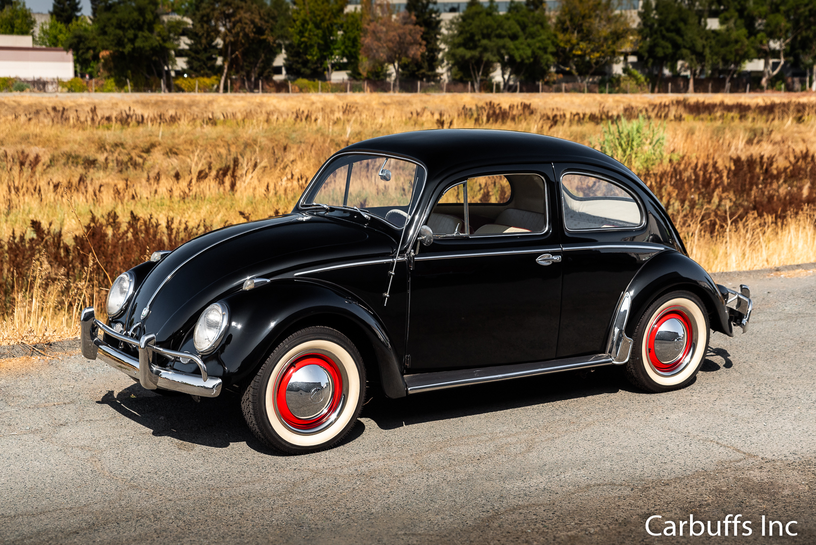

I have a soft spot for VW Bugs, and that looks like a lovely '59. From the era many think was the best for the Bug - the 'classic look' rear window, but still small windows all round, sloping headlights, long rear engine lid etc.

I bought this one as a clean rolling shell 21 years ago now. Even back then it was tough to find a good one. As you know, The Karmann supplied sheet metal is some weird steel alloy that rusts -even when you look at it funny 😉 . It took some practice to MIG weld Coupe sheet metal when compared to American “iron”.
Triple webers on a 12.5:1 M90, mated to a C/R dogleg 5 sp. gearbox in this one. 2596 pounds empty weight when run across the scale at the dump last time through.
I can not see the M90, you mean the block ? that obviously can not be seen in the pics
it looks to my untrained eye like an M30, maybe also B30, or B35 ?
at least the head (year stamped 79) is the conventional M30 one, not mechanical fuel pump open rod, and quite an odd distributor, sort of big one,
I am not an expert on M90, forgive me if i am wrong, but i know quite a bit about M30´s having overhauled a handfull of those by myself
that is VGS ports to the webers ?

M90 is a combination of an M30 single cam head with M88 bottom end resulting in a shorter stroke, larger bore 3.5L version of the M30B35, so it allows for high revving, high compression single cam builds. With an upgraded valve train you can rev past 7000 very easily which isn’t bad for a big boy like that.

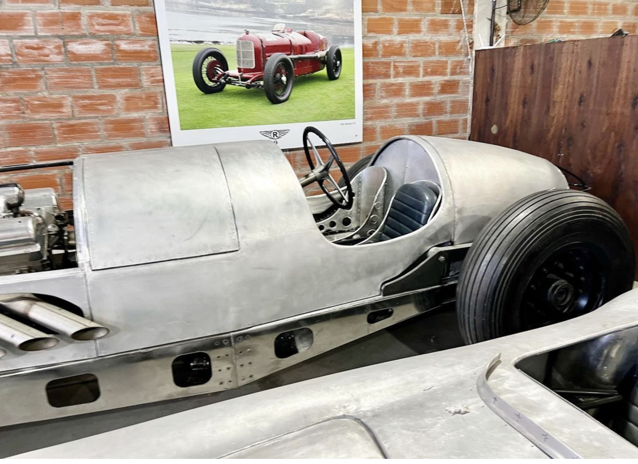

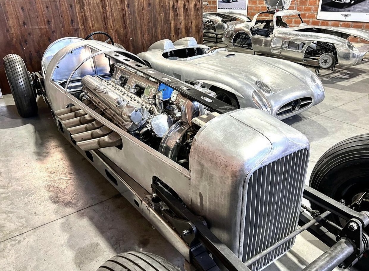

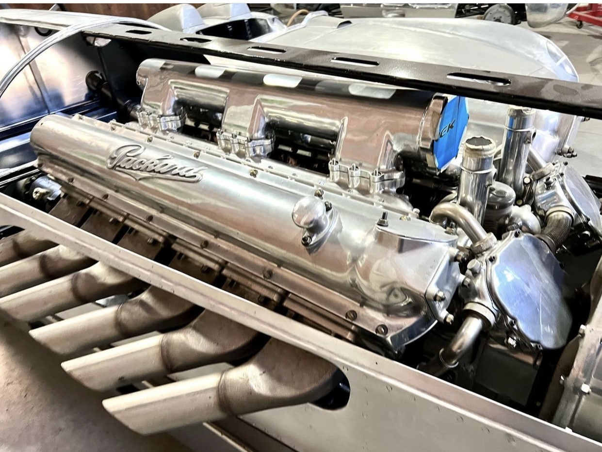

1600 hp aircraft engine 1940
I think that is actually a marine packard engine, not a merlin
