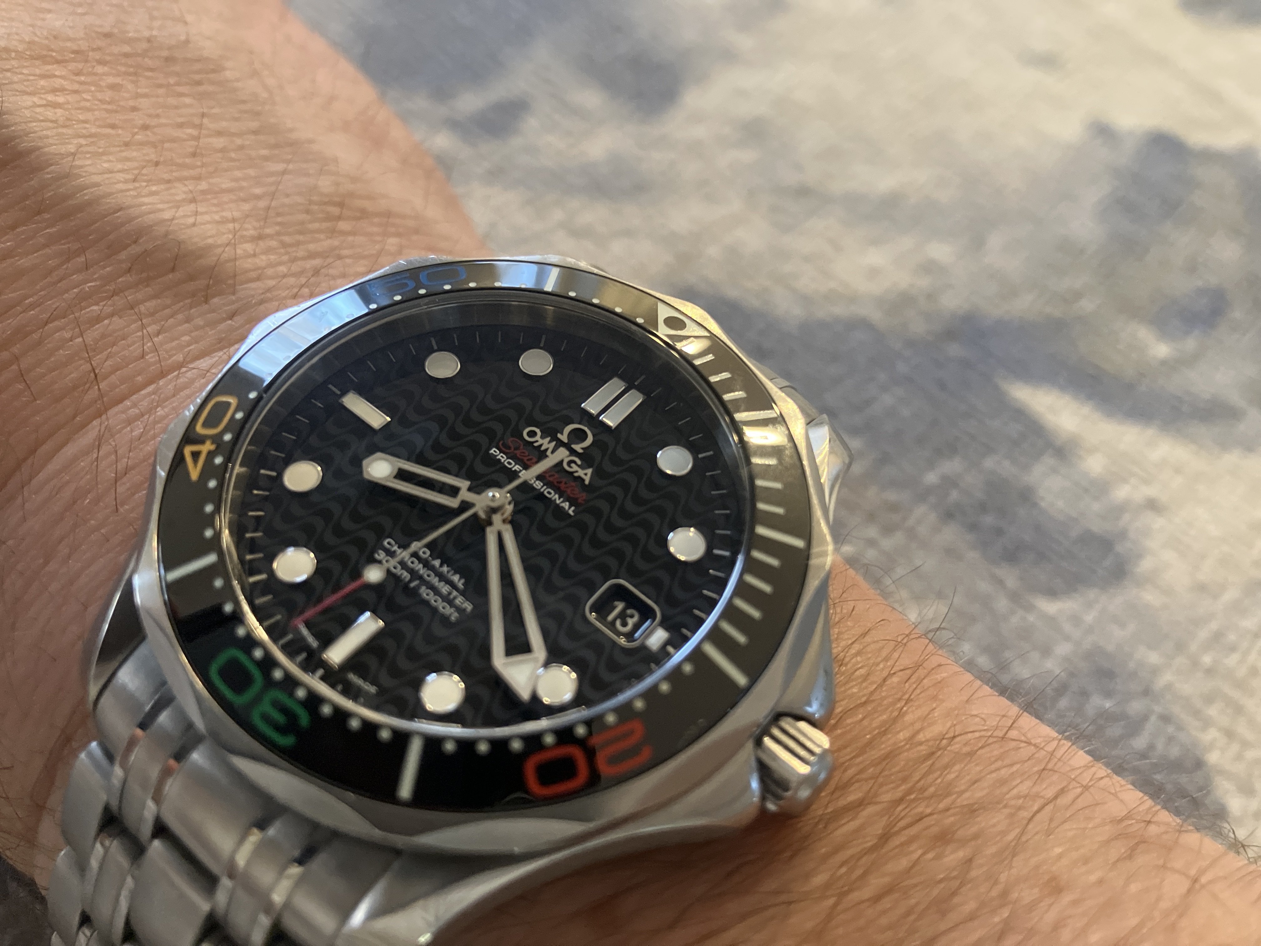

My question: I’ve noticed that the watch doesn’t seem to recharge with typical wear. I wind it fully (70 good turns) and wear it for two days—and I’m pretty active during those days—and then the watch stops in the middle of the night. This doesn’t happen with any of my other automatics. …What’s up with that?
It seems to have its full power reserve. And I know the rotor isn’t stuck because I can hear it moving around when I rotate the watch. So I’m guessing the issue is that rotor is somehow no longer engaged with the winding mechanism—? Does that seem right?
SWATCH will sort it—I’m just curious.
Obligatory wrist shot.
