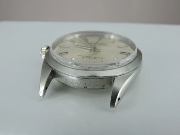

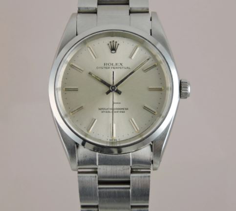

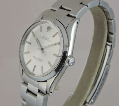

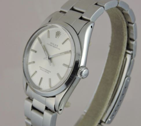

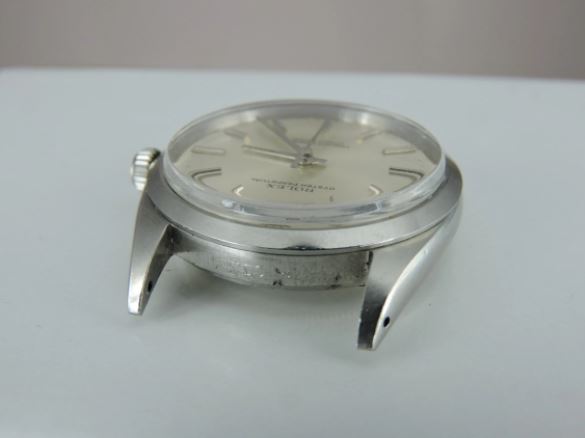

Hi,
I hope you are all good and that you're having a great having weekend.

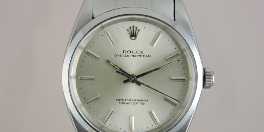

In the near future, I plan to buy I vintage Rolex - knowing that this is a mine-field since I have little knowledge in this field. Therefore, it would be helpful if you can support me with your opinion on this Rolex 1018.
Is the watch - in your opinion - overall in good condition (case, dial, hands, bracelet, crown). My opinion:
Case: Has seen slight polishment but is - overall - in good shape.
Dial: I've seen this model with "long" indices (as this offer has) and "short" indices. Is this version with "long" indices authentic? Overall I cannot asses whether this is a redial or repainted dial. Would be very happy if you can help me.
Hands: Look in general authentic to me - however, are those hands authentic for the model? The reason is, that I've seen other offers with dauphine hands.
Bracelet: The offered watch comes with the reference 78360 and 558 endlinks - is this correct for this model?
Crown: Not assesable for me - help would be very appreciated.
Thank you in advance and have a great day ahead!

Hi there,
Case looks good, make sure it has a correct caseback and check for corrosion between the lugs and in the caseback threads.
Dial: the earlier ones had the short indicies in the positions that are not 3, 6, 9. It could be a service dial, but could be a dial from a 1002. If you look around the edge at the bottom of the rehault, you can see what may be the edge of the dial (indicating a smaller dial), ask for higher resolution photos.
Stick hands are correct for this dial and the earlier dial. Dauphine hands are for 1965ish and earlier. the pics are too low resolution to see if they are the correct length, but they look OK.
78360 is a later bracelet and the 580 endlinks would be correct I think. these 558 ones are pretty ill fitting, but this slim case is a difficult fit.

Excuses for my late response and many thanks to both of you for your answer. Especially the reply from vibe was really helpful, very much knowledge here in this forum I guess 😀 In the end, however, I didnt buy the watch mentioned in my original post.

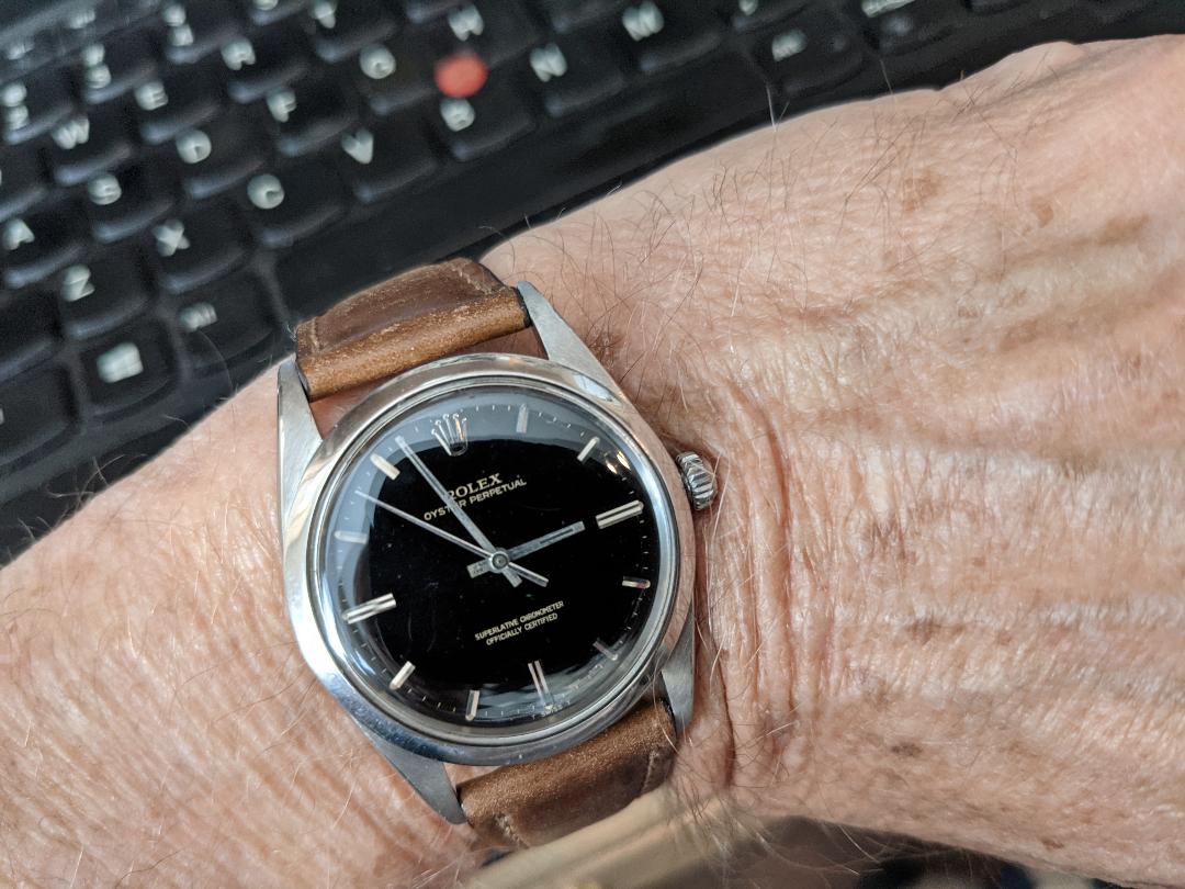

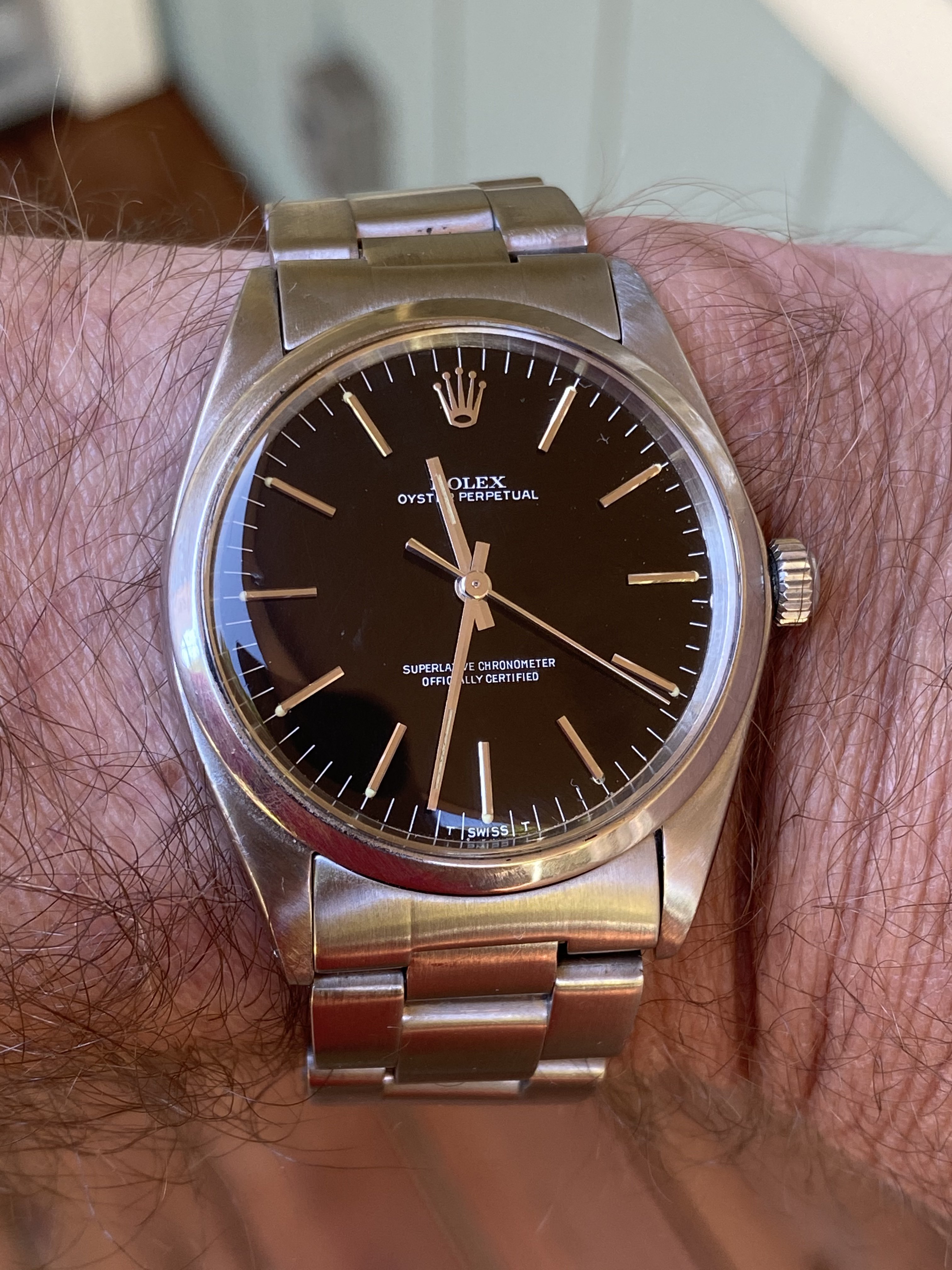

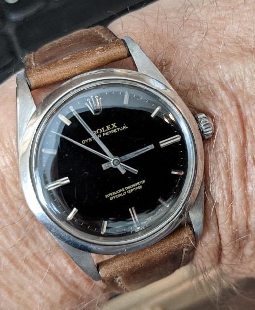

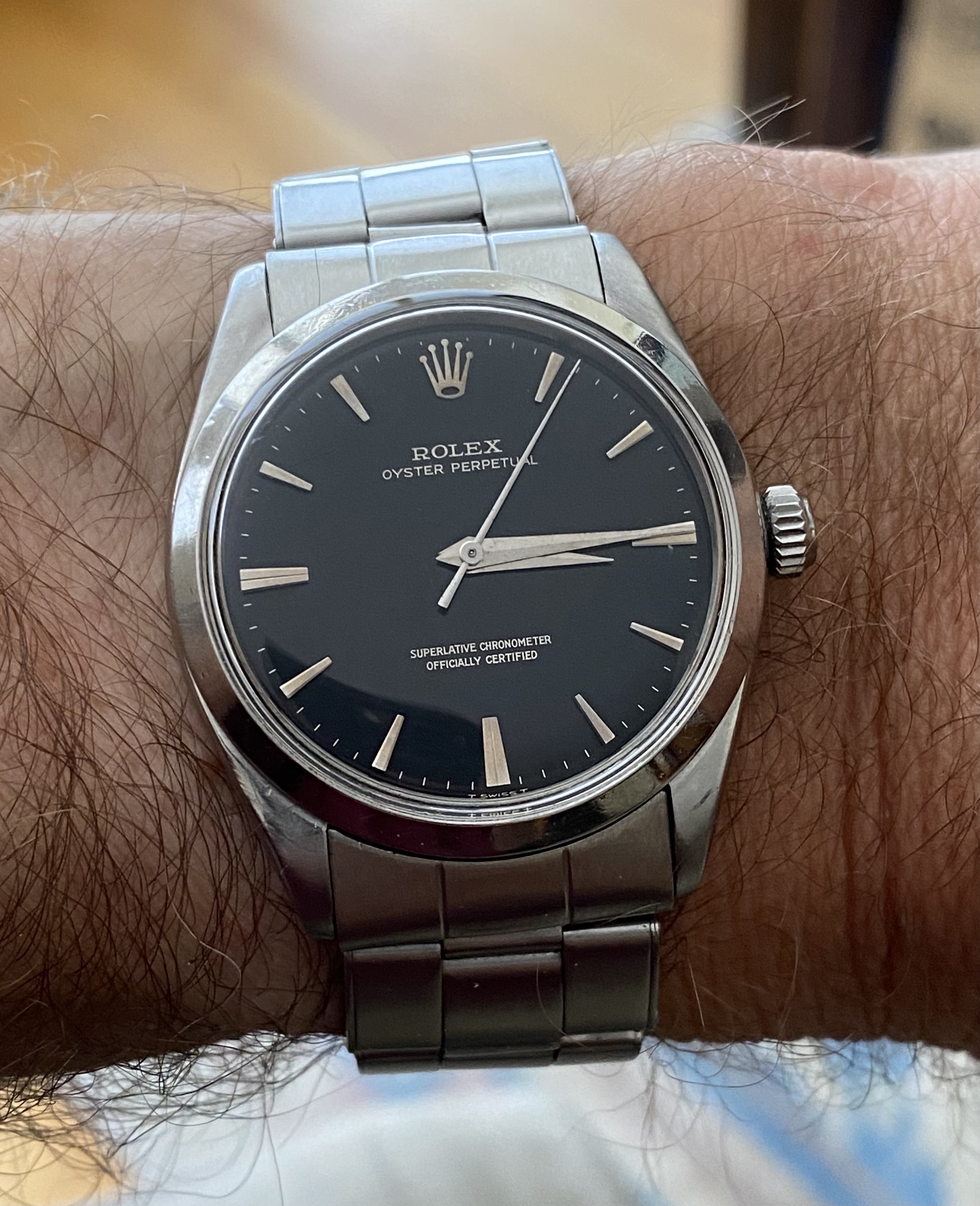

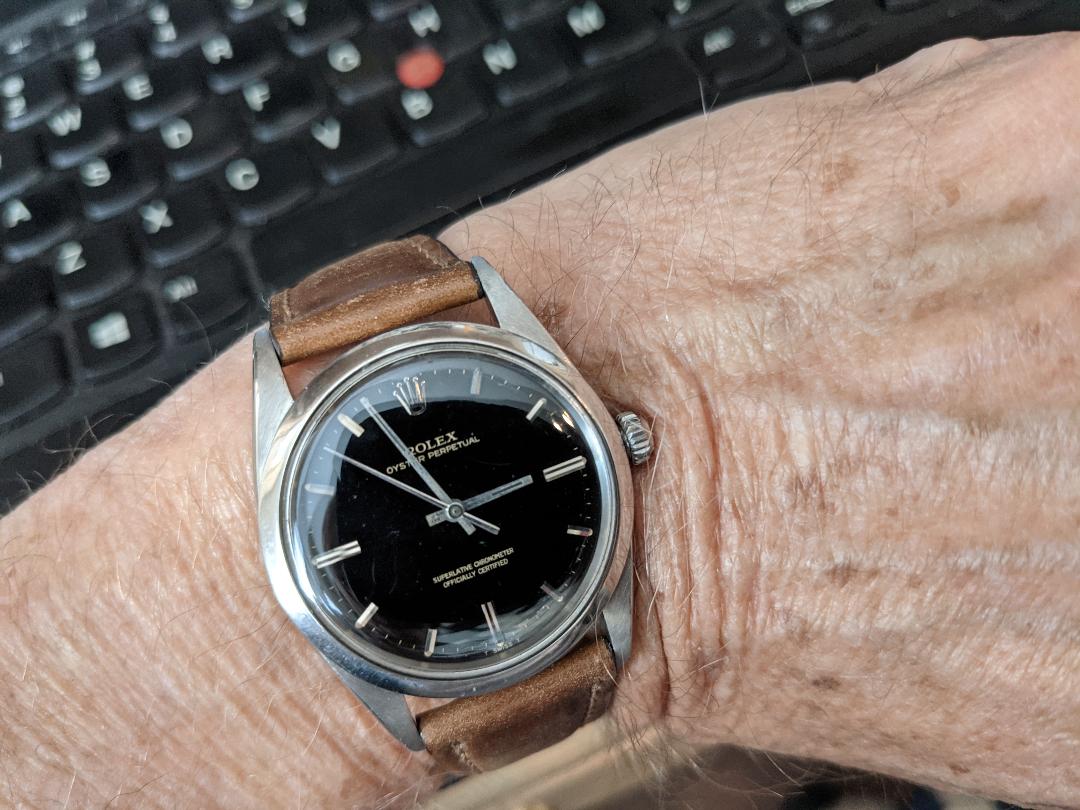

A good buy. The long markers and stick hands are true to the second generation that happened in the mid to late sixties. The earlier versions with the shorter markers are the first generation, and also had dauphine hands. Those models with stick hands had the hands changed, probably during a service. I just bought this glossy black gilt dialed version yesterday for $5,800 plus a watch in trade. I have only seen 3 examples of this black dial in the last 20 years. The 1018 is often considered the business suit verion of the 1016 Explorer (same size case but with smaller crown and case tube) and is often used to create "fake 1016s." I personally prefer the 1018 to the 1016 as a daily watch, just a more subtle look.

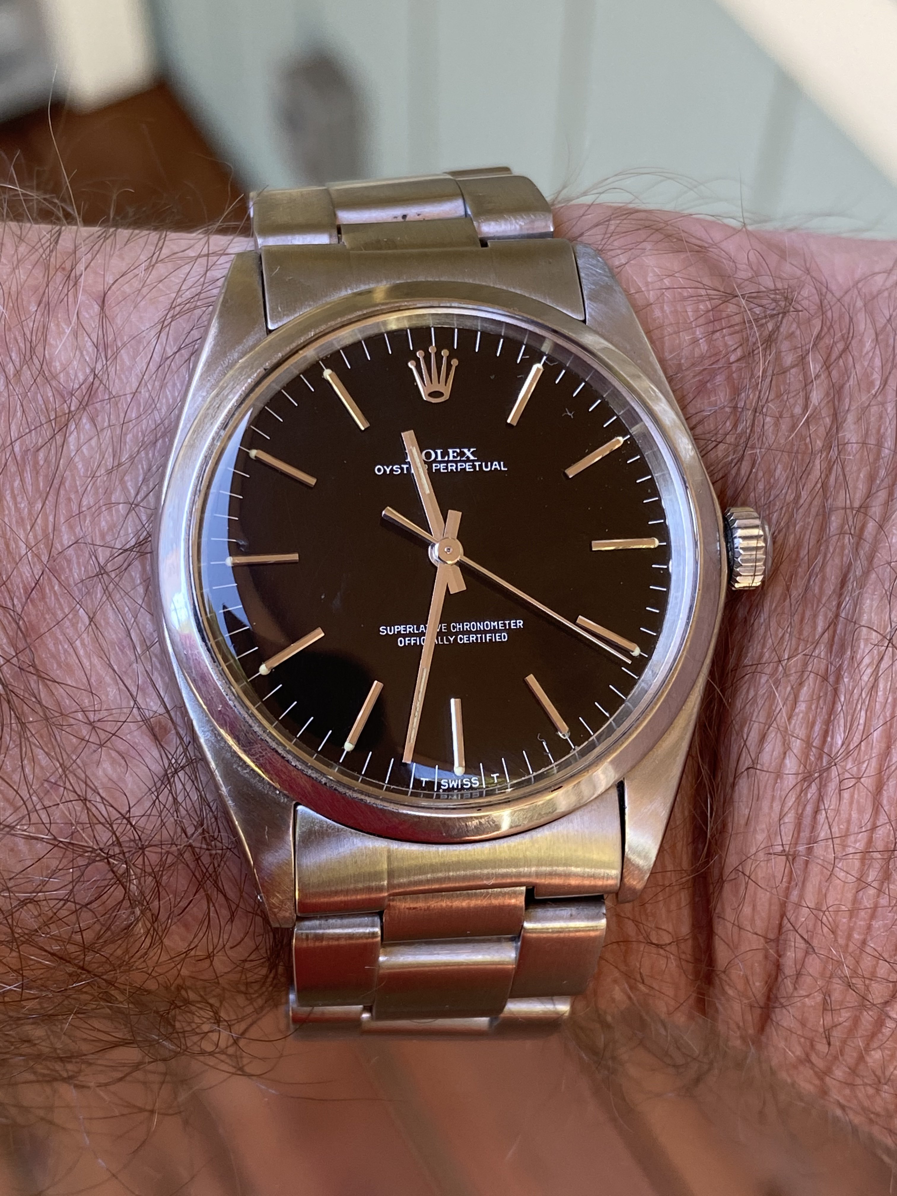

2,519
17,844

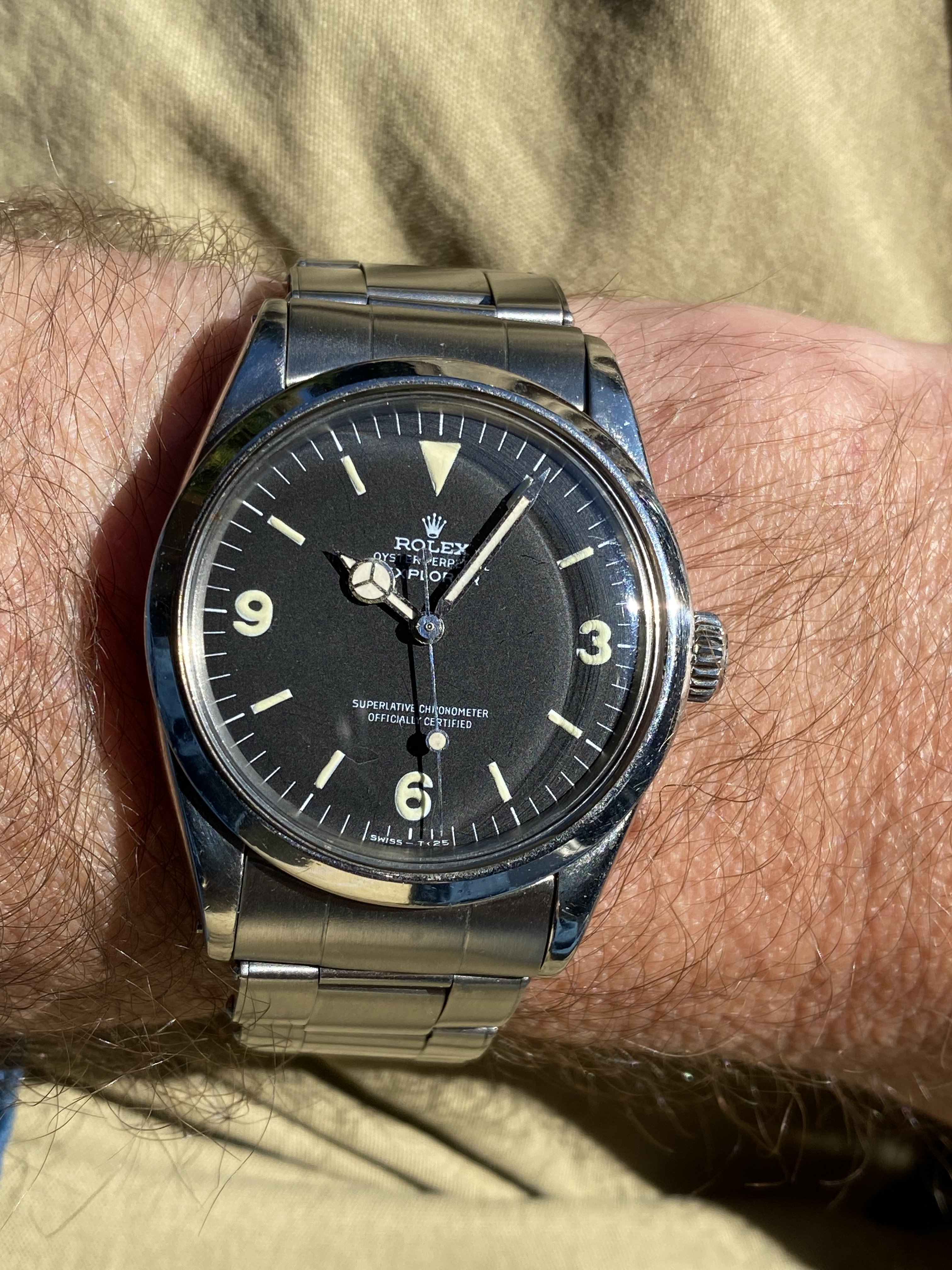

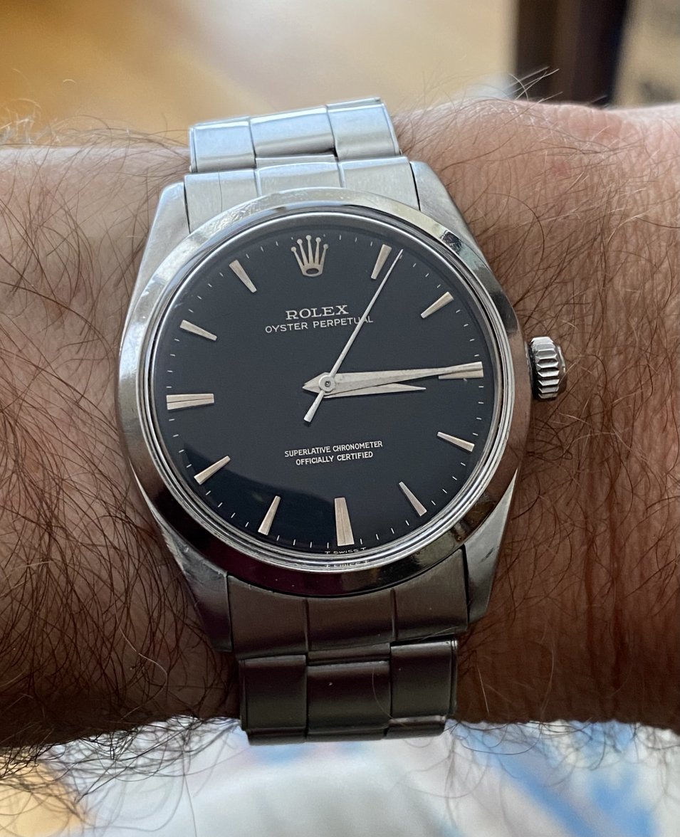

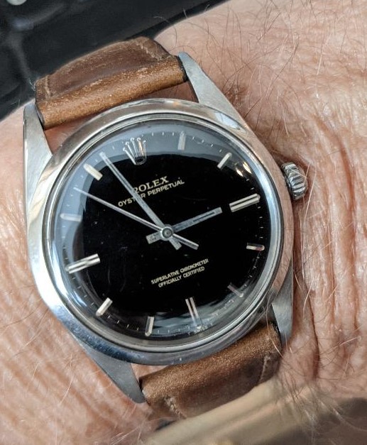

the 1018 is an oddball but a perfect slim case that is more flat and a better size than a 1002.
So, I have a few 1002s, a 1018 and 1016. I think a 1002 fits me better than the 1018 and tend to prefer wearing one.
And I still prefer my 1016 over the 1018. I fell in love with the dial the first time I saw it and still feel that way about it, even though the 1018 has an amazing glossy black dial that I enjoy.
(But, if I’m honest, I no longer feel comfortable wearing it, given how much they’re going for these days. 🙁 I never thought I’d get to that point, as I've owned it for 35 years, loved it and worn it more than any other single watch I own. I’d be heartbroken if something happened to it and probably couldn’t afford to replace it.)
(My 1018 is from 1969 and has later (correct) service hands hands and dial.)

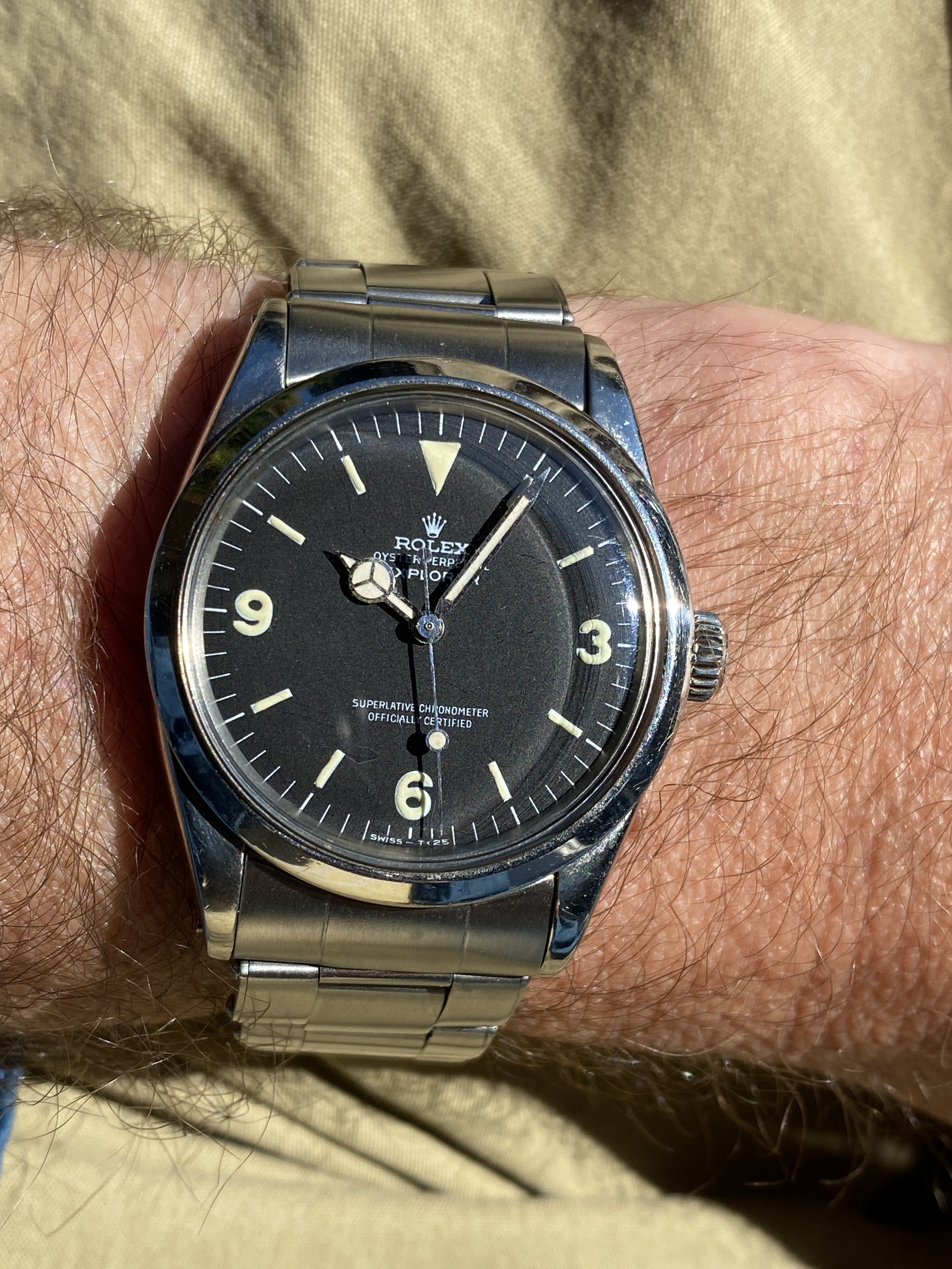

All three of your watches are stunning. Each one a unique face that deserves wrist time. I think the Explorer is well known by collectors and enthusiasts, but it still might be too subtle for modern day thieves. They tend to chase the more obvious...anything that looks like a Sub or is gold. At the same time, an Oyster bracelet does send up a red Rolex flag and draw attention. Have you considered using a leather strap as a way of dressing it down even more? I speak one way but do another...waiting for delivery of a very nice 1969 steel Rolex Jubilee for my 1018.

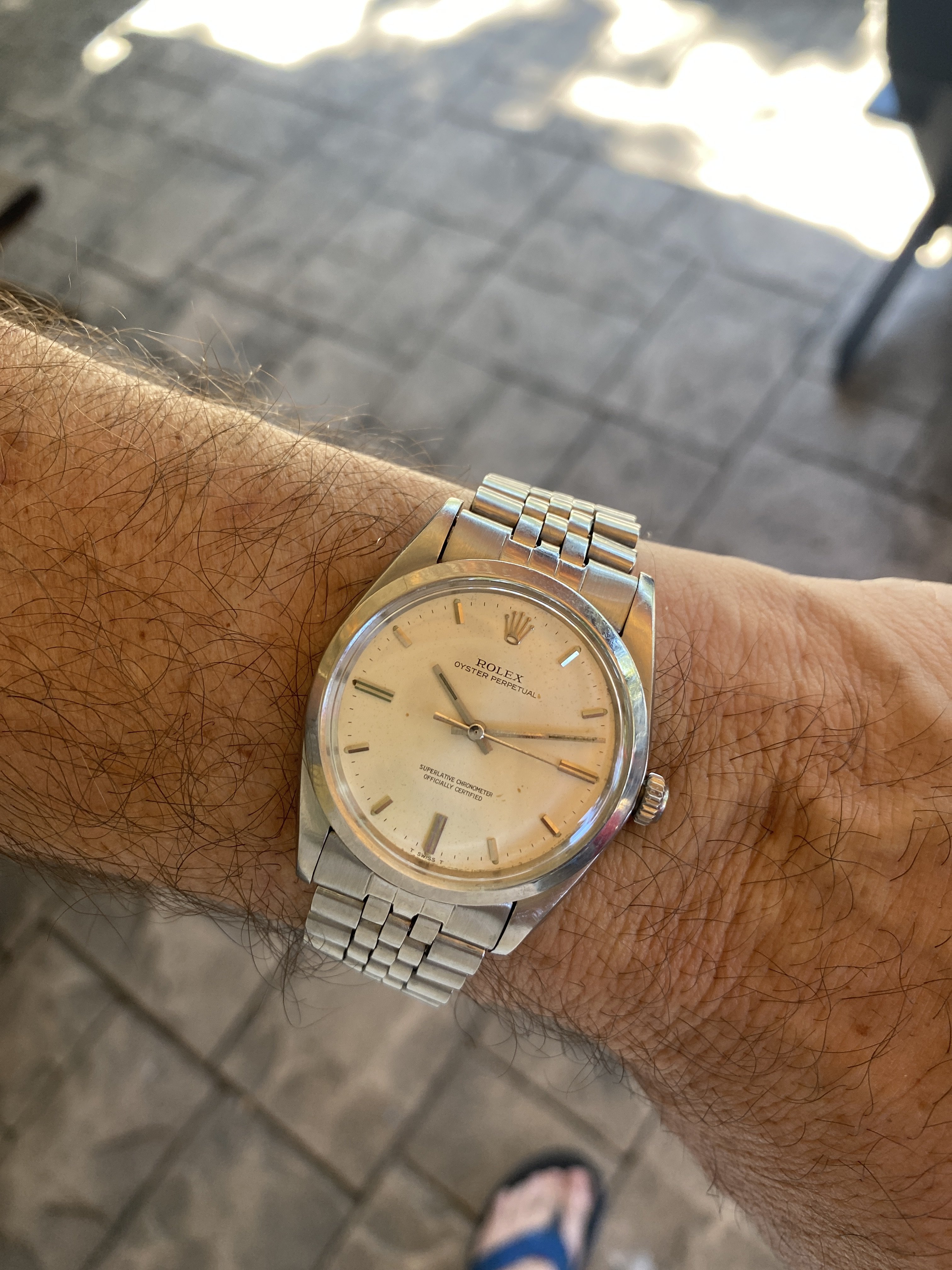

Hello John !!!
Welcome to the forum. How the heck are you ?
The love of the uncommon non rotating bezel Rolex club!
Here are bad pics of my 1018 and my 1013 ….. These are just for John !
