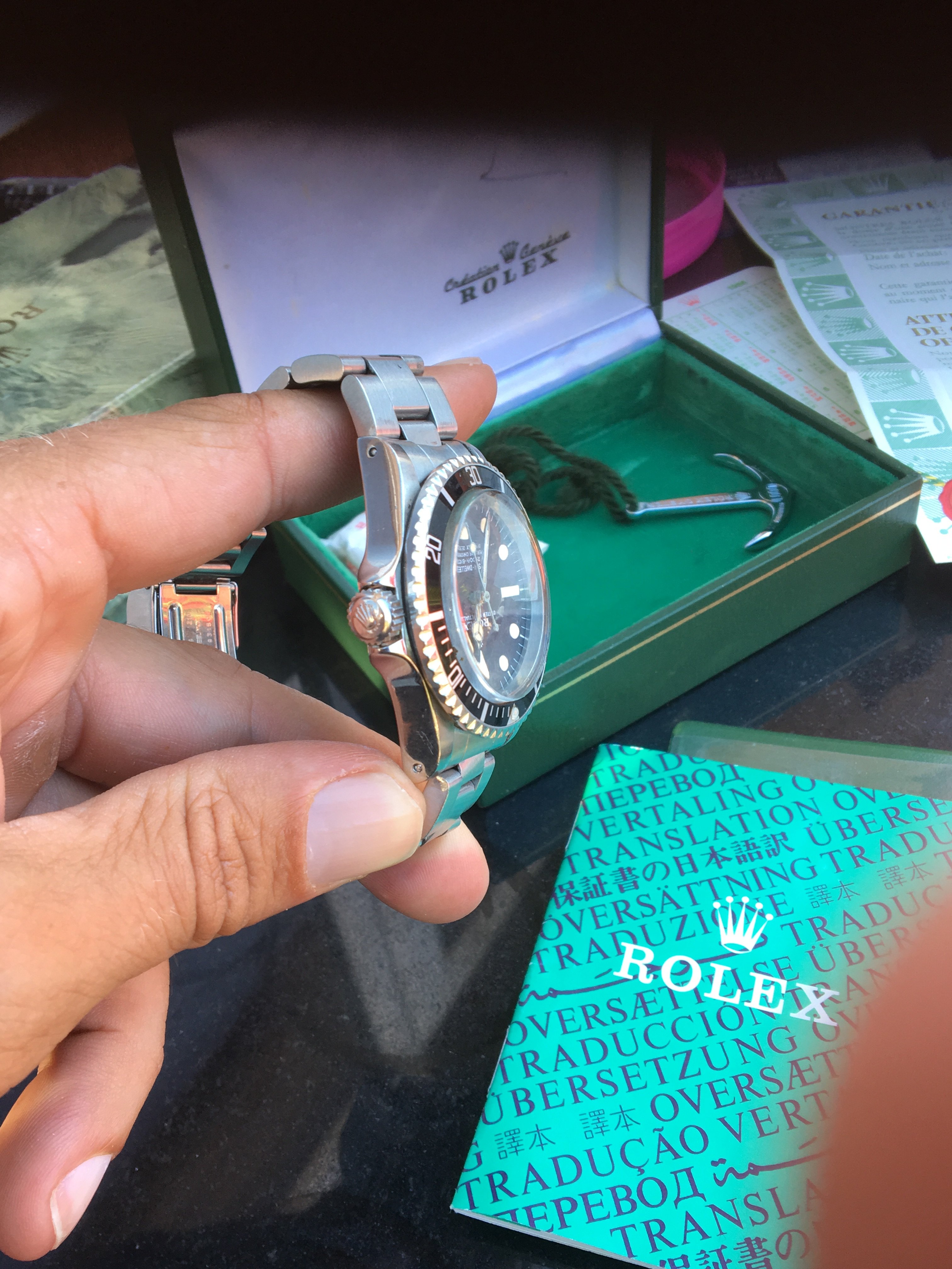

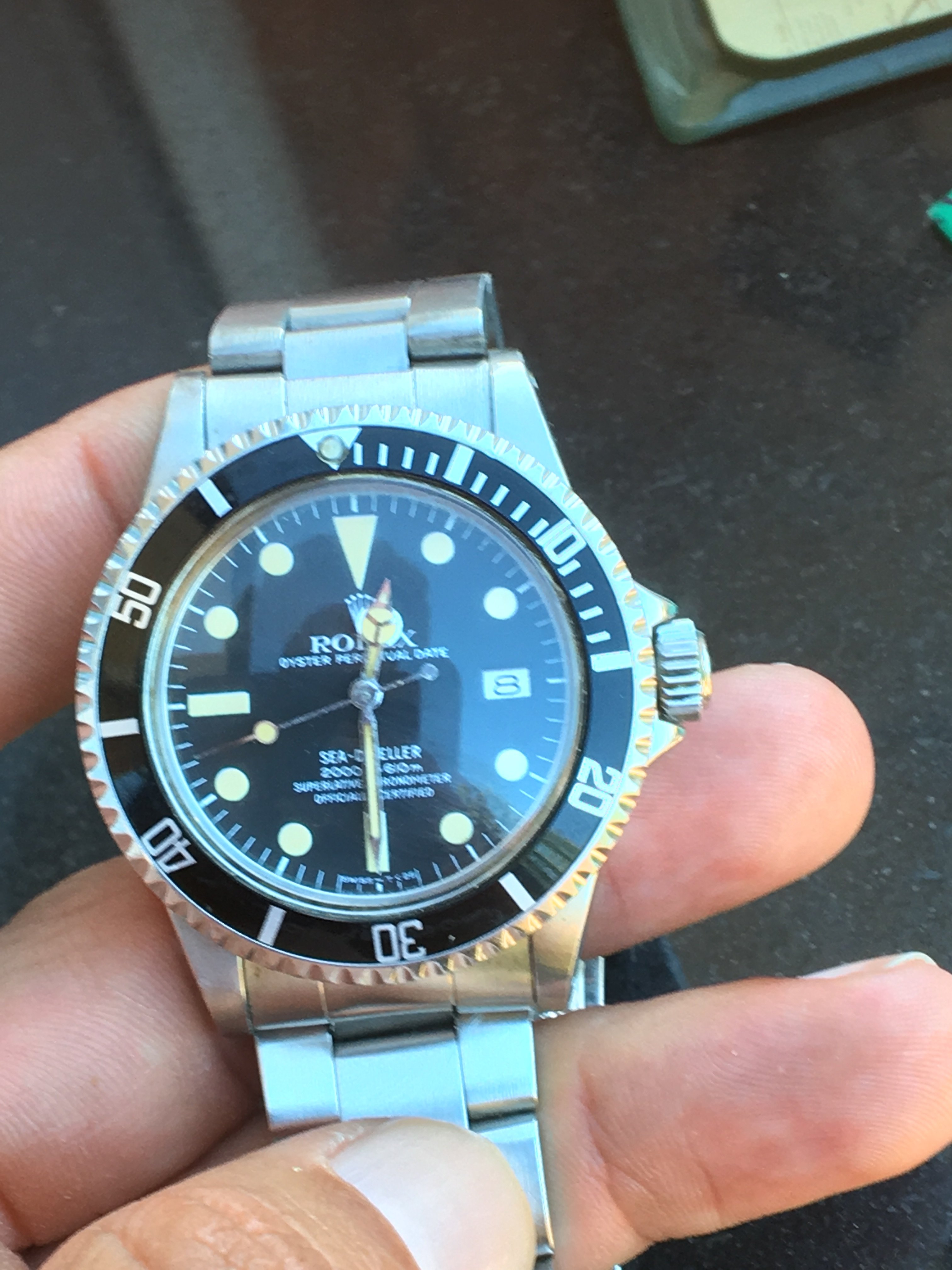

Hi I had some more photos sent my opinion would be maybe the bezel insert has been changed and maybe a polish at some point Apart from that I thought a nice looking Watch
1,854
5,412

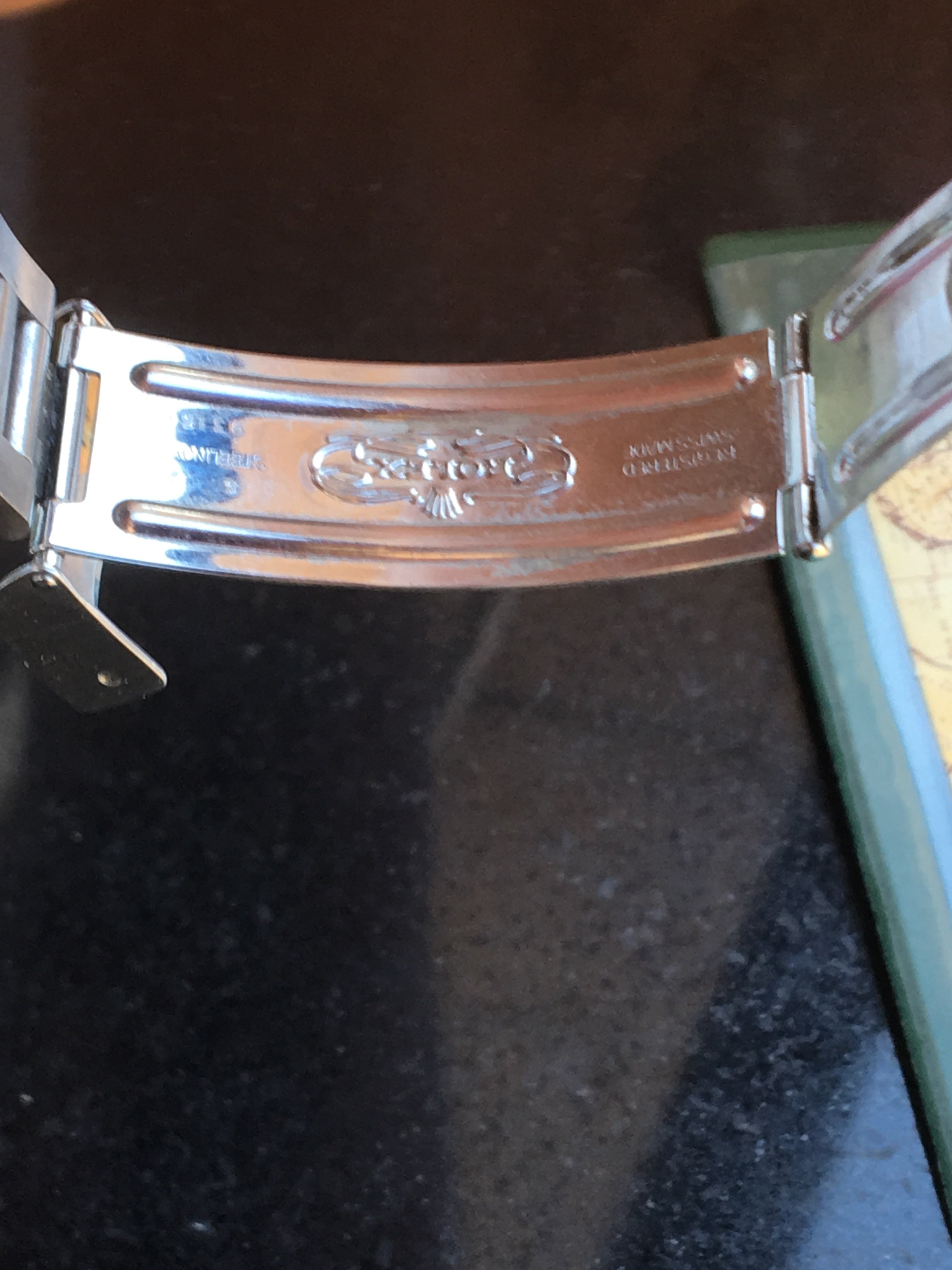

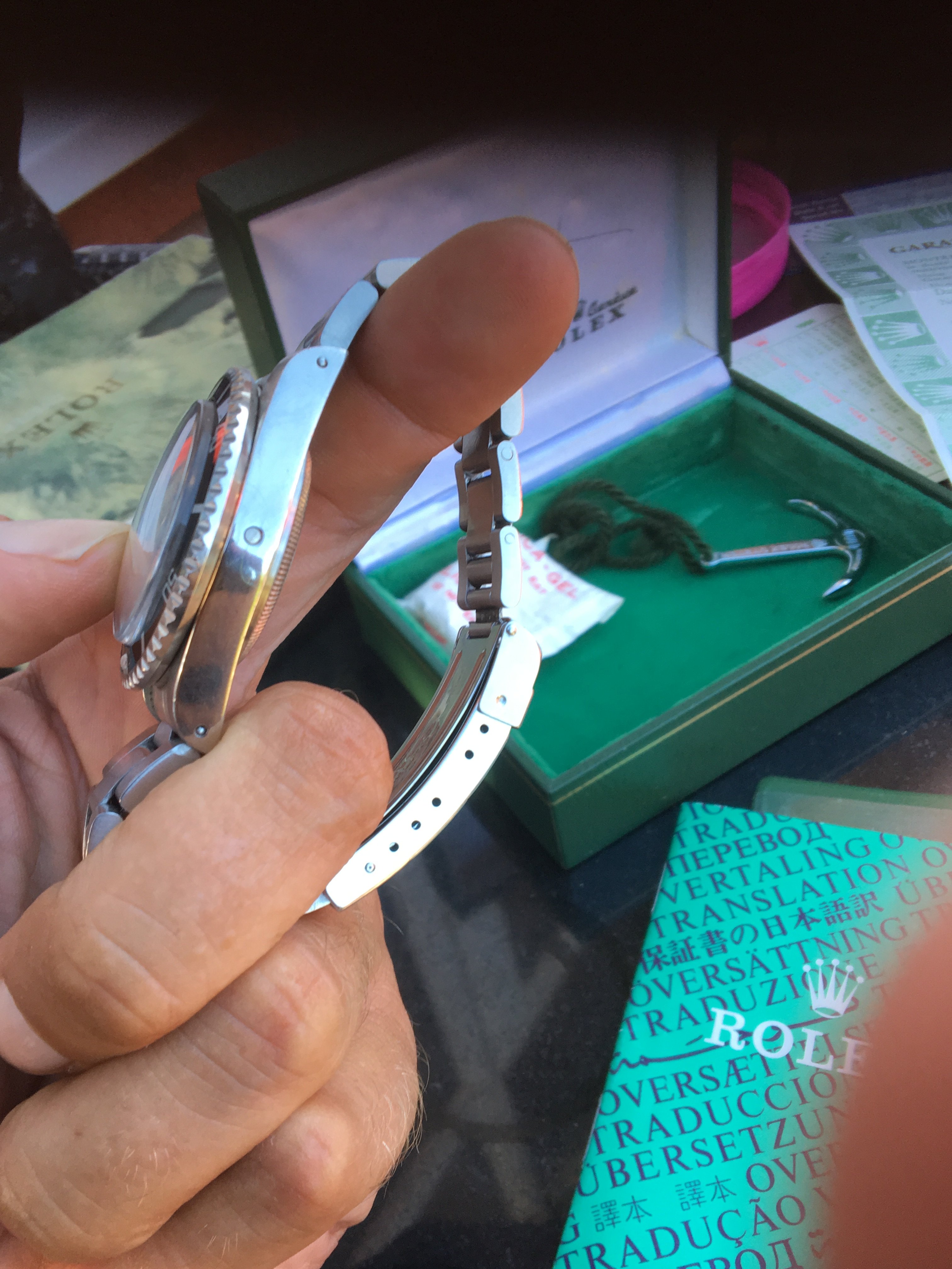

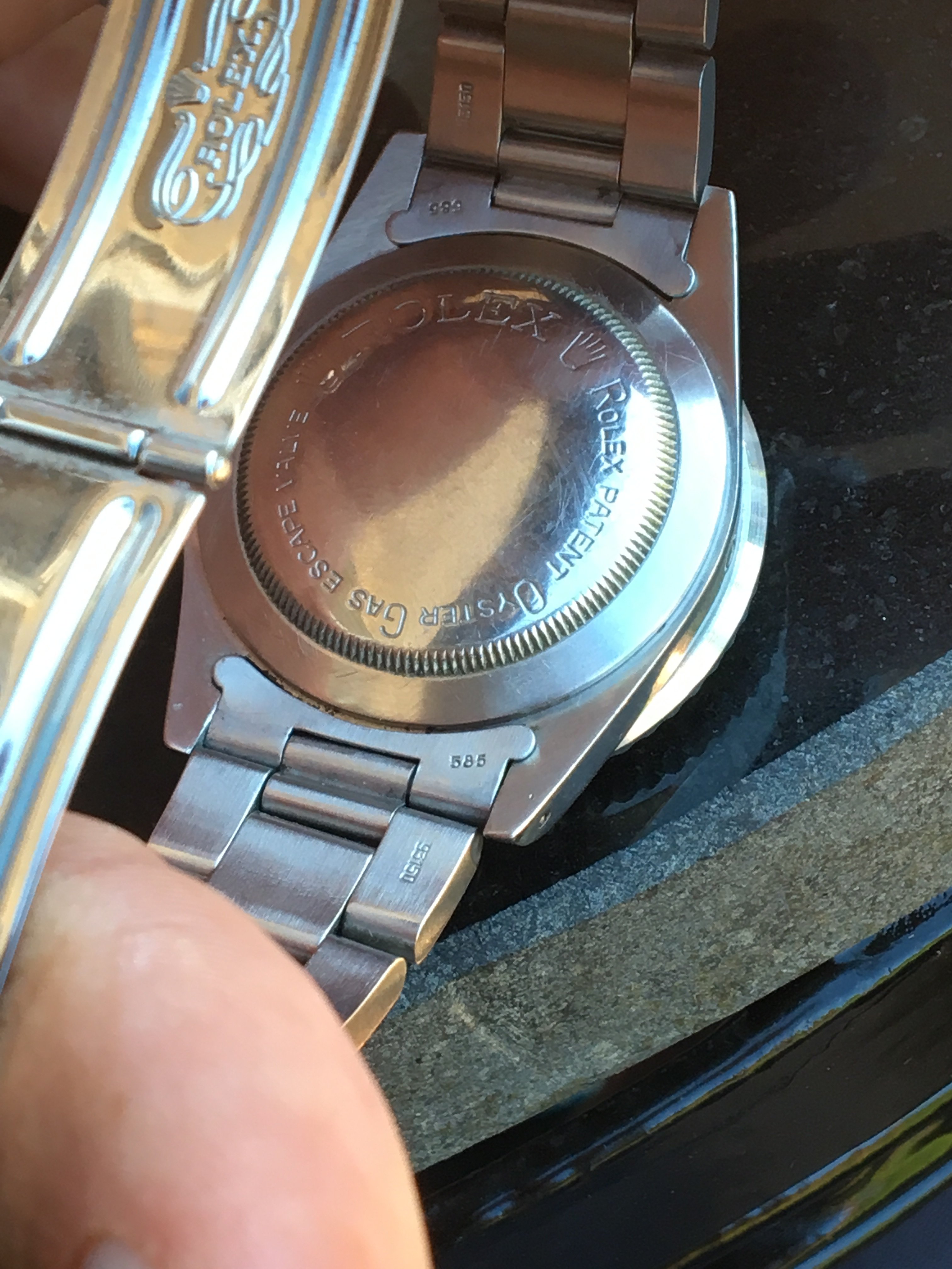

Looking at the last pics you added the watch appears quite polished, especially if you look at the crown guards. The buckle of the bracelet does not appear like the original, so the bracelet is probably not original to the watch. I don't see the very well the anchor, but it should have a green plastic medallion saying 610 m. The cristal is a service one...
Many elements that are not consistent with what the seller has said. So be very carefull and/or negotiate the price.

This has been discussed on the Rolex Forum and had mixed results, the anchor is a 1000m one and I think the booklets are wrong as well, supposed to be a one owner watch!

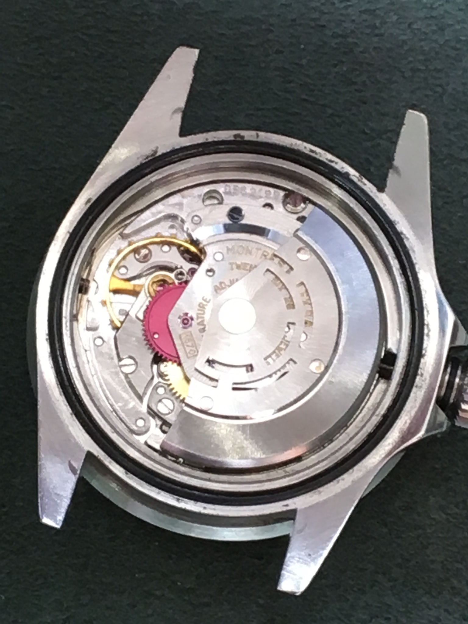

Hi guys,
had the Watch checked over by mike woods lovely guy. He gave the thumbs up & just a couple of minor issues but happy with the outcome. Thanks guys and thank you again mike woods

Well, there you have it then...End of story if he looked it over for you.
