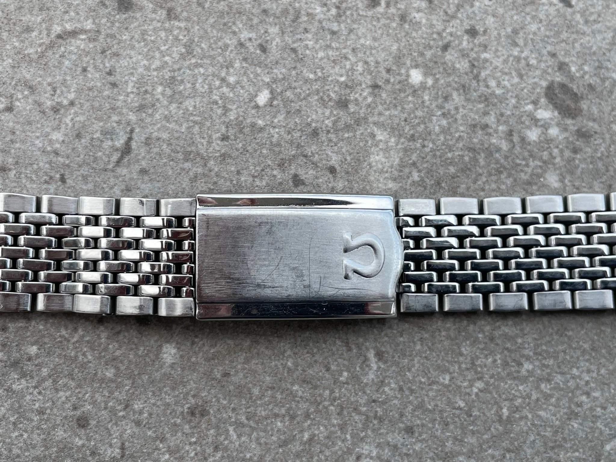

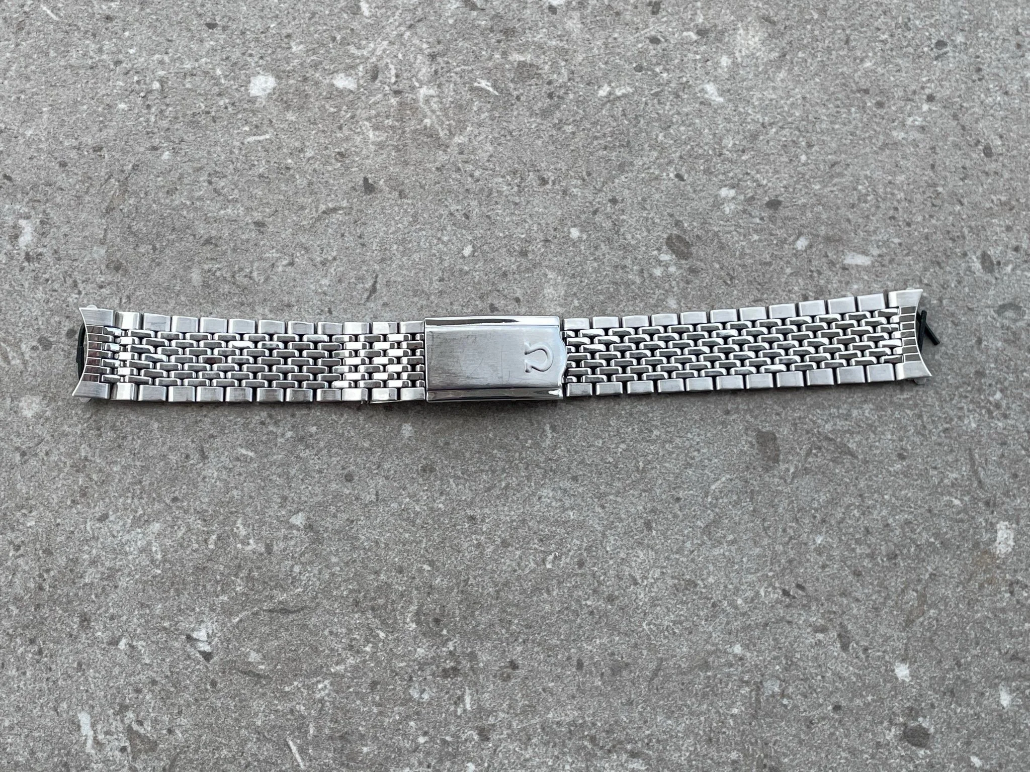

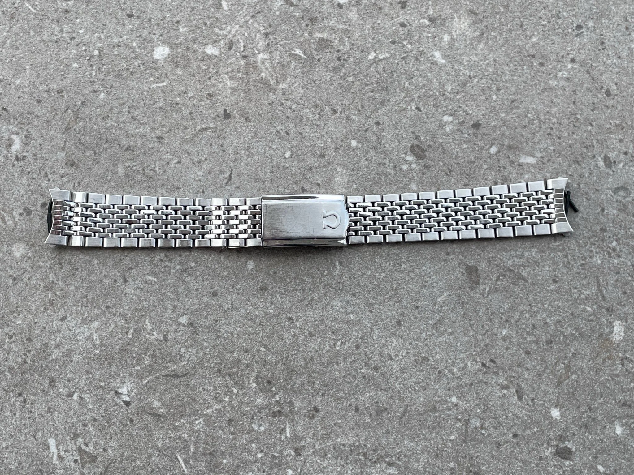

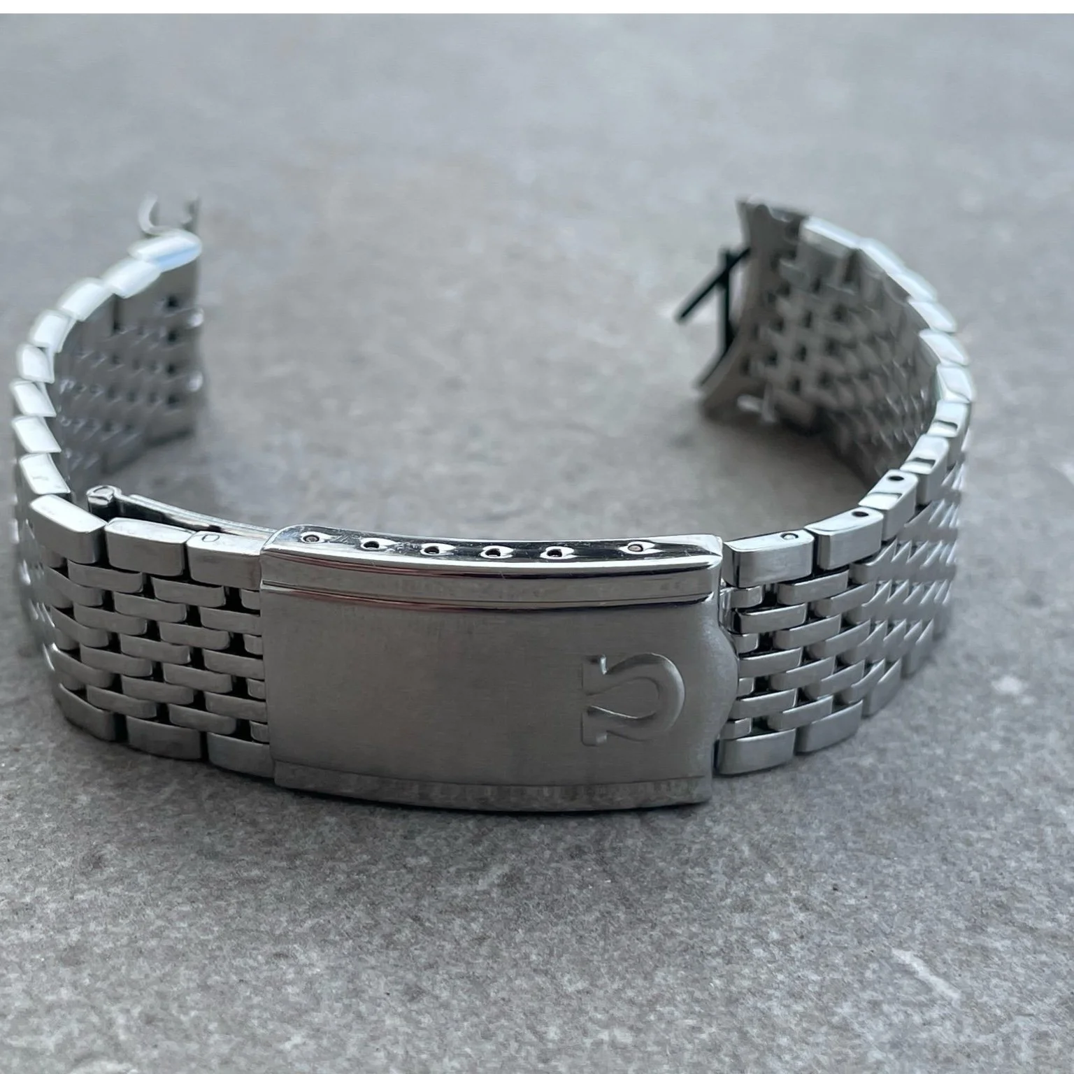

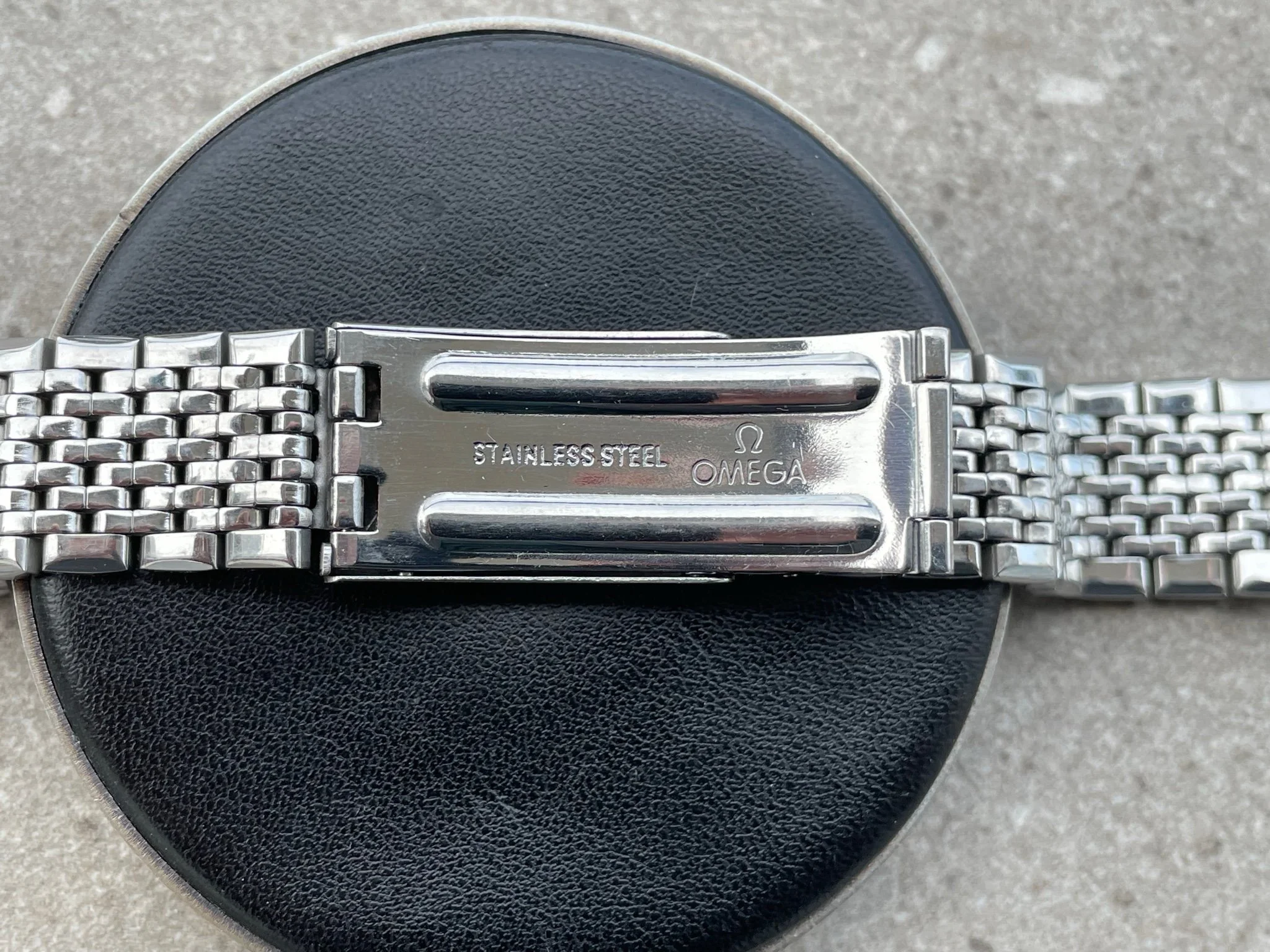

Hi all!

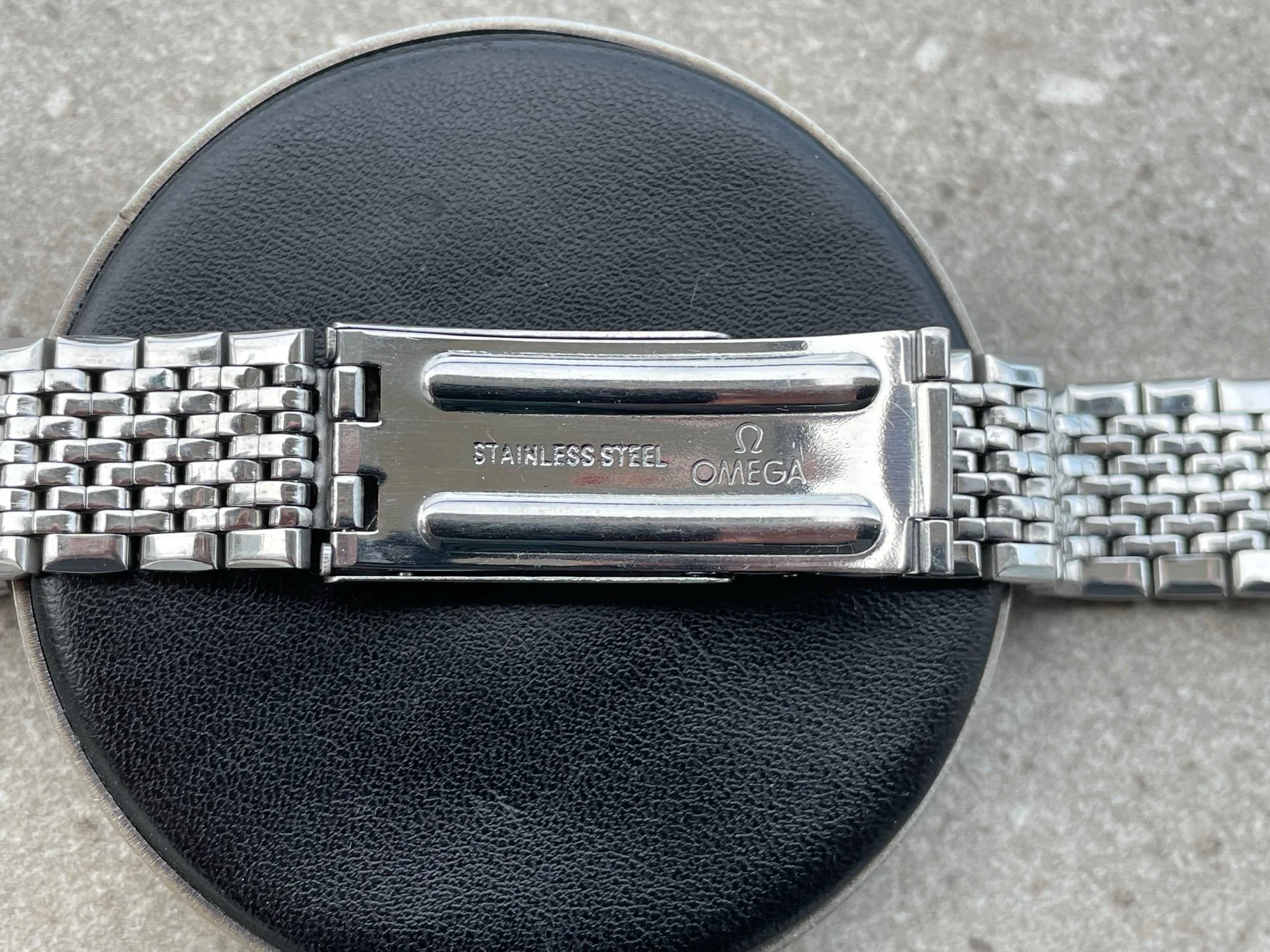

I am looking to buy this bracelet and wanted to see if any of you had some insights into if it is authentic or not? No markings for reference number at all which seems suspicious. Was apparently bought at a watch dealer in Japan.
Thanks in advance 馃榾

Hello kallekrusell and welcome to the forum! What does your own research say?
Hello, kallekrusell, and welcome to the forum! What does your own research say?

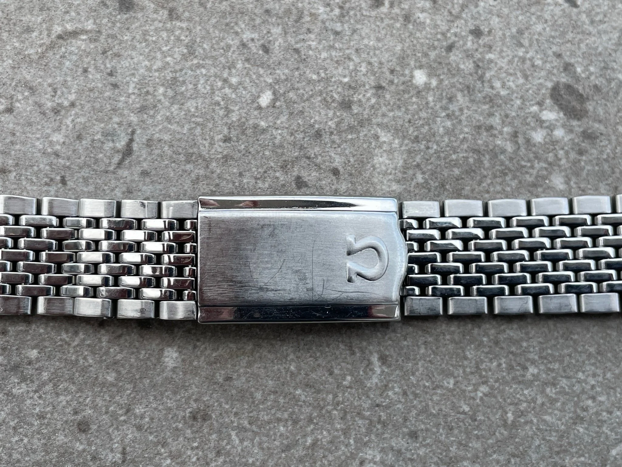

Having trouble finding similar bracelets or any forums about it. One forum said that some bracelets come without reference numbers, but I still find the overall bracelet feeling a bit fishy. For instance, the clasp feels quite small.

It is an aftermarket/fake bracelet and endlinks.
Those endlinks won't fit properly on dog leg lugs, only fit on Seamaster de Ville.

I think I saw similar combination Stainless steel and omega without reference numbers on a sliding clasp (maybe also others, I am not an expert) BoR bracelet. The quality of this one in OP is suspicious, I would agree that it is fake.
