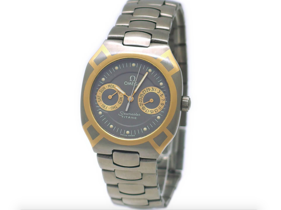

Hello! I’m new here but had a question regarding how I could authenticate or at least get an idea if a watch I recently purchased was real or not.
to make a long story short, I won a bid on catawiki for an omega Seamaster Polaris, and although it says that it was authenticated, I wanted to double check. I know almost nothing about watches, and was hoping someone could guide me to someone who does. I already called omega boutiques near me but they couldn’t help much. I thought I’d post the link to the auction here, and hopefully a kind and knowledgeable stranger can guide me to the right move. Thank you all!
https://www.catawiki.com/en/l/70782...rice-seamaster-polaris-day-date-men-1980-1989
947
605
Much better if you actually post photos rather than a link. I don't think that anyone in their right mind would try to produce a replica of an Omega Polaris, but this is just my opinion. Looking forward to seeing the images. Good luck.

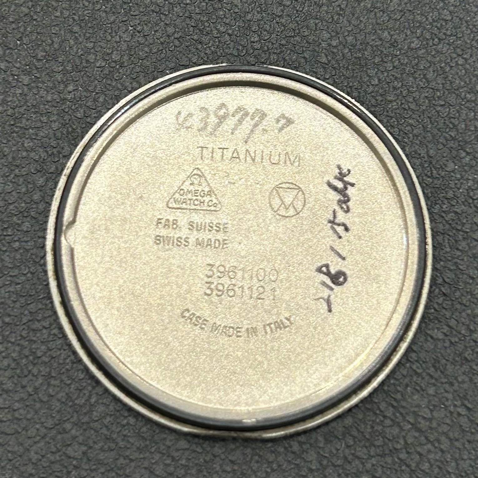

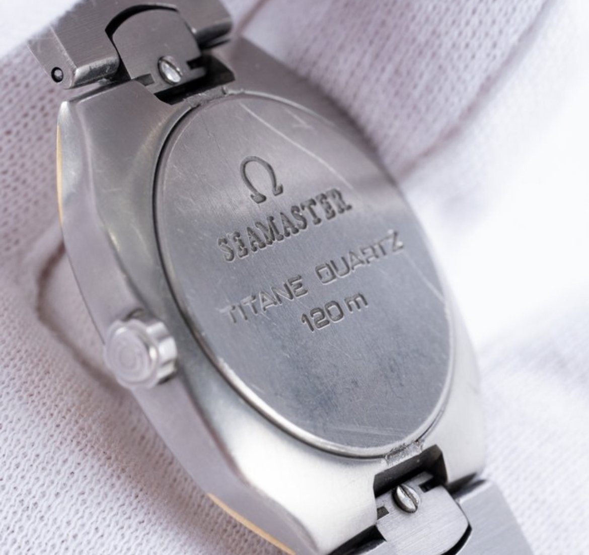

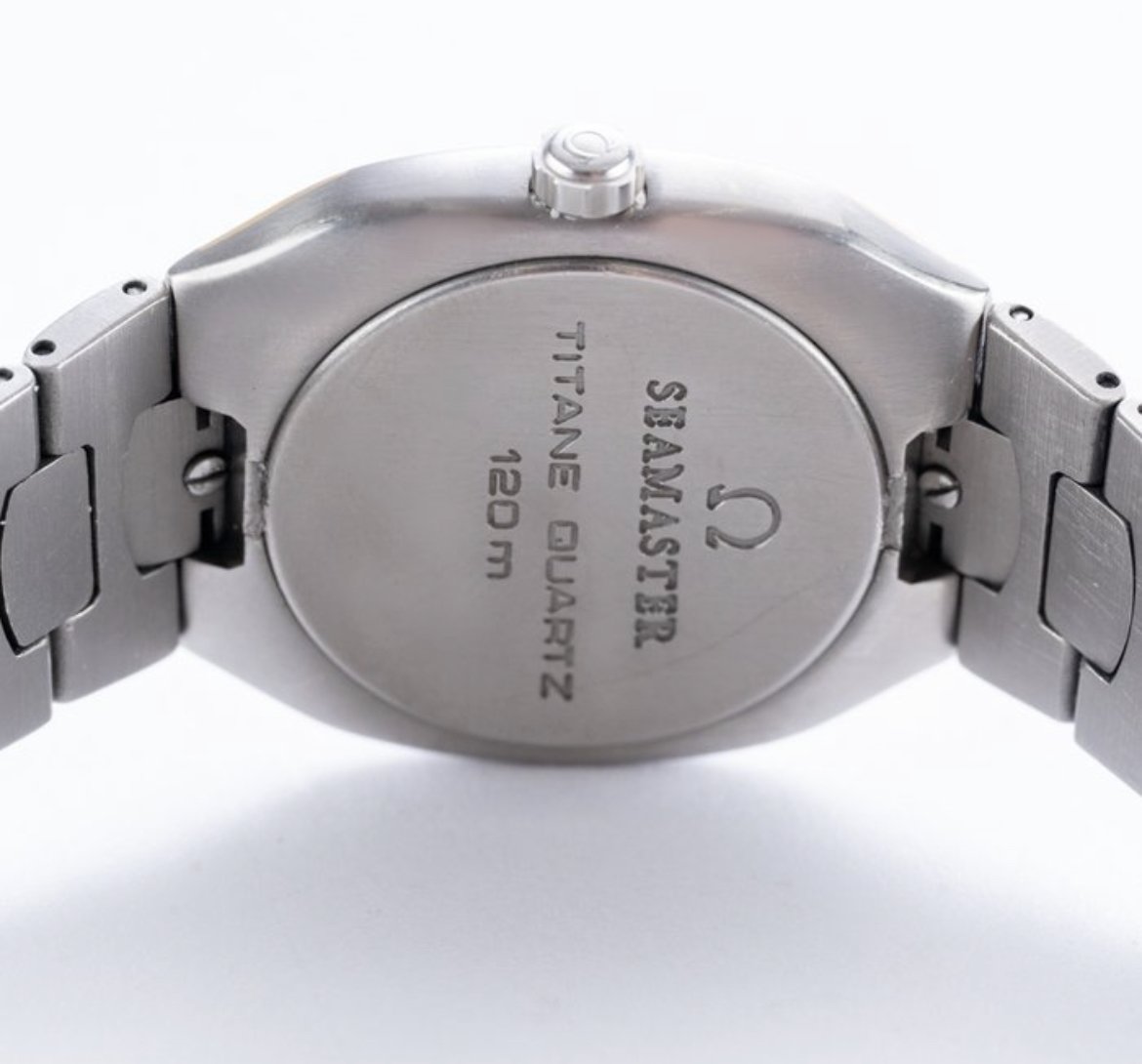

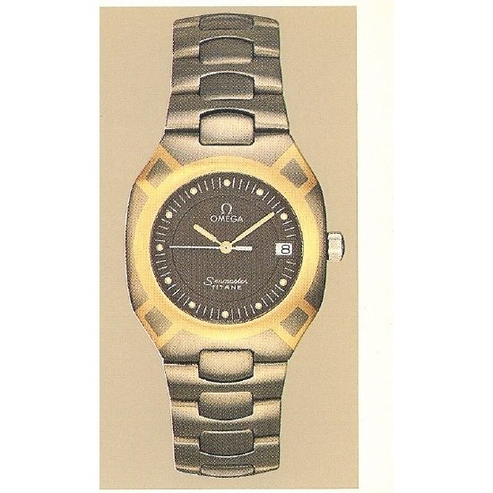

Hello again all! I just got a picture of the caseback, and am not totally sure what I am looking at. Any help would be greatly appreciated.
Weirdly, the back says "Case Made in Italy". I know it is supposed to be made in Switzerland, so now I am even more confused. Supposedly the watch was vetted, but it looks peculiar to me. Based on my research, some other seamasters from this era had this issue, but I don't know much more than that. Thank you all!
1,193
6,194
Hi
https://www.omegawatches.com/en-us/watch-omega-seamaster-polaris-tr-396-1121
These are actually cool watches. They were designed by a famous watch designer whose name is Genta
https://en.m.wikipedia.org/wiki/Gérald_Genta
Cases are often made in different countries than the watch itself. There is nothing to worry about it is genuine, cool, with an interesting provenance.

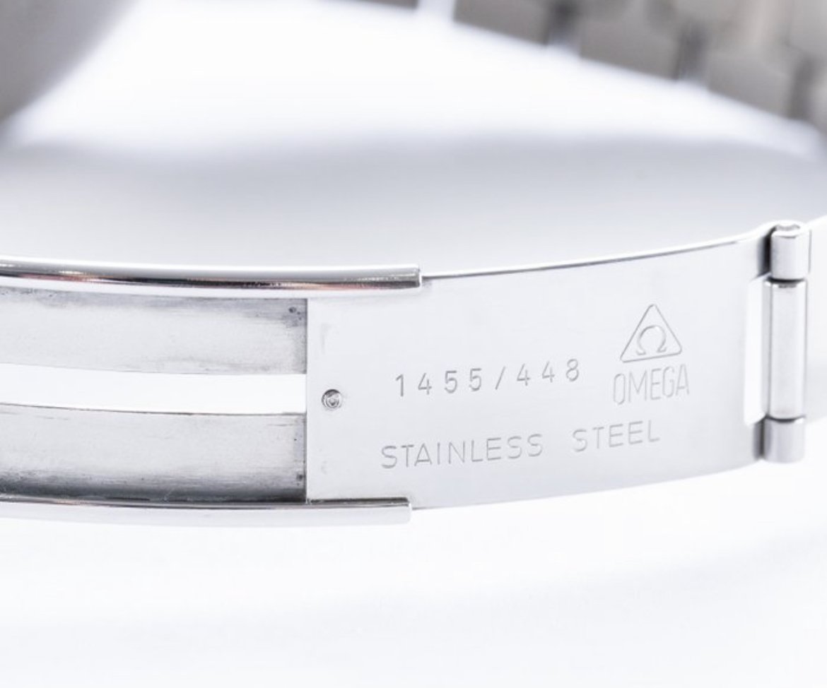

BTW
1455/448 is the bracelet and endlink number.

Ahh i understand. So then, if i may ask, what are the two seven-digit numbers engraved right above "made in Italy"?
Again, thank you so much for all of your help, it has brought me incredible peace of mind and been extremely useful.
18,841
39,184
The seven digits are the case reference number.
The three leading digits tell you what kind of watch it is.
3 = Gents Bracelet Watch
9 = Electronic
6 = Water-resistant Calendar
The last four digits are sequential model variants.
1,193
6,194
There are two seven digit numbers because that case was used for two different watches. Yours has the reference number 3961100
9 = Electronic
Ahh, understood. Thank you so much! That makes much more sense...
15
Ohh, so was this specific case on two different watches at different times? Or was it just a case used for two different watches? Sorry again for all of the questions, but it is all clearing up now! Thank you again!!!
15
Two different watches used the same case.
3961121
3961100
Oh! That makes much more sense, and seeing as the bottom photo is identical to my watch, it appears as if the watch I purchased was legitimate after all. Regardless, I'll find the serial number and see if it corresponds to the right watch, but I can't do that until I have it in my hands. Thank you again all! I will return once my watch arrives! I cannot thank you all enough!!!
