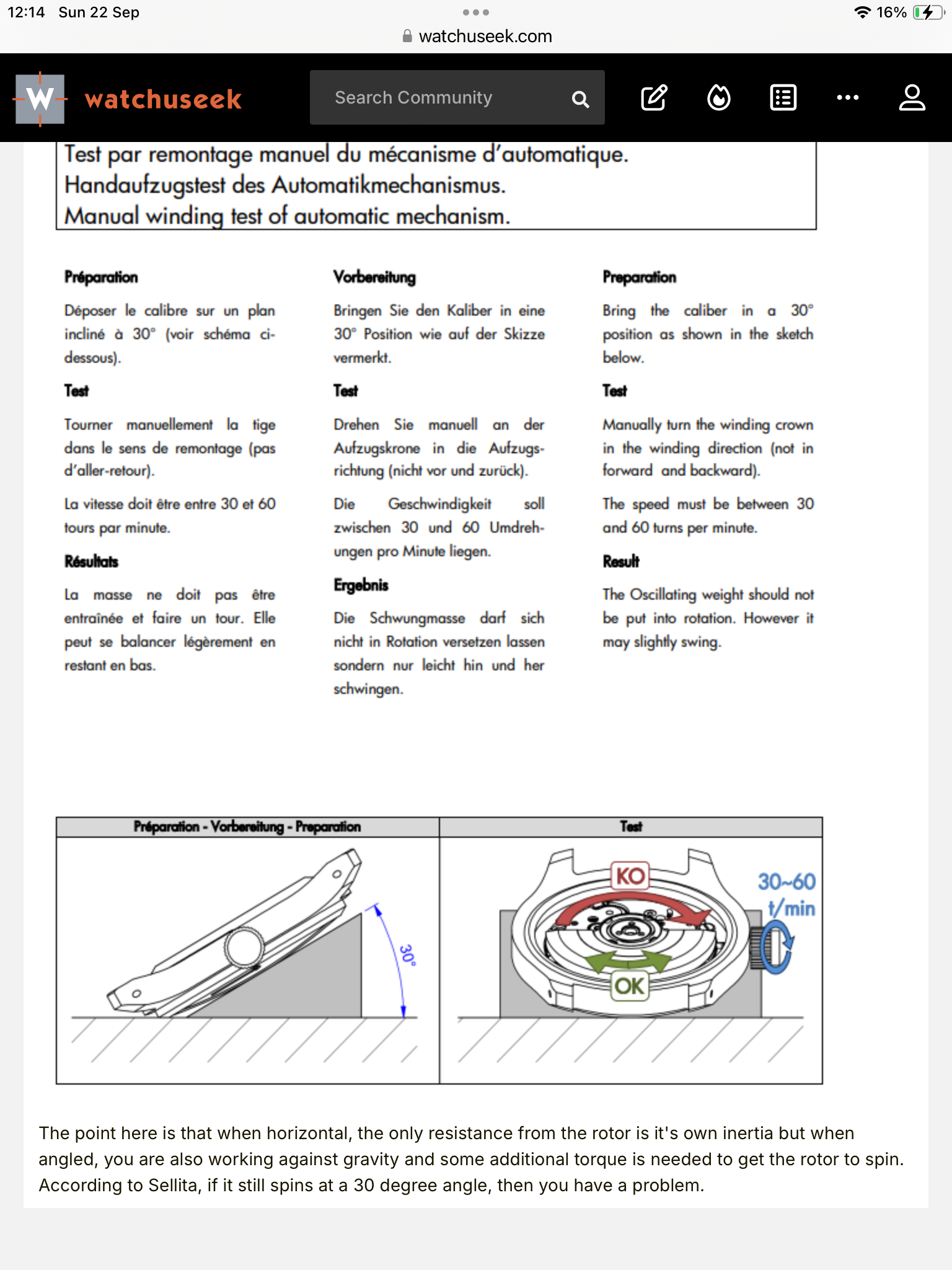

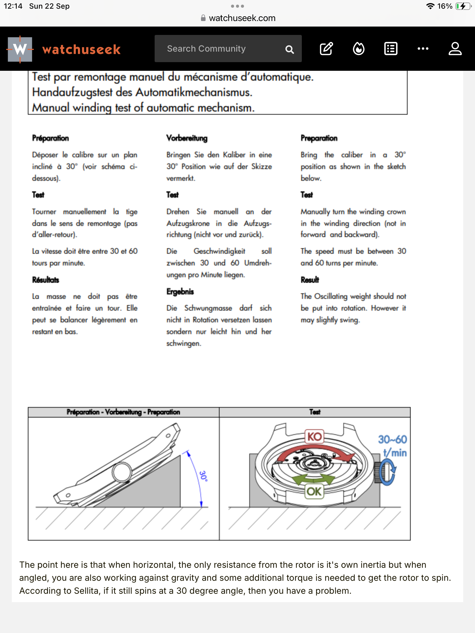

Awaiting a call from the OB and found this…
My watch easily falls within these limits but I will get it checked out anyway next time I am at the OB.

The Watchuseek screenshot above references Sellita and has no bearing on your issue. The linked Watchuseek thread above is referencing ETA and Sellita movements. Your watch isn't equipped with either.
It isn't operating correctly. The amount of torque applied to the winding mechanism by the rotor moving even a "little" when mannually winding is extraordinary. It will only be worse in the future.
