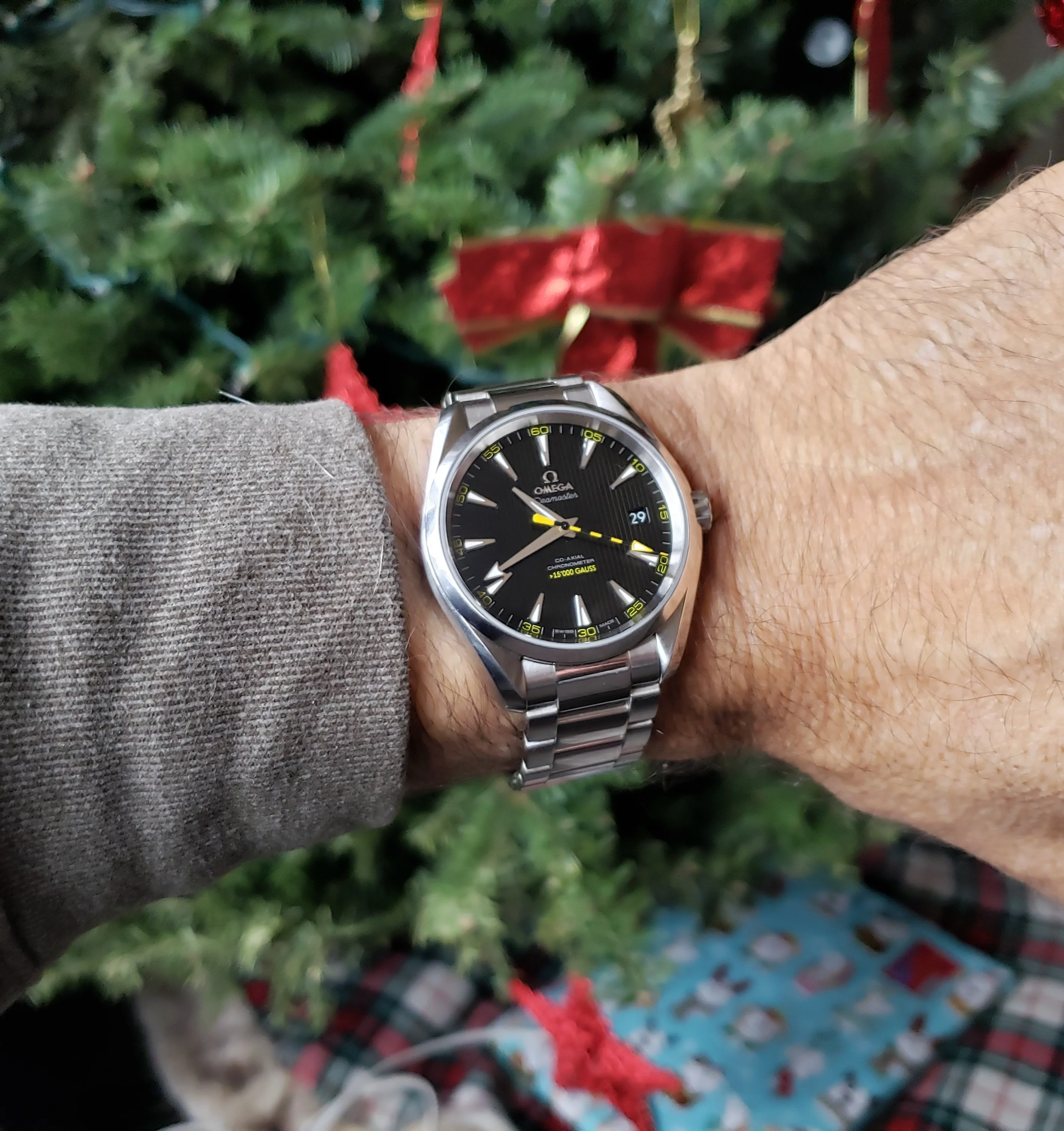

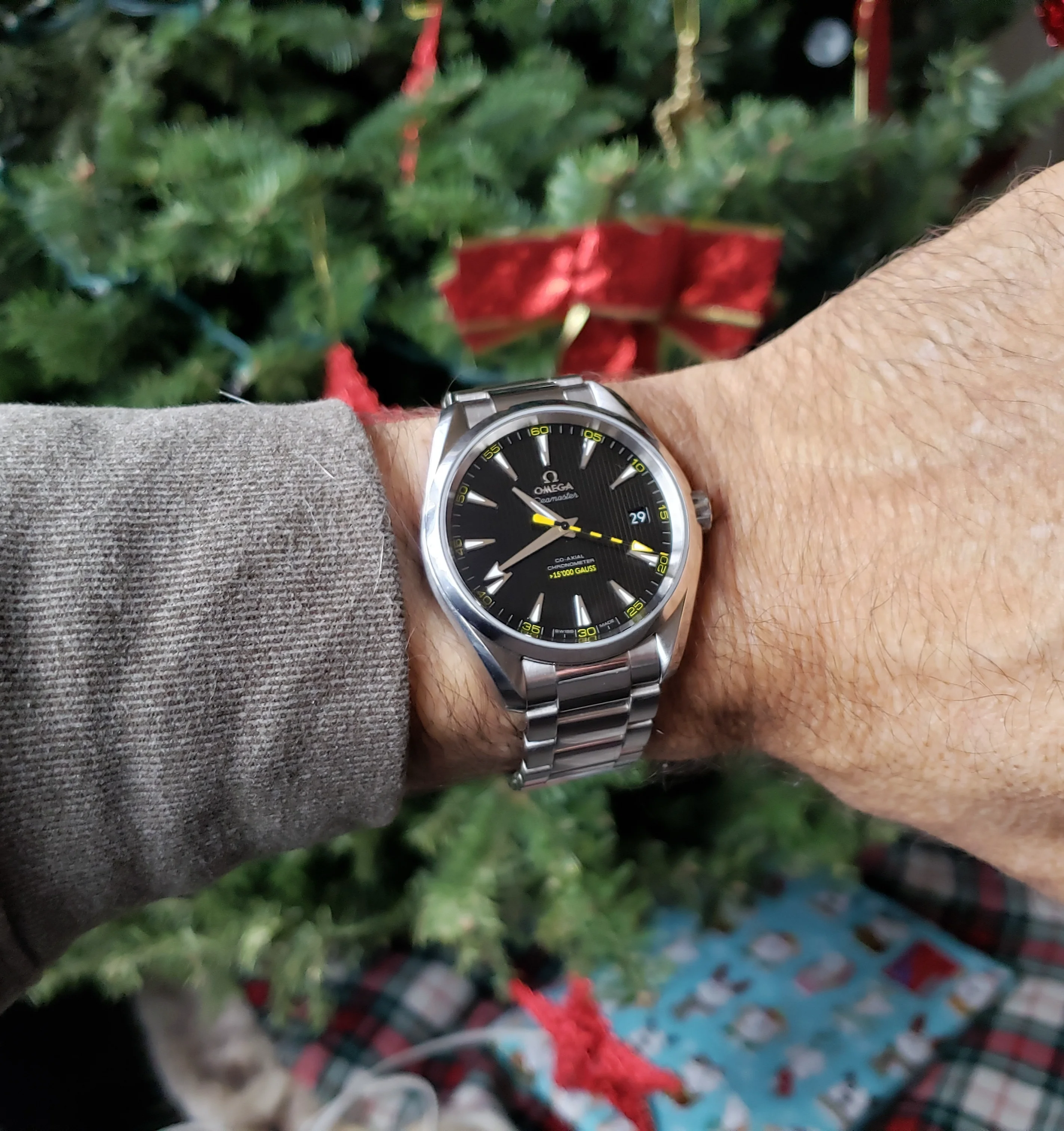

Here's my Aqua Terra Bumblebee with the 8508 movement, 41.5 mm, circa 2013. Measured out the extra links and a full link is 3 cm in length, two half links together are 4 cm in length.
