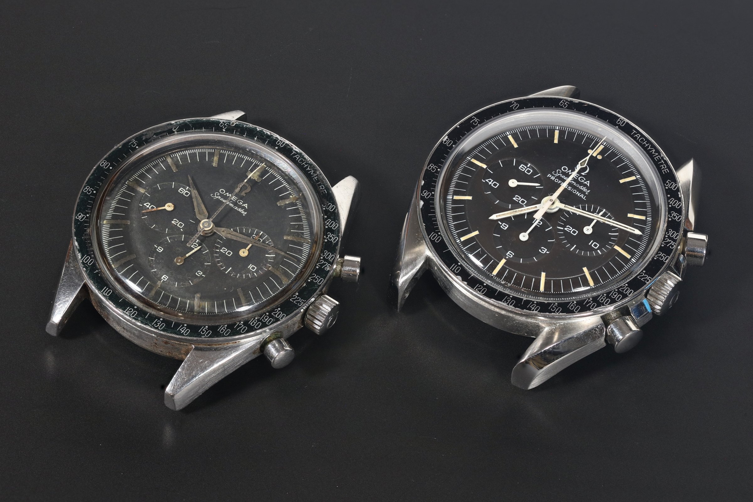

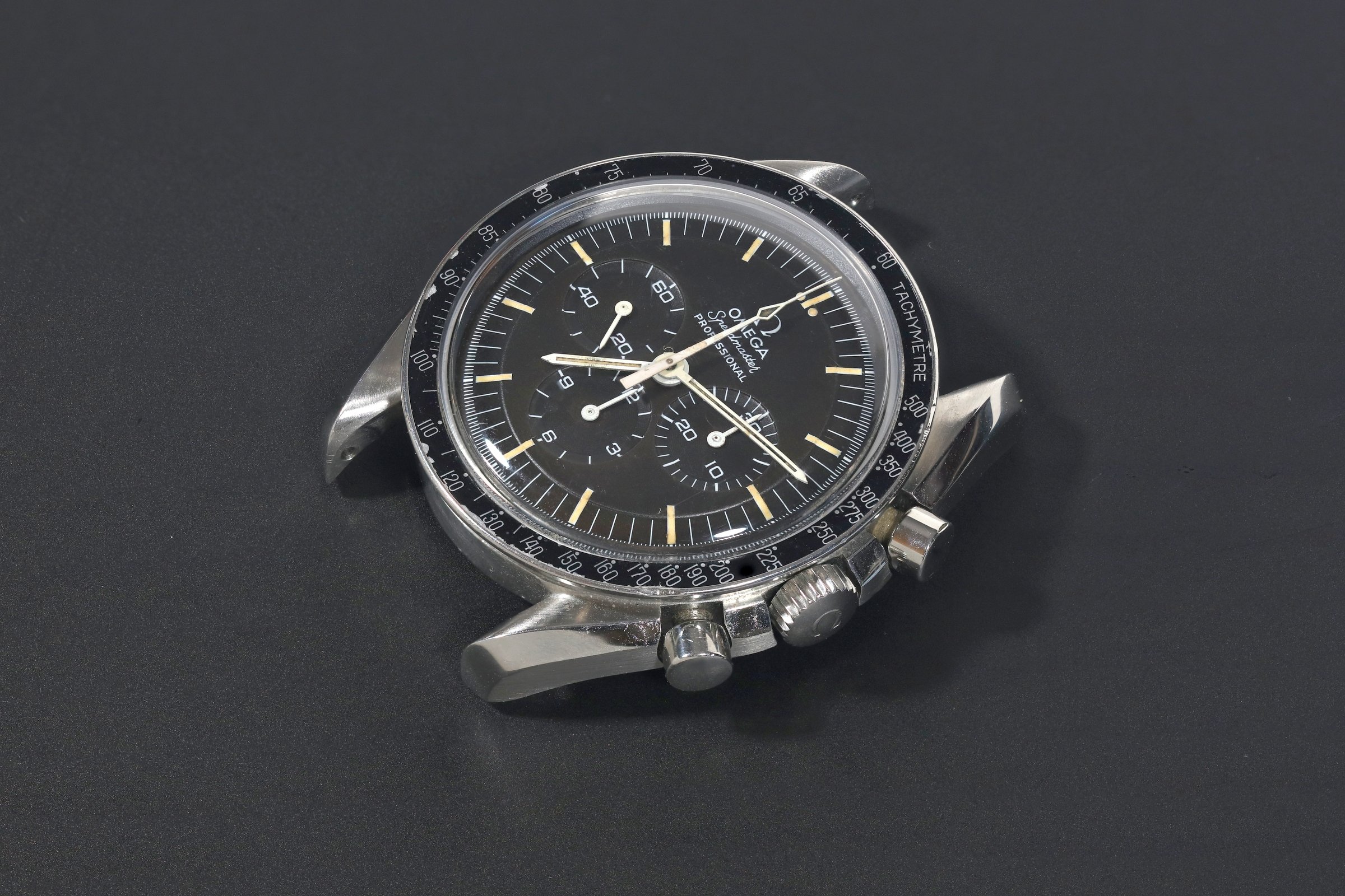

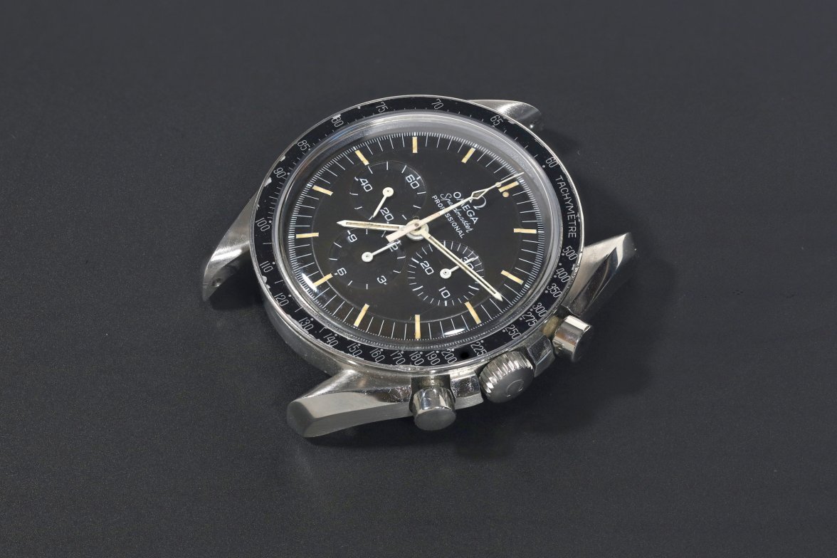

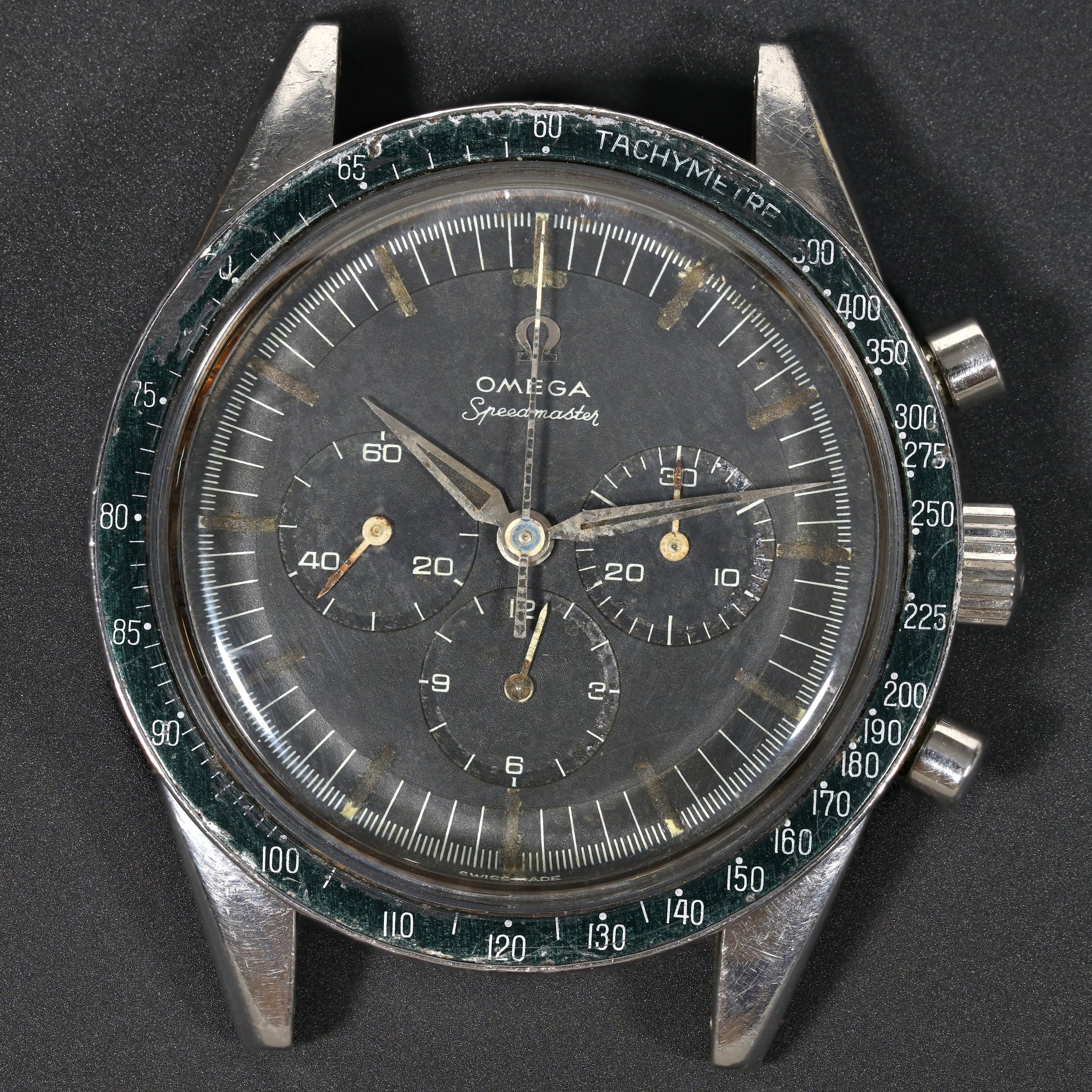

After a long trip working in Asia, I am back in Fruit Towers with spoils. It is unusual to be able to find interesting and buyable Speedmasters, but this time was good.
The left is a 2998-5. It's in terrible shape, but each part appears original to the other, it has a triangle lume hour hand, and should clean up. It needs a crown. Of course, it was cheap. (to me)
On the right is a lovely 69; The dial is slightly brown, and it came on a later 1171.
I have to decide what to do to each.

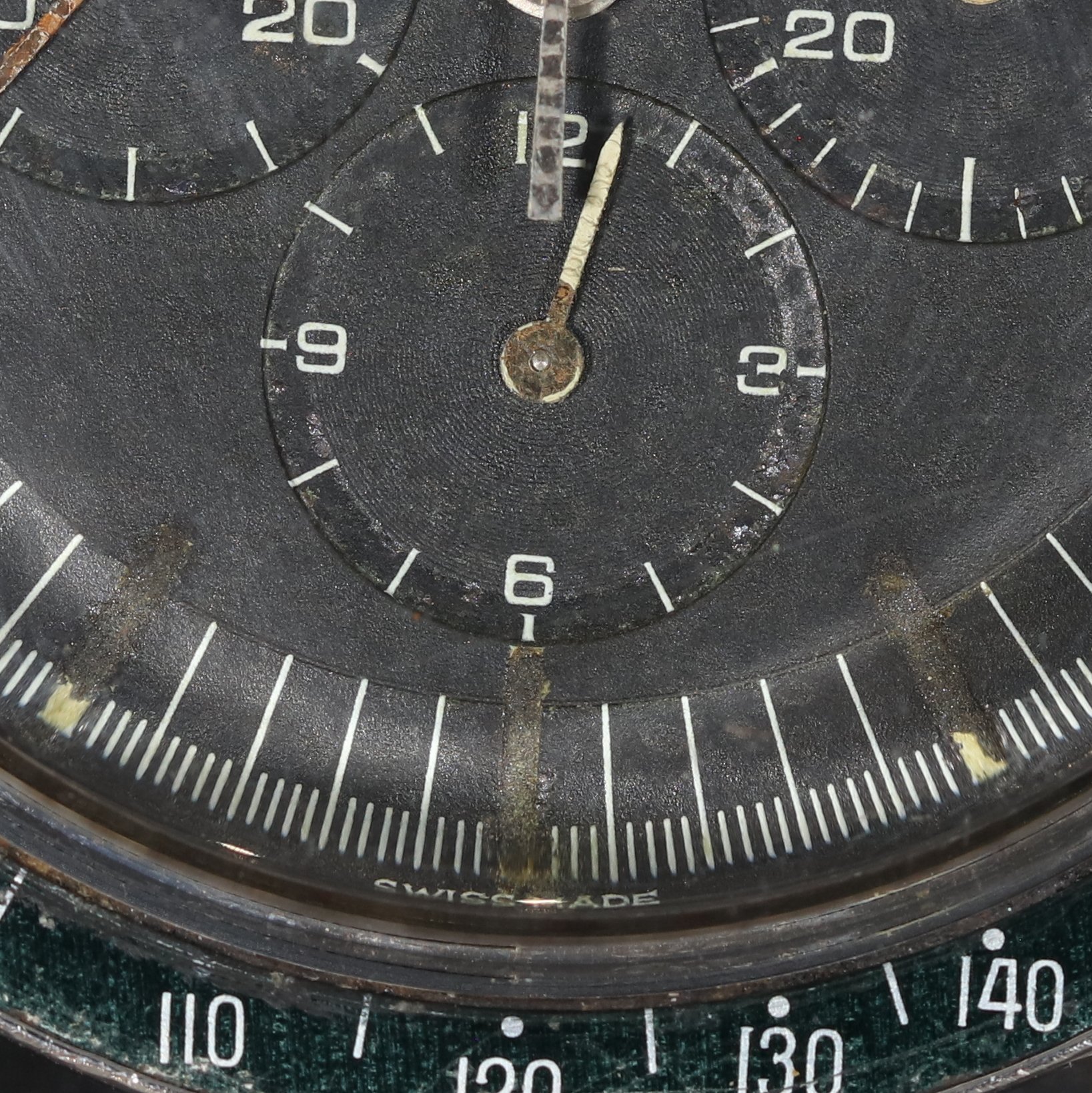

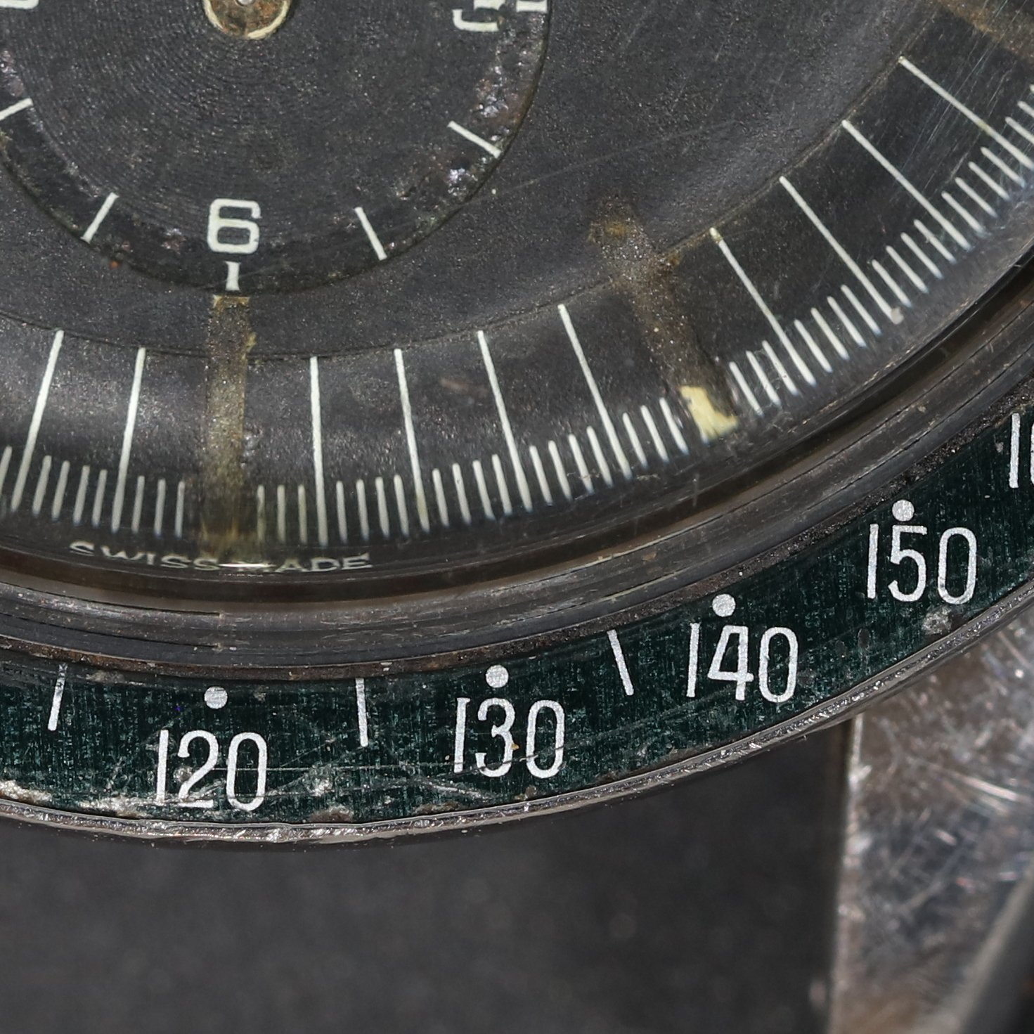

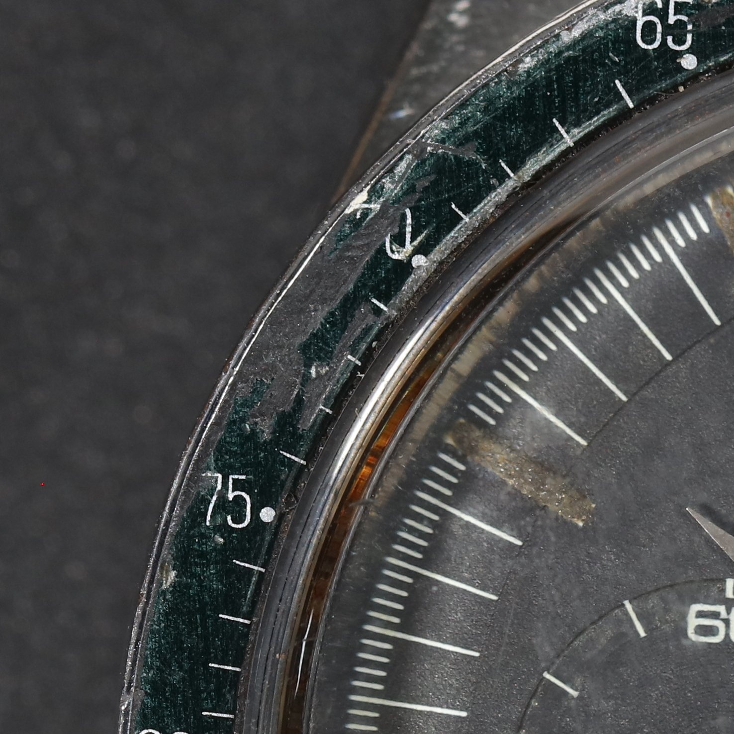

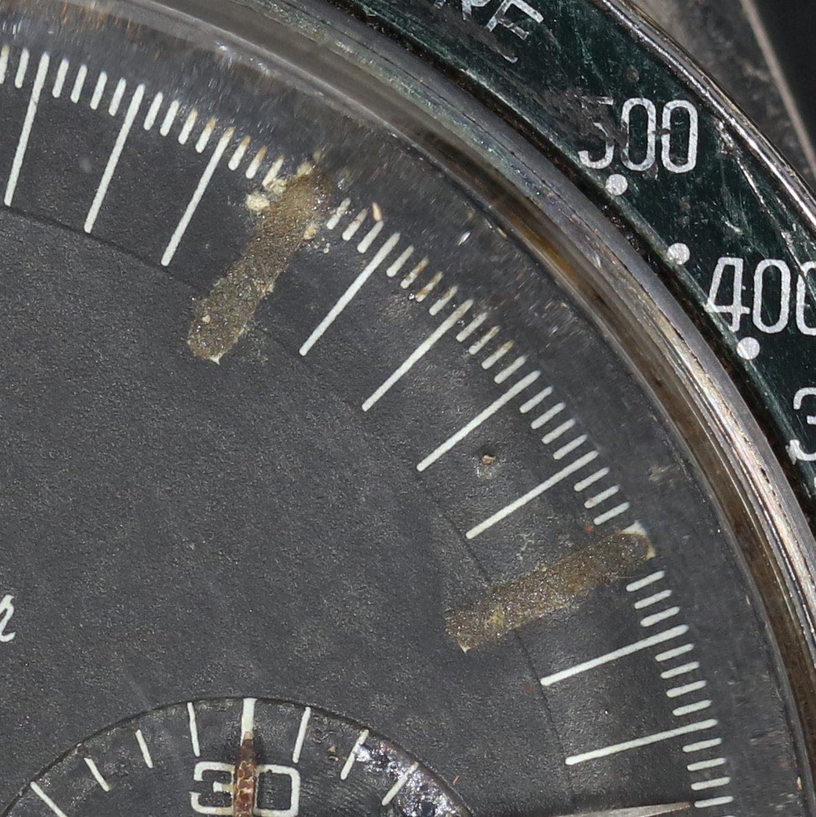

Here is a closer look at the 2998. I don’t think it would look right if I re lume it.
The triangle hand
Greenish bezel?
5,729
9,515
The triangle hand
Greenish bezel?
Greenish/blueish bezels fine for that ref. Don't relume. Paint the counter hands and second center hand in a very dark egg shell/very light brownish colour and leave it at that.

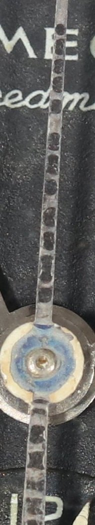

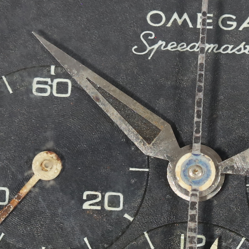

Interesting tire track pattern.
What do you think caused this? Are the dark spots paint remnants or metal decay? Did it deteriorate this way on its own or did someone previously try to address the hand condition?
Regardless, it's an interesting pattern that in my limited experience I have not seen.

Ah, the lesser spotted Zebra chrono seconds hand ( see what I did there? 🤦 ), very rare and only seen on the 2998-5 😉

So ugly that it’s beautiful!

Would not do much to 69 - looks great!
But, that 2998 is indeed a difficult case. After relume that dial still doesn't fit. When leaving as it is - that decay gets even worse over time, which is also a bit sad.
ahead of its time?

I'm wondering @Spacefruit how you would rate both these watches on your scale. Does "terrible" = "poor" or is it a step below?

There are much worse examples to go into the poor category. It has some attributes that save this watch from POOR.
1. It has Alpha hands with triangle lume - this is very desirable.
2. It appears to be largely original, crown notwithstanding.
3. All the parts appear to have been together and aged alongside each other, giving the appearance of a genuine watch with parts that have been with it since new.

I’m go against the grain here and say I would consider a relume on the 2998.
Does the current lume increase the attractiveness of the watch? Not for me.
Could a relume improve the watch? For me yes. I agree a poorly chosen relume would look jarring and out of place, but the right relume could lift the overall look while still being in keeping with the condition and finish of the dial body.
I also think a relume is a no regret option as for me, the current lume adds no value over a washed dial. Utterly subjective and I understand others may disagree, a relume would make this into a great daily wear 2998

When "fuzzy cat poop" can be a used to describe the lume, it's probably appropriate to consider a relume 😁

Here is a close up of the 2911 serial, slight brown:
