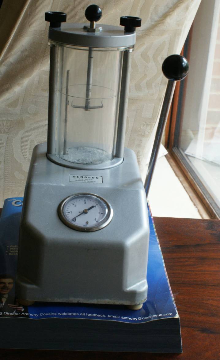

Bought this a couple of weeks ago from a local jeweler.

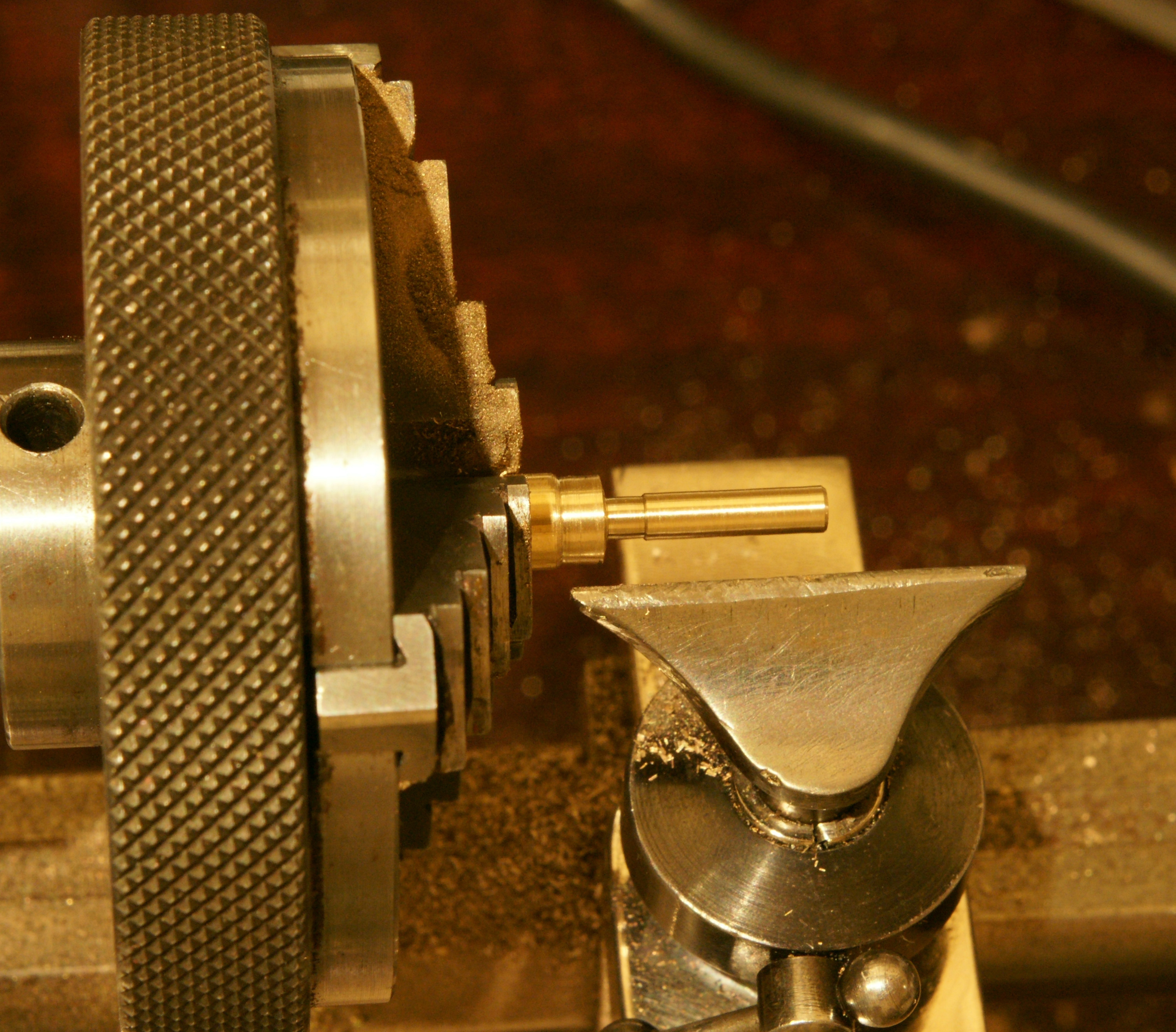

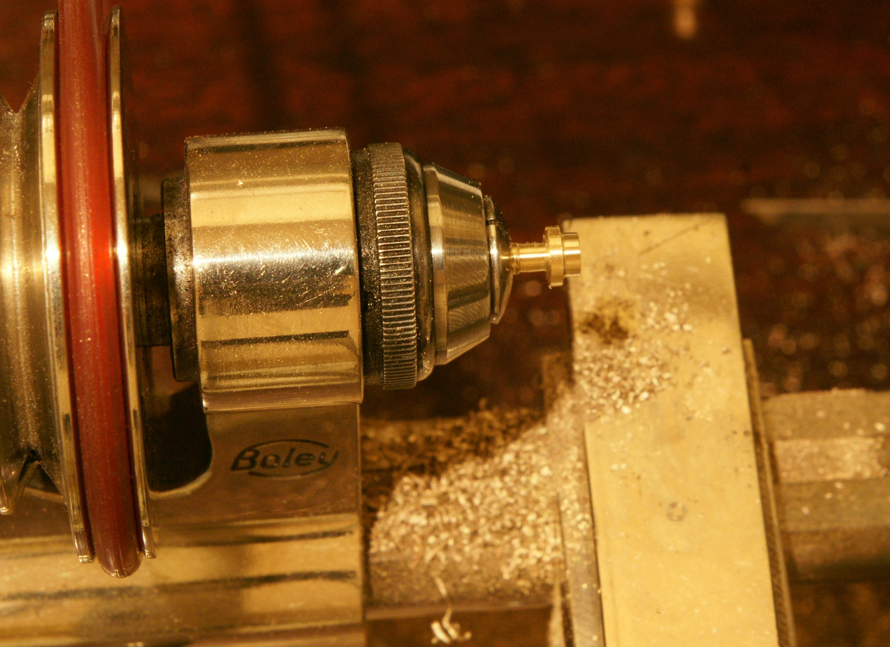

The valve leaked, the tank leaked from the bottom seal and the seal on the holding rod leaked. The groove in which the bottom seal sits was half full of limescale (we live in a very hard water area) hence the lack of seal. So, I cleaned it up and bought a new set of seals. All was fine except for the valve which had a weak, rusted spring and part of the stem was corroded away. Nothing ventured; nothing gained and as I didn't have a piece of 6mm aluminium (the stem is 5.5mm at its widest) so I thought I'd make one out of brass.
The first three cuts done.
Parted off and the seat for the spring cut.
It won't hold 3 Bar of pressure but it holds 2.5 Bar nicely which is plenty good enough for what I want.. I guess I'll have to try re-grinding the seat in the valve body. All in I got it for less than 20% of the cost for a new one so I'm happy.
EDIT Forgot to say that I spent all of 拢3 on a nice new stainless steel spring for the valve.

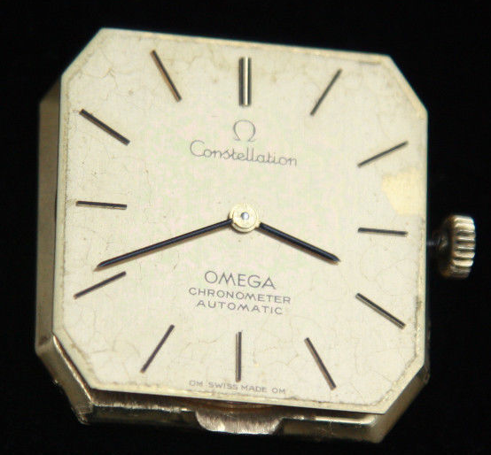

I bought this:
as a parts donor for this:
interesting is also the other side:
an "OM" dial. I wonder how much gold i will get on top. 馃槑

I bought this:
81869
81870
81868

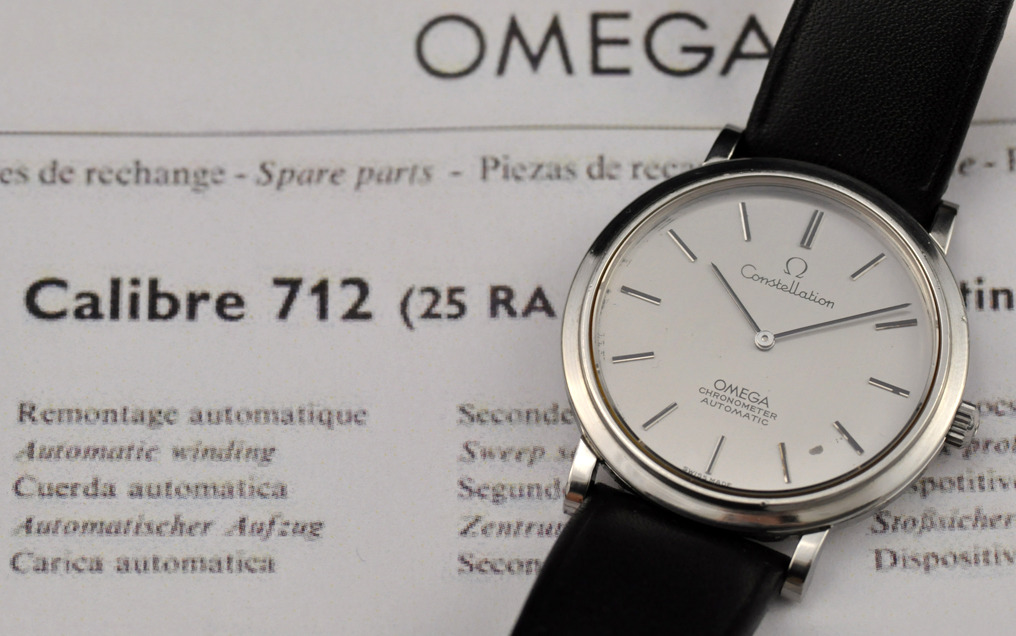

I used to own a 712, it was stolen by the Watch Fairy.
I have two. Now terrified that a bearded new jerseyite is going to sneak in to my house and swap them for loose change.

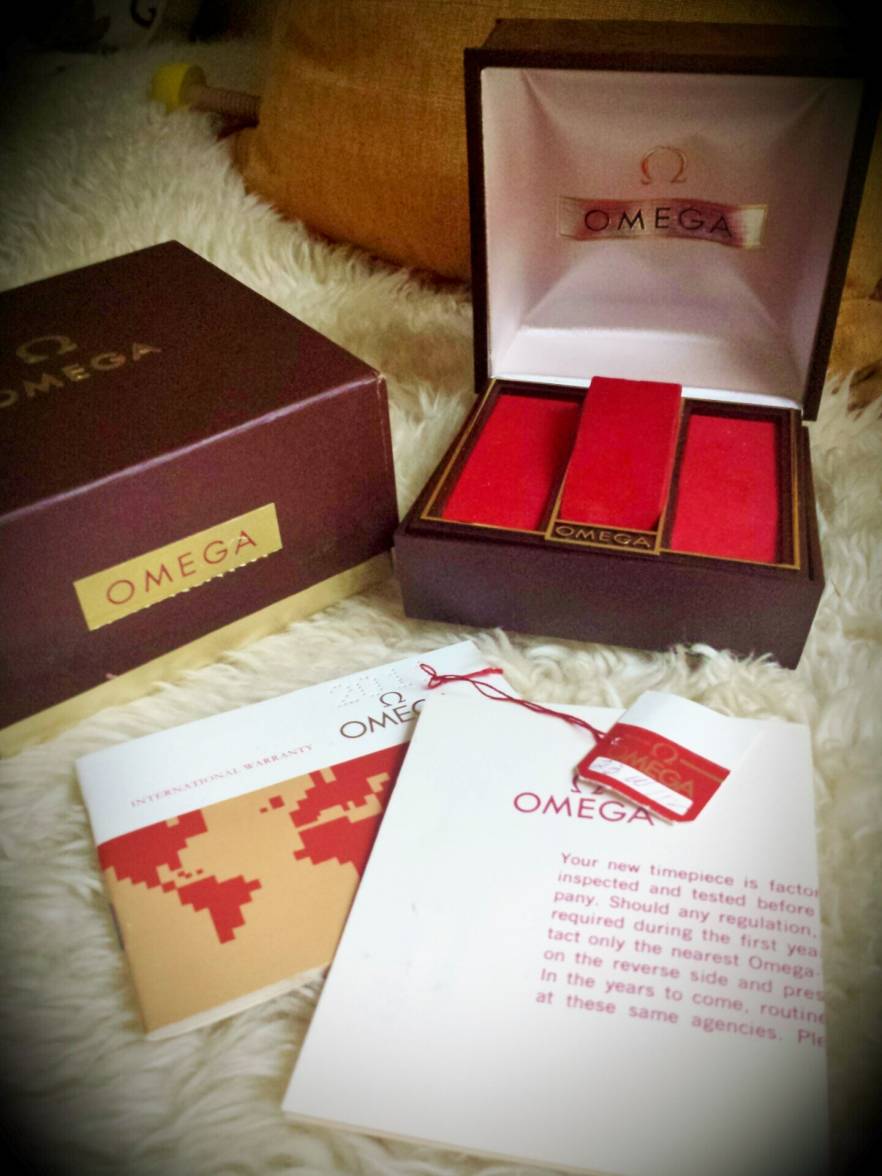

An as new 70麓s box set.
81999
Nice catch.
Now you just need a watch to put inside! 馃槈

I bought this:
81868
Less than 1g or about $25. Would have been melted already had the previous owner known what OM meant.

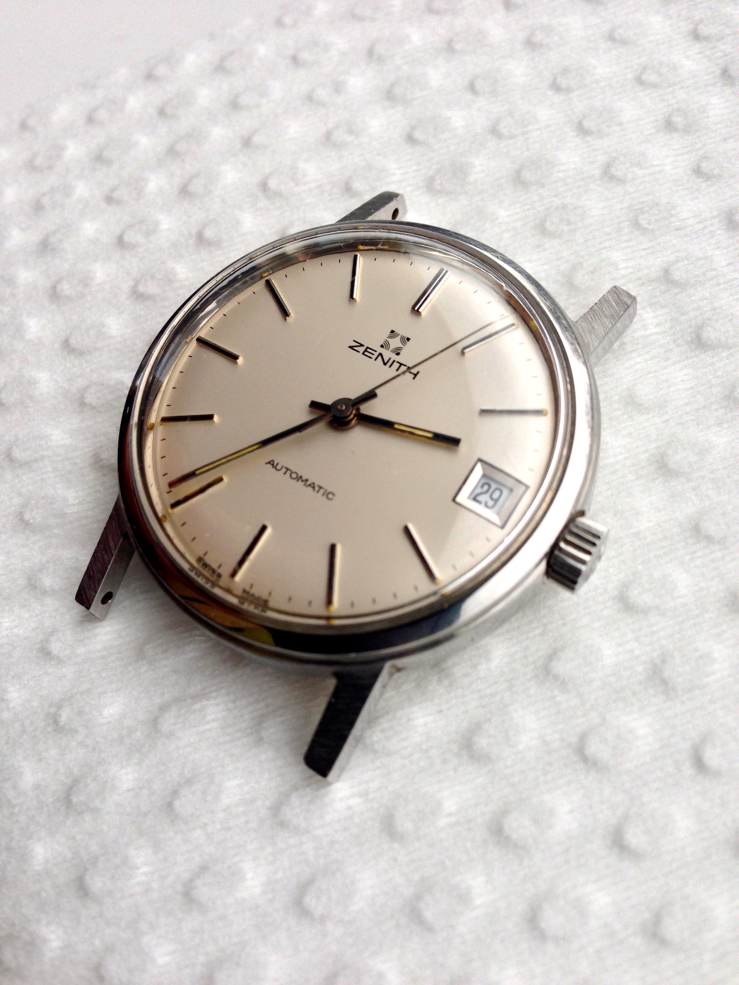

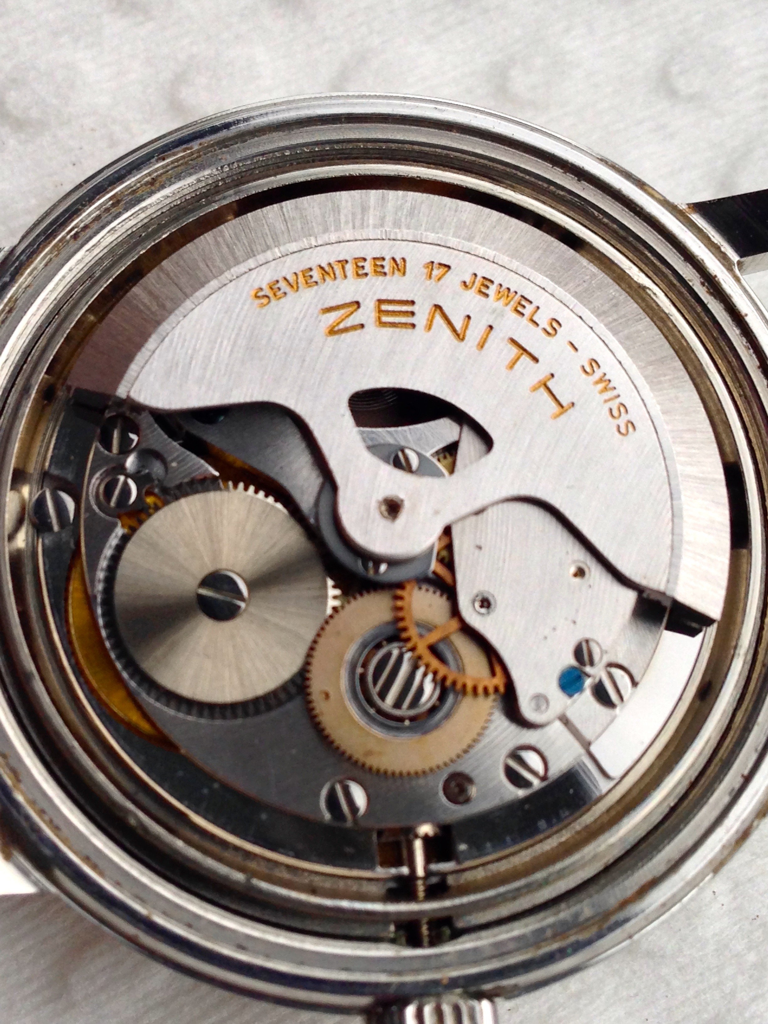

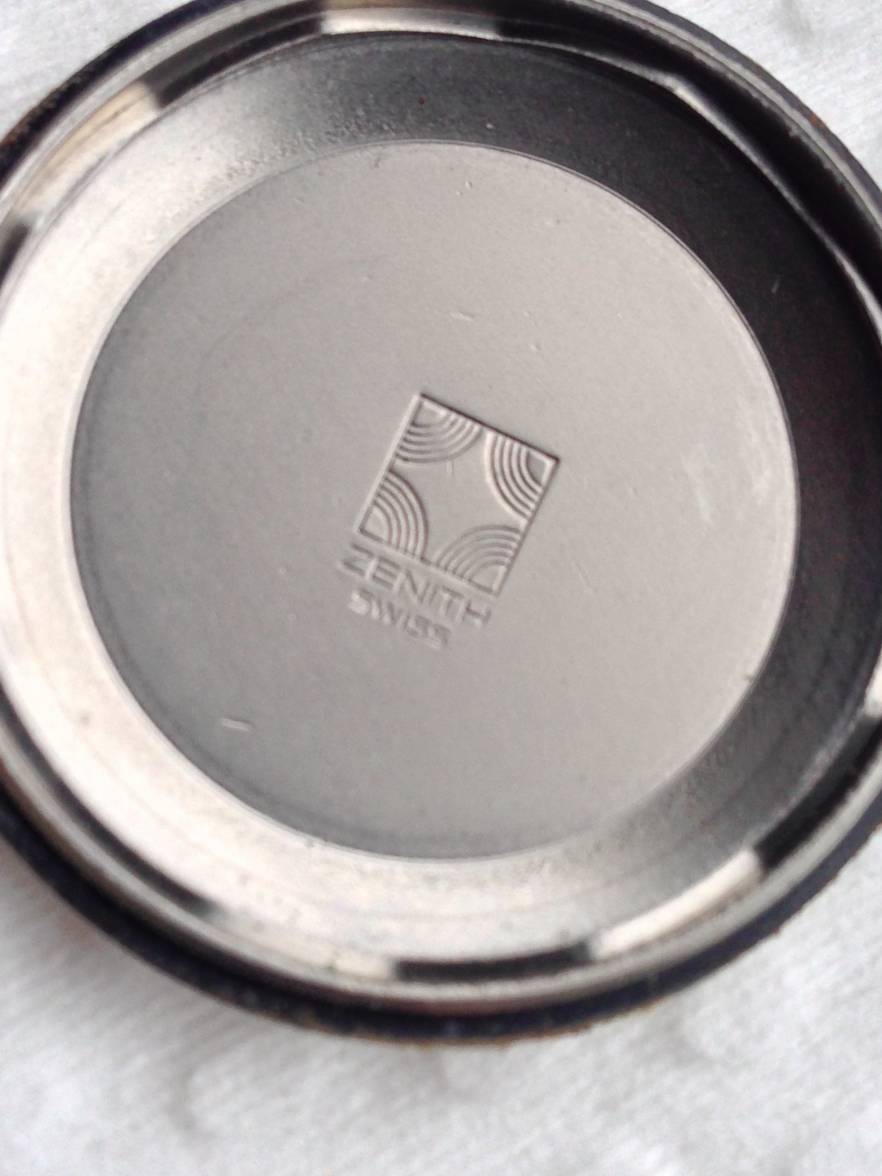

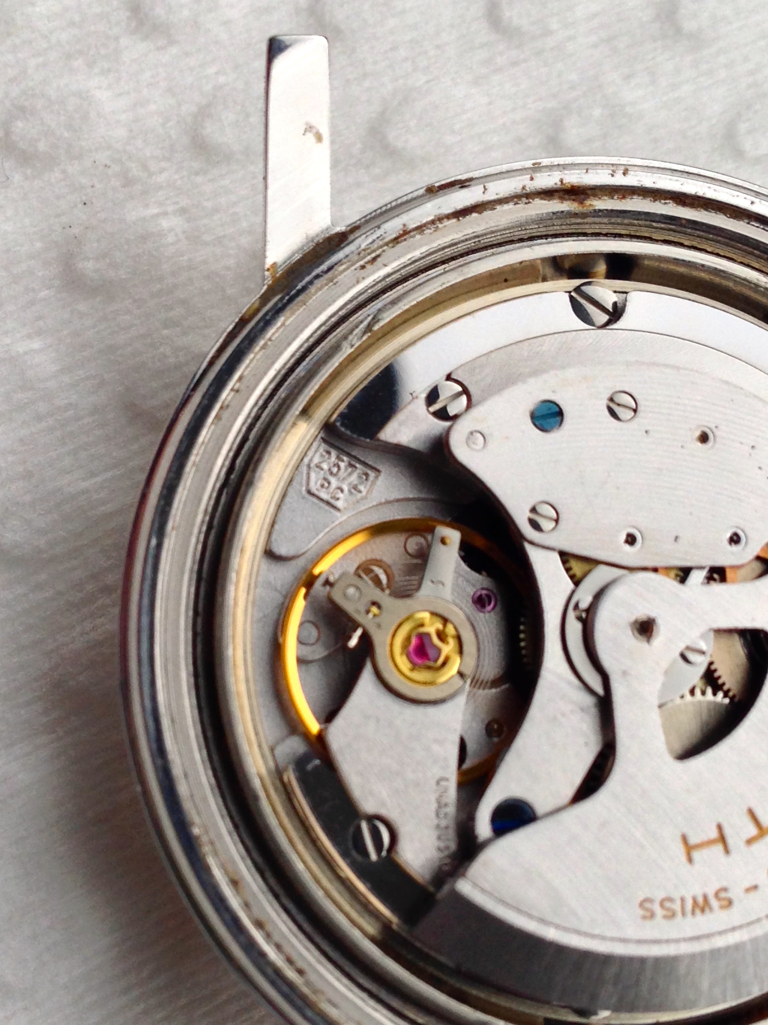

Picked up a small bundle today and amongst them a nice little surprise ( more about the others at a later time )
First Zenith, a small step but sure larger will follow. A 2572PC from if I am correct 1975/8 and the last of the Zenith movements ?
Any information or comments appreciated, and yes, some pics.
