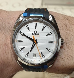

I recently bought an AT, but have found the 'wind' a lot stiffer compared to other watches I owned.
I popped into an OB today to sort out an problem with a PO, and told the manager about the issue with the winding on the AT - he said he had noticed the same on the ATs versus the other watches in the shop when he had been winding them, and hence he thought it was just something to do with that particular line.
I was inclined to believe him, as I didn't have the watch with me and hence he wasn't in danger of me asking him to go through the hassle of sending it off to sort it out.
But I wondered, just for confirmation, if anyone else experienced a similar issue with ATs?
