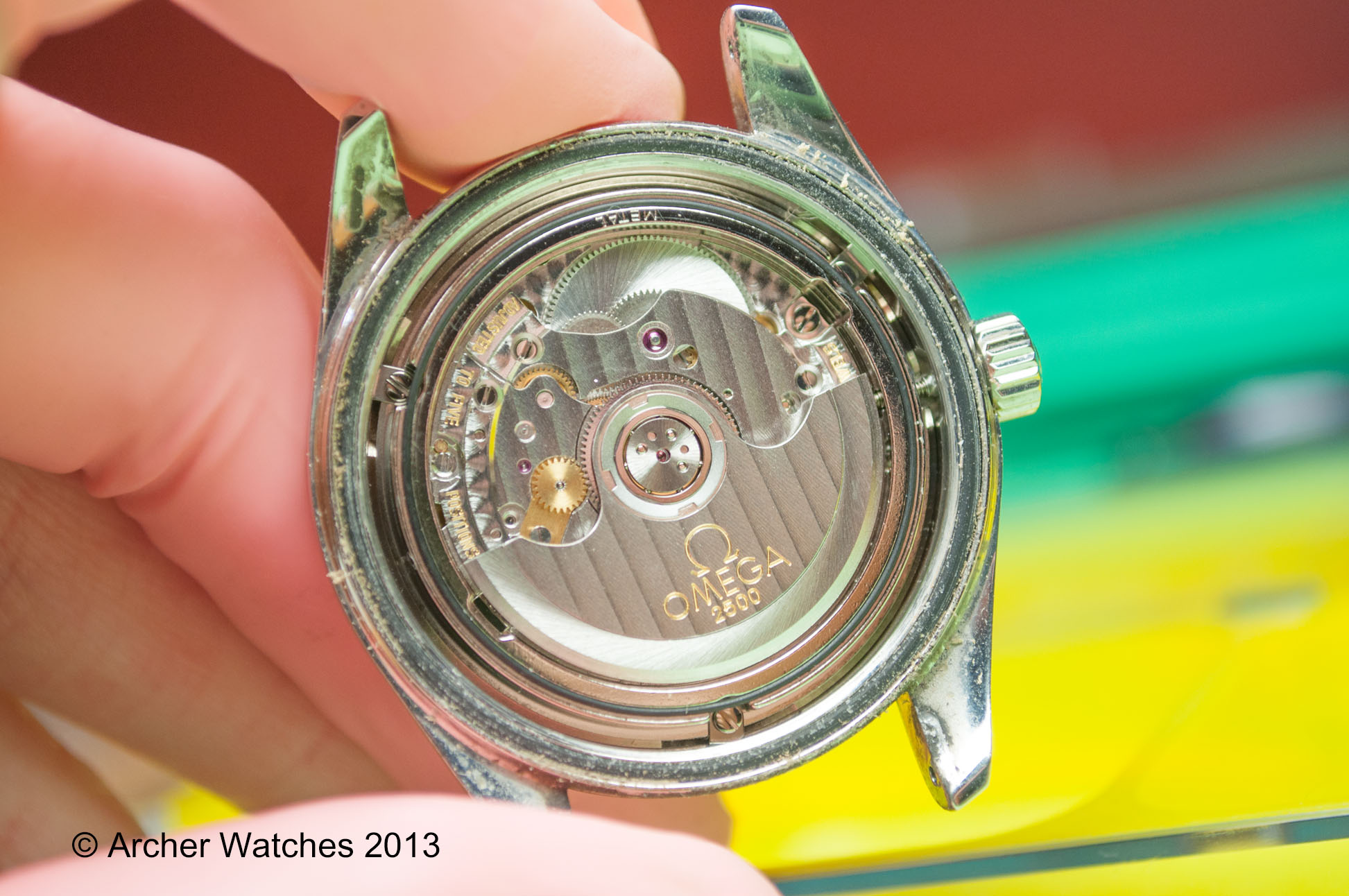

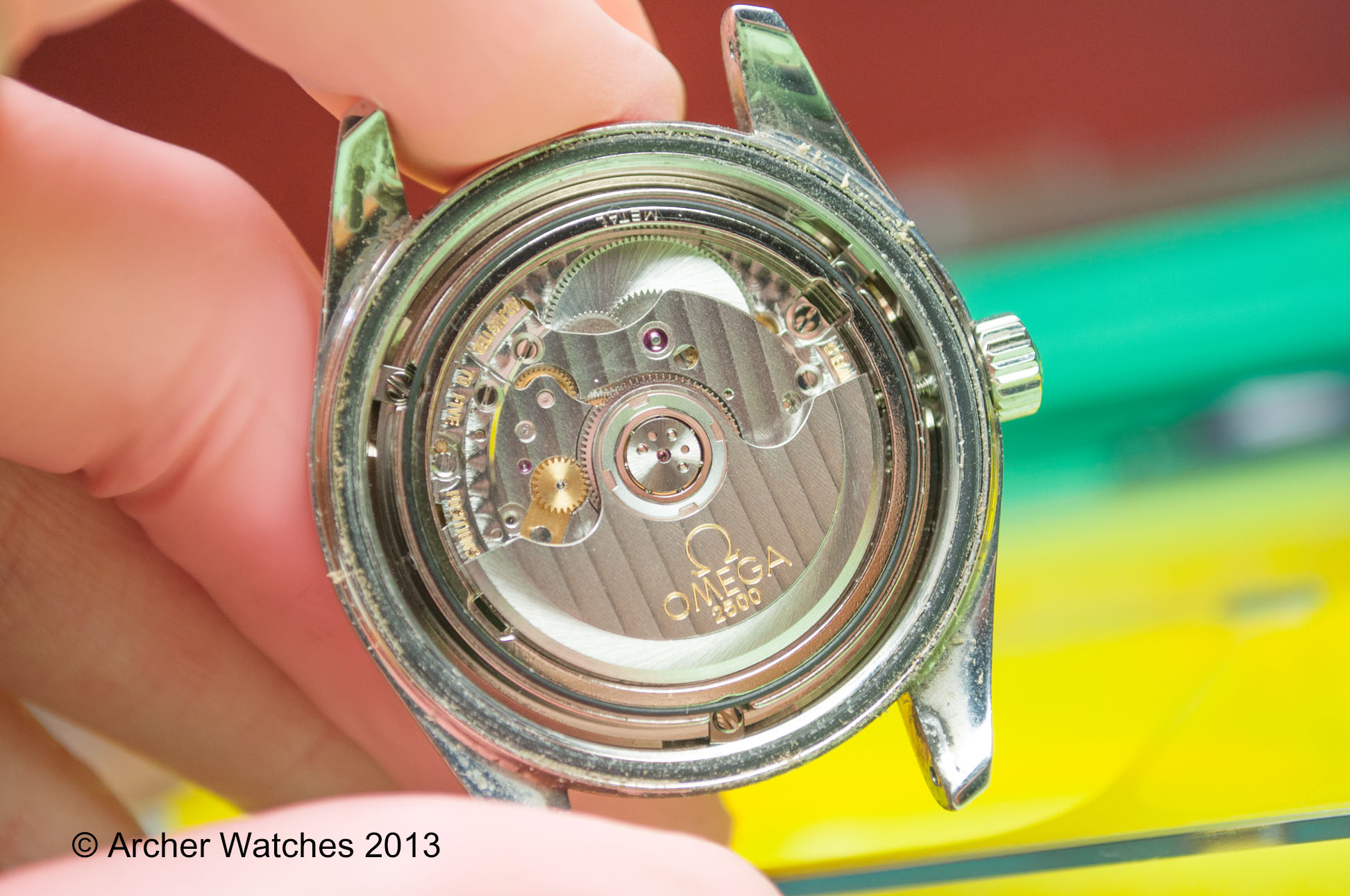

No. Here is a 25035000 with the case back off...

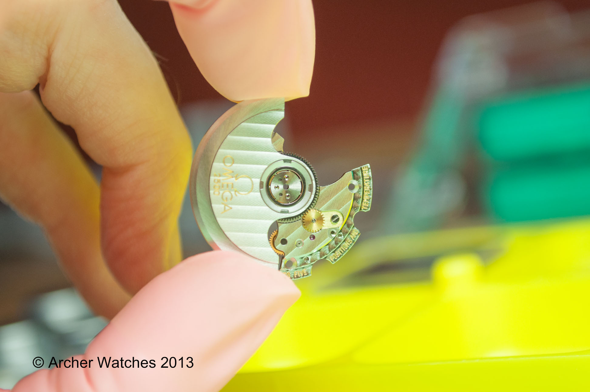

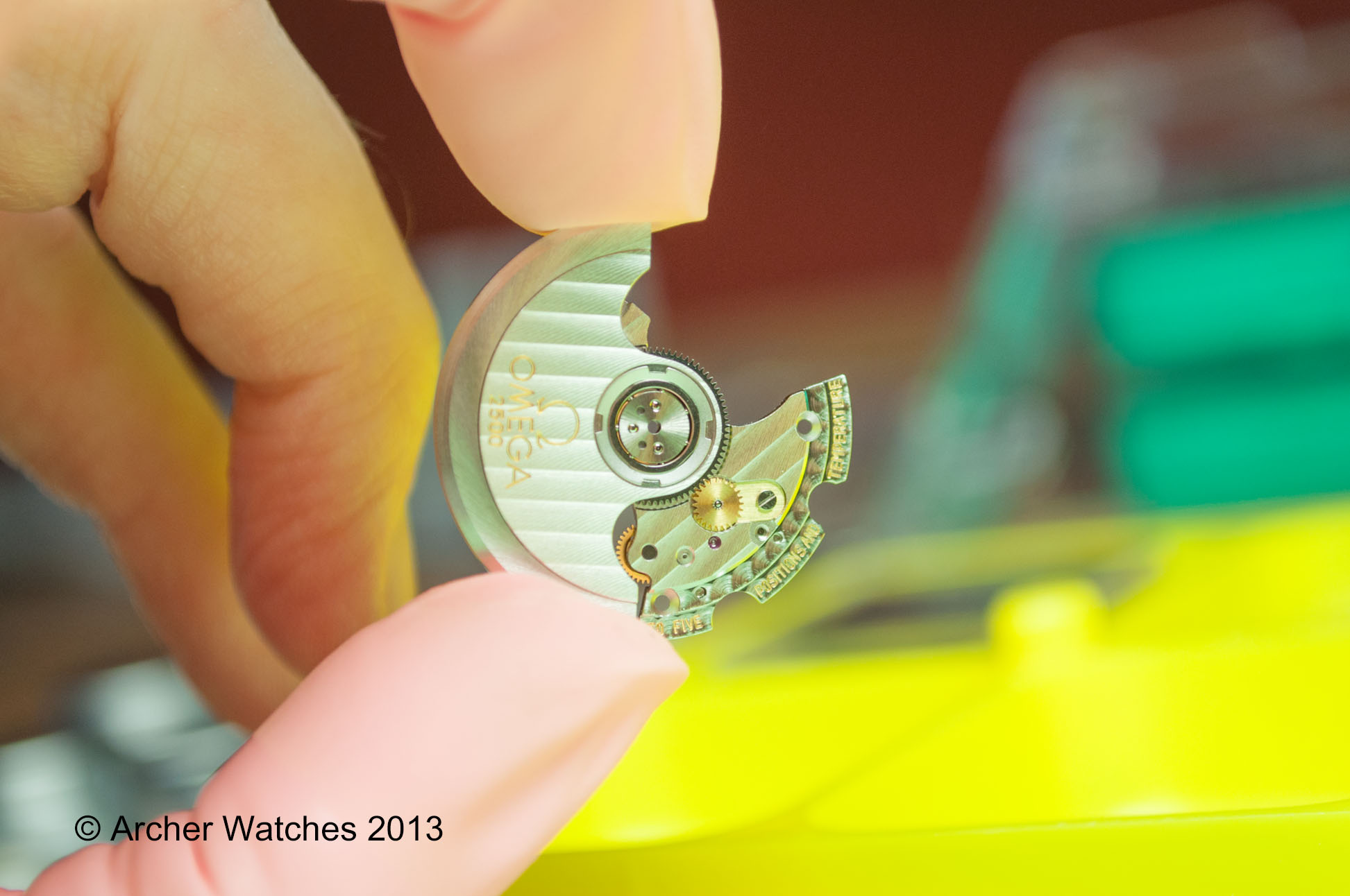

Here I have removed the automatic winding module...

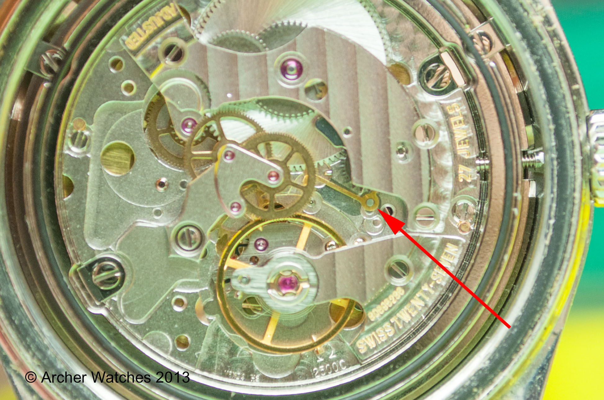

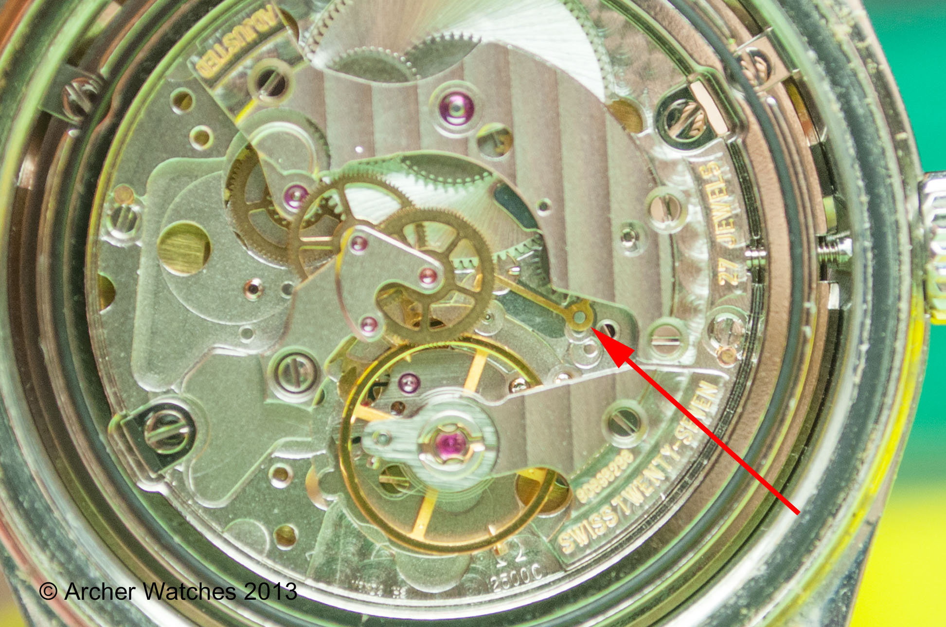

Right under that module, you can see the part that provides the hacking function - called the balance stop lever - at the red arrow...
The only thing holding this part in place is the automatic winding system being screwed in place, so when someone who may not be too familiar with this movement, or may not be too careful, removes the automatic system, they could easily lose the balance stop lever. There is also a chance that when the were assembling the movement, they may have set this lever is place and then when they placed the automatic parts they disturbed it, so it may not be installed properly.
This part is specific to the 2500 series of movements, so trying to use one from a Cal. 1120 or ETA 2892 (the movement the 2500 is based on ) will not work. If the person who last performed the service didn't have access to Omega parts, they would not be able to replace a lost or damaged stop lever. I would also say they likely didn't service the movement right if this doesn't work properly, so although it would be a simple fix, you should consider getting a full service by someone who knows how to service these watches properly (has been trained directly by Omega), and has access to the parts and proper tools needed to service these in the right way.
