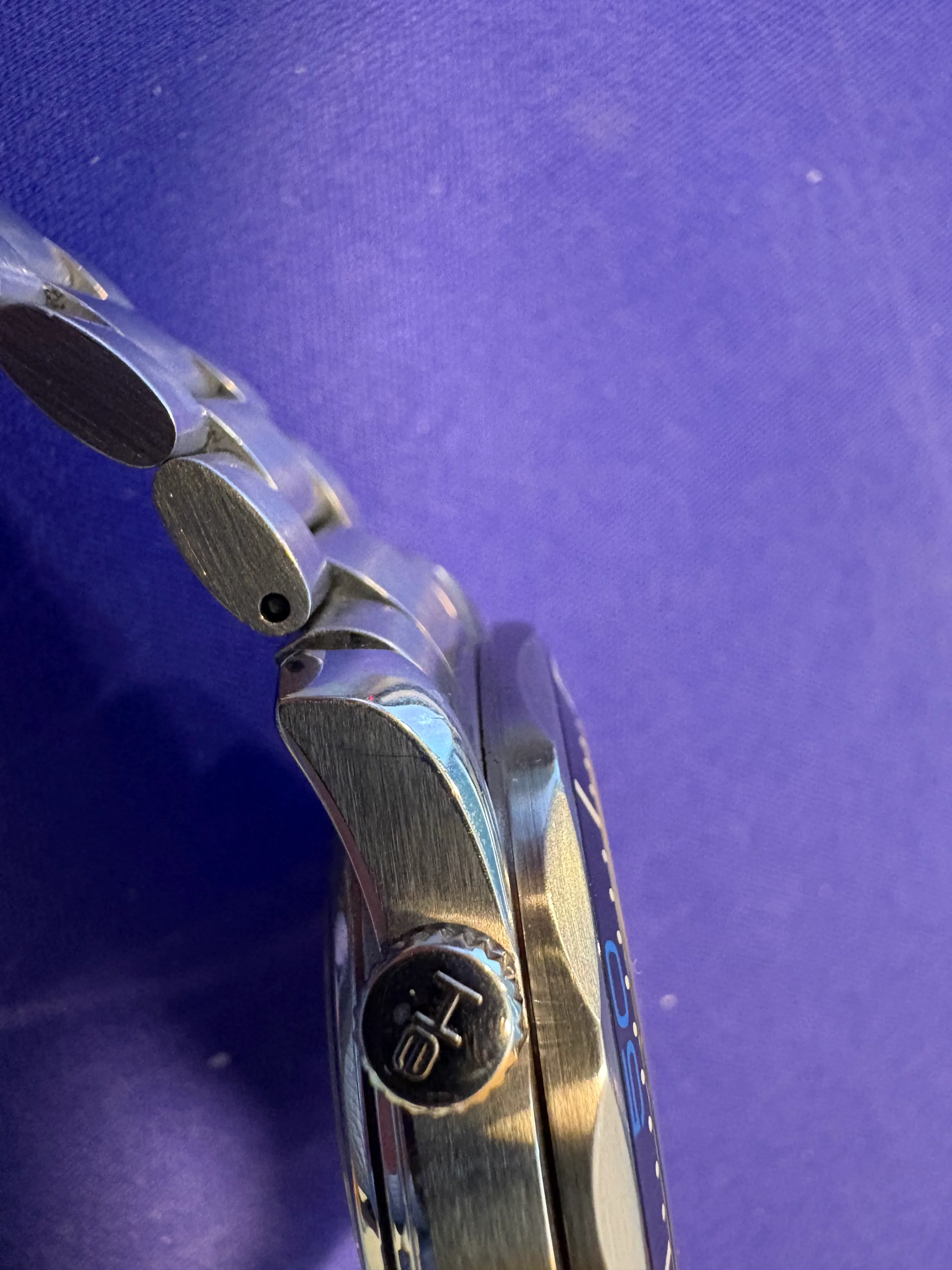

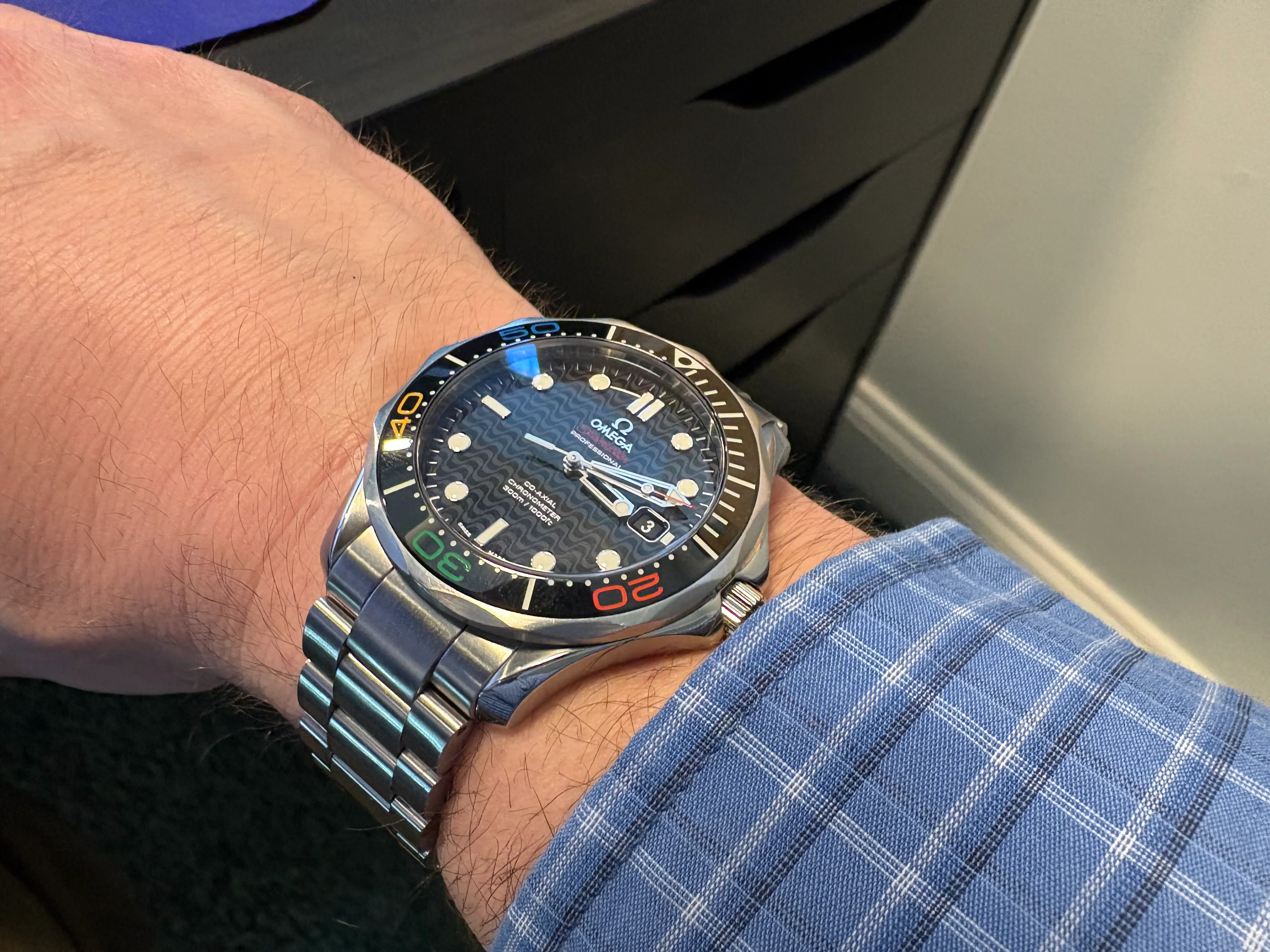

My 1574/898 arrived today, after a prolonged shipping delay. I was eager to see if this really works---and it does, and I'm quite thrilled with the result, as I love my 41mm ceramic diver, but dislike the non-tapering, chunky-clasp, and IMO way over-ornamented bracelet it came on. I just wanted a standard oyster-style bracelet, and I love the concealed clasps on the ATs.

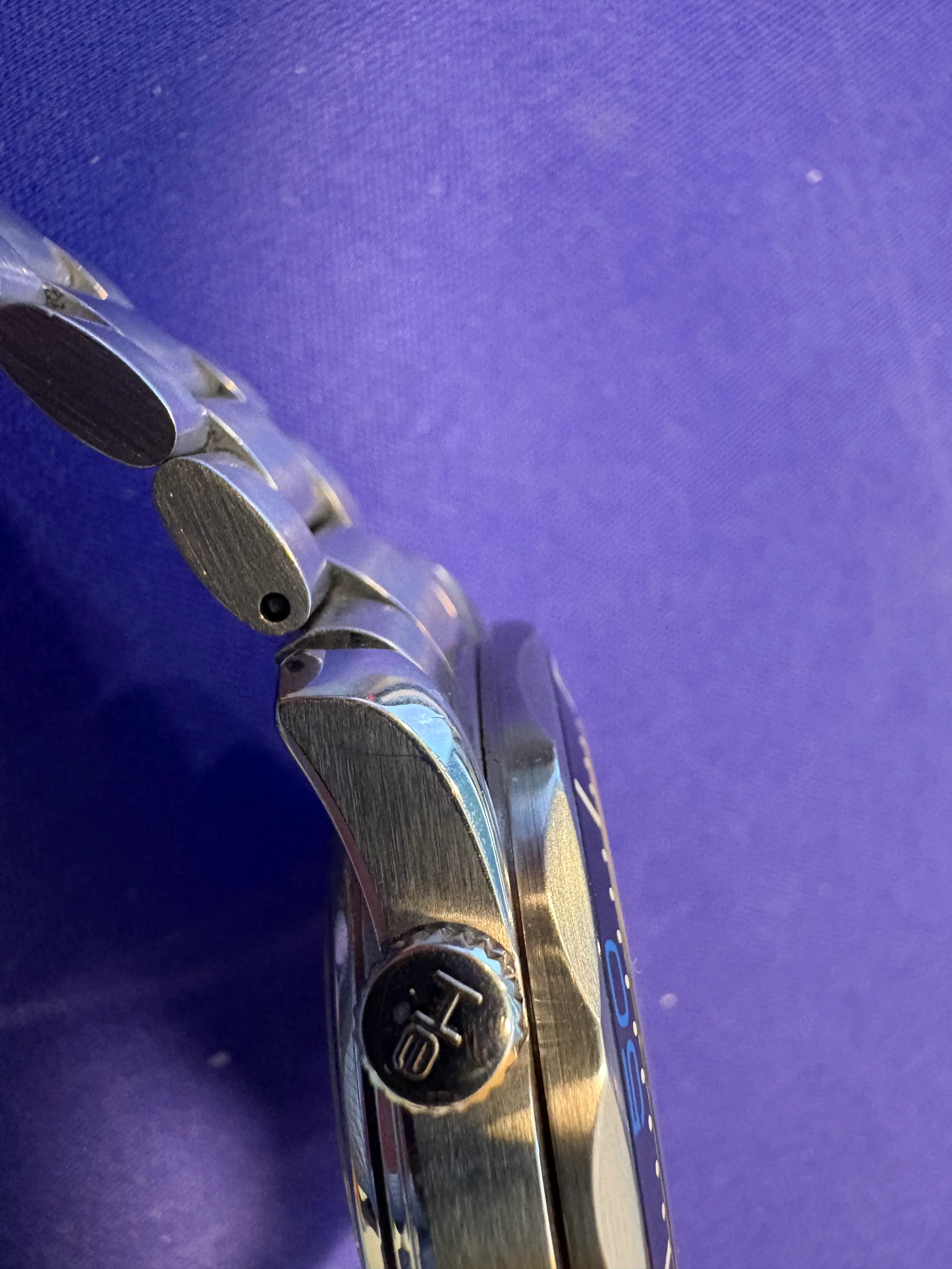

Fitment is perfect at the lugs---the springbars snap in as they should, and everything looks just right on the back. There's a slight protrusion at the lug-ends (pictured below), but it's only noticeable, really, side-on, and even then it's not enough to bother me. The picture exaggerates the phenomenon, as I'm pulling the bracelet straight out. (Quite frankly, I've owned other brand watches that have such protrusions from the factory.) To me the, the pros far outweigh this one small con.
SO much happier with this combo than the original one! And if I ever change my mind, I'll swap the original back on---it's going in the safe for now.
EDIT: after wearing for an hour, one other observation. This bracelet makes the watch wear significantly lighter, which is a big plus; it does balance a little differently than the original combo, making the watch a little more top-heavy.

Looks good! That style of endlink protrusion basically makes it a white gold Daytona.

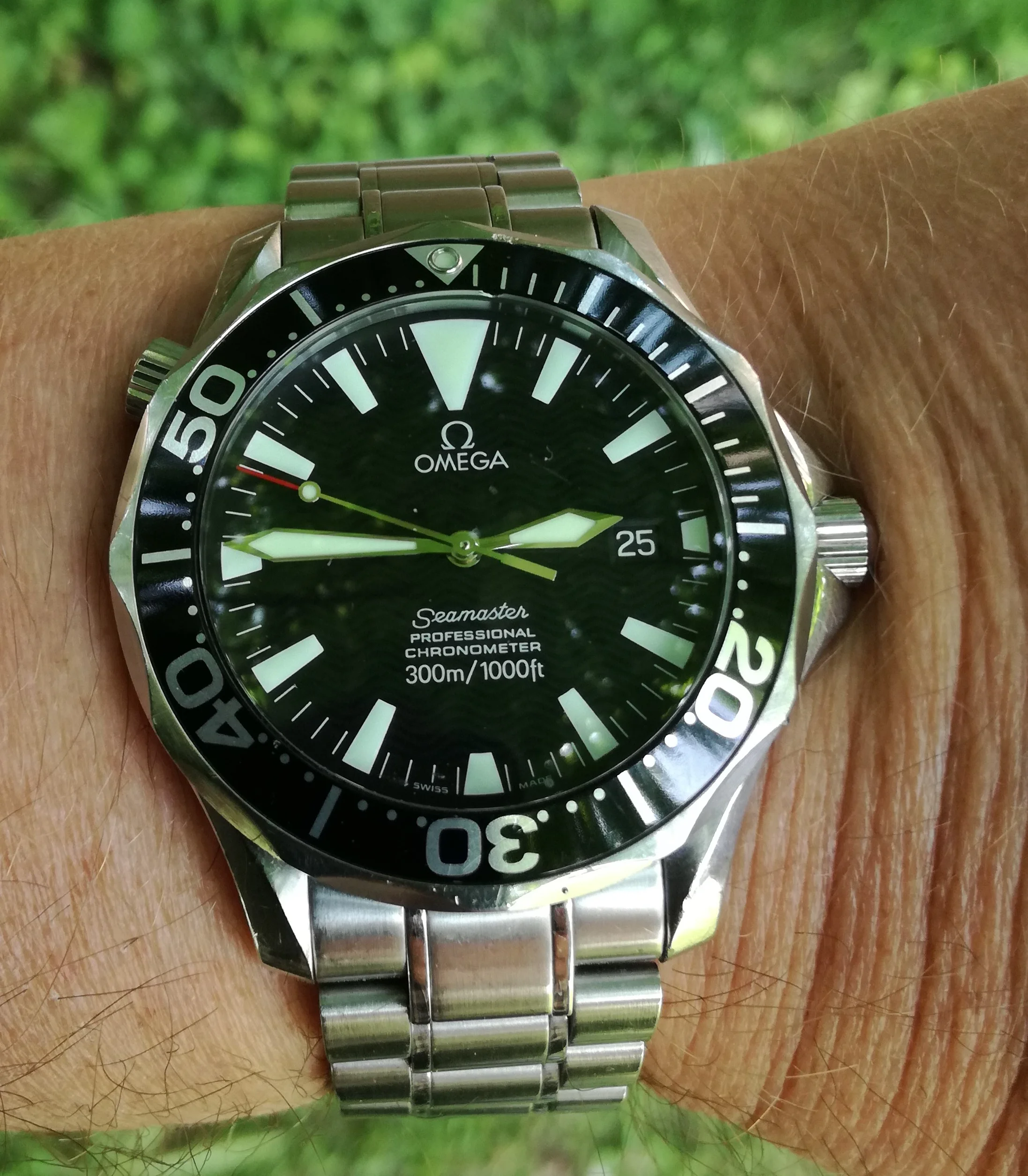

This is my favorite bracelet for my 41mm SMP's. In fact, I'm writing this with this bracelet on my 2531.80. The minor protrusion is something I noticed as well. And within 5 minutes I never thought about it again (until I read threads like this). It is 100% not an issue in real life.
If you want to continue down the rabbit hole of style and comfort, you can add a Heritage 300 adjustable clasp to the bracelet.

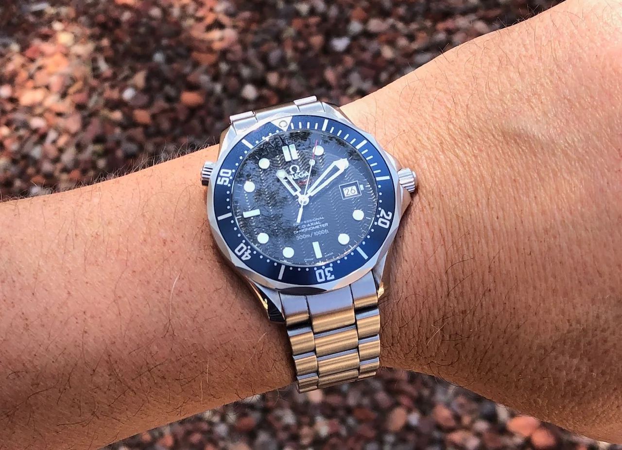

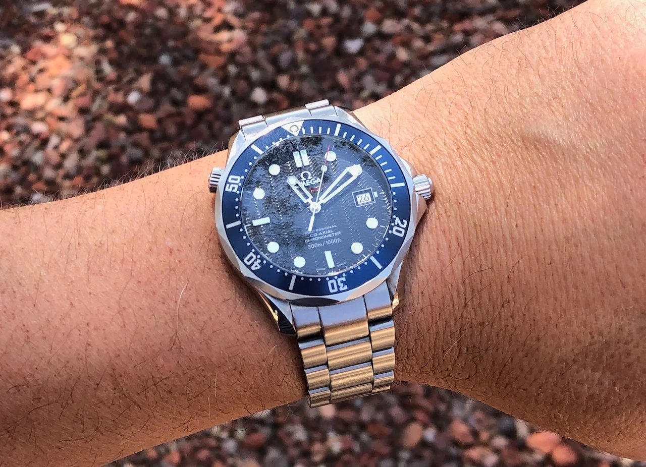

Did you need to use 1.5mm springbars? With my 2541.80 and 2531.80 I can use 1.8mm springbars. But for my 2220.80 I need to use 1.5mm springbars.
Here is my 2220.80 with the AT bracelet.

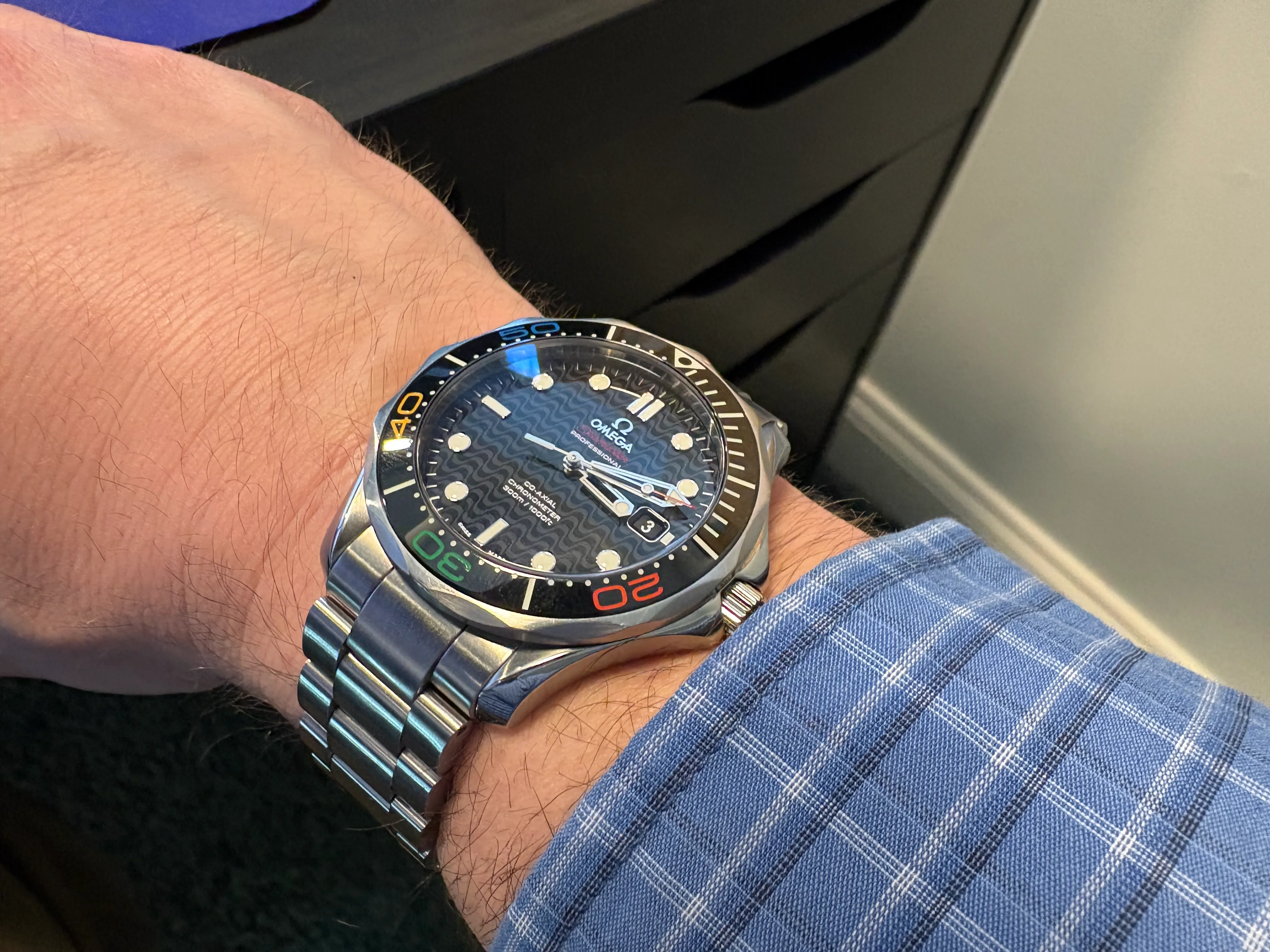

It will fit the no wave ceramics of the mid-2010's. But not the current 42mm version. I also have this bracelet. My complaint is that the mid-links on the end links stick out too far. The AT bracelet end link mid-link has more curve down toward your arm. But if someone has a large wrist they probably wouldn't notice.

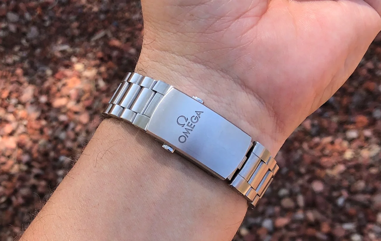

@502 to right --- good morning I hope this finds you well. I am in the process of also replacing the bracelet on my seamaster 41mm. However I noticed that @Annapolis used the 1574/898 AT bracelet and when I see the photo of your seamaster the bracelet has a different clasp than the 1574/898. Your clasp is diver style while the 1574/898 is a more dressier clasp. Would you mind sharing the bracelet model and serial number you have on your seamaster? I am struggling to find a 1574/898 in a good condition at a reasonable price so I want to make sure I consider all other possible OEM Omega bracelets that fits the 41mm. Any help you can provide will be greatly appreciated.
2,698
3,017

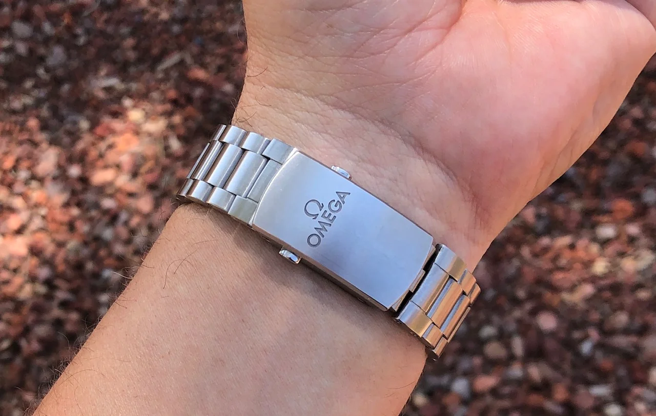

I think he replaced the standard clasp on the 1574/898 with a different clasp. Here's a picture of my 1574/898 on my Seamaster. Bracelet should look like this.

See post #66 in the attached thread. The parts are the same for the 1574/898.
https://www.watchuseek.com/threads/adjustable-clasp-conversion-compilation.5396509/#replies
7
thank you so much
@502 to right --- good morning and sorry to bother you again. I read all the comments on the link you provided and see the 3 clasp options. However, since the 1574 898 tappers at approximately 17mm I could not conclude which clasp model number is the one you have. I really like how your 1574 898 bracelet looks with that clasp from looking at your photo. If you don't mind and when you have time can you please let me know the clasp model number?
7
I think I found it... please let me know if I am on the right track
Bracelet for 1st Gen 39mm Aqua Terra 1574/898 - Part No. 020ST1574898
Links to connect bracelet to clasp - Part No. 118ST1589 (you need 2)
Clasp for 2021 Omega 300 Heritage - Part No. 117STZ014058

Correct
