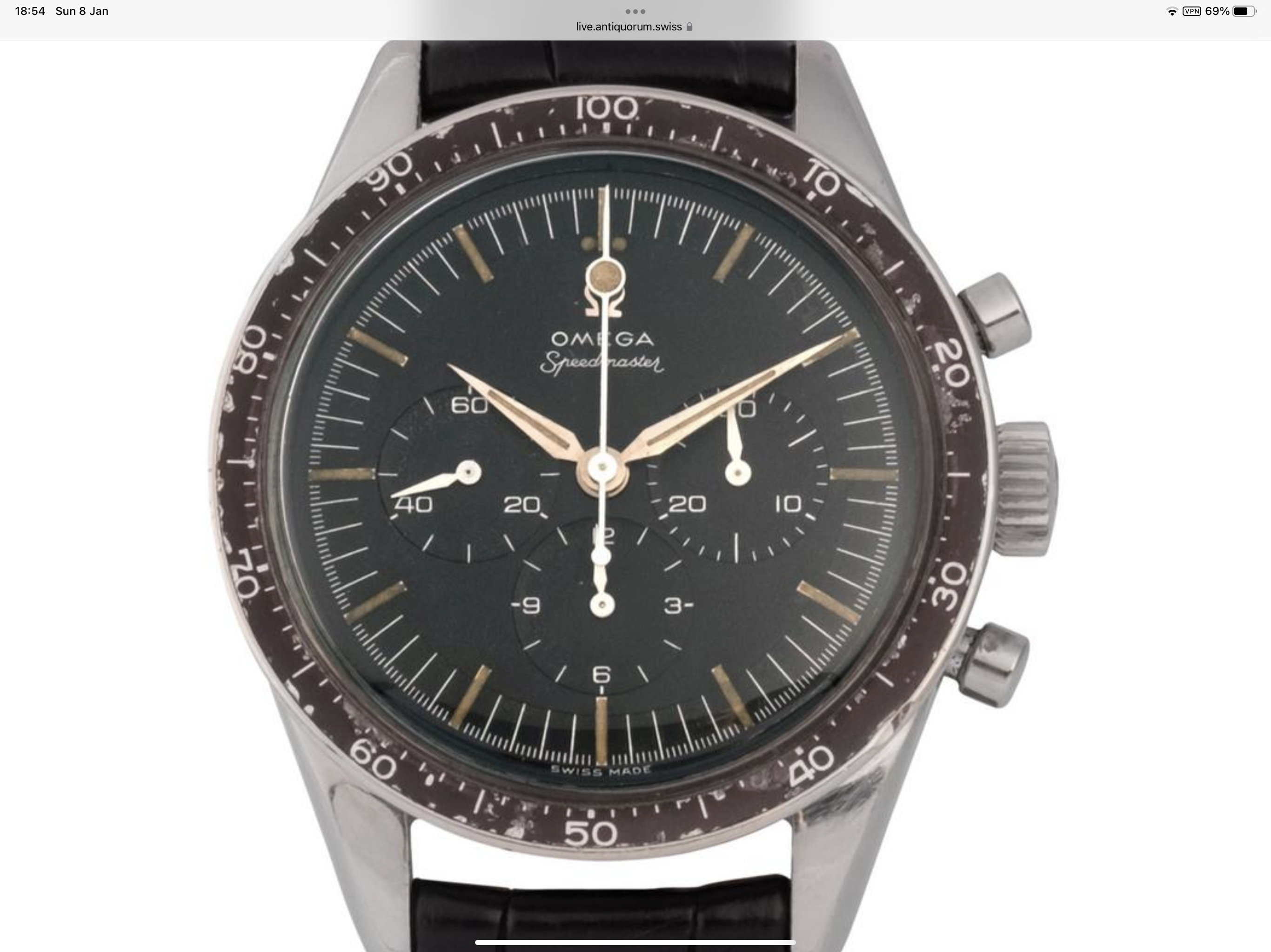

This watch is offered by Antiquorum on a live auction in January 2023. Link here.
As we can see immediately there is a bezel, which may or may not be genuine, and has faded slightly brown. If I was trying to fool people with this kind of bezel, I would make it brown and I would keep it in my pocket full of stones. I’m not trying to fool people, but I think a lot of people who put Watches in auctions are.

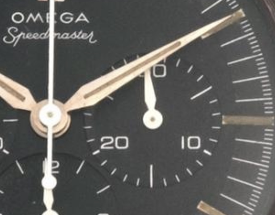

The dial of this watch is correct for a -1, and this can be seen in the short indices on the minute subdial:

The hands have lume slots with square ends on the hour hand and round ends on the minute hand . This configuration was also seen in the recent Philip sale of a 2998 with a brown dial that sold for over $110,000 in the winter.
It doesn’t mean to say that it’s right, and in any event it means that I value it less than if it had the triangle lume hour hand .

How does a person who wears a Speedmaster get chips on the inner ring of the bezel? There are no nicks on the steel ring that matches the outside edge nicks. Also, if the bezel took this much abuse wouldn't we expect nicks and scratches on the case to match the knuckle dragger? That case looks worked.
It's easy to discount the value of the bezel, but it leaves a stink thinking that the seller thinks so little of a potential buyer.
I learned about the pointy end lume slots from your blog. Since then I assume a square end is a service hand. Were there some 2998 alpha hands that came originally with square slot ends?
Those subregister hands may be original but they are so white that they are a bit distracting. In your experience do you think they could be original, ie are they typically this clean?

I think we should assume the bezel is not legitimate, and even if it were, the correct bezel will never be found. If you found one, how much to buy it? The dial is not one of the more attractive I’ve seen. I’d expect it to bring less than 20 as it is. Truthfully, I think 15 is closer. But there’s not much supply of -1s. I’d MUCH prefer an attractive-4,5,6 than this one at the same price.
Did you mention the much-too-white sub dial hands and sweep hand?

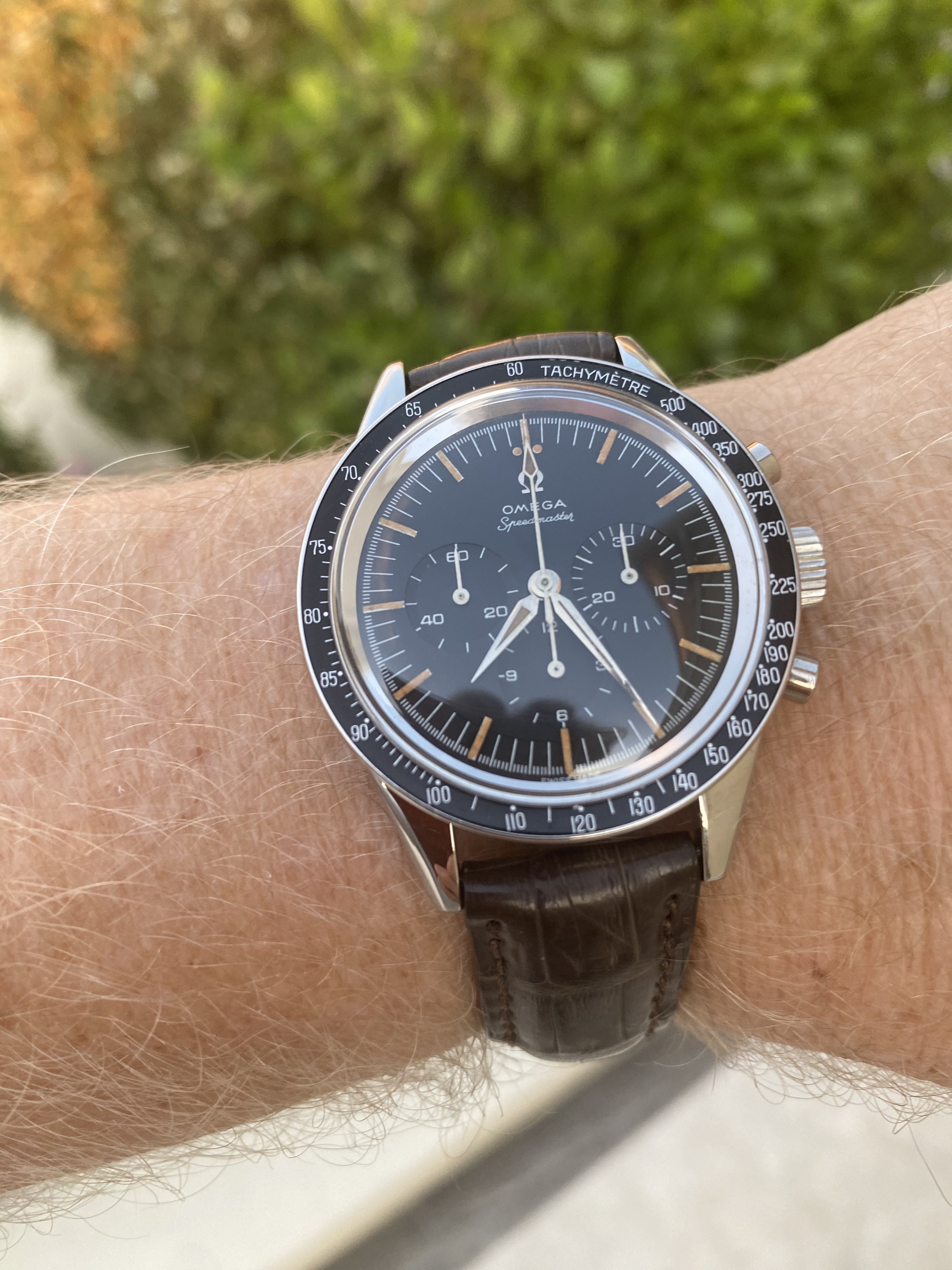

For context this is my current wearer, a 2998-6
Obviously it has the later dial compared to the OP watch, but for me this is a 2998 worth having
a quick thought on the alpha hands - sharp cut square end slots in flat hands indicate service hands.
I have seen some original hands with what look square ends, but curved hands. On very close inspection the square cutouts are not as sharp. So it is a little fluid.
however in terms of value, the handset with the triangle lume, transverse curve will always be valued more in my eyes.
