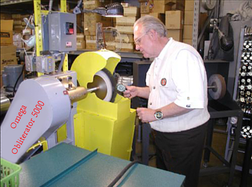

I believe in using the factory correct tools when ever possible. I get all my watches done once a week fast with one of these.
Takes only 10 minutes for the whole lot. 👍
