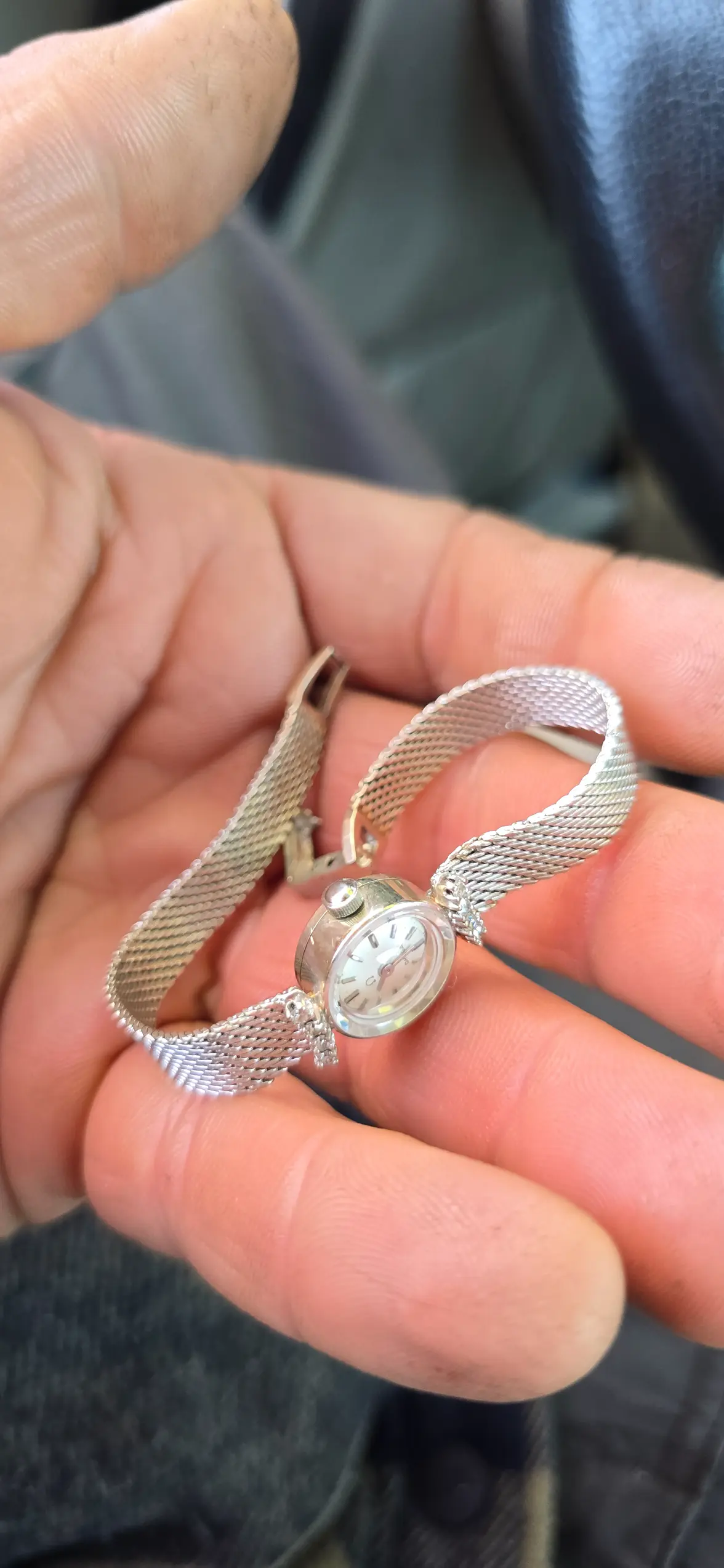

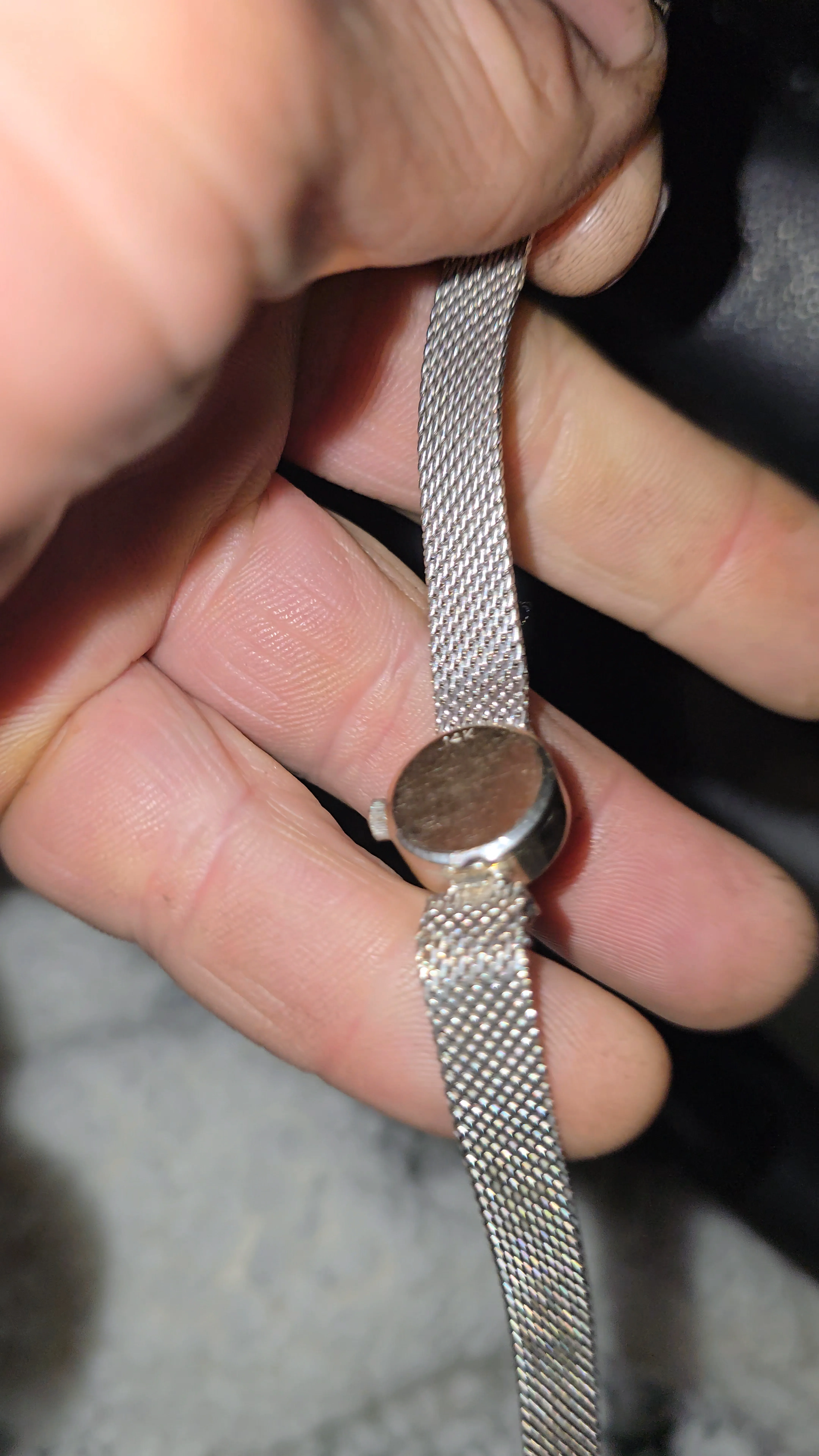

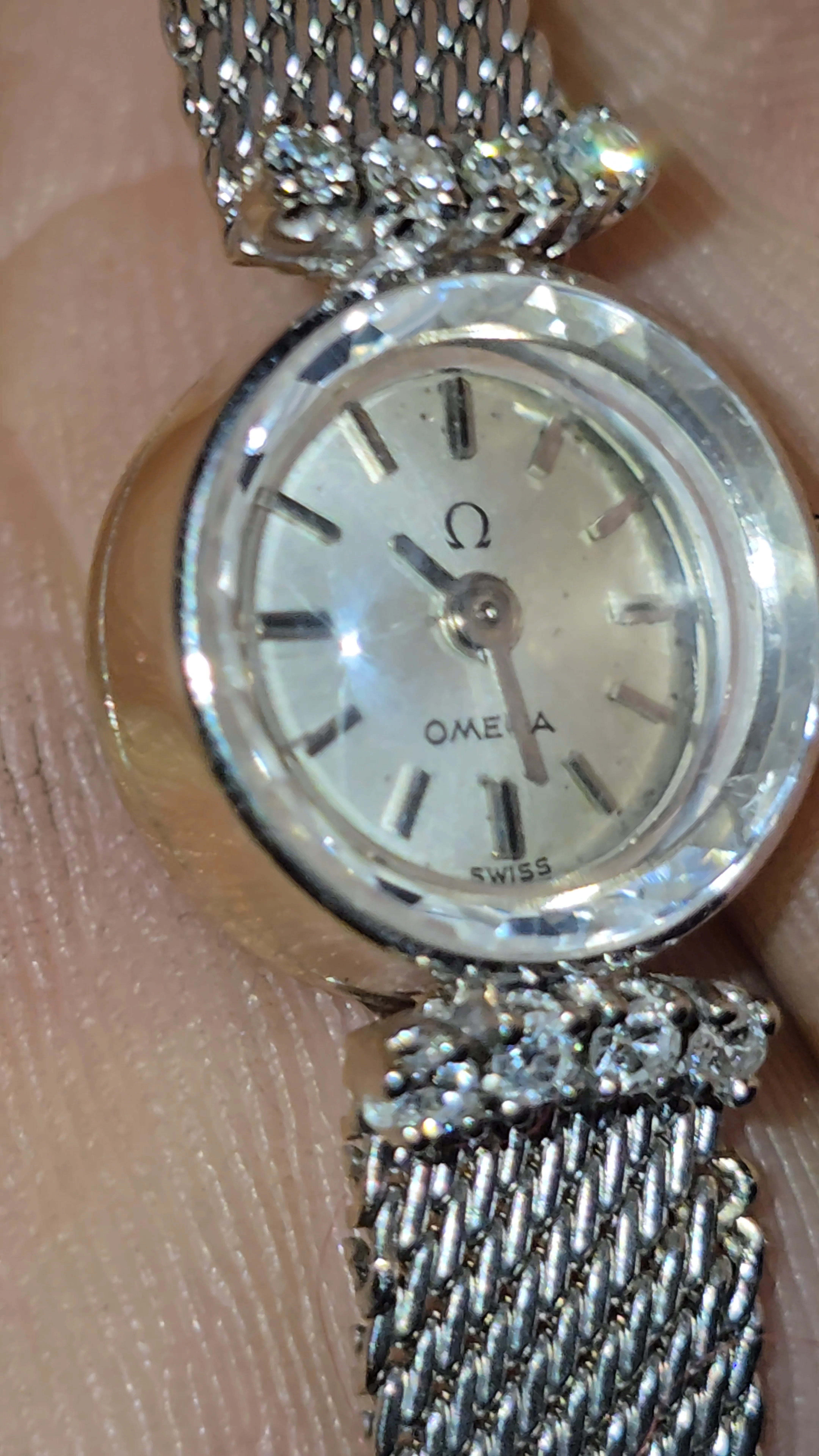

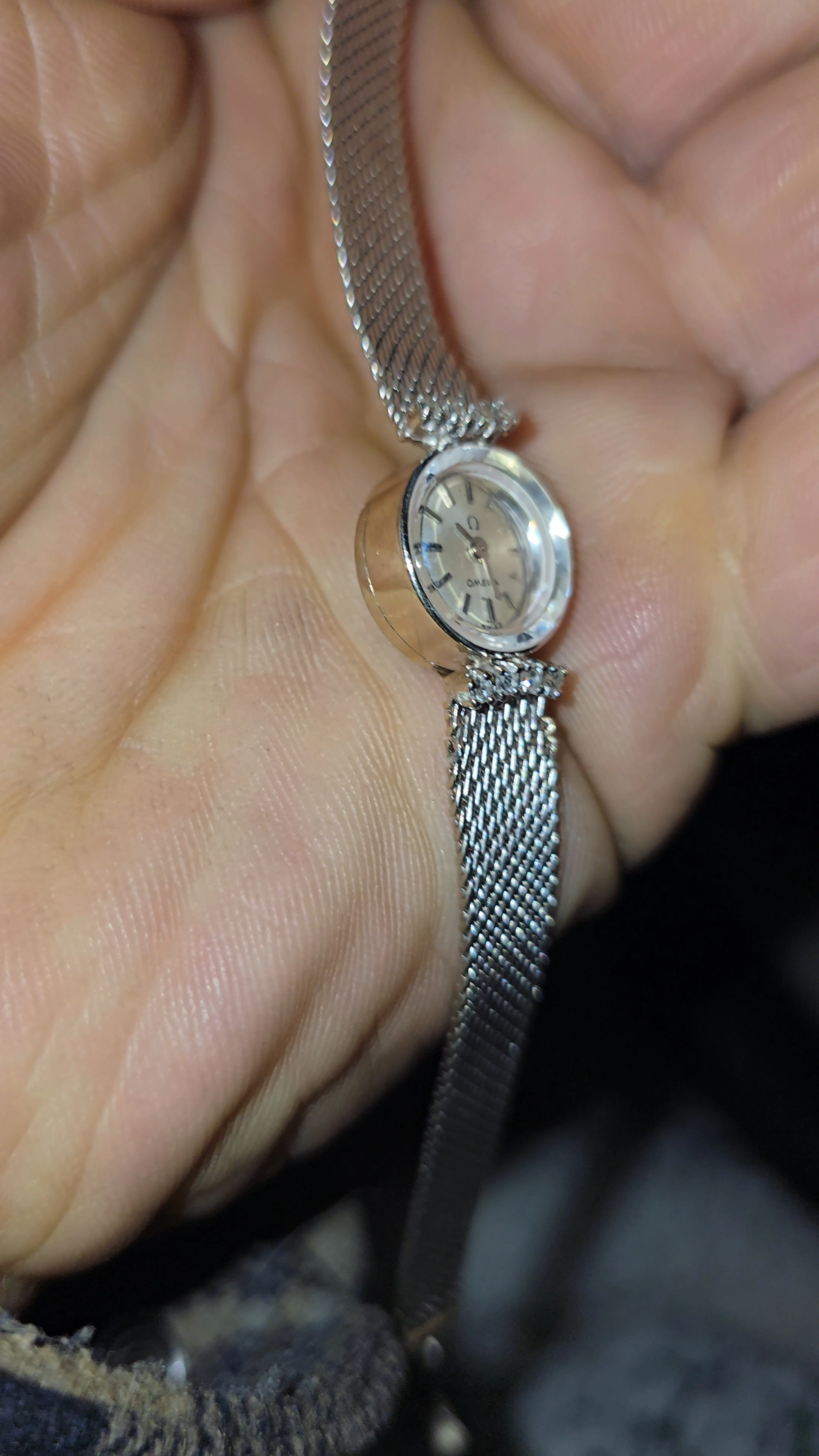

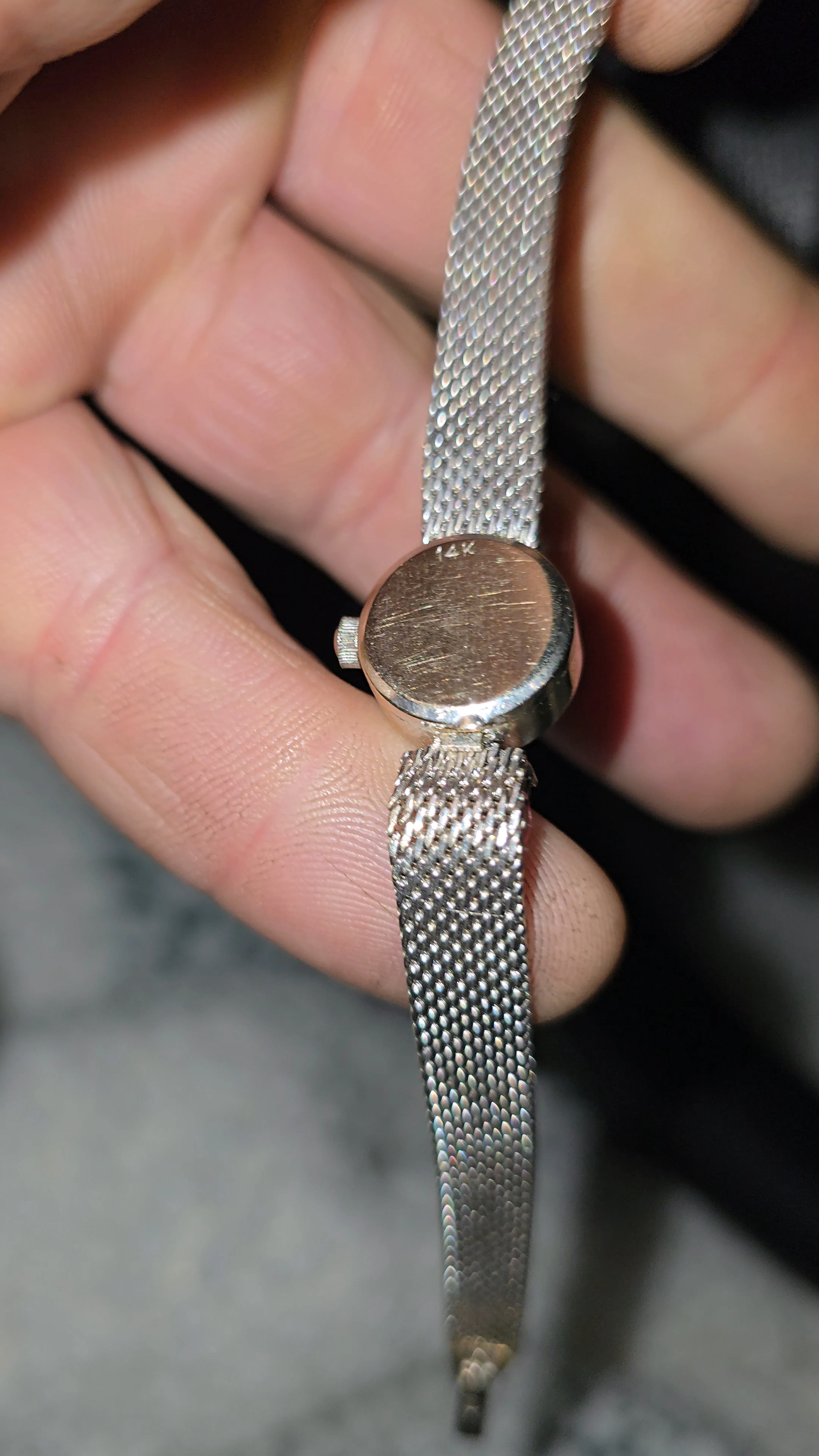

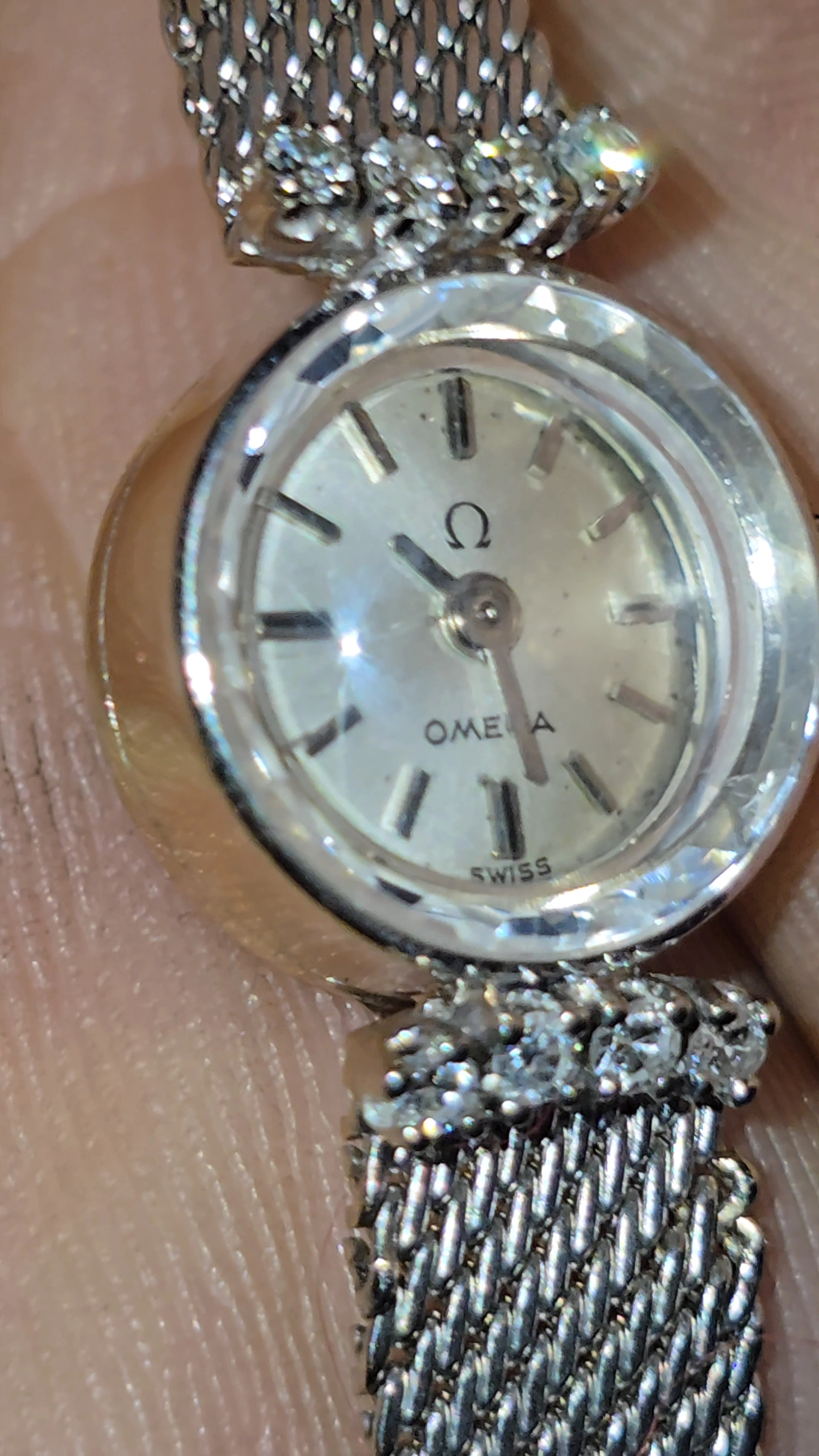

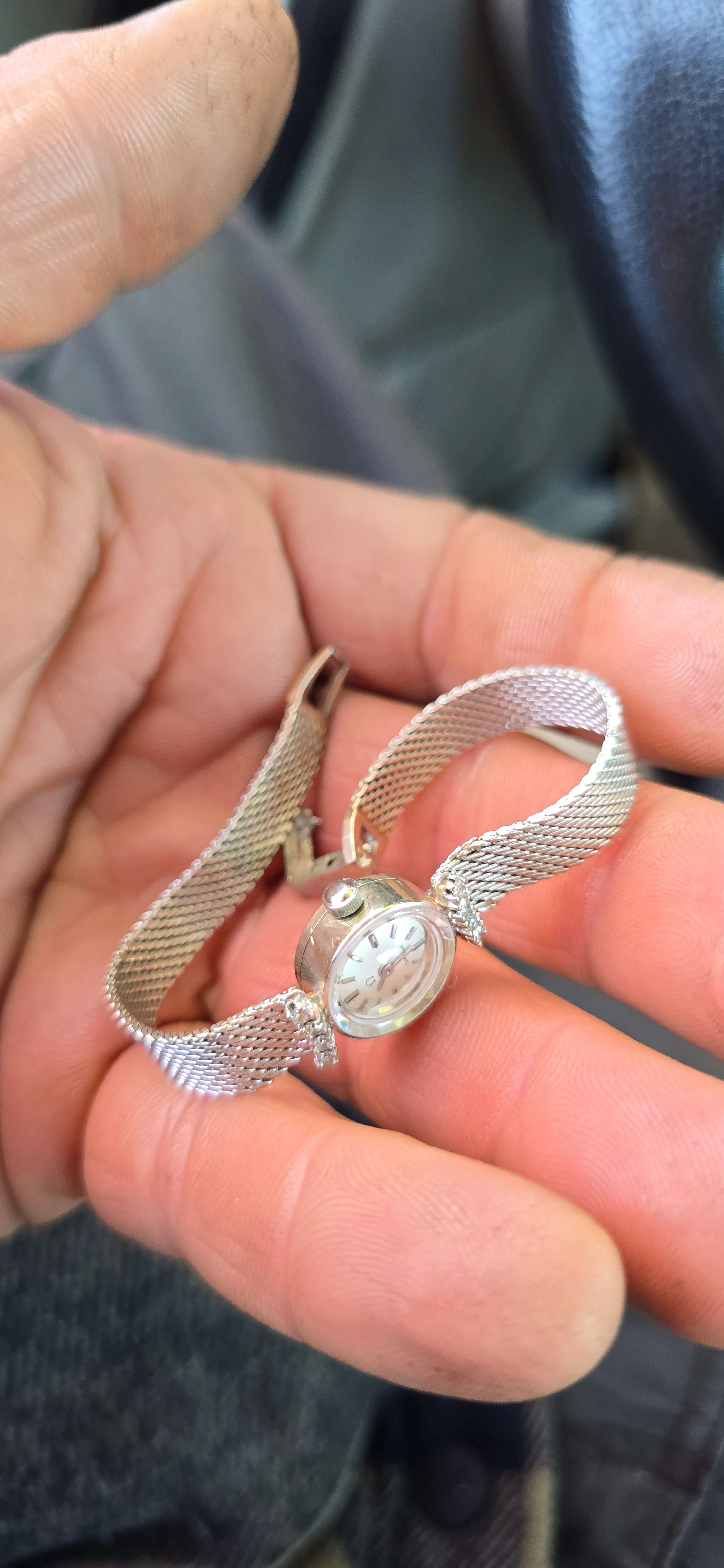

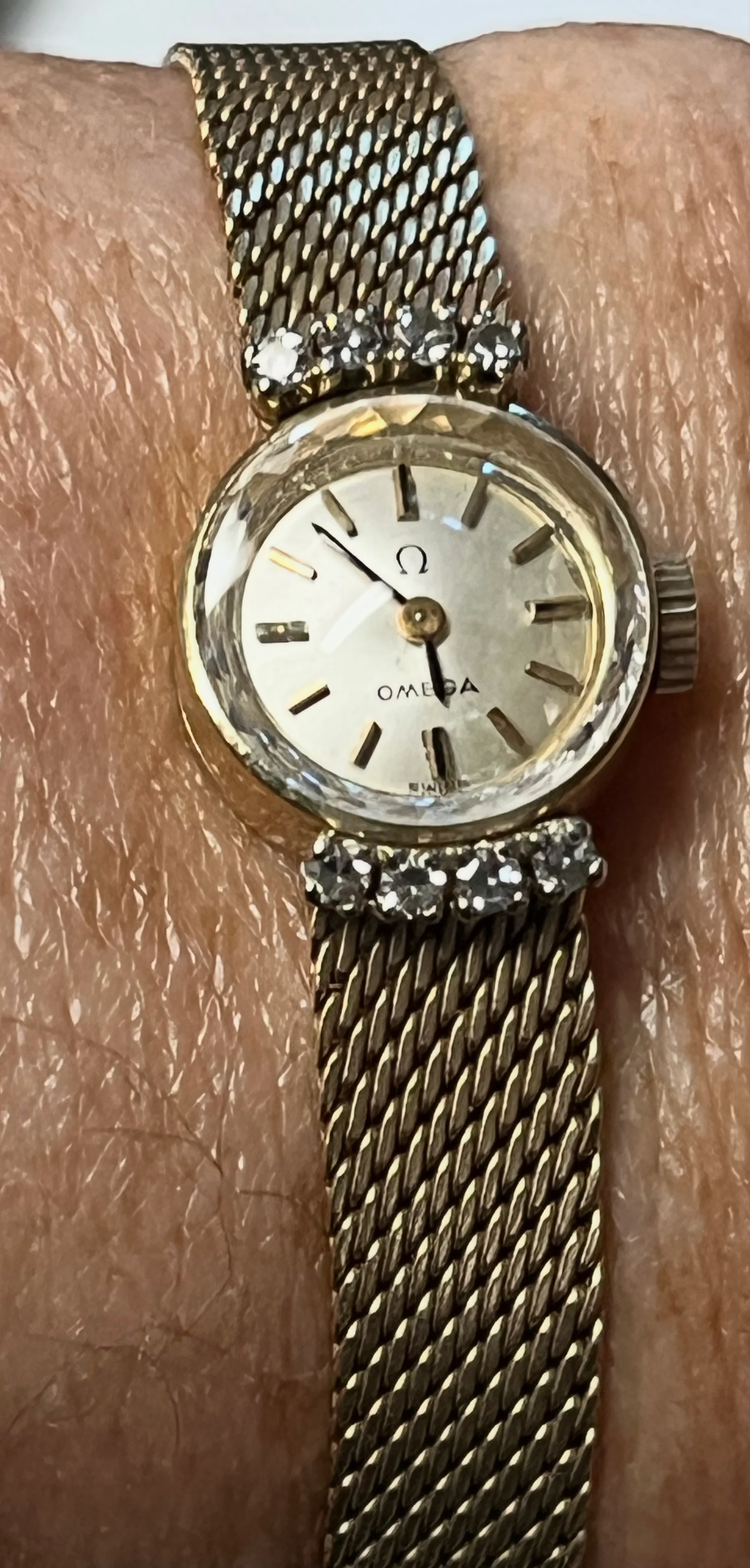

If anybody can give me insight I would appreciate it very much. I was in a jam last year and I melted down a piece that I regret with all my soul.
4
I dunno, feels pretty real. It was purchased new once upon a long time ago.
7,799
14,399
It's a snap back, open it up and much will be revealed. Like it or not the value is the gold content, it's not a collectible piece.
2,671
2,856

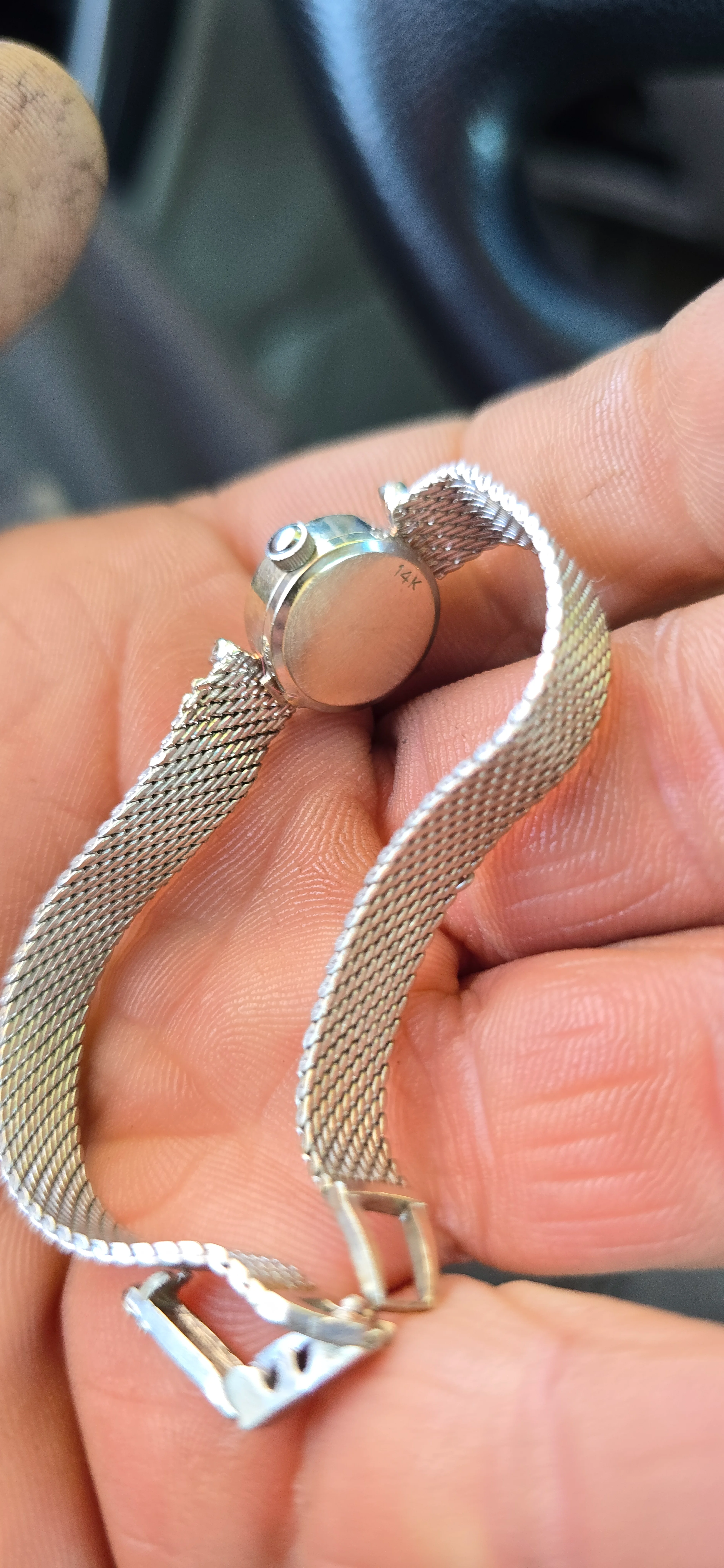

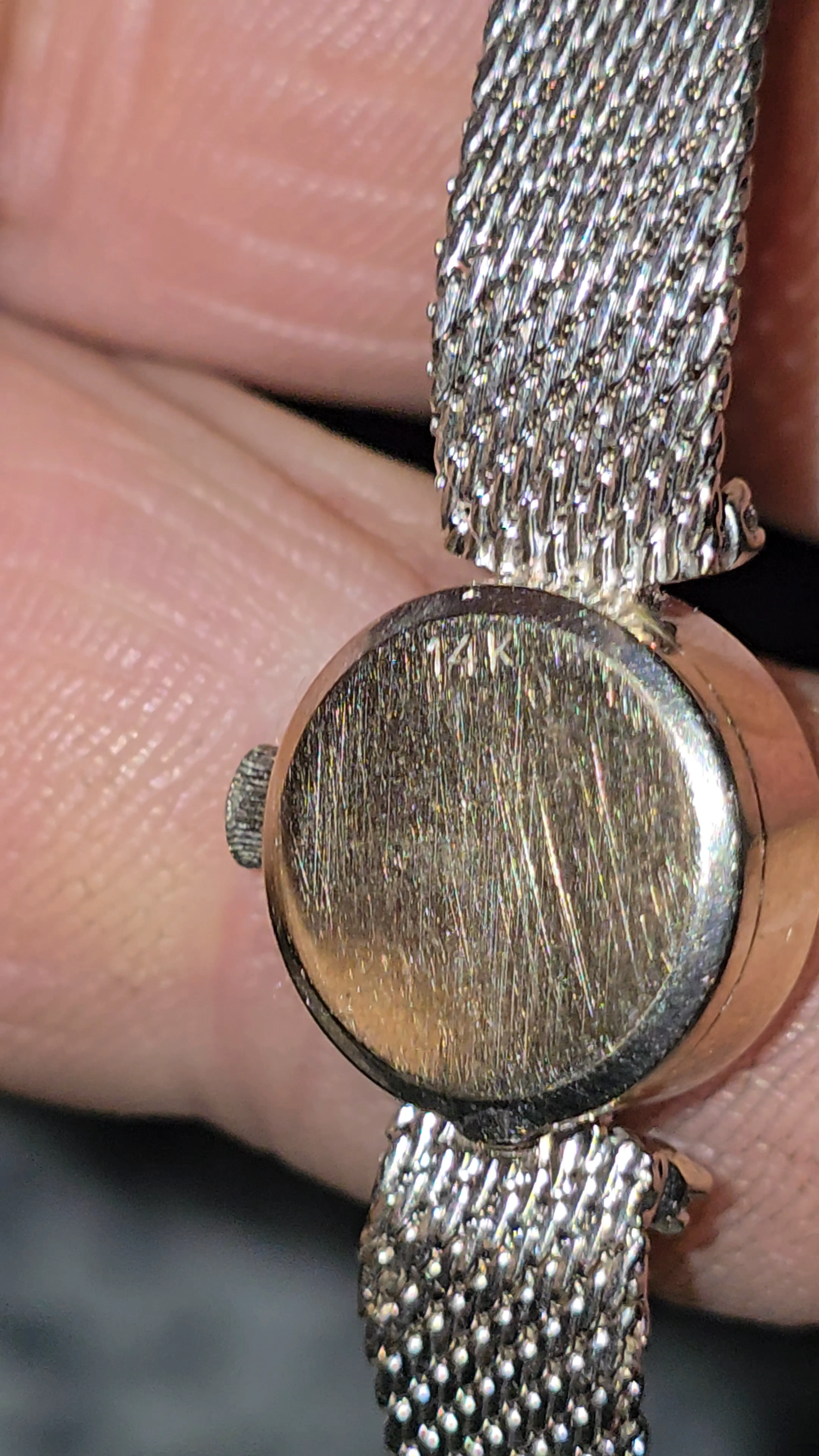

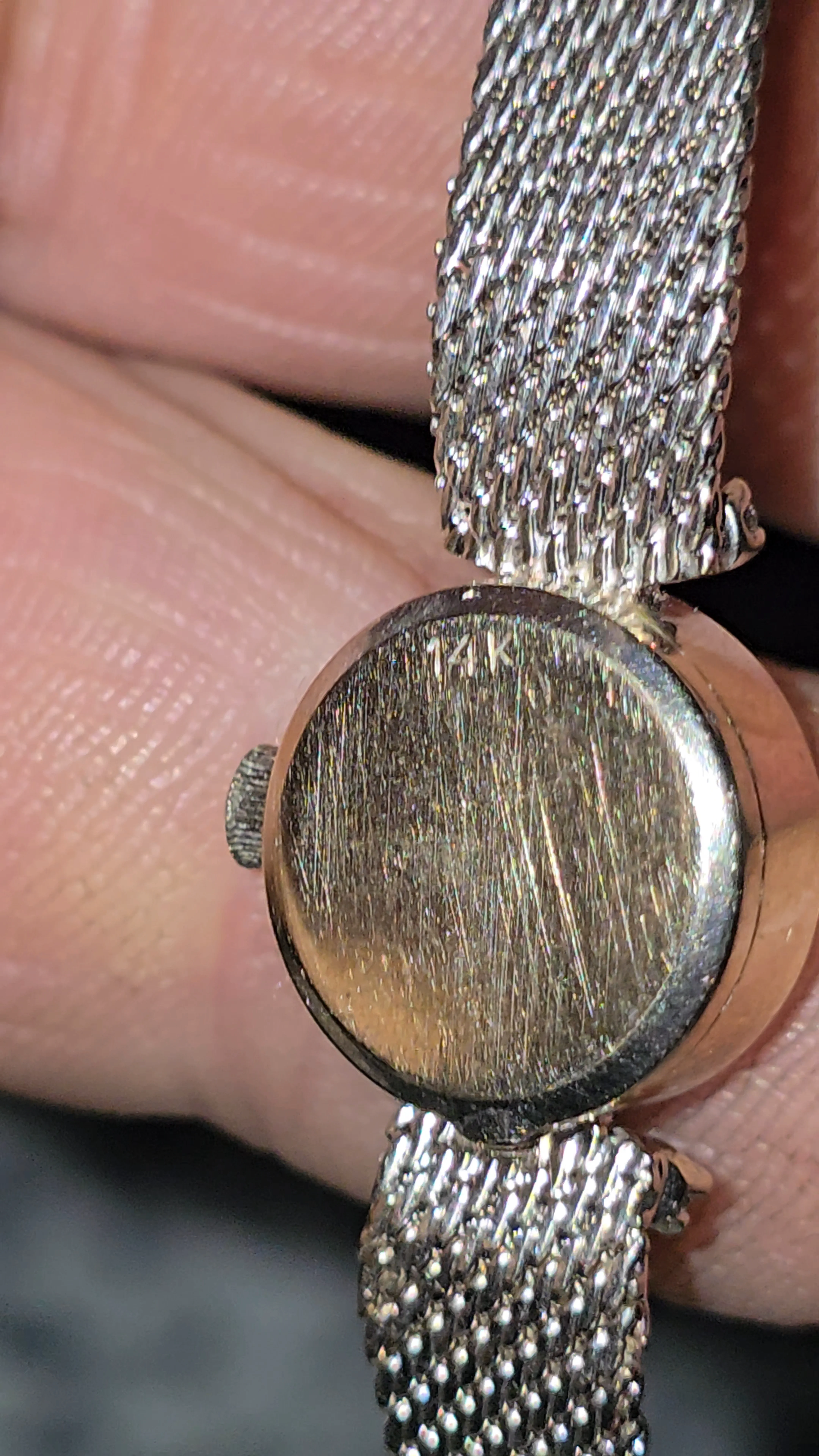

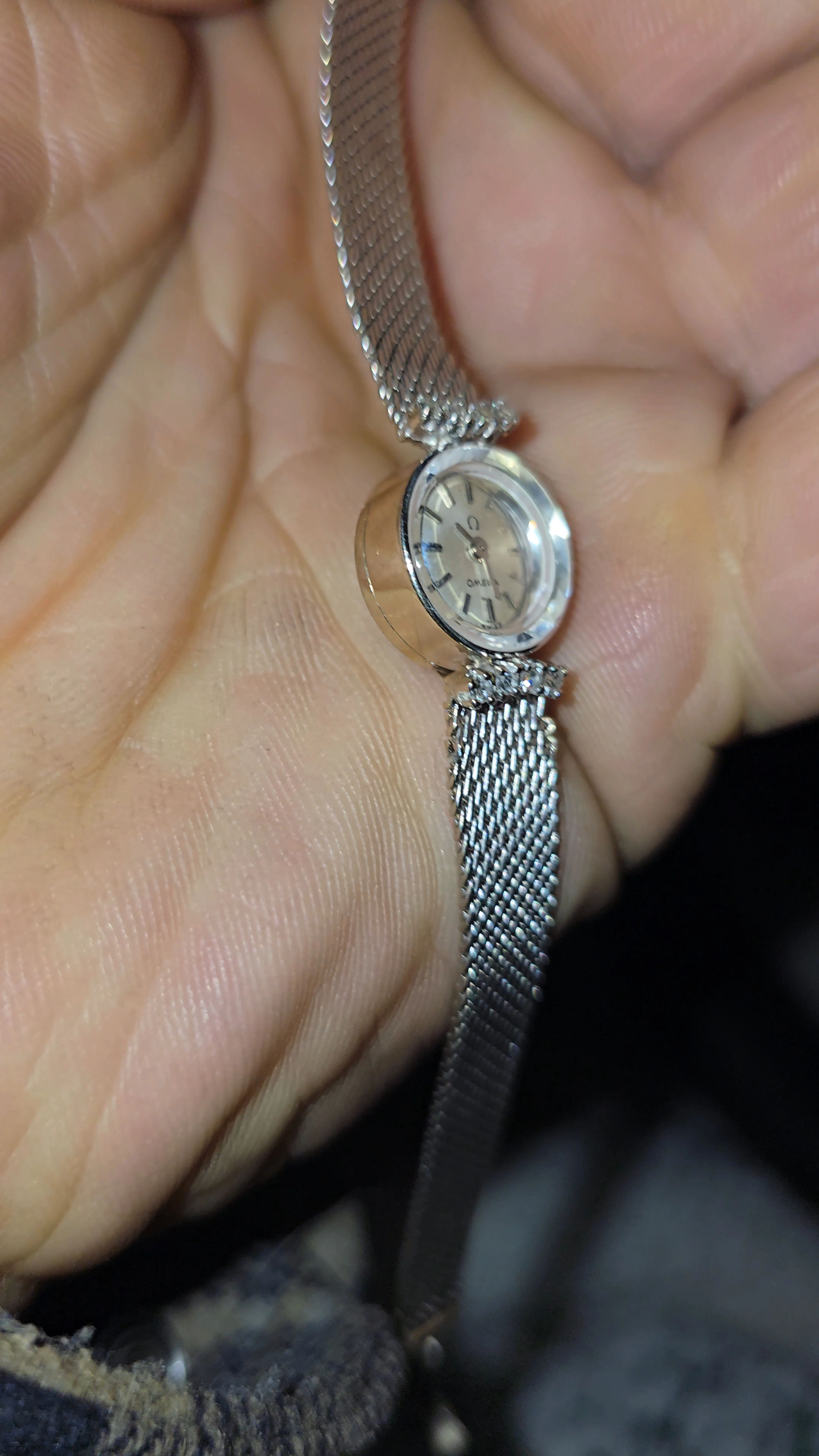

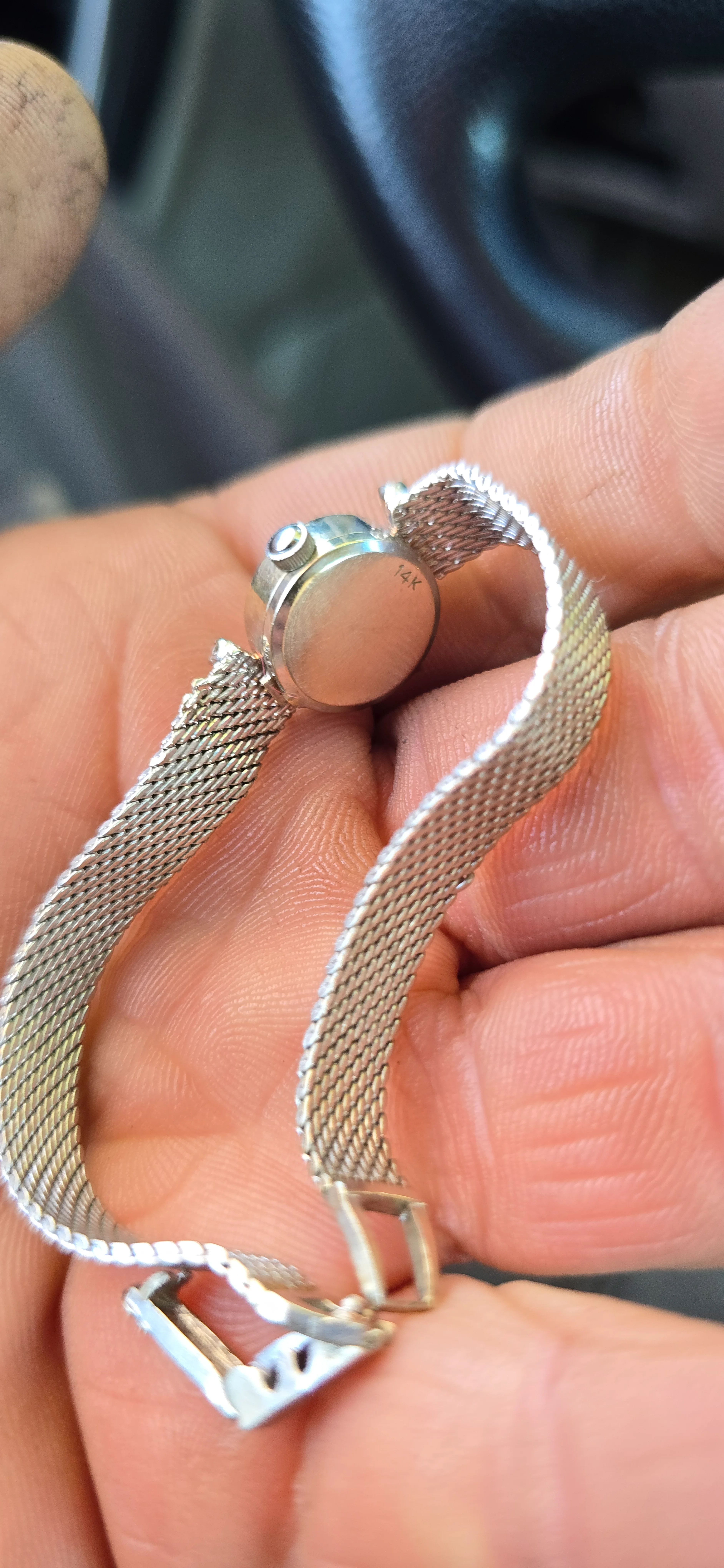

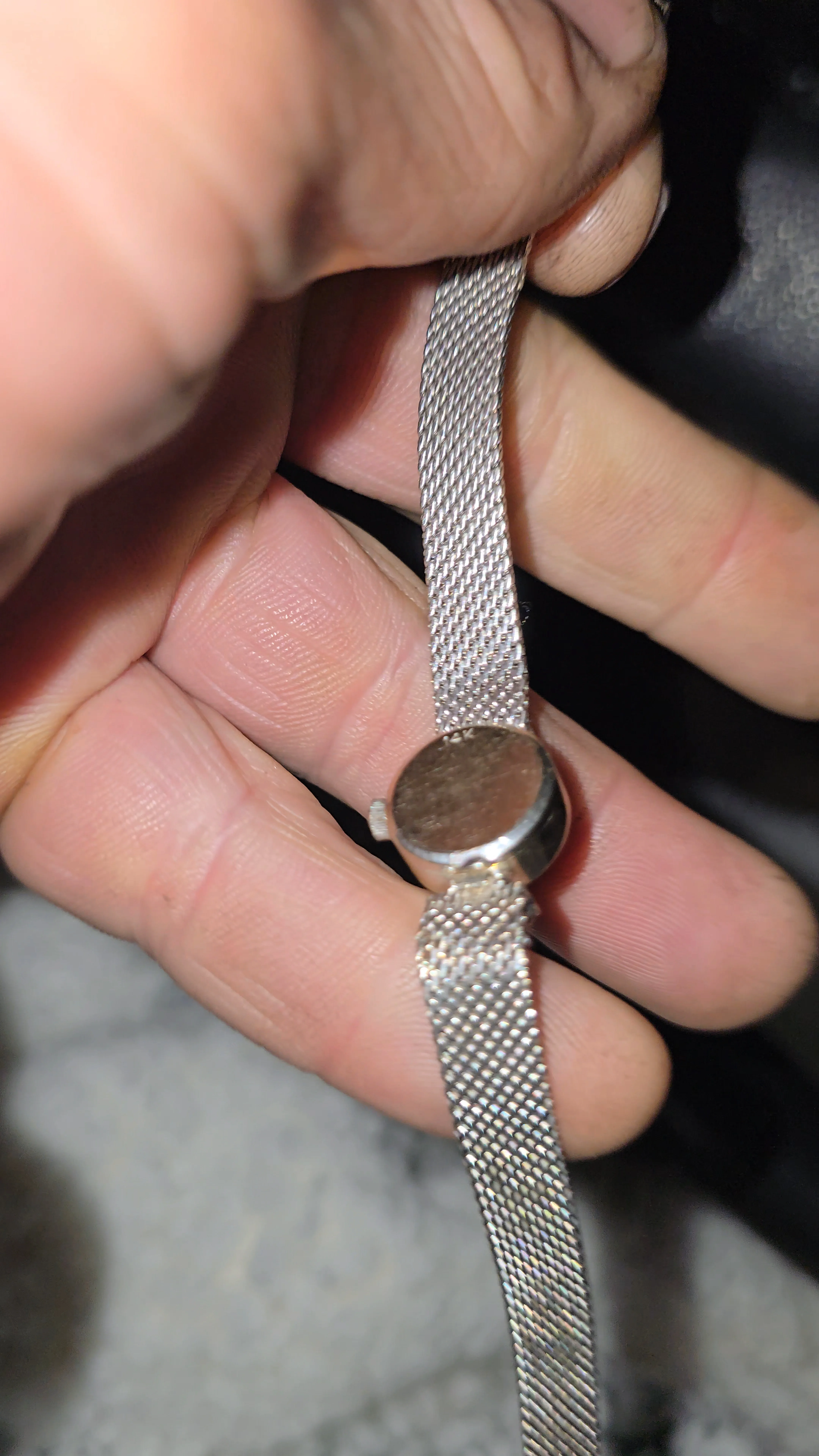

The non-signed crown plus what appears to be the allegedly 14k gold wearing thru to brass on the back of the case makes me have some doubt as to its authenticity, as does the 14k printing, that isn't consistent with the ones I've seen, though I have only minor experience with these sorts of watches.
As @Evitzee says, the tell of the tape would be to see the movement and inside of the caseback on it.
Even if real, value is going to be entirely melt value. You might get ~$75 for the movement from someone desperate for parts, but the case value is all there is. There is ~4g of gold in a case of that size, though if the bracelet is gold too, thats where the value would be. The diamonds are small enough to likely have little value.

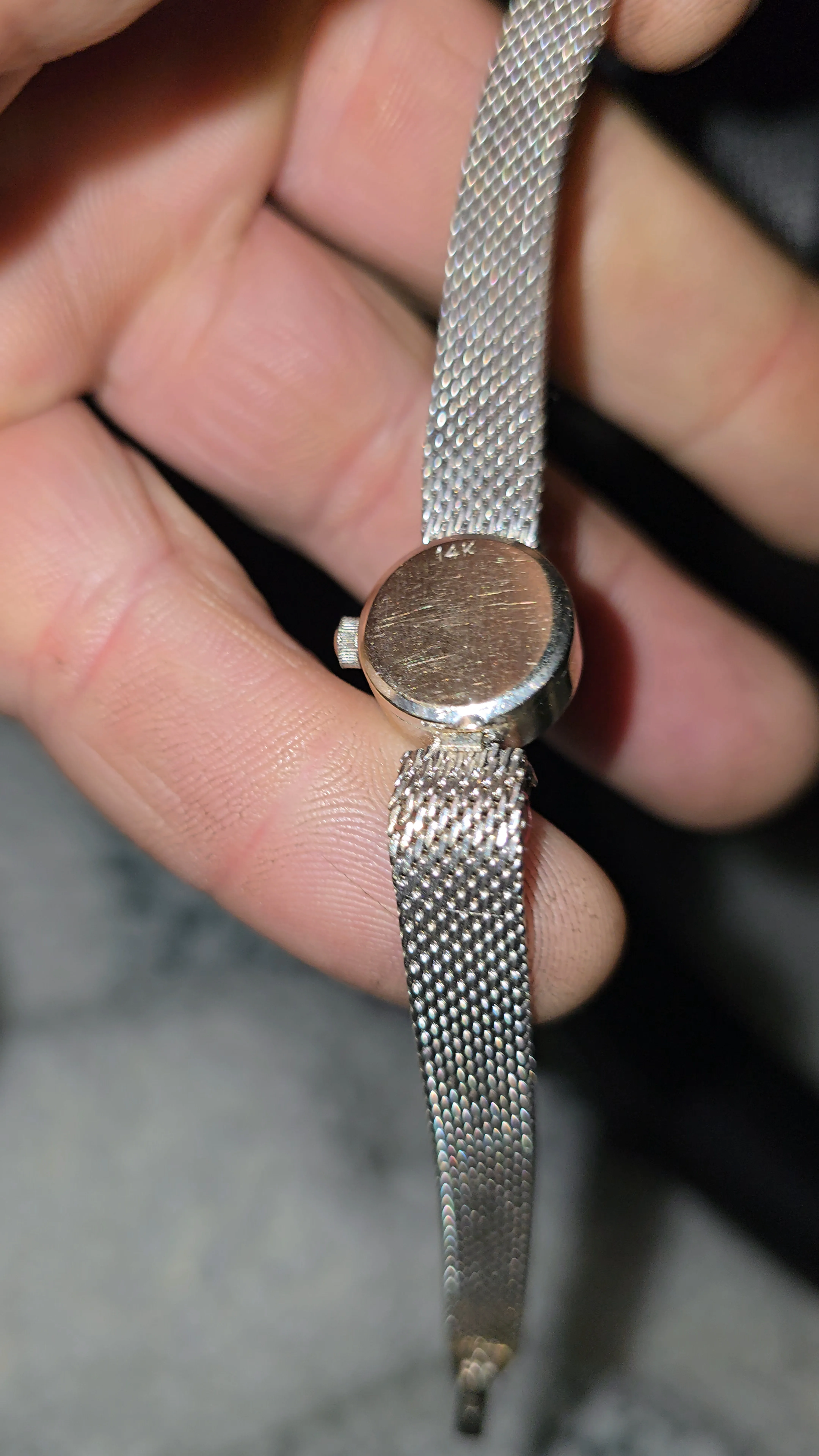

4

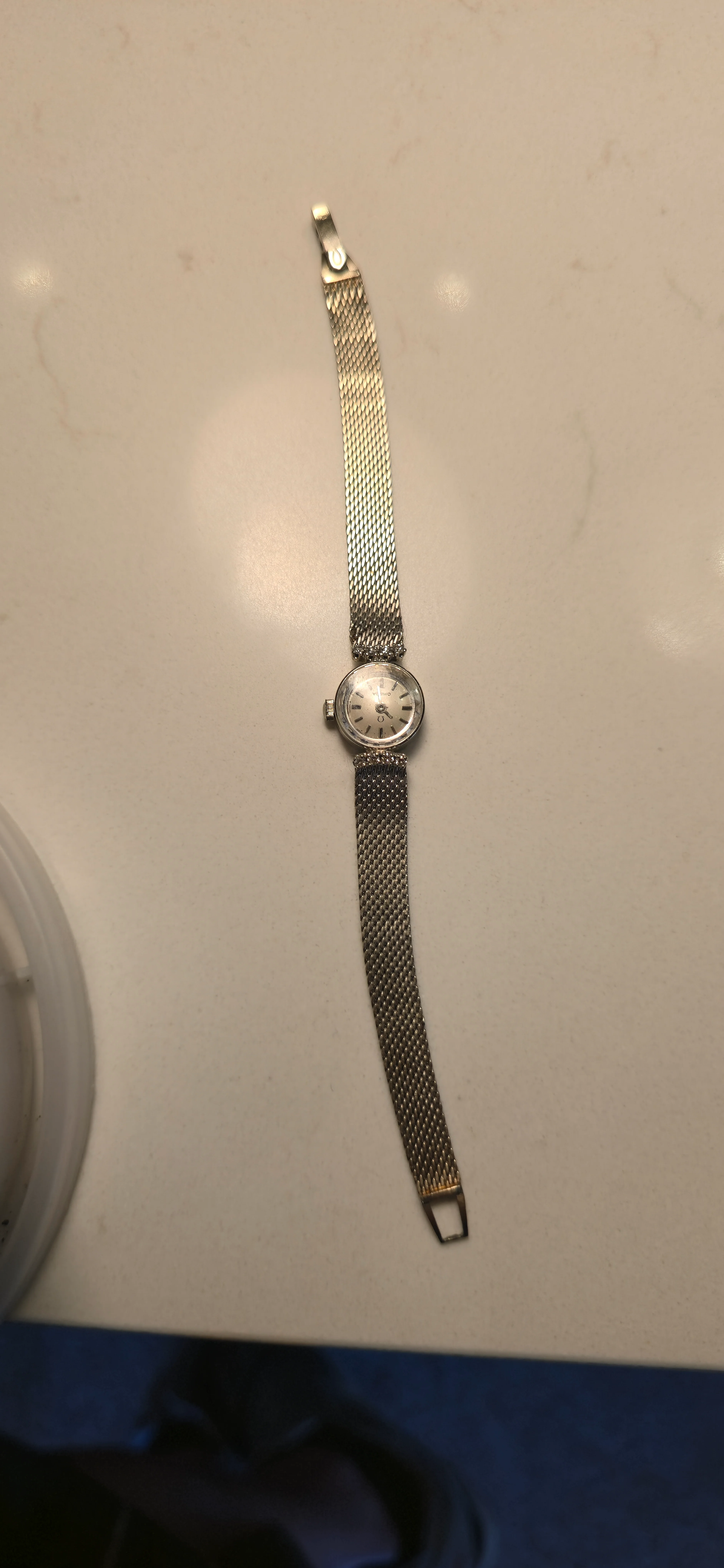

Ok melt it is. A shame though. It's real pretty.

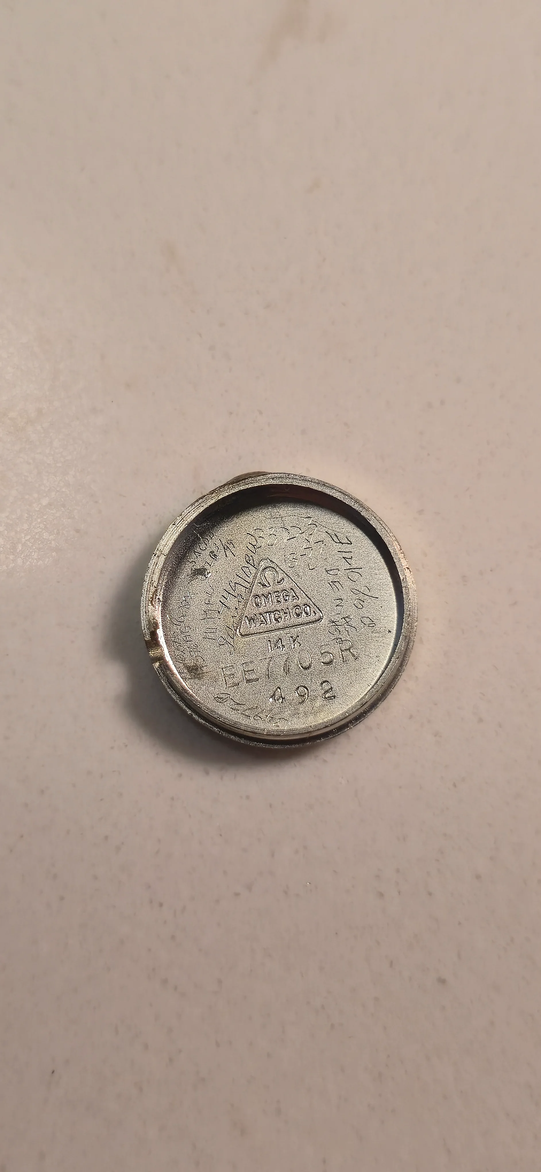

4

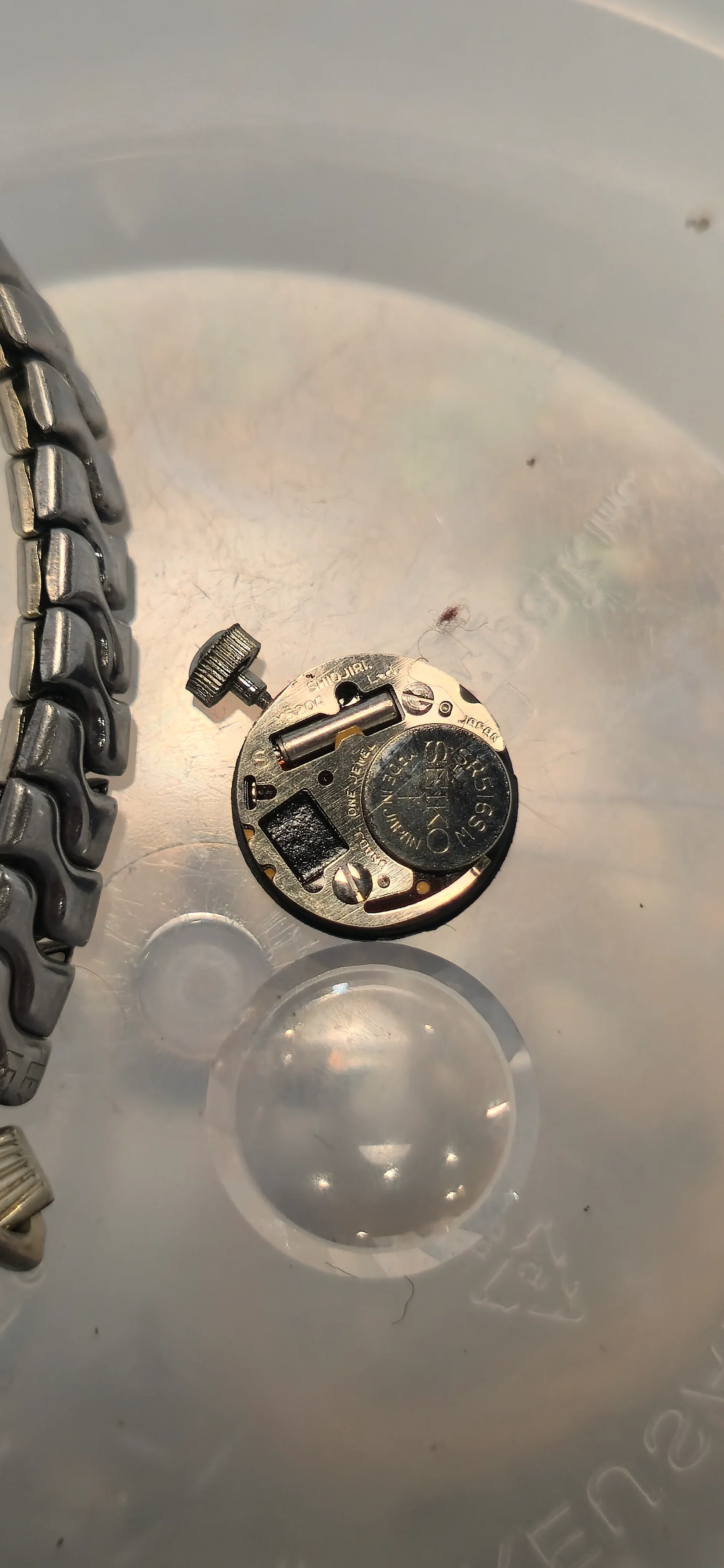

16.9 total weight
15.1 gold @ 14k
A real shame though.
2,671
2,856
16.9 total weight
15.1 gold @ 14k
Looks like at best you could get ~$1200 for it, and most places only offer 80%, so 80% of that. The crystal is ~3/4g or so, and you probably have the rest of a gram in stones that don't really have value (EDIT: not quite! That listing I posted above says it is 0.16 carats, which would be 0.032g). That said, they give weight as 14.4g, but that could be a bracelet size difference, or they are properly removing the crystal.
You'll probably have no luck selling that 'as a watch' thanks to the movement (though even WITH the right movement, it didn't really have much value).

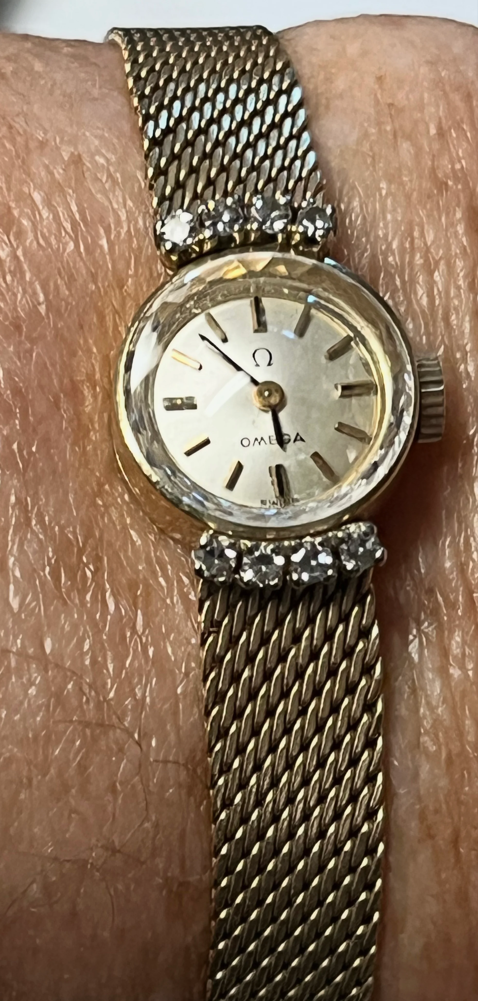

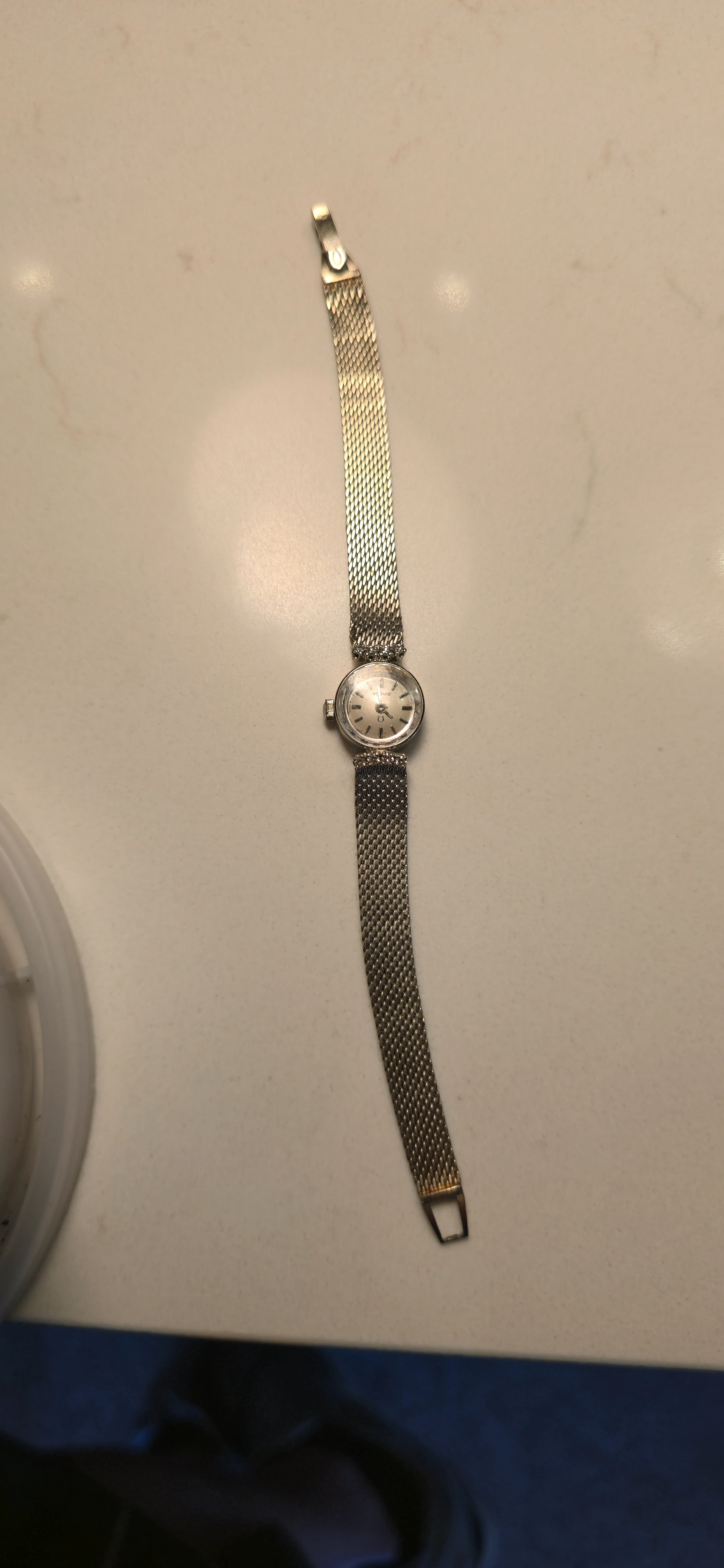

3,014
4,782

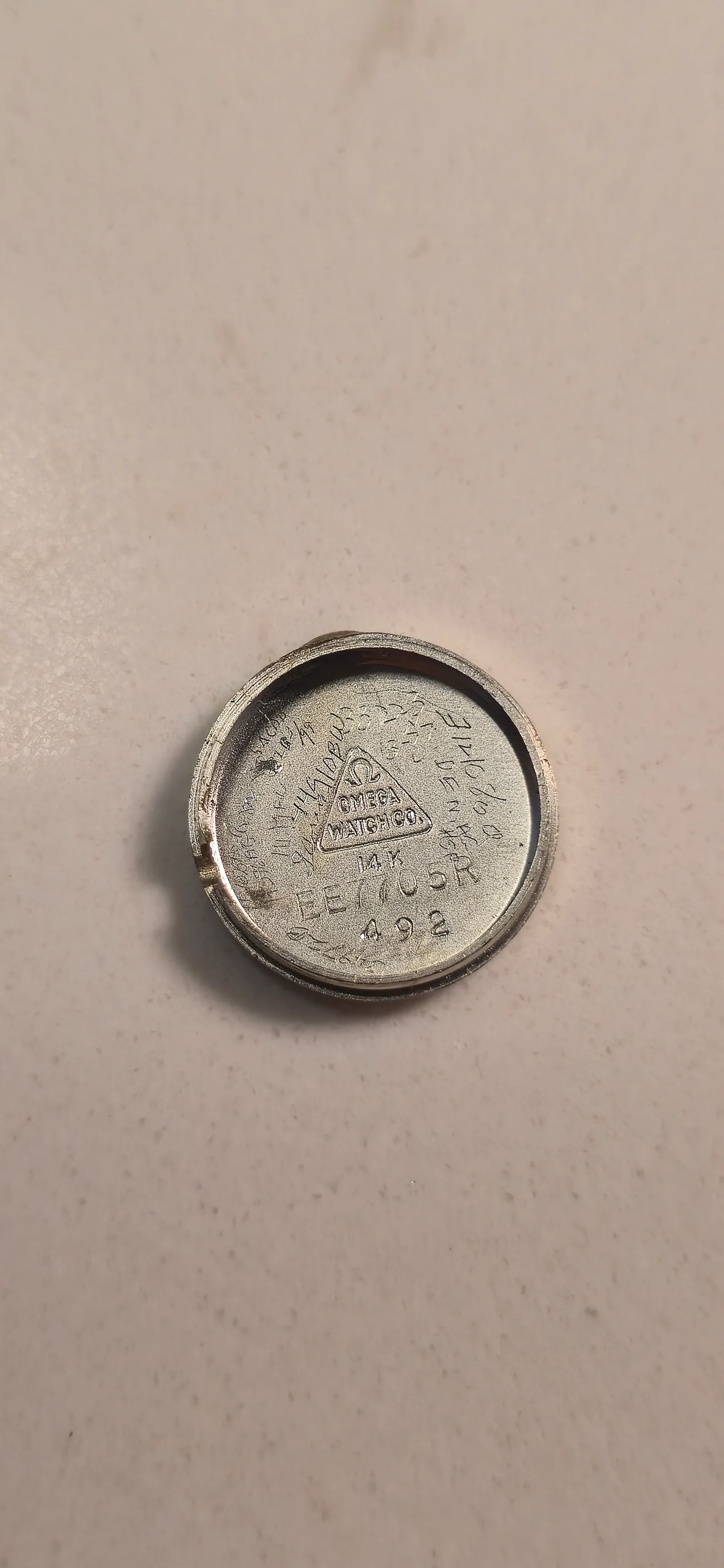

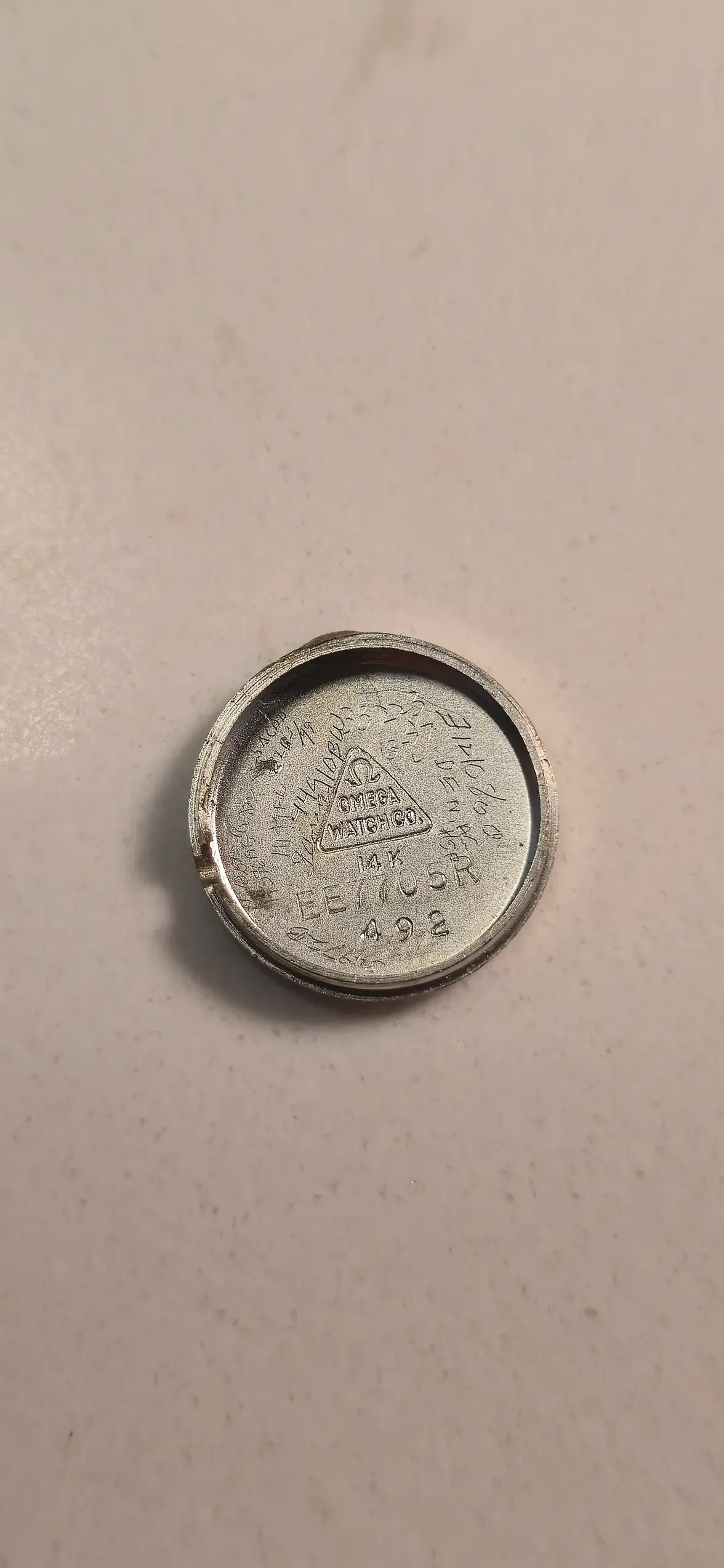

I have one almost like this Same case number which I think is a Ross American case.
The movement should be a 650. I have an early thread on it here somewhere. These movements are about as cheap as an Omega movement one will find (well 620 and 480 movements are more abundant.) 640/650 movements are really tricky to work on. I wound up (incorrectly) using rodico to hold the wheels so I could get the plates together. Then broke a bunch of incabloc springs.
I did get a large collection of Women's watch parts to see if I can eventually get better timegrapher results. These though are a real PITA to work with and I have plenty of 55x, 33x and 134x movements to play with first.
I have no intention of ever melting mine though. I used to wear it to the SF opera when I had a box seat. It also visited the Omega factory when I did as one of the 10 omega watches (5 on each wrist.) I still remember on one of the bus rides where one of the other makers looking at the stones remarked 'Holy sh*t those stones are real.' (while small they are of good quality.)

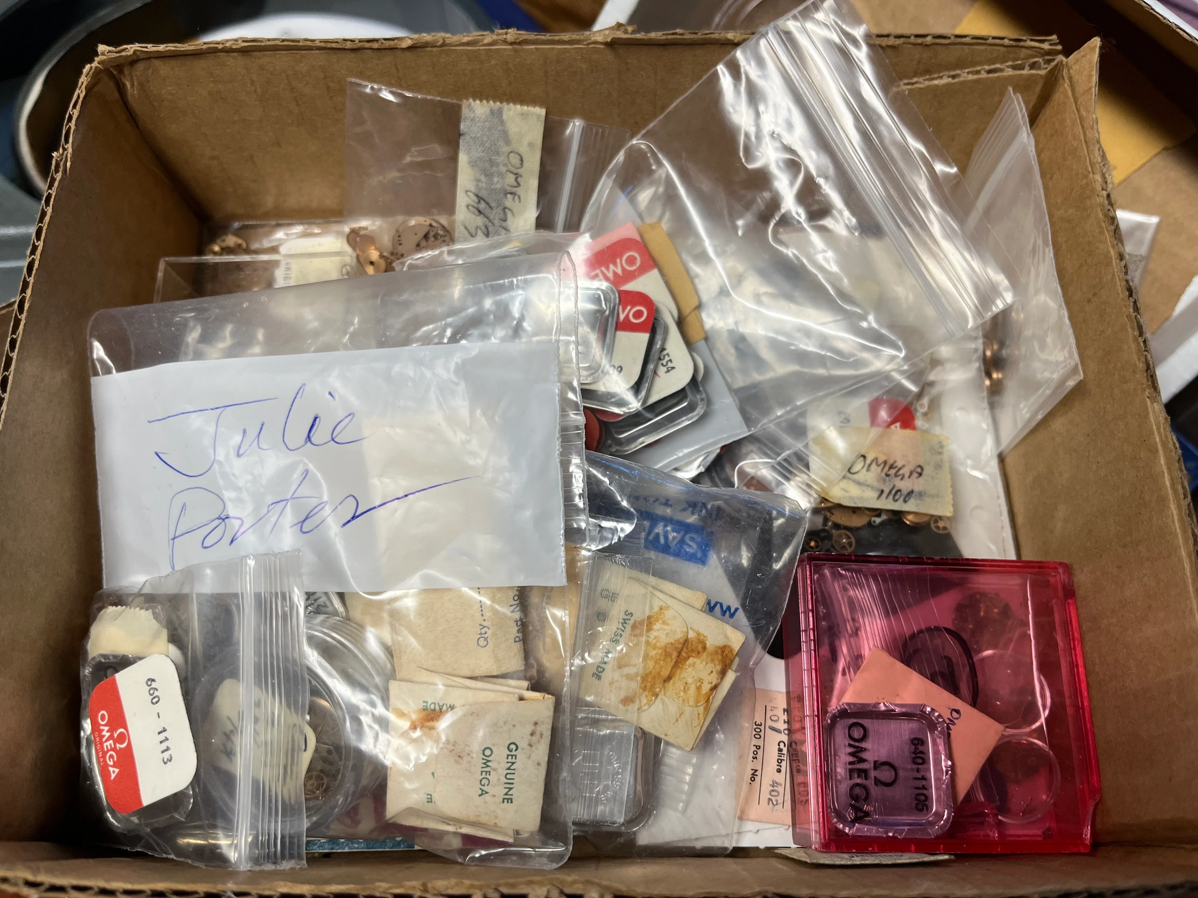

It is hard to keep track of all these ladies calibers. They were a lot of the bread and butter before the quartz crisis. What paied for the R&D. The 470/480 is not the smallest auto. The 455 is 16mm and automatic. I have some rectangular 730 movements what fell into my shoe, and I walked around for the better part of a day till I felt the lump Surprisingly the balances still twitch.
The main problem with these wonderful watches is as noted they were melted down. Most were probably gifts only worn once, which is why they were such the cash cow back in the day.
The makerspace recently got a new 3D printer that is a lot easier to use. I had some decent results using the laser to cut acrylic, but the acrylic is brittle. Did a bit with silicone RTV for mold making. Might be possible to use the laser to make a mold and cast some RTV. Gaskets are an issue why I never totally finish my projects. One of which is a shot injection molding press.

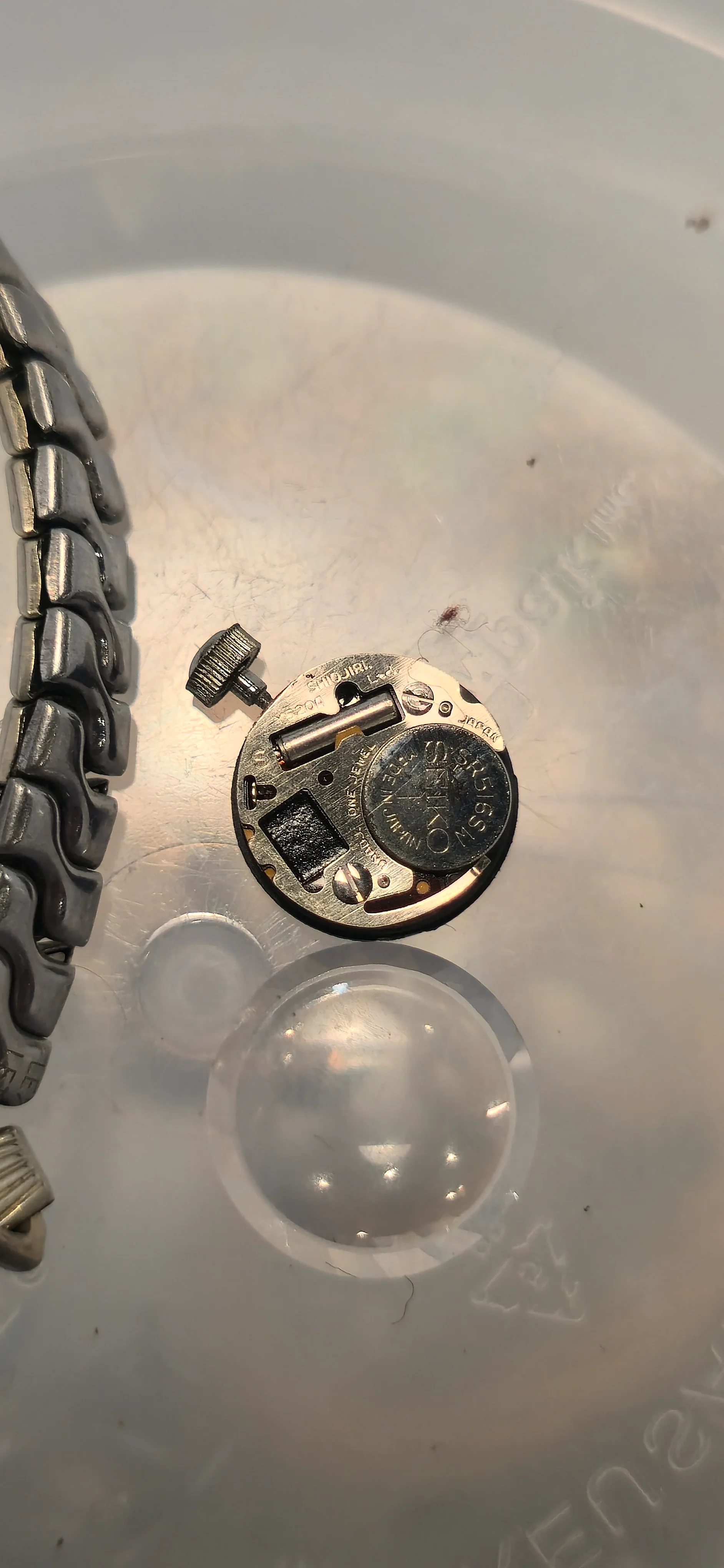

These are actually more than JUST gaskets, they are full-size things with shapes/etc.
Here's a pic of the gaskets I have. They are in reasonable shape, and I might just re-use them, but they have some gouges from a previous watchmaker trying to dig them out (I got this watch as 'used' with no idea what was IN it thanks to said seller not being able to get into it!).
I DID pick up a piece of what I think is the best match, some 95A Polyurethane round rod, but could only find it in... a large size and didn't conceptualize how big it is 😁 It should only take a little time to make each piece on the lathe, but I have to get out ot my shop, and its cold these days 😁 (Ed White for scale, note that the bracelet while open only BARELY fits! 2.5" diameter!).
