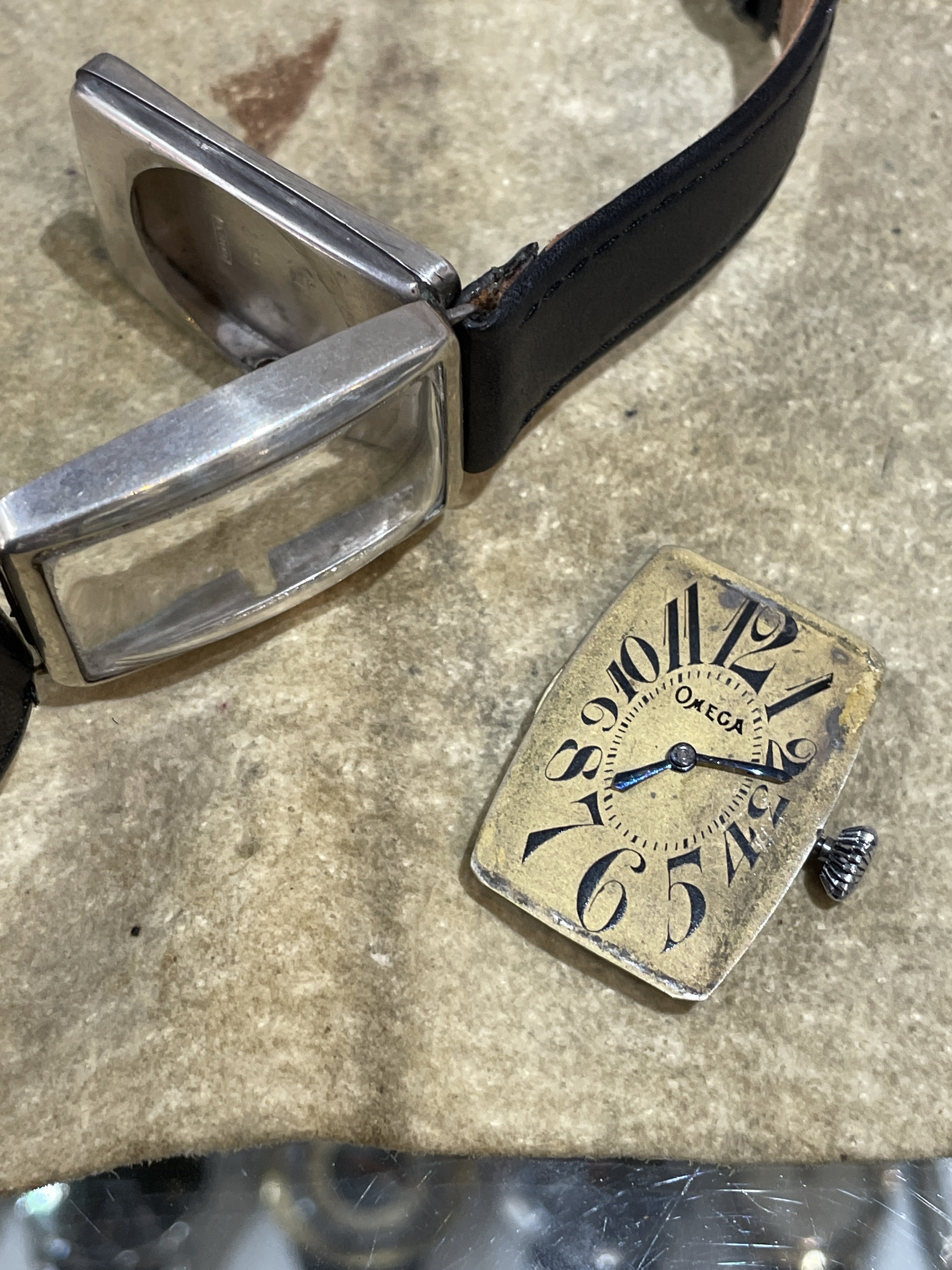

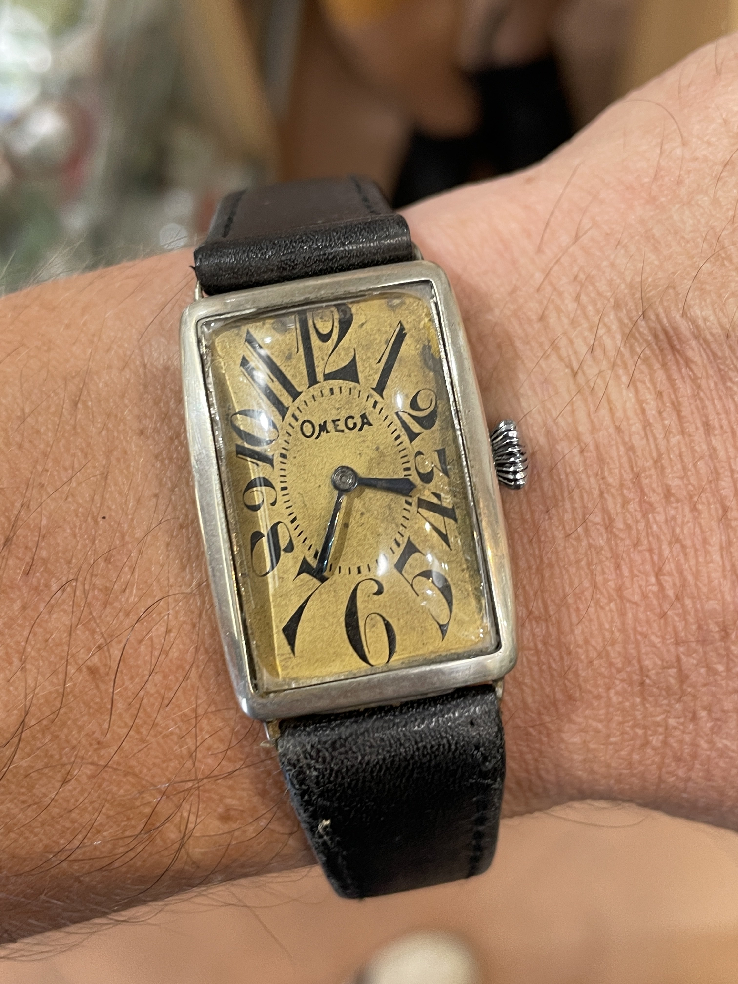

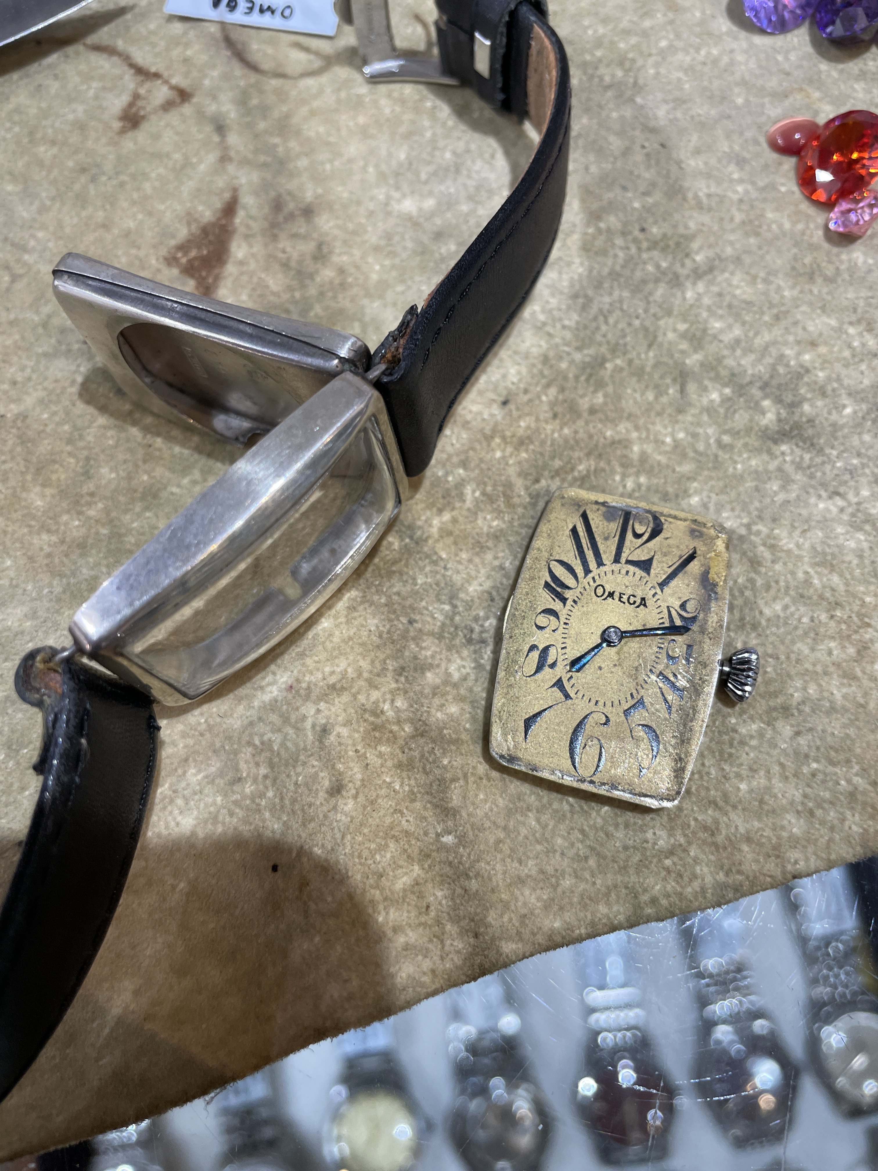

Hi there - bit of a long-winded subject line... 😀
Wondered if there is anyone out there knowledgeable in this area...?!

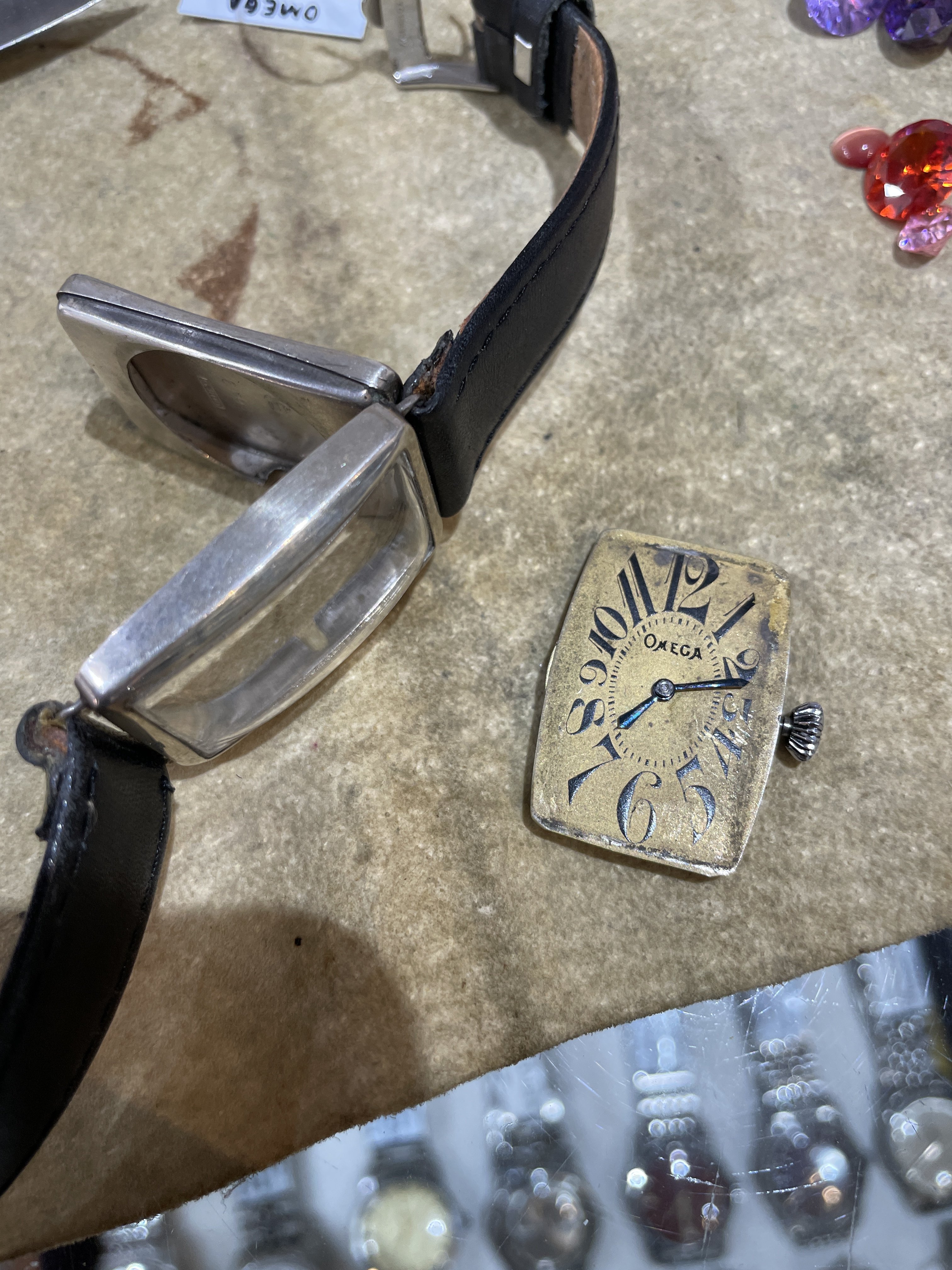

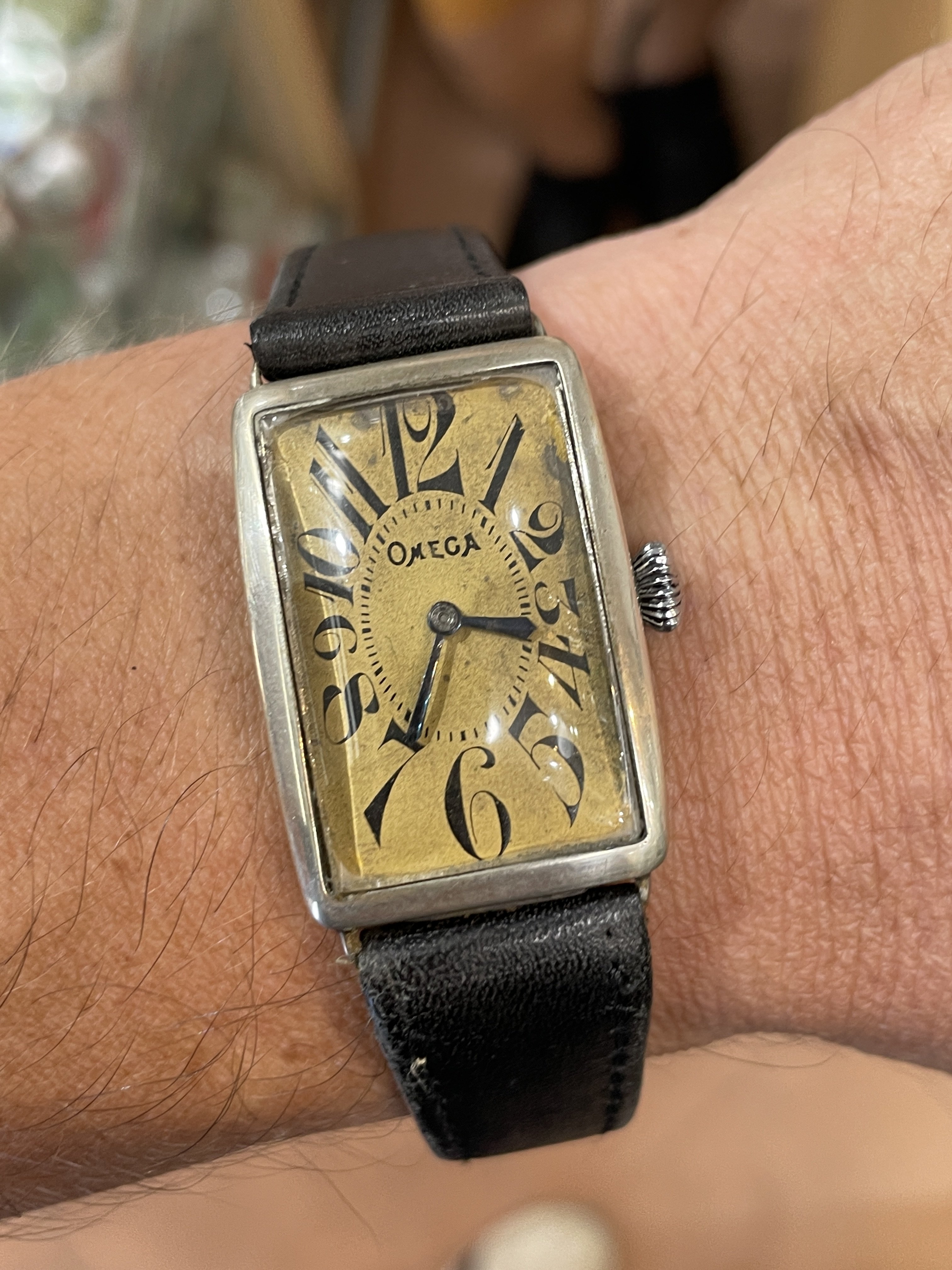

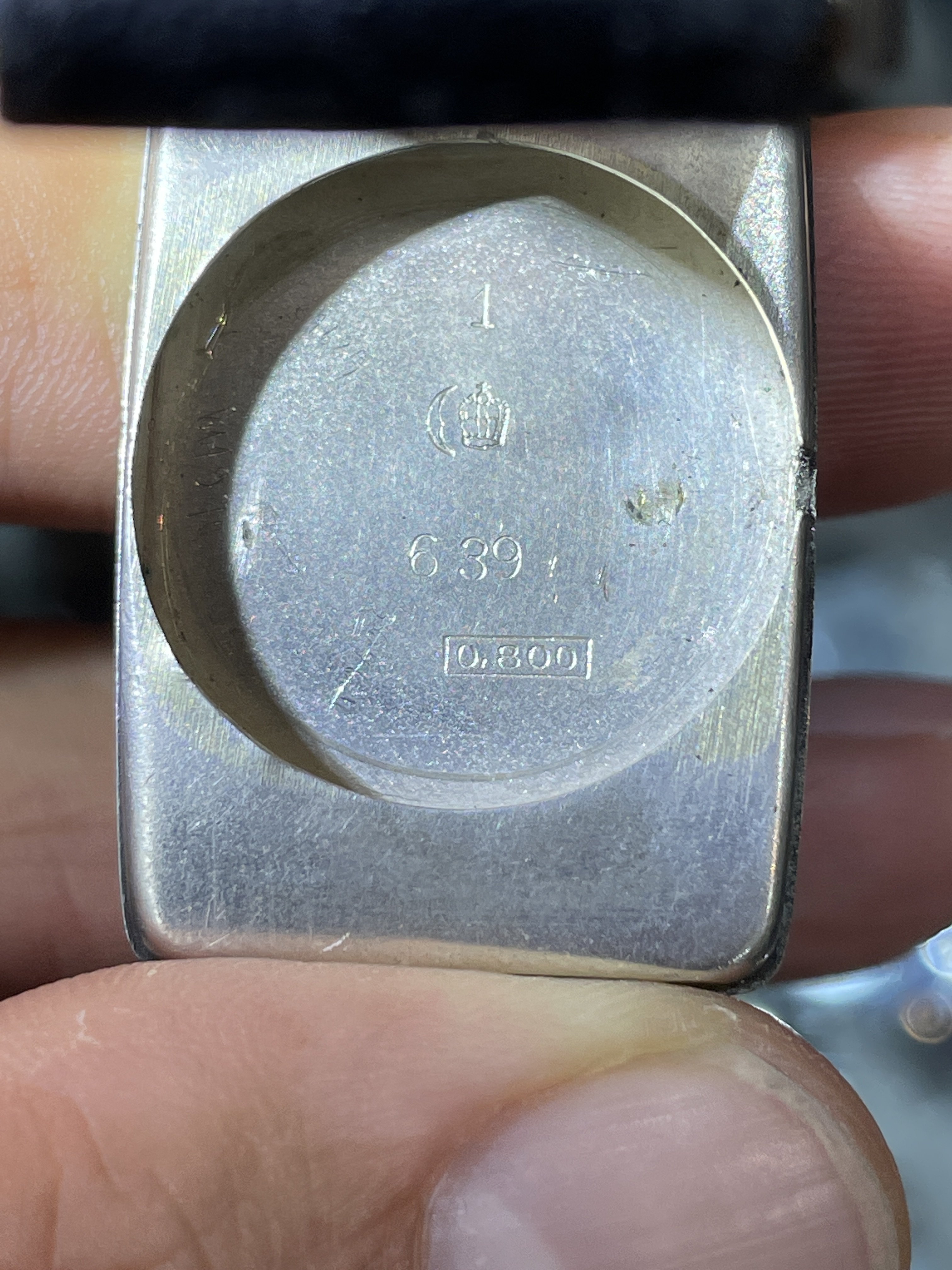

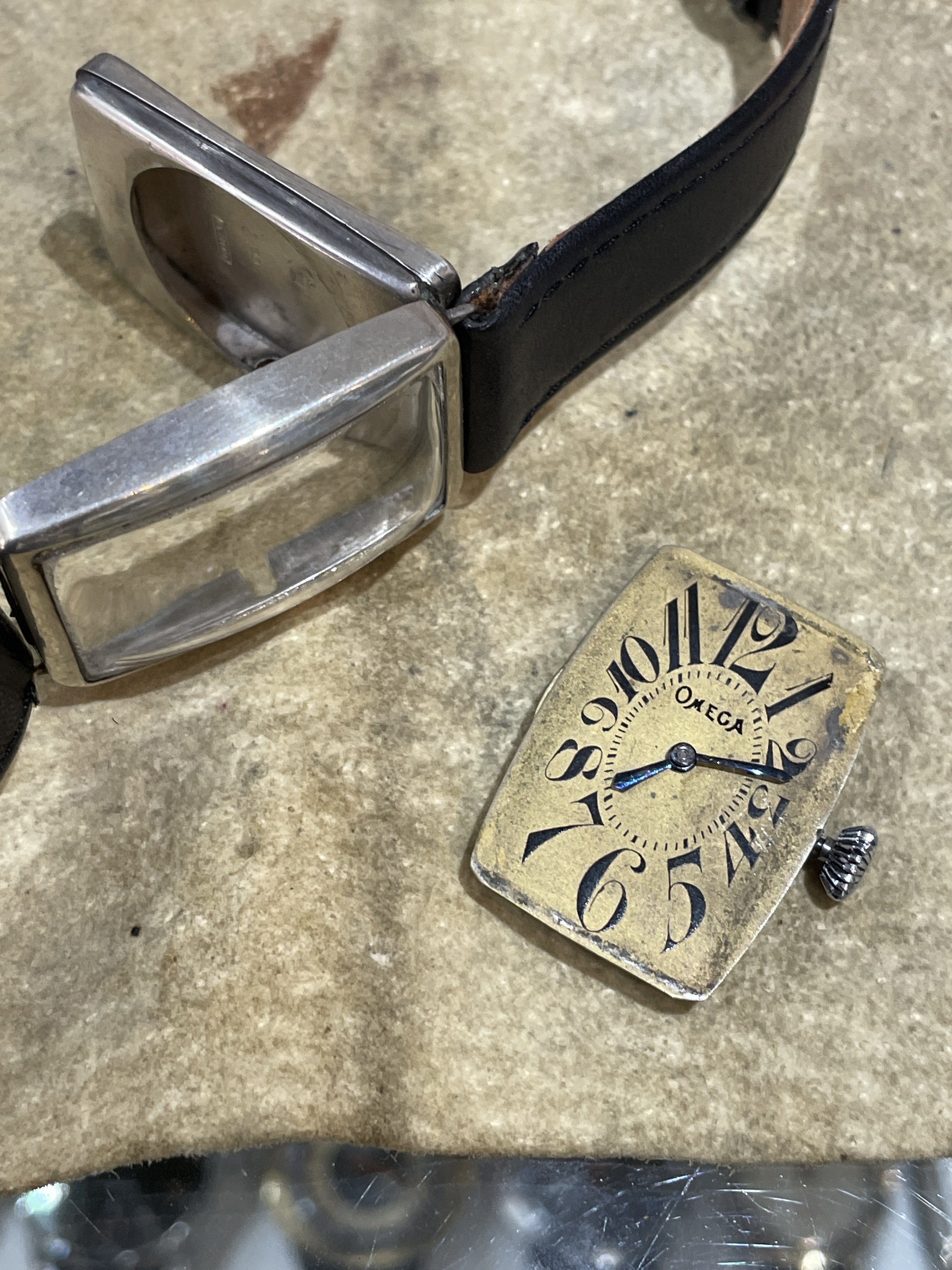

So I've seen this lovely art deco-style rectangle watch in a local watchmakers.
And there is curiously what looks like an applied Omega name on the dial.
Now I can't find any other reference to this font used for Omega other than a very old advert for a watch release.
However, there is info on the Omega logo itself being used first back in the 1930s.
Although I have seen other vintage / antique Omega watches that have used other fonts for the Omega name.
When the dial is examined it looks under a loupe that the Omega name is applied in the same ink/paint/application (or same material used) as the numerals and doesn't look (very) later applied.
But it does not look like it should be Omega.
Also to the watchmaker, the movement is the same type as a vintage pocket watch of that period so unmarked with no brand but distinctly Omega to him.

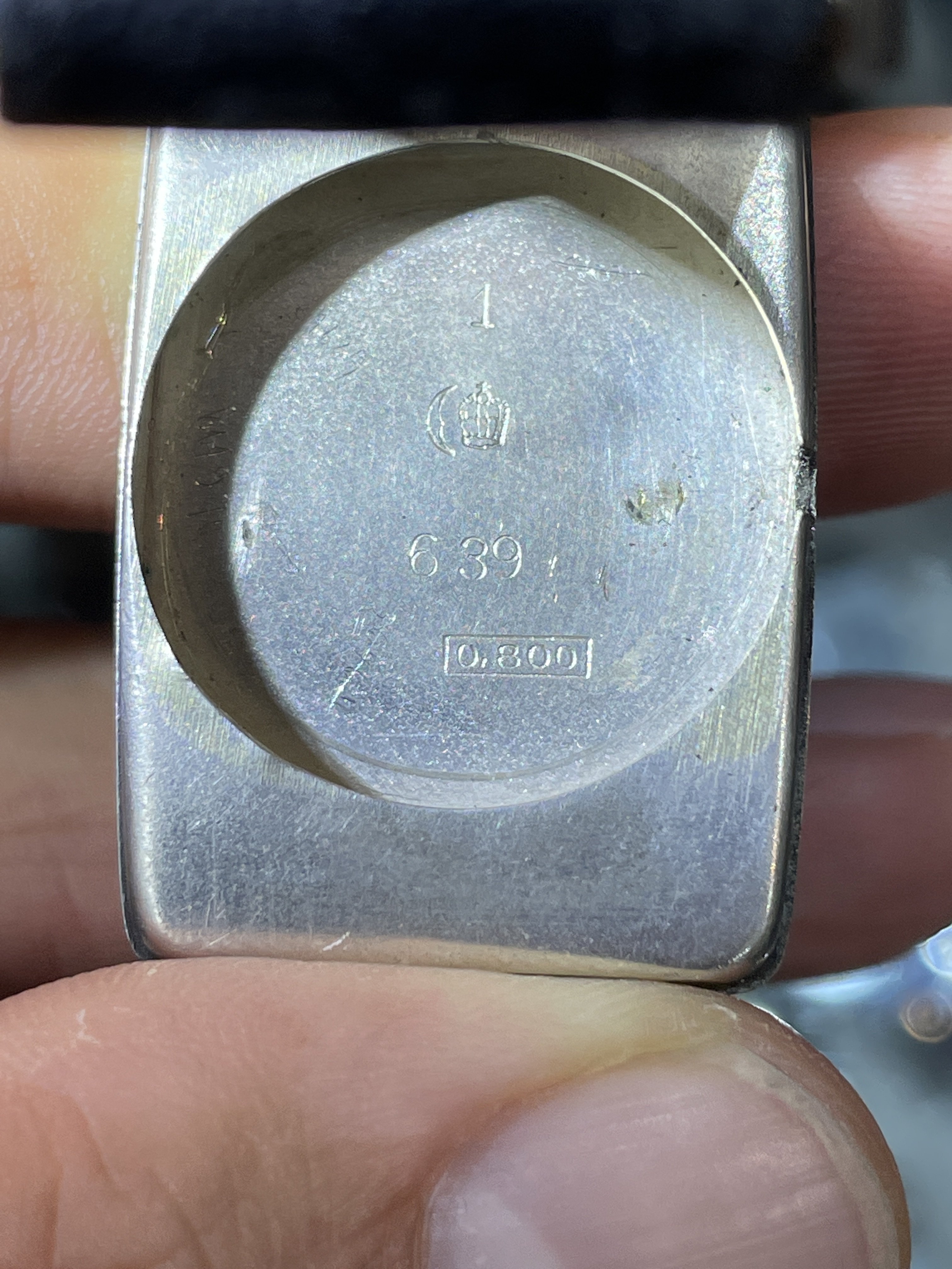

Finally, the case is a silver mix with a hallmark, as you will see in the pics.
Now, this is a generation apart from what I am used to researching however I have recently got into art deco style dials so this is interesting to me.
Be great to hear anyone's thoughts on this on the dial, case, movement etc...
Many thanks!

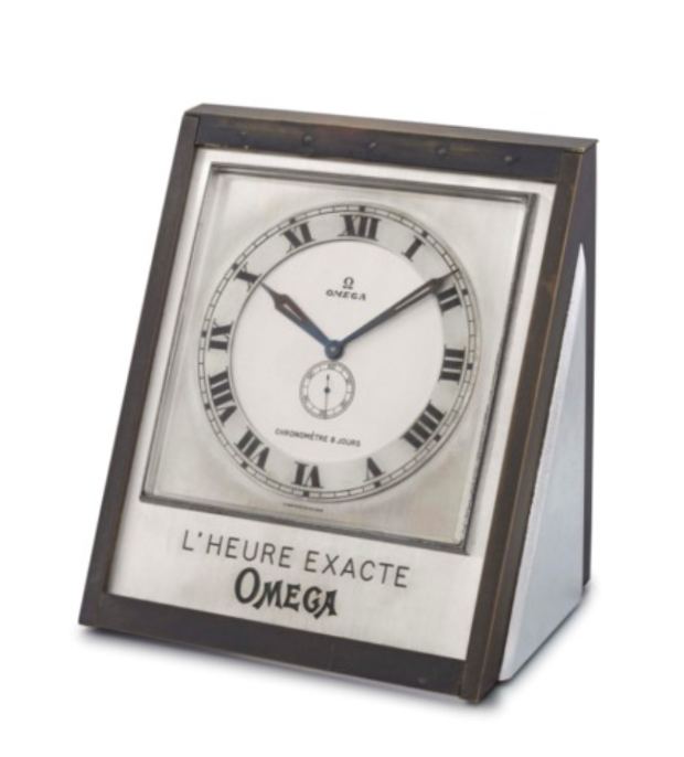

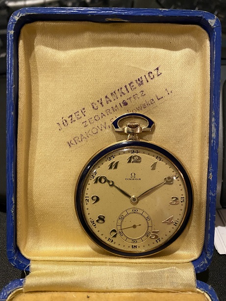

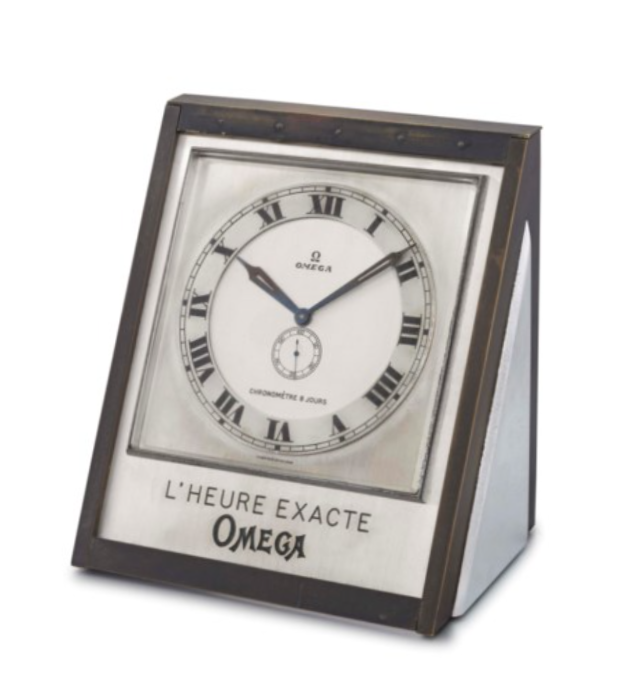

You're correct in identifying this version of the Omega logo as being both correct and from the 1930's. More often seen on clocks and in advertising than watches IMHO. Here a heavy shop window chronometre with the logo in recessed enamel.
As for your watch I have extreme doubts that this is an original dial. It looks hand drawn to me. The case also shows no Omega hallmarks so isn't factory. You mention that the movement is also not signed Omega, then I would suggest this watch has nothing at all to do with Omega except it has a similar design to some of their 1930's offerings.

I am also a huge fan of the ceco period; the architecture especially! After doing a bit of googling, I could not come up with any other references similar to the one you posted. I'd have to agree with @cristos71. Keep us updated if you make any discoveries.

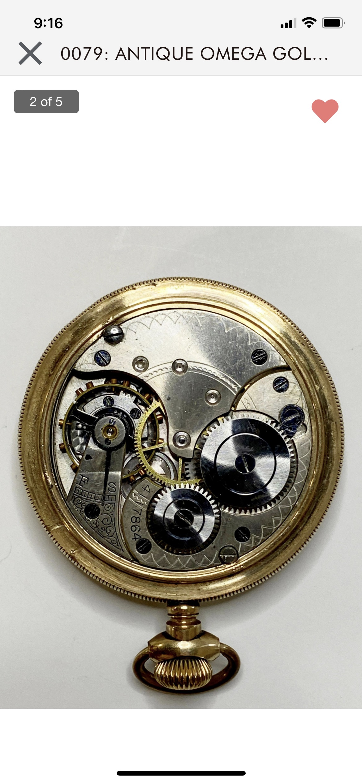

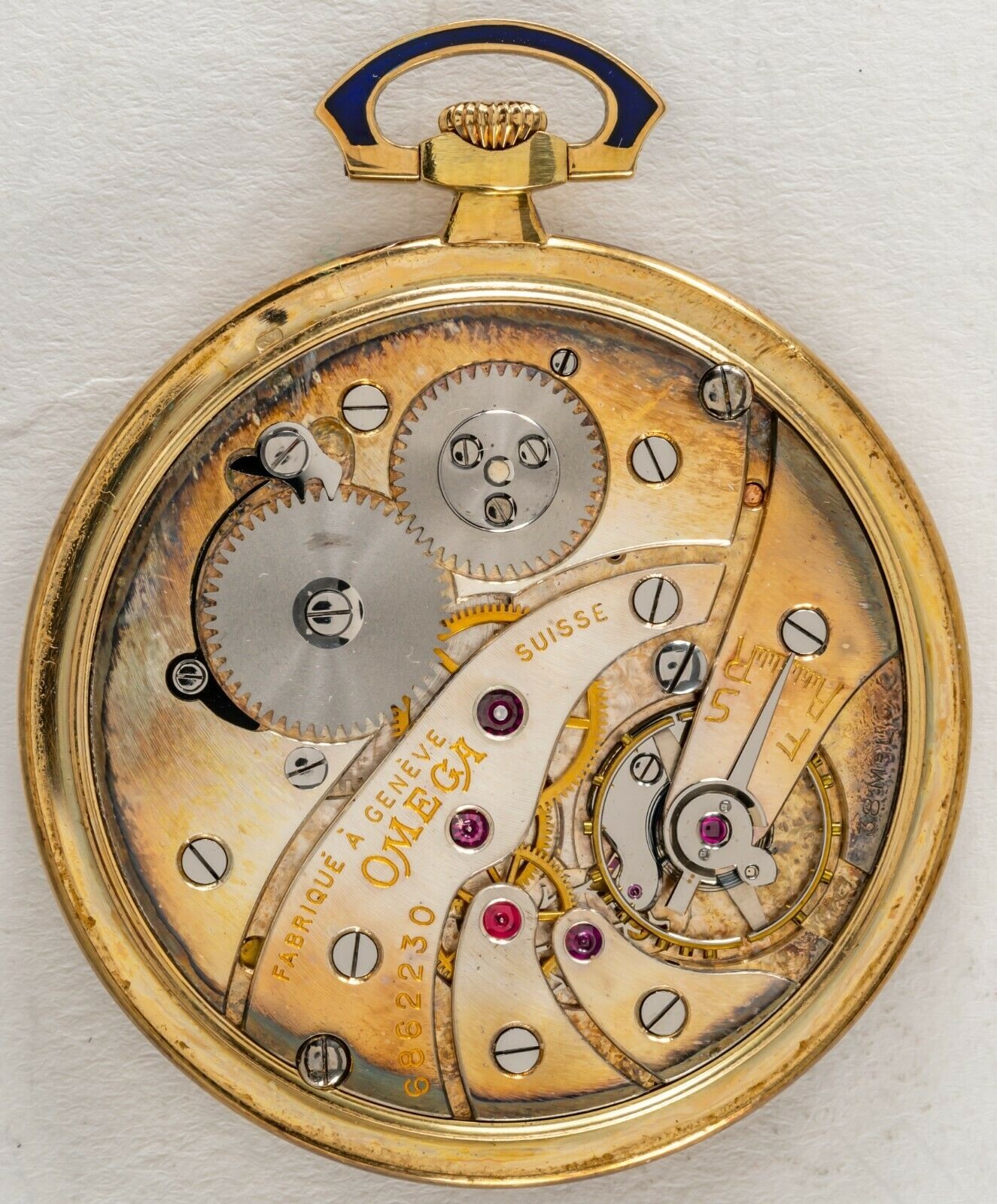

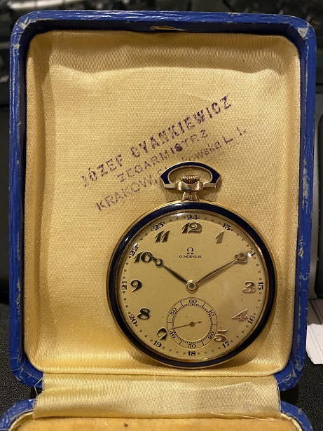

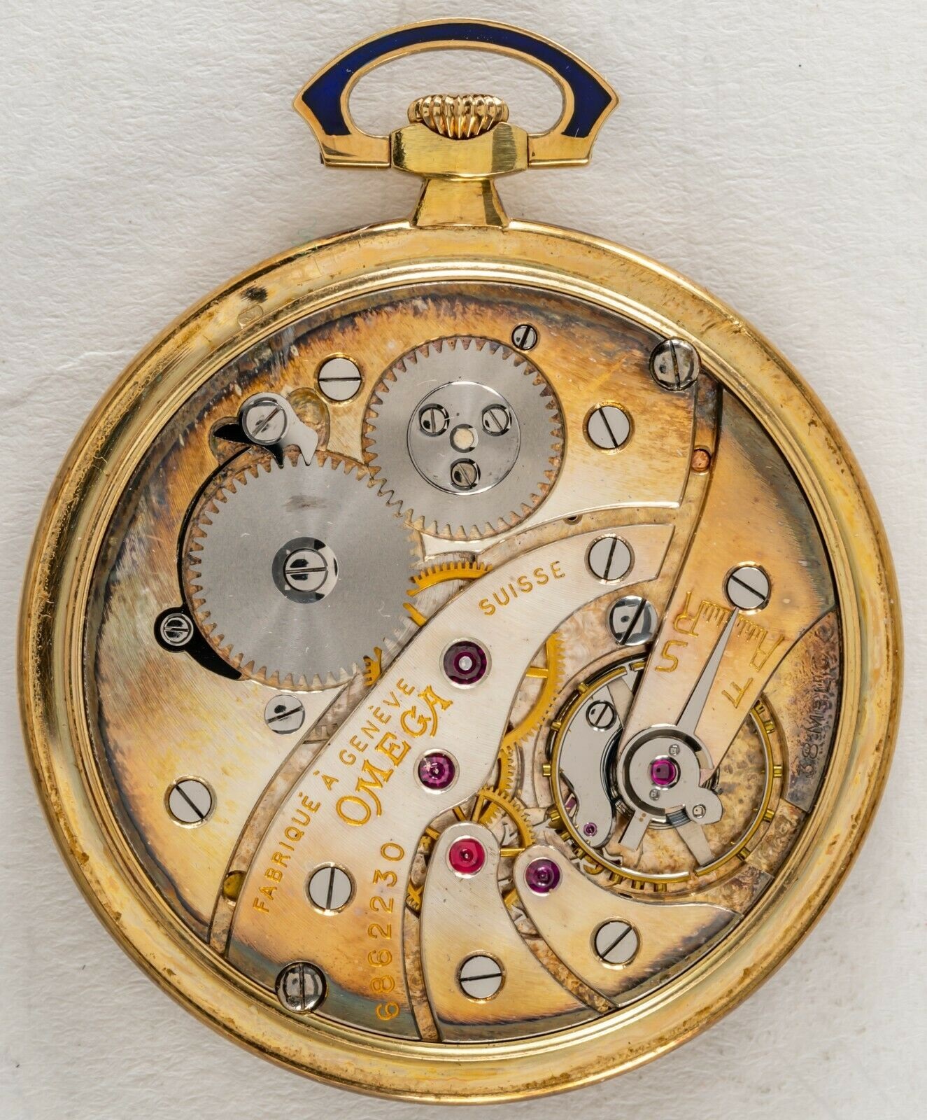

Movement scan would have helped. Here is a movement scan of my art deco period Omega PW
fabricated in Geneva, same logo on the movement.

Apologies for second post, memory fails these days... That style of dial is generally referred to as an Exploding dial. All the Omega wrists from that period with similar dials that I've seen have logos similar to the face of my PW.

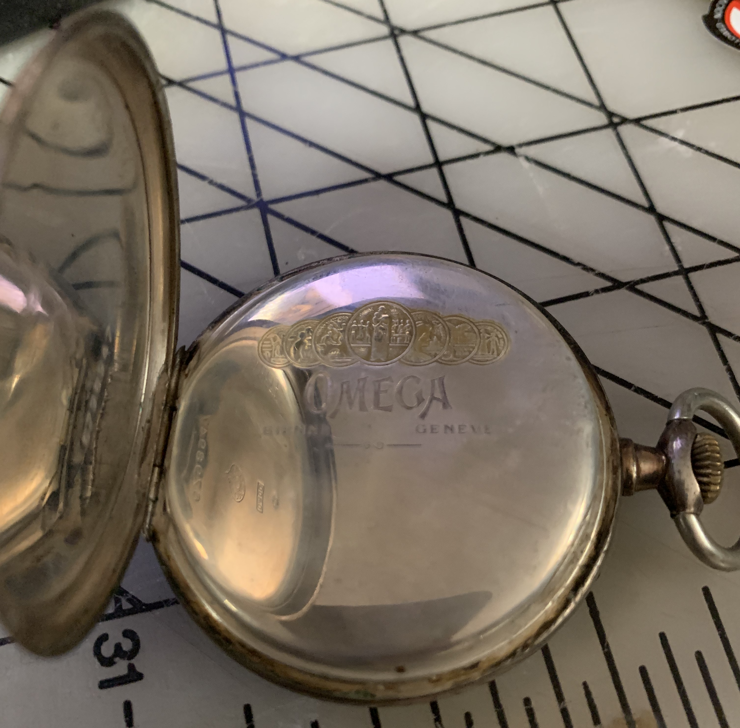

I'm definitely inexperienced with this era of Omega but the logo on the dial on OP's watch does look repainted as well. The exploding numerals look fine but the logo is highly suspect. I always assumed Omega had used the italicized OMEGA logo, not the stylized one used for marketing materials. Perhaps it could've been a very, very early service dial?

I have only ever seen the 'swept' omega logo on the movement or dust covers. I do like it and think it would look good on the dial. The OP watch looks more like a 1970s retro knockoff.

I don’t know about Omegas but I’ve seen a lot of fake Longines from Ukraine from that era and style— specifically with 1920s exploding dials and mostly tonneau cases. A new way of recycling authentic movements without having to fake a modern watch I suspect.

yeah agree, thanks for your reply. I had only seen examples with that omega logo too.
on your q about the movement, it was yellow, just with no omega markings or name anywhere.
I do think this has nothing to do with Omega as well. Shame they added it really as i would've preferred it with the exploding dial on its own.

Thats an interesting point - I've seen quite a few from Hungary too but on these, as I'm liking some of the designs I'm keeping an open mind on the recycling... cheers!
Hi -thanks for the reply.
I agree that i don't think it has anything to do with Omega and has been painted/drawn on. Shame imo as the dial itself is nice without it and doesn't need the association!

The Omega logo addition spoils it really. I feel the dial with the numerals is original and dare I suggest correct to the period, but what they were thinking adding the Omega on it. Its actually not a bad effort at copying it either - spacing and layout etc - but just wrong overall and looks like a knockoff for sure as a result.

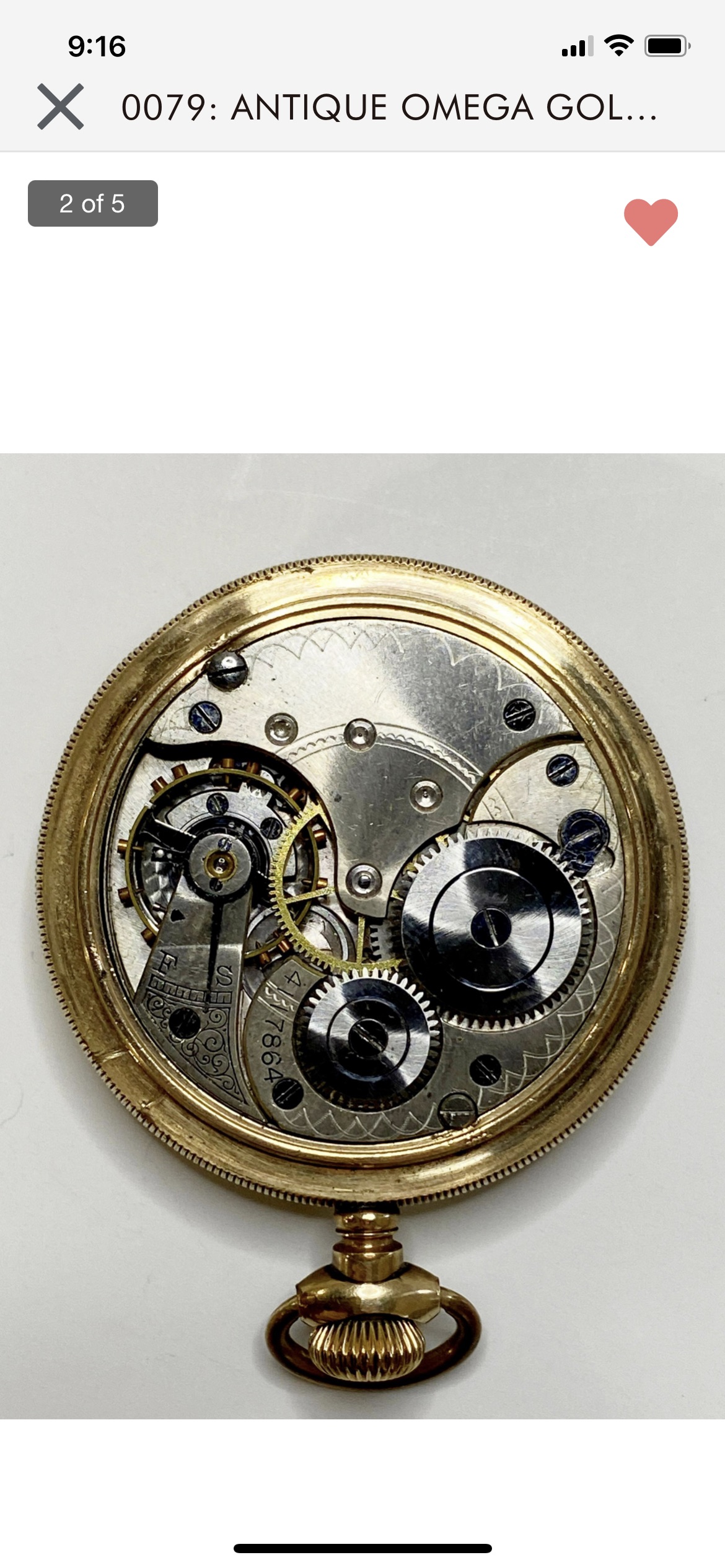

Any idea what kind of movement is in the watch?

The watch in the OP's picture appears to have fixed wire lugs. Wouldn't that indicate a 1910's or early 1920's watch?
Also the crown and crescent hallmarks indicate a German case.

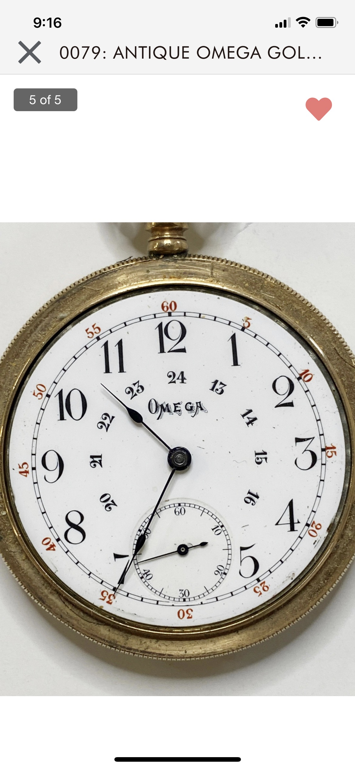

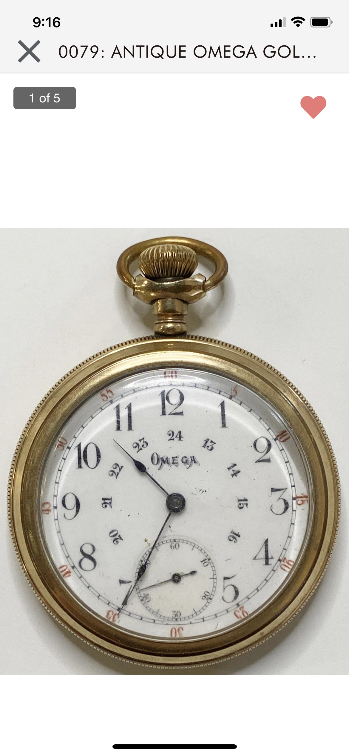

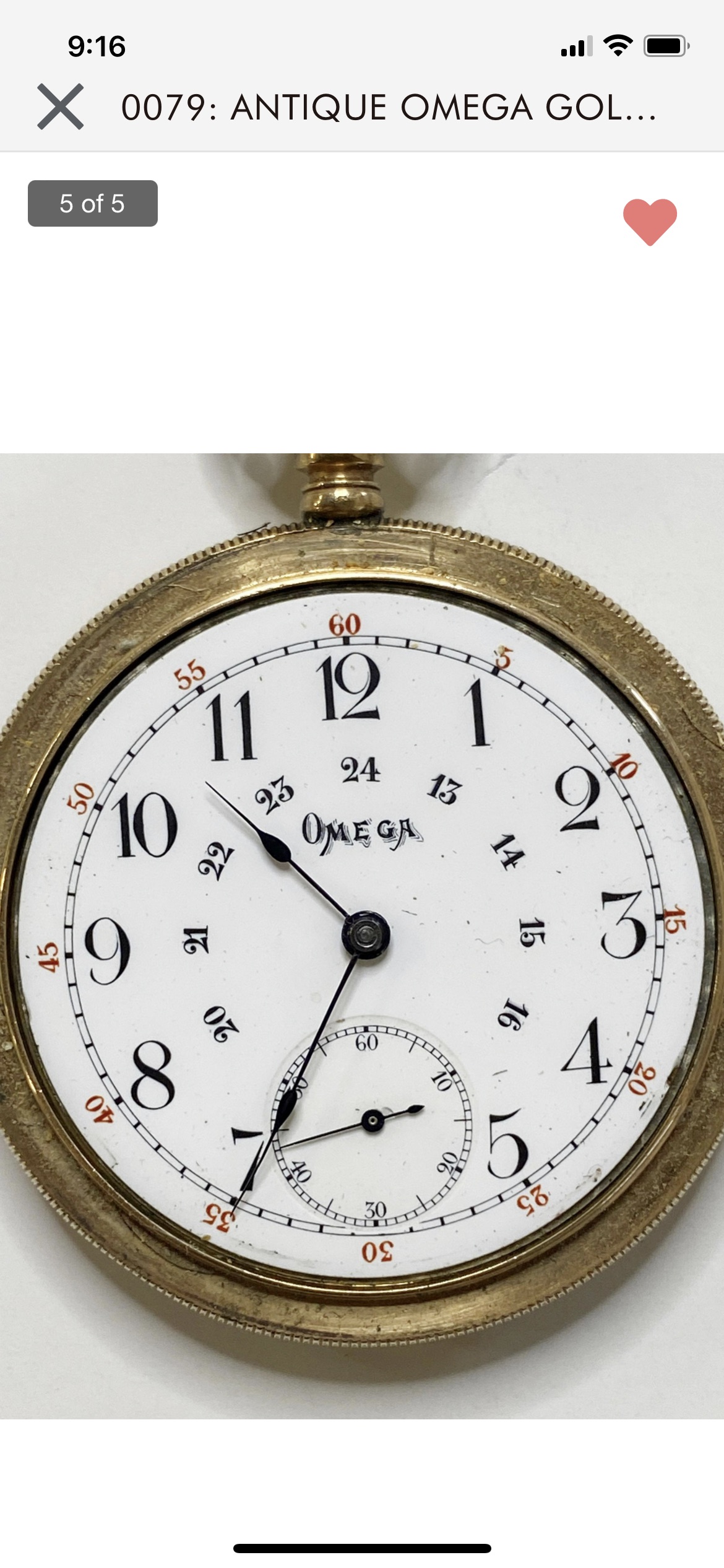

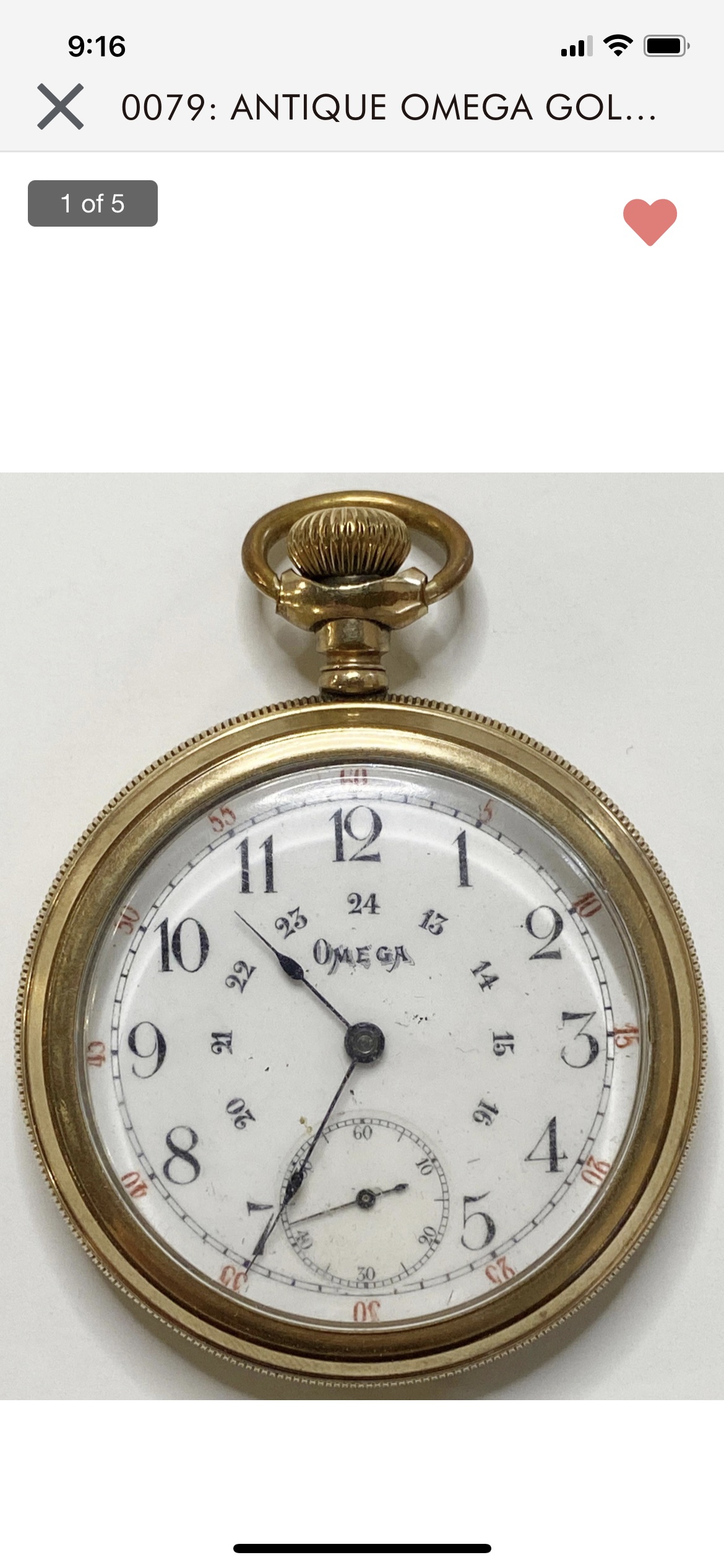

I saw this at auction the other day. I’ve seen the logo font in advertising, but never on a watch. Very cool
153
261
I stand corrected, now I've seen a PW with the stylized Omega script on the dial!
5,076
15,713
sold for $100 Plus auction fees, I would have enjoyed having it
