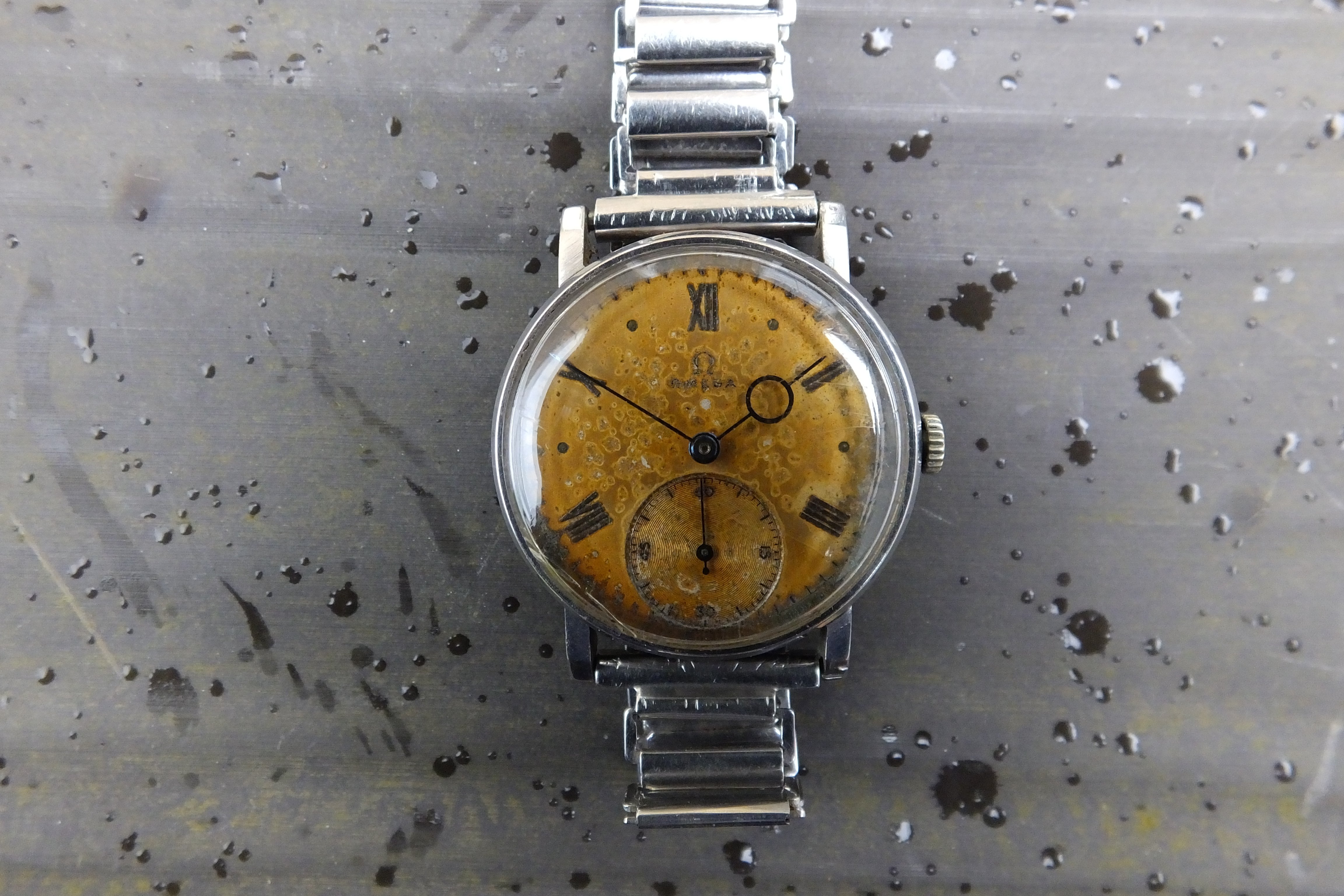

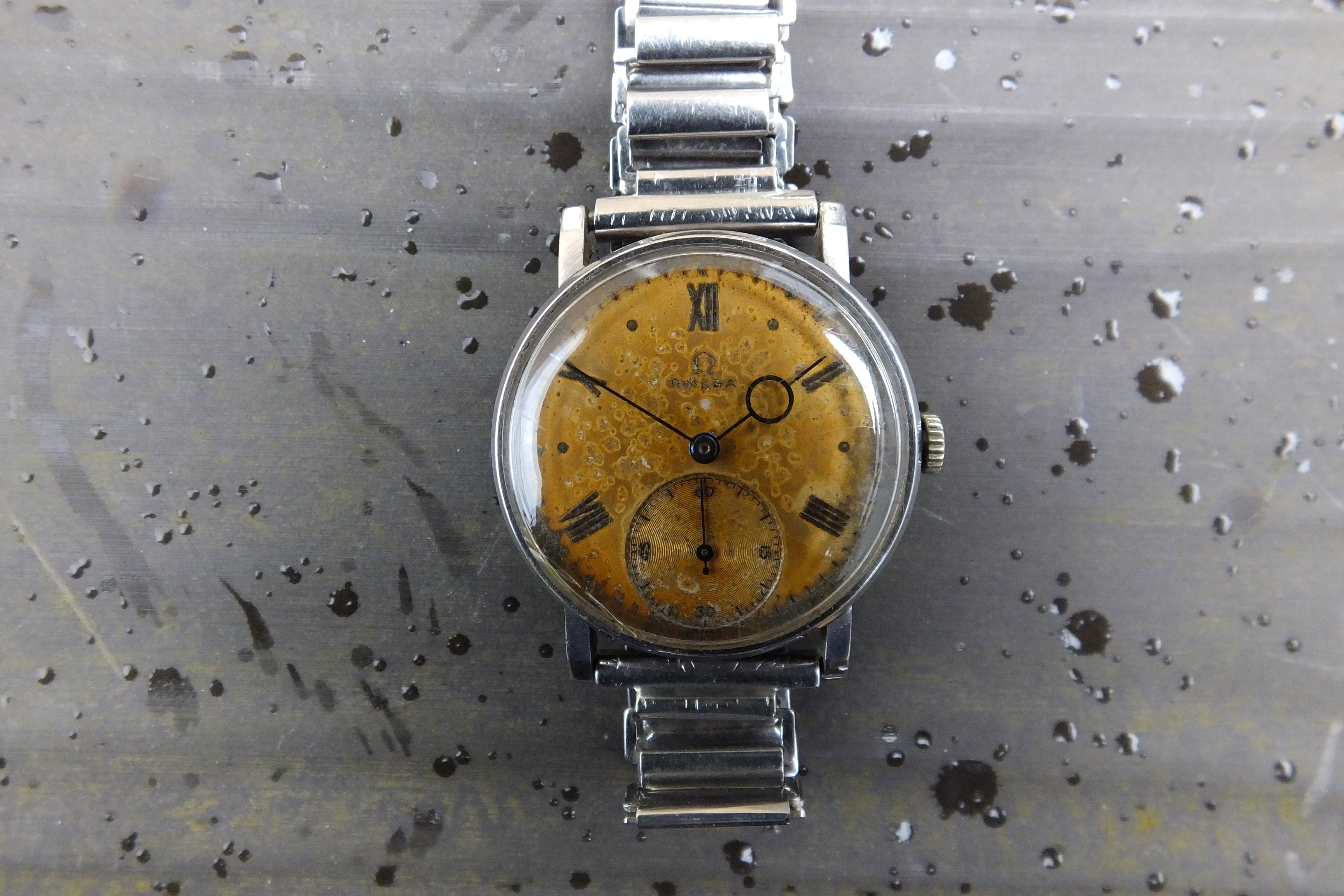

Hello everyone 馃槈 Greetings from Scotland! I'm a 'newby' so please be gentle with me!
If I have mastered the technology, you should see a photo of my late dad's Omega watch, which I am trying to identify.
He had the watch when I was born in 1950, so I suspect the watch was from the 40s.
The watch doesn't work, so I assume it has little or no value but for my dad's memory, I'd love to know the model name. Any light shone on this would be gratefully received! 馃榾

While some models at the time had "names", it was simply known as a "Gents Omega Wrist Watch" and I agree with the date of about 1940s.
Unfortunately the dial has suffered some damage (possible water intrusion), but it is still worth saving.
The hands are Omega "Poire" style and slightly unusual. If you have somebody competent open the caseback for you we can give you much more info.
Is the bracelet marked Bonklip at all?
Edit: The hands are actually called "Pontife" by Omega.
Sometimes idiots get them confused with Poire hands 馃槜.
(Thanks Erich)

I cannot offer any info on the watch but i LOVE the dial just as it is! Agree with the above post - the bracelet looks like a Bonklip. Somebody will be able to get that going again for you, but please don't even touch that dial. It's lovely.

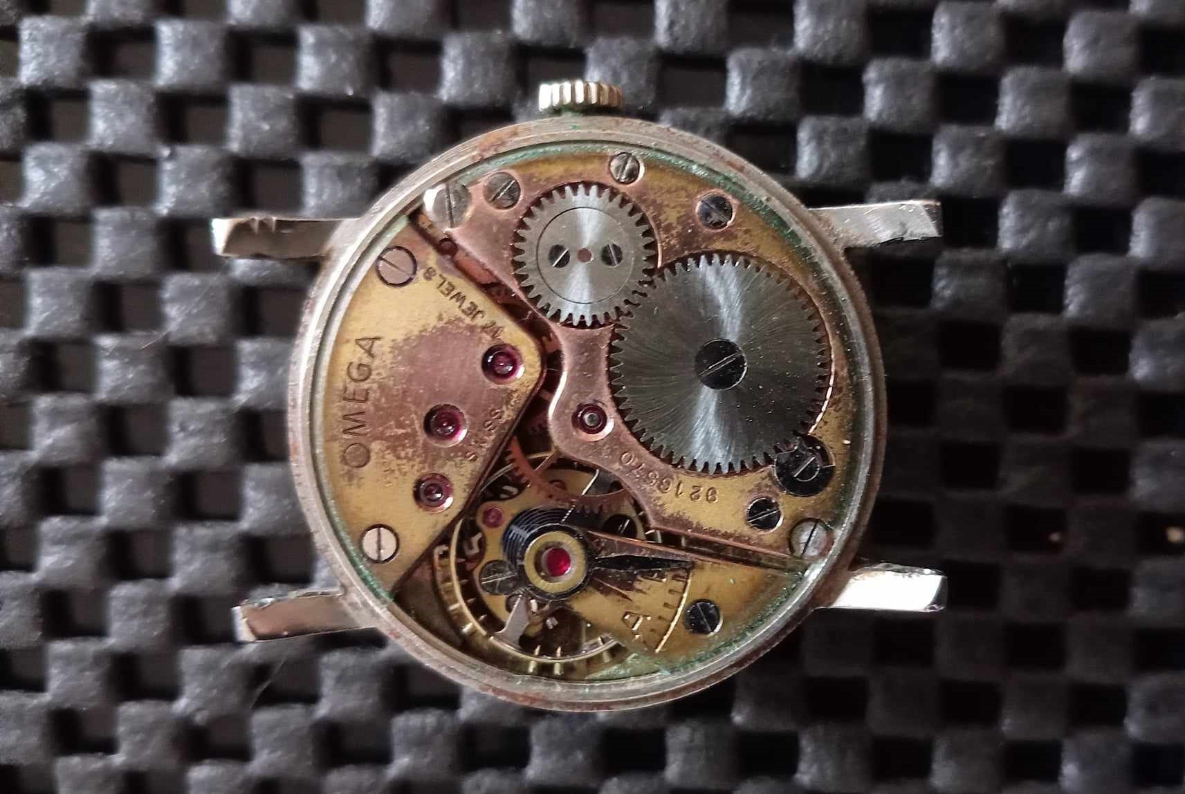

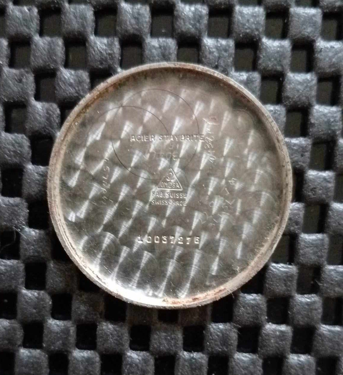

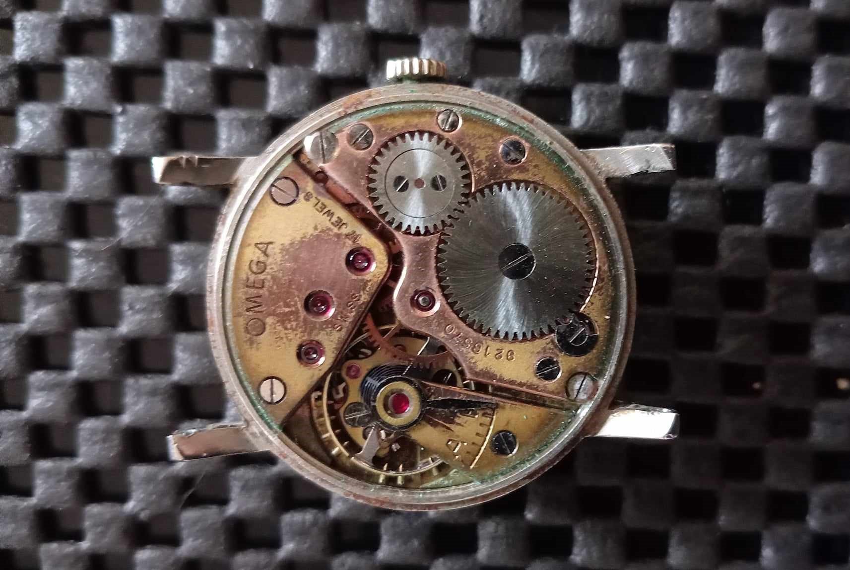

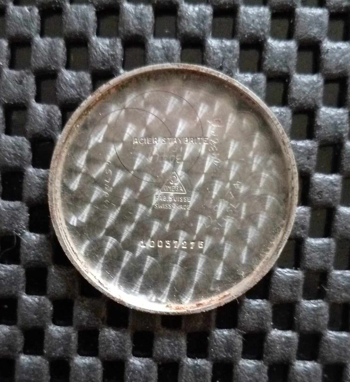

Thanks so much for your speedy reply! I do agree about the possibility of water ingress. Since I posted earlier, I took the back off the watch (I should have done so earlier!) and I have two more photos to add here.
The watch internals have the number 9216570 and '17 jewels'. Inside the back, there is the number 10037276.
As for the bracelet, the only words are 'bright steel'!

hello and welcome,
your watch is a reference CK 2243 with an early production calibre 30 T2 from early 40ies
these peculiar hands are called "pontife" hands and are not very common and loved by collectors.

Wow! That's fabulous news Mac! So good to know what it is now! Thanks so much!
