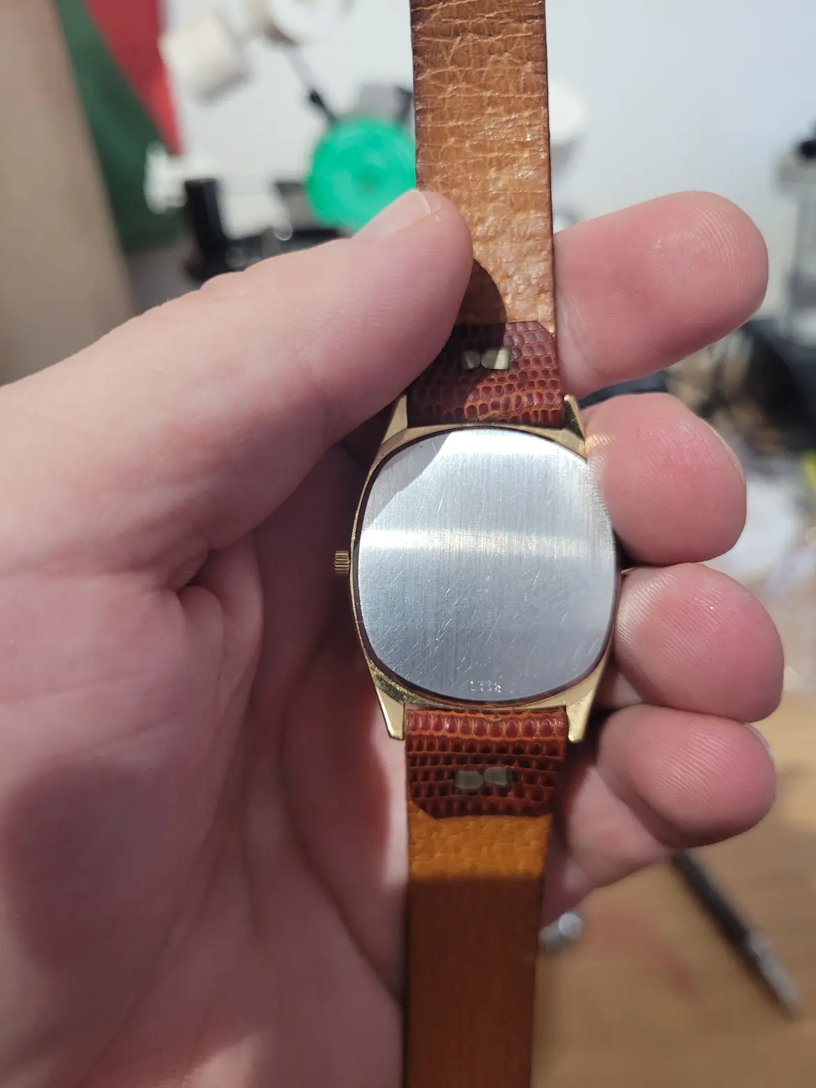

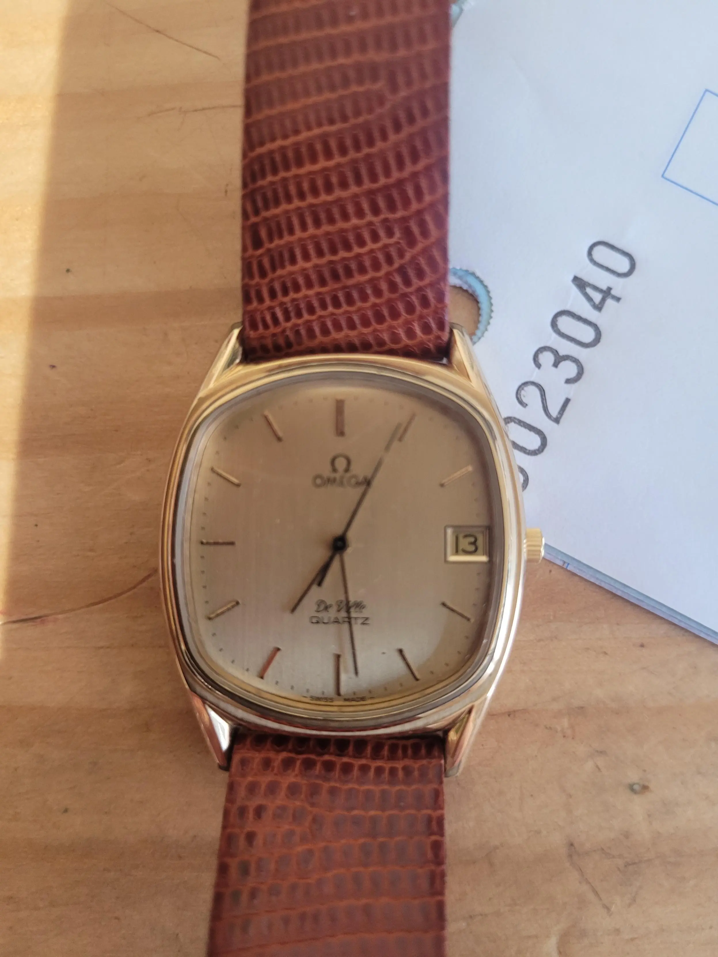

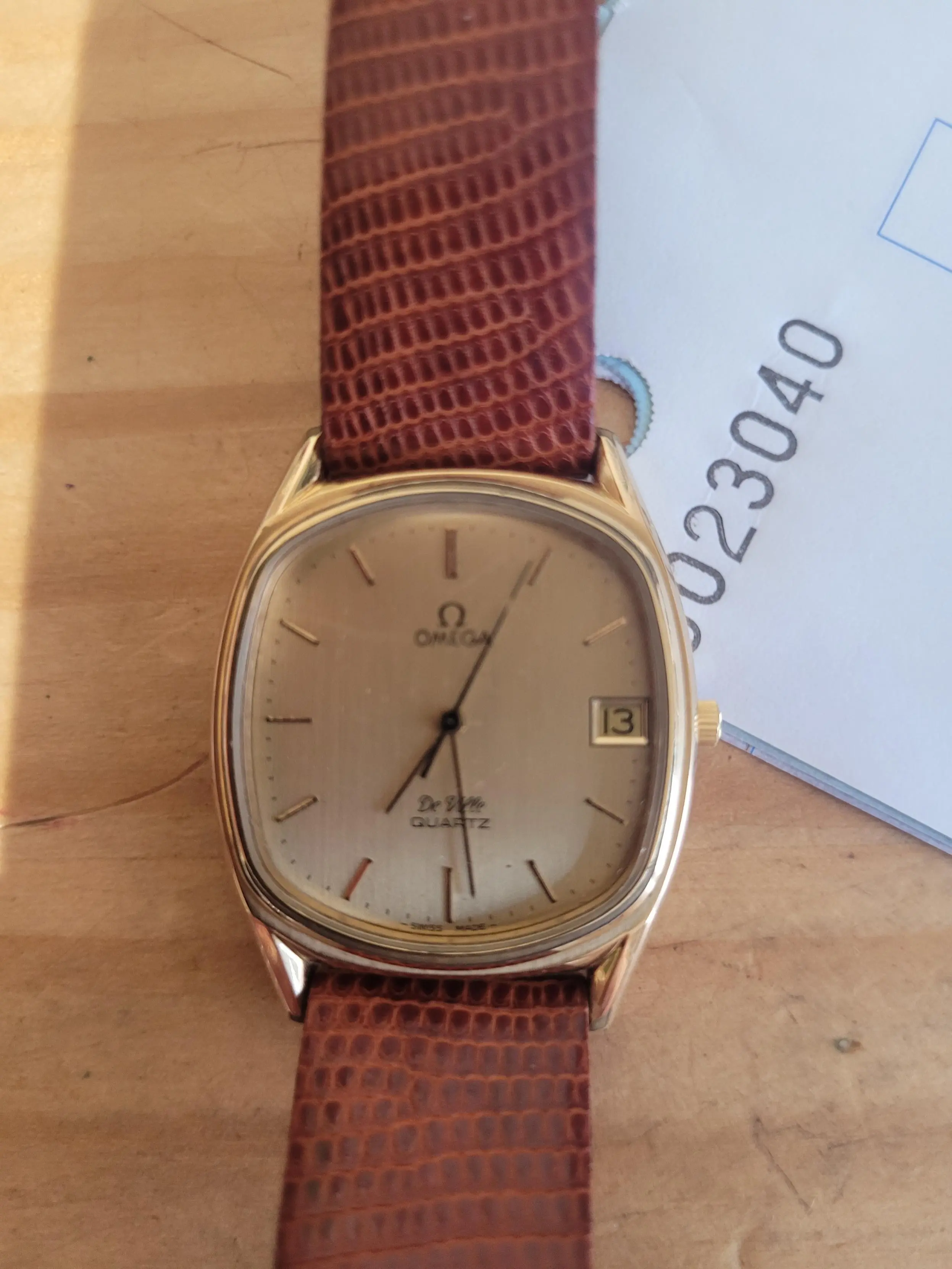

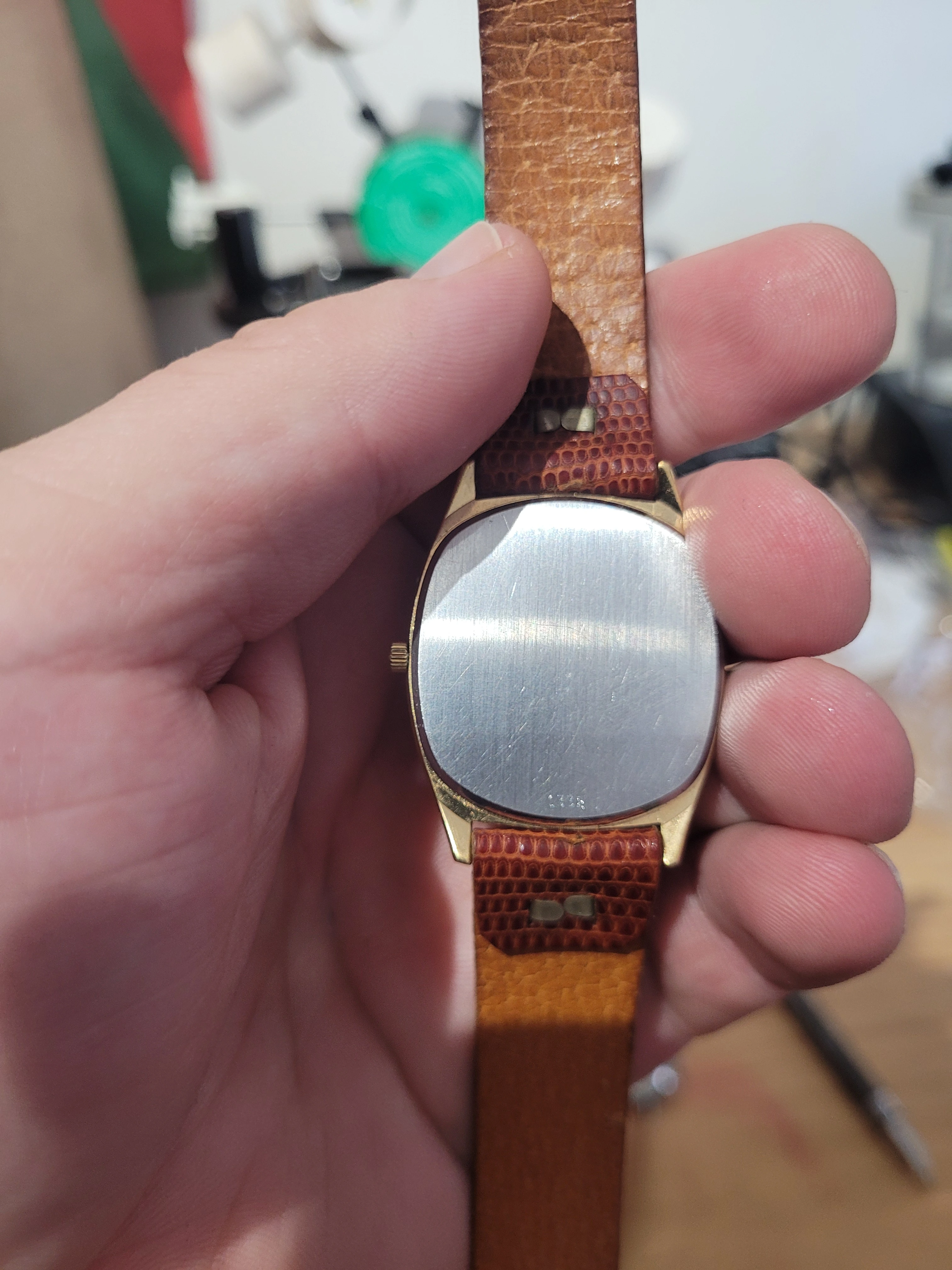

I have this beauty 1332 caliber Omega Deville Quartz (which I will call Tonneau?).
I'm trying to change the glass, original or not at this point. But I can't find information online about the part models.
Any information? I've found this: Ref. 169.0207 but even with this I am not able to find the part of the glass.
In some other website with google image reverse I've found his reference - R茅f : 192.0046. But not sure about this one.
Any help is welcome 馃榾
Thanks

What is the problem with the current crystal ?
In the photos you provided i cant see any flaws

Yes the picture doens't show clearly under this angle but it has a large scratch which, according to 2 pro, can't be fixed

Ask the pros to tell you the reference number of the watch inside the case-back, and maybe they can also look up the part number for you.
908
3,818
This looks like a reference 196.0207, but the only way to confirm that is by opening the caseback as suggested above. If that's the correct reference, Boley and Cousins list 063TN5368 as the mineral crystal for it. It is available at Cousins at a reasonable price, but I would have a watchmaker install it for you.
https://www.cousinsuk.com/sku/details/omega-case-parts/tn5368
You may also need a new gasket with it, which would be this one according to Cousins:
https://www.cousinsuk.com/sku/details/omega-case-parts/x13282
