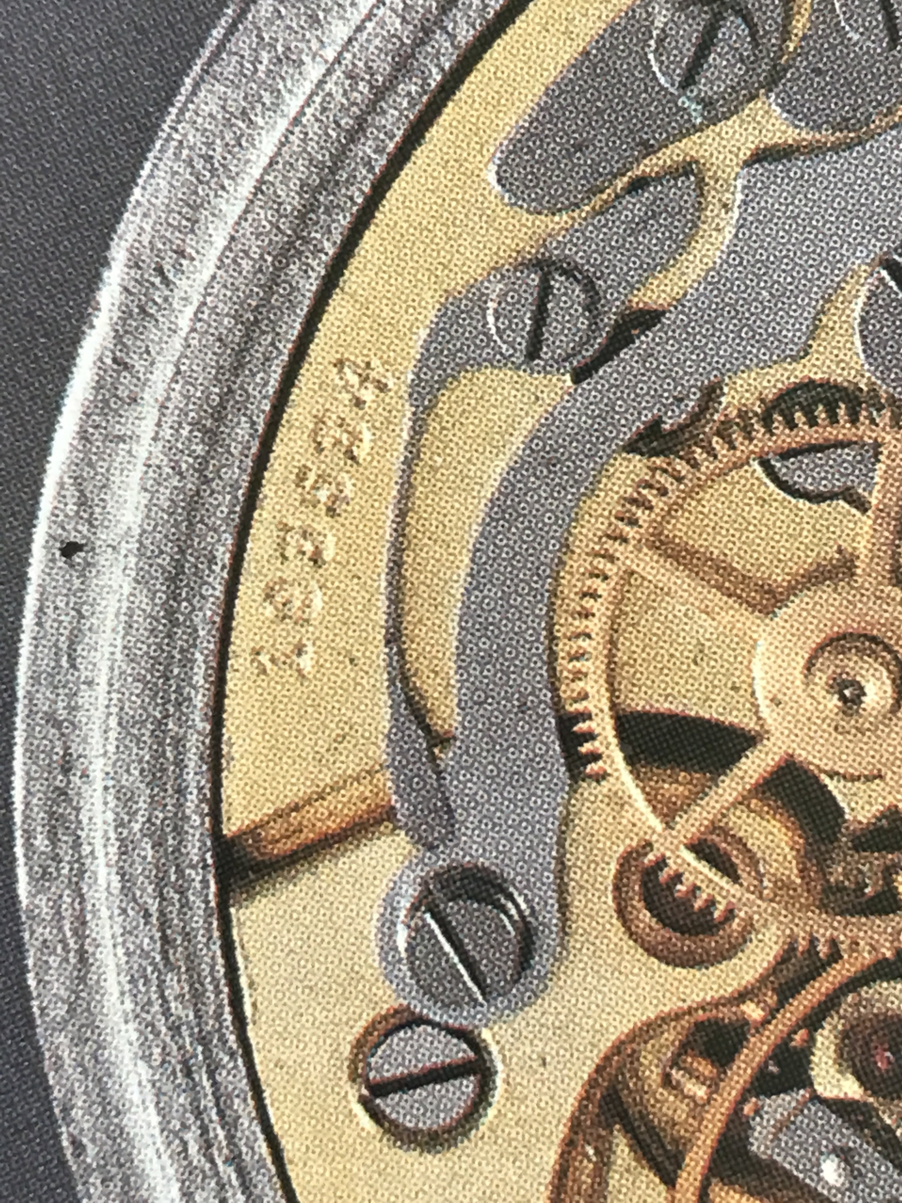

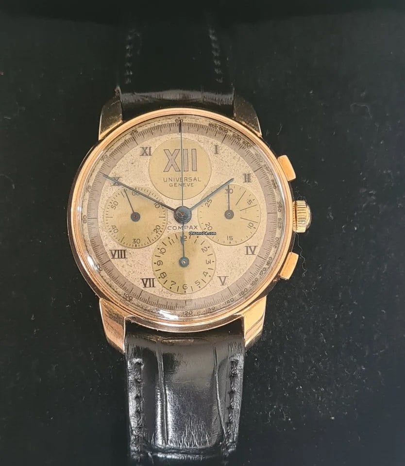

Found another example. Movement serials looks to be 183.584 which is close to others with this dial design. I have my doubts about the originality of this dial BTW

Adding another one:

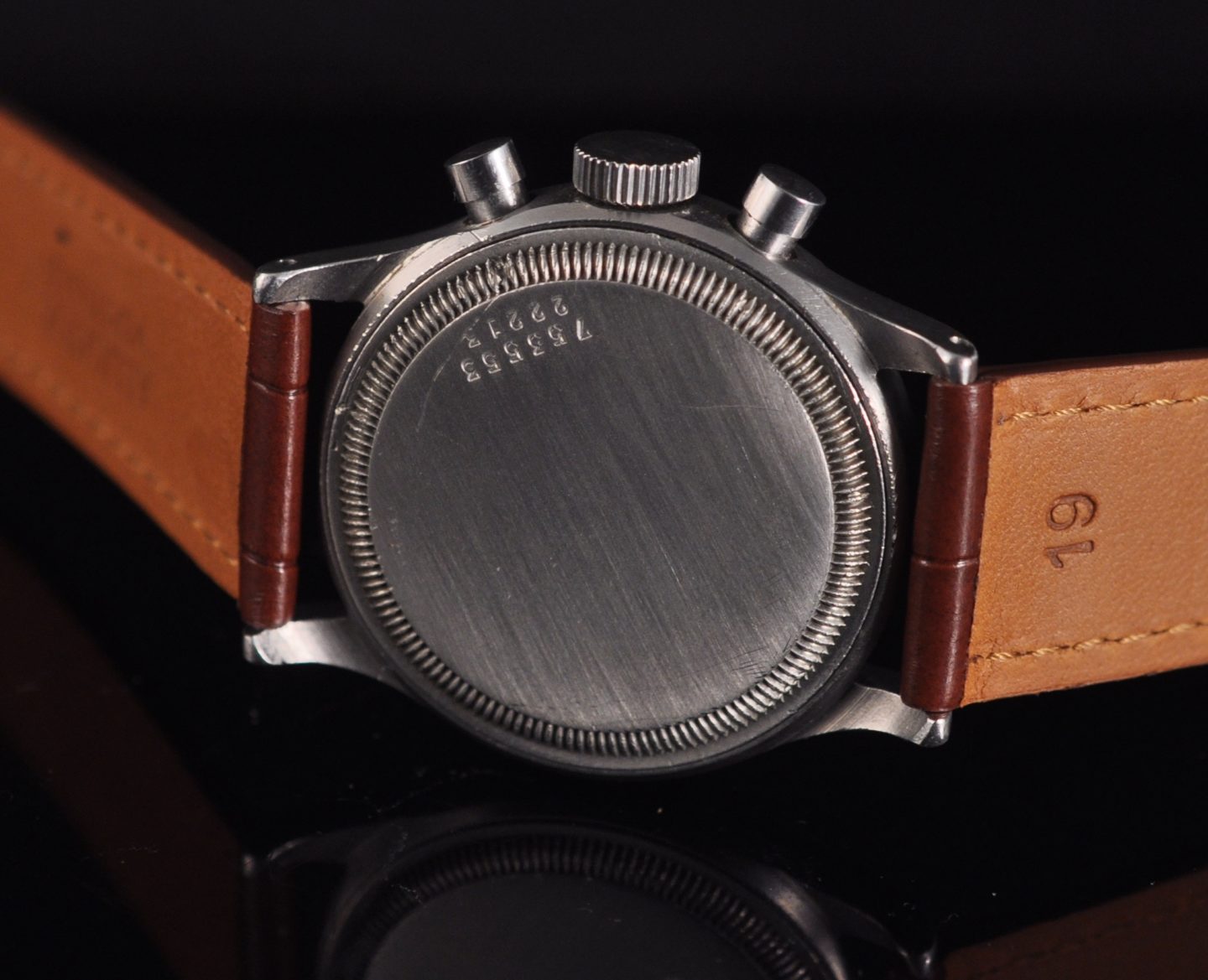

Had some contact with the seller. I think the dial started its life with this movement. However: the caseback is not original...

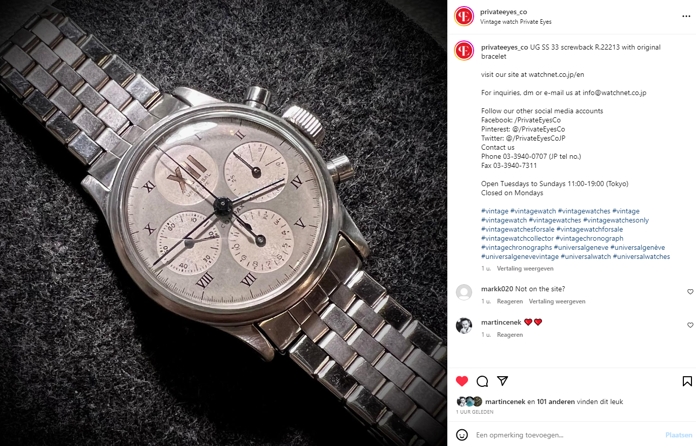

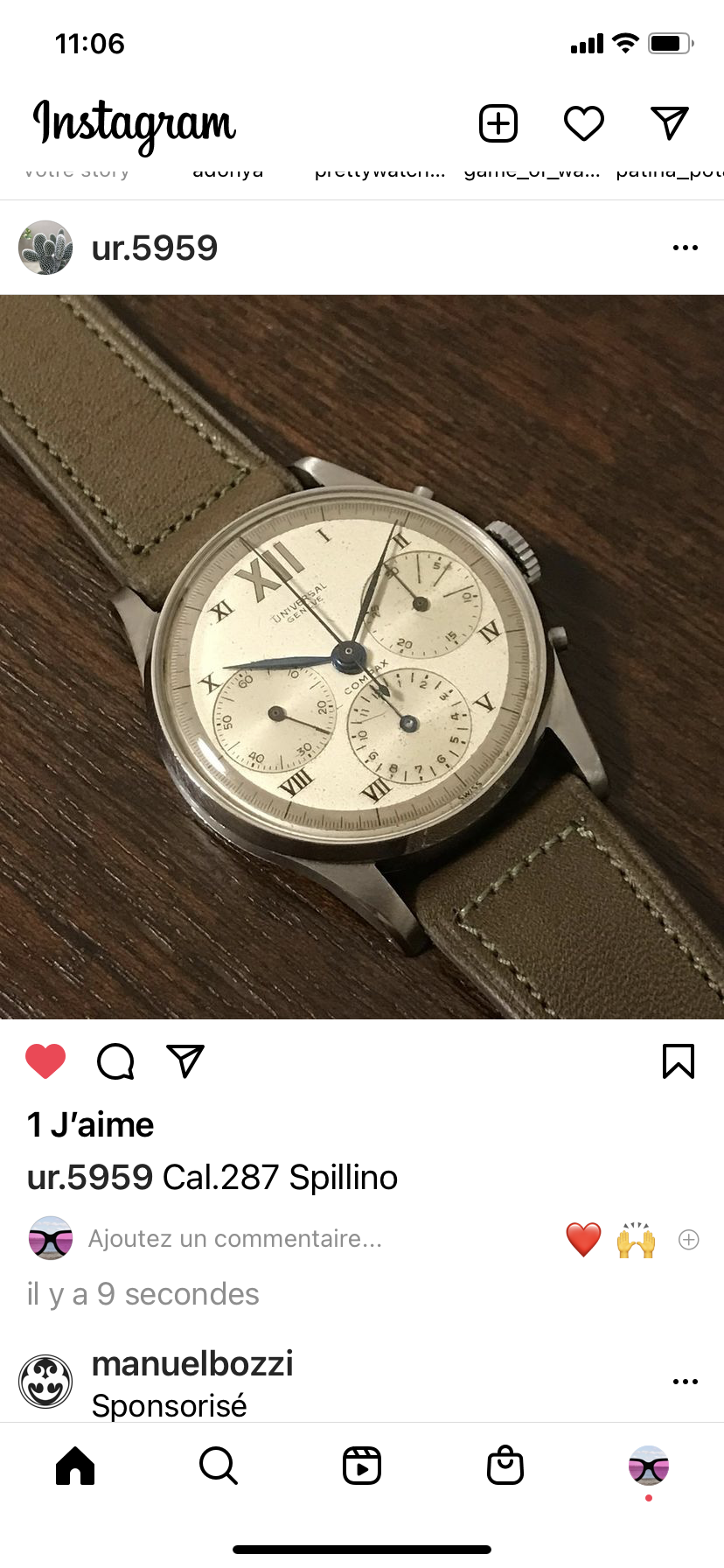

And now in Japan.... (see the dot at 53)

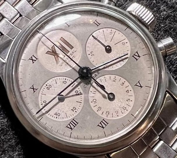

Another one, and a beauty.

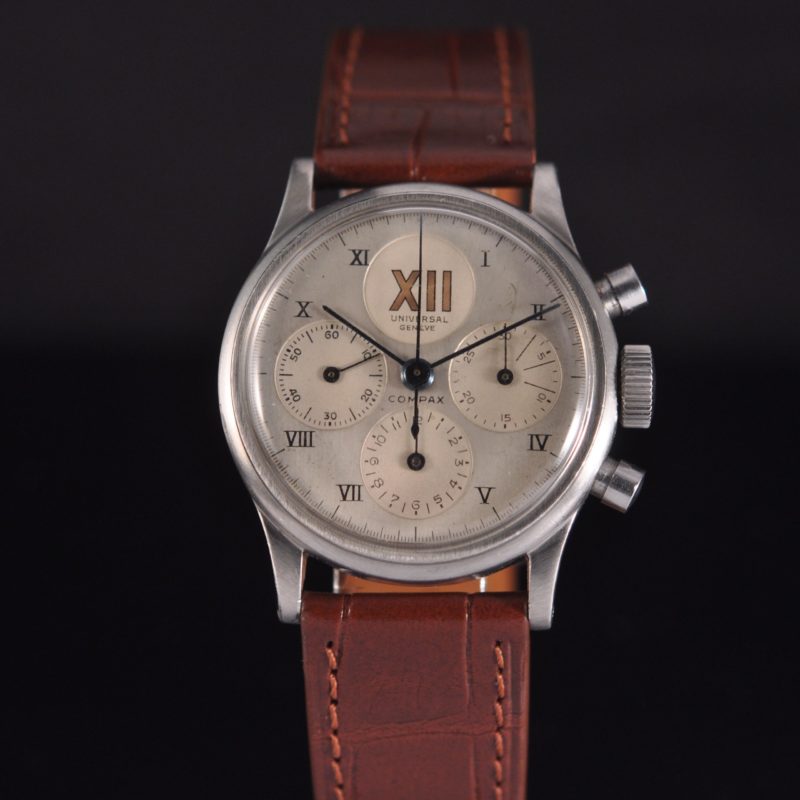

haven't looked closely..but I'd imagine they have a crazy price on it, they are very optomistic on pricing but move the merchandise.

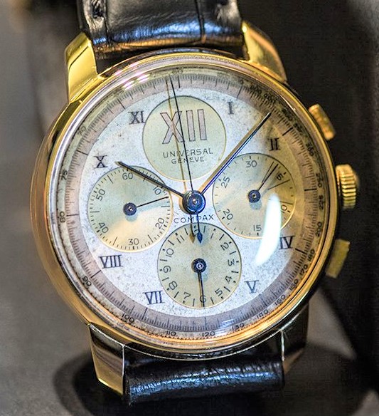

If you get close to the printing you can see redial more easily. They made a valiant effort though to match it up as best they could to the real thing..

The thing is that some of the other XII's have the same sloppy printing but I don't know whether that is good or bad 😎

Yes. You don't?
I don’t think it’s a redial. 😉
