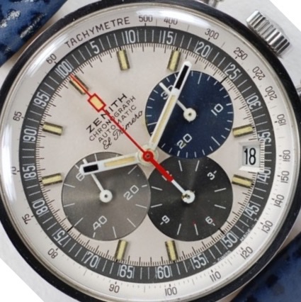

Stewart- I have trouble making out the distinctions between original and service tachy. Any pointers?
Does this one look kosher?
3,070
3,533
Larry. I don't know the nuances - I'm sure LouS or someone else will chip in. My assumption was based on the fact that the ring looks very clean and if the dial and hands needed to be replaced, an original ring would show signs of aging, disproportionate to the replaced parts, otherwise they would not have needed to be replaced in the first instance.
424
907
The C of TACHYMETRE is rounded in the Service.... this is the most evident,
however also the number's font

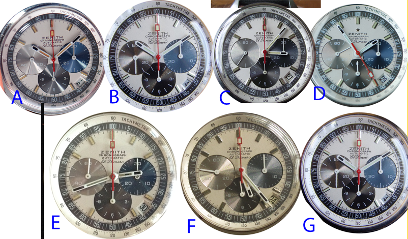

sorry. this link describes some of the differences between an A386 original and service dial
here are some to test your skills
1,366
867
oooooh. This is a fun game. How long should we wait to put down our guesses?
629
6,605
OK, I give it a try
A original dial, original hands (or perfectly colored relume), tachy ok
B service dial, service hands, service tachy
C seems all original (in perfect condition - almost too good)
D original Dial (but lume looks almost too good - maybe relumed, service hands, tachy ok
E looks all original (hands
F dial and tachy original, service hands
G all service (dial, tachy hands)
