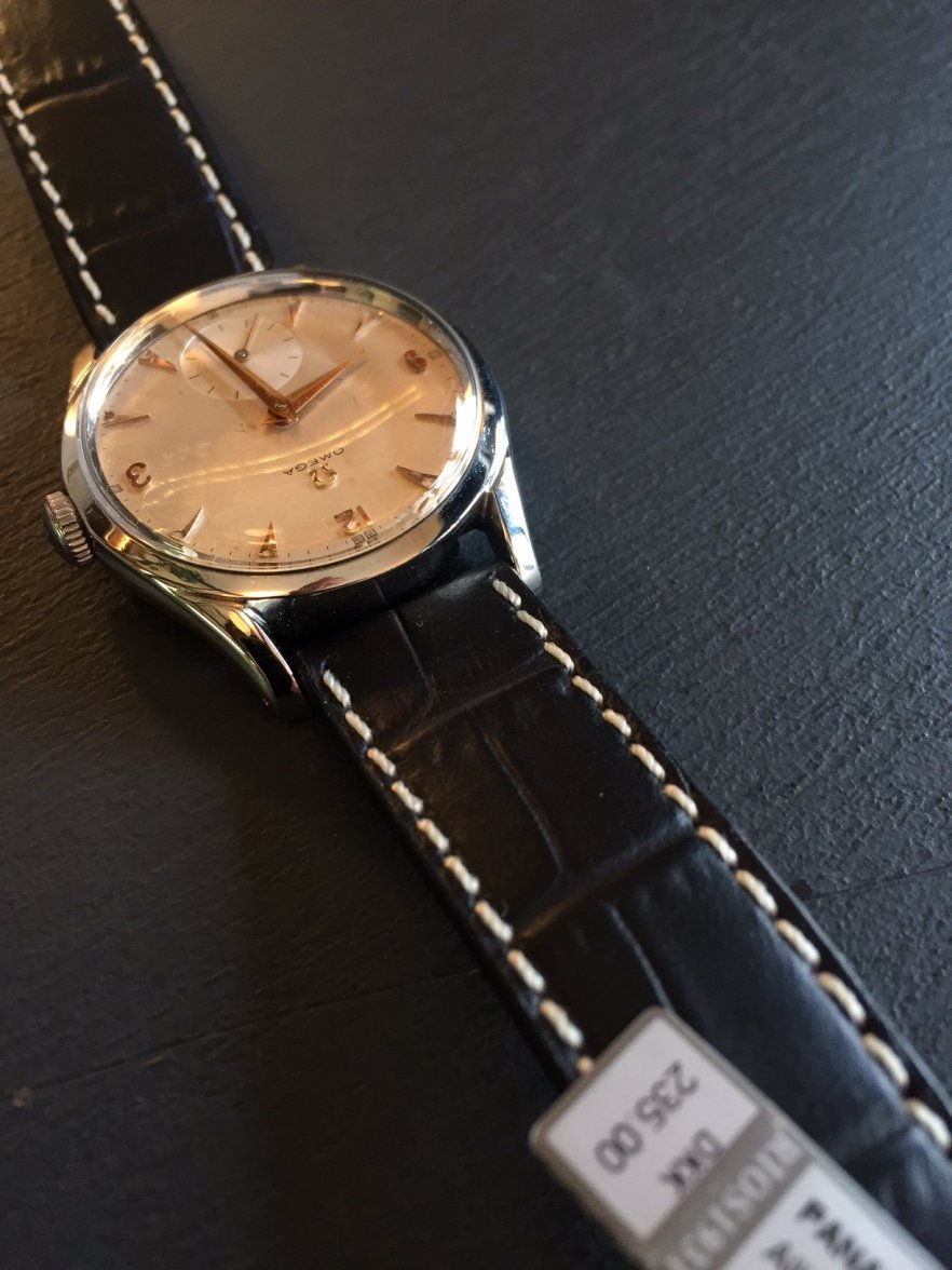

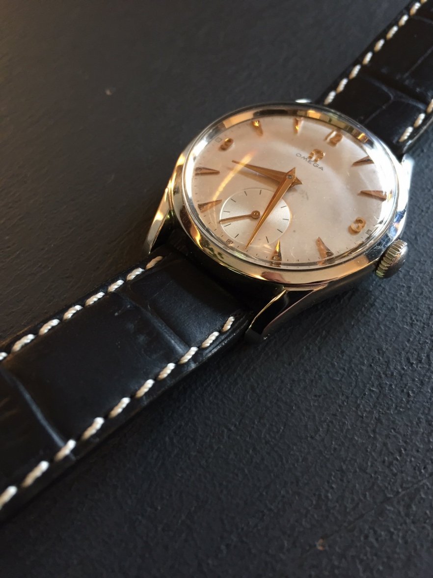

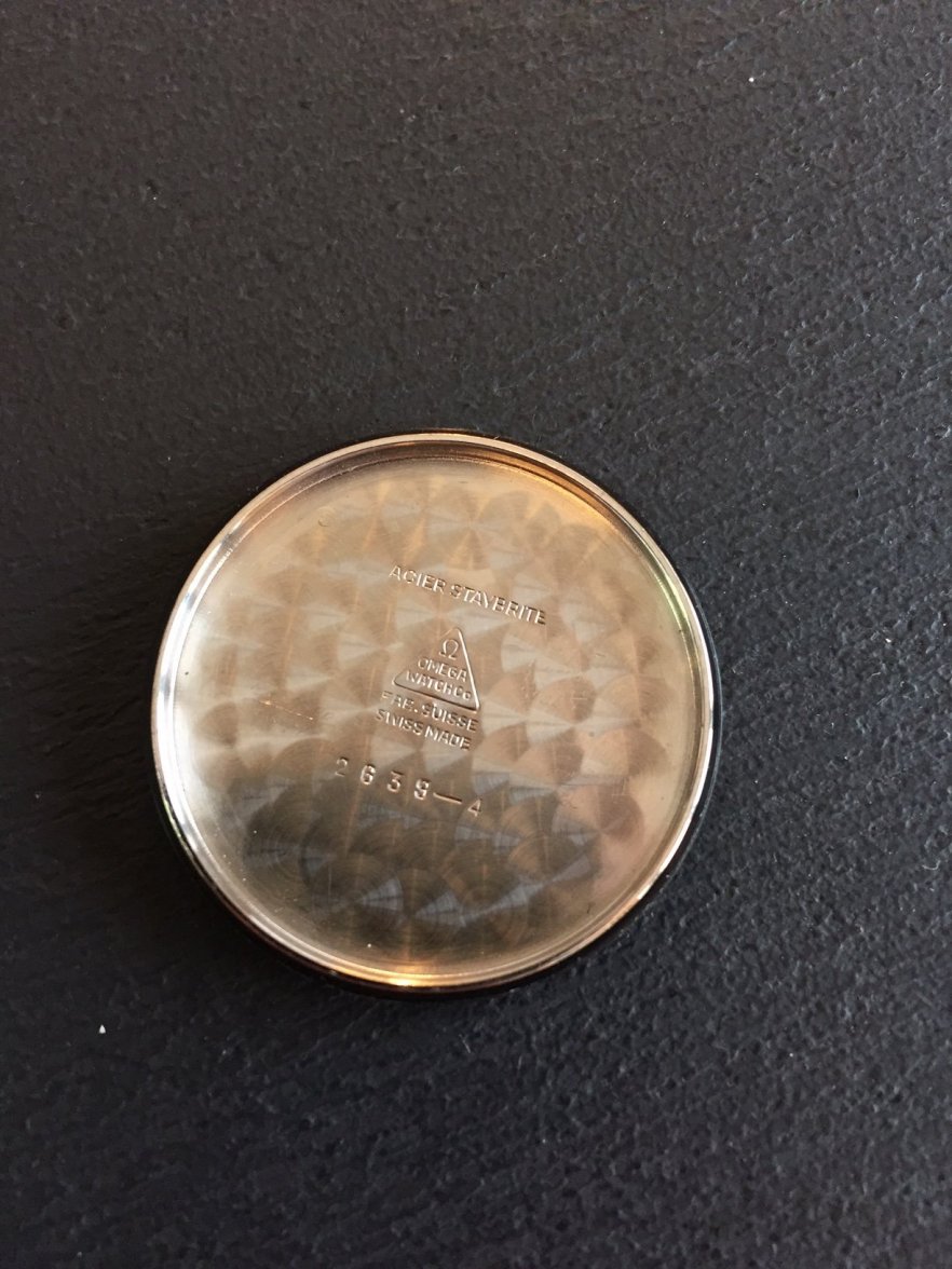

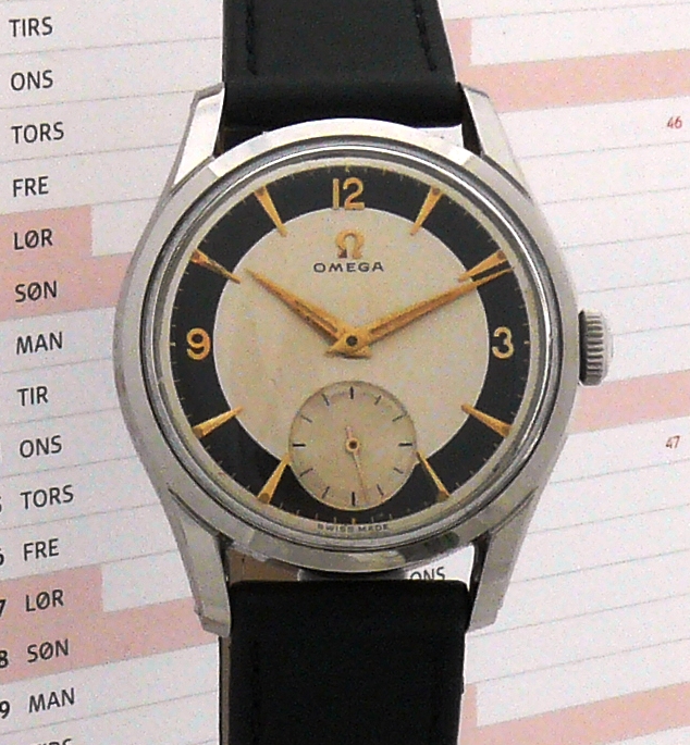

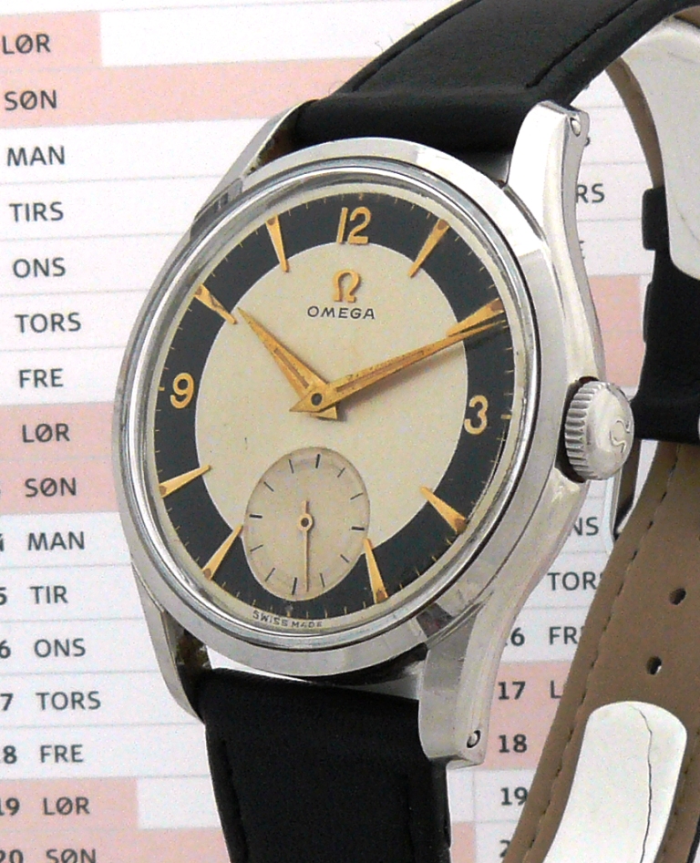

    Hello again.
    After last month's redial misadventure (https://omegaforums.net/threads/this-has-to-be-a-redial-right.92870/), I have decided to do the smart thing this time around and ask here before I buy.
    The stats:
    Ref. no.: 2639-4
    Caliber: 266
    Year of manufacture: 1954
    The watch has recently been serviced according to the seller. The price is the equivalent of USD 977 (plus shipping).
    Obviously, I'm anxious to know whether the dial looks legit, and whether the case looks overly polished. I'd also like to know whether you think the price is reasonable. Beyond that, anything else you can tell me about this particular watch (good or bad), will be greatly appreciated.
    Some pictures sent to me by the seller:
    As always, thanks in advance for your help!
  2. Canuck May 10, 2019
    13,478
    38,028
    Not one decent picture of the dial, face on, filtered lighting. Very difficult to make a meaningful comment. The case looks polished. 977 USD? Really? Must be from a dealer. I would have preferred to see it before it got so highly “processed”.
    connieseamaster and NoHatMan like this.
  3. bubba48 May 10, 2019
    1,548
    7,877

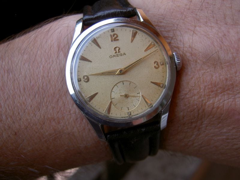

    The dial is correct IMO, but not the second hand

  5. Dan S May 10, 2019
    18,819
    43,266
    I believe this reference is 36mm which is a decent size, but not truly one of the jumbo references. Better photos are needed to judge the dial, since zooming in seems to show stains and damage. The case is overly shiny and reflective , making me concerned about polishing, so again better photos are needed. Seconds hand is wrong.
    Would have to be a really excellent example to justify the asking price.
    Shabbaz and NoHatMan like this.
  6. X350 XJR Vintage Omega Aficionado May 10, 2019
    12,626
    29,952
    ALL of the hands are incorrect, lumed dial and un-lumed hour and minute hands. Maybe a $400 watch.

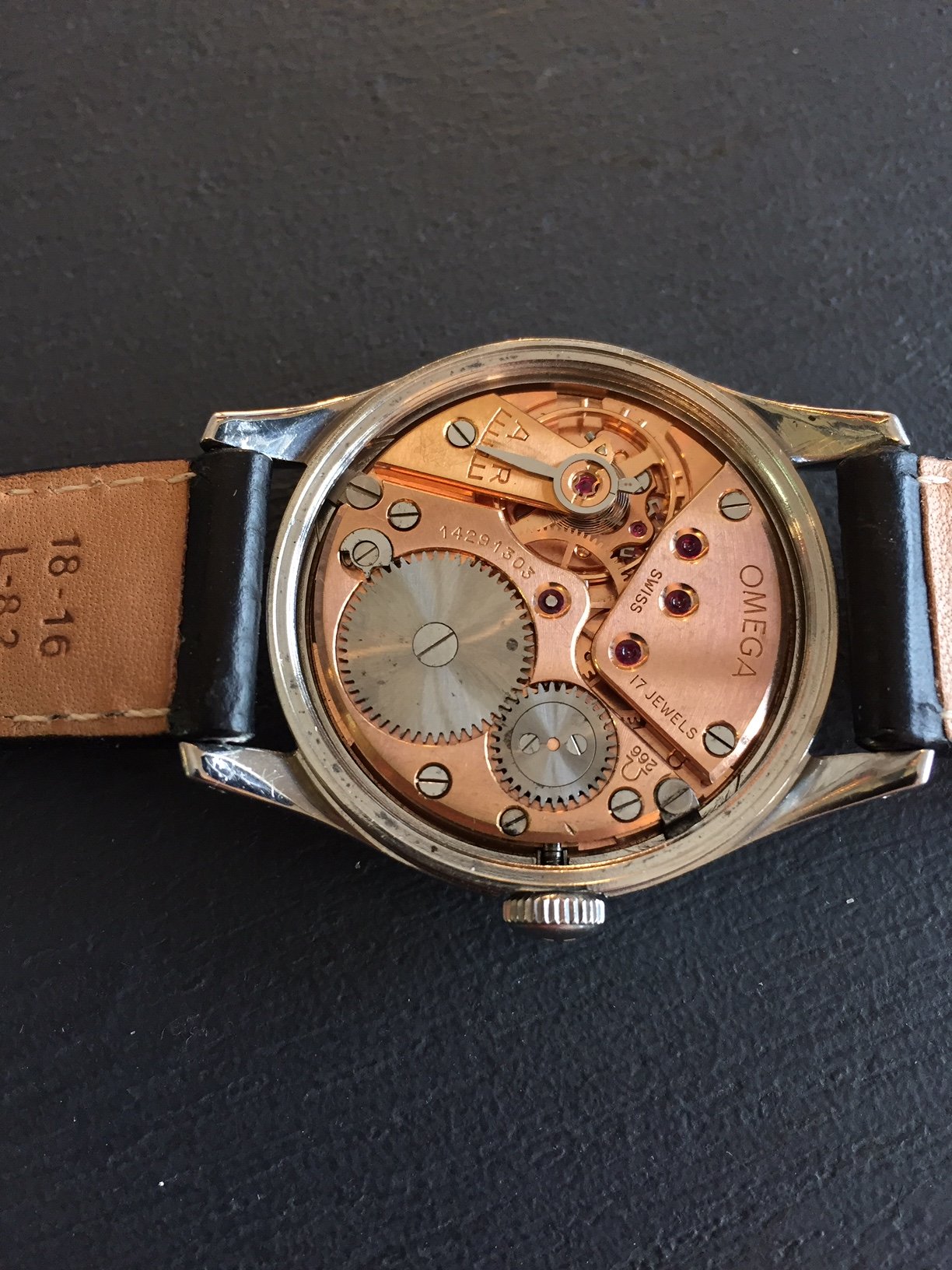

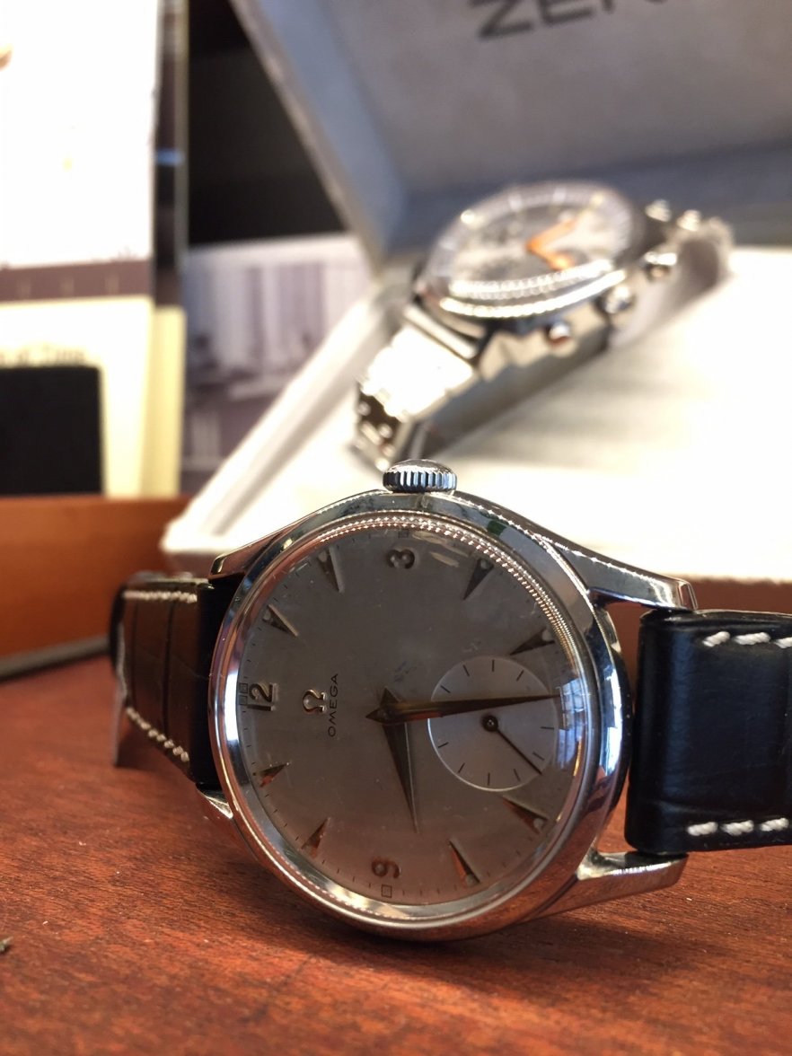

  8. NoHatMan May 15, 2019
    15
    5

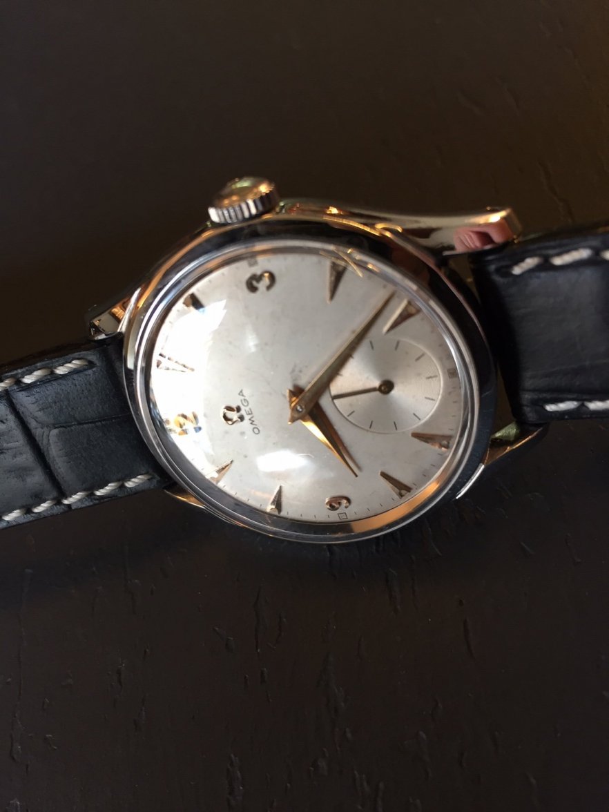

    Aaaaand here's another one up for your judgment. All original, according to the seller.
    Case ref.: 2639-14
    Caliber: 265
    Year of manufacture: 1953
    Case diameter: 36mm
    Asking price: The equivalent of USD 870
    I haven't received a movement pic, which is why I didn't include one.
    Worth pursuing any further? Any obvious red flags?
    Again, thanks in advance. (And apologies if I'm being annoying. I'm a noob and still trying to learn the ropes.)
  9. Observer I know nothing! May 15, 2019
    806
    1,878
    I'm a noob, too, and I like these threads as opportunities to learn when more experienced collectors weigh in. Thanks for posting.
    It would be nice if these last photos were higher resolution. If someone sends you blurry photos, it might not be a good sign.

  10. NoHatMan May 16, 2019
    15
    5
    Yeah, I know. I've had the same thought - and would also like to see some better, more hi-res, pictures from the seller. Still, if these photos show any obvious red flags (e.g. incorrect dial, hands …), why even bother asking the seller for better pics?
